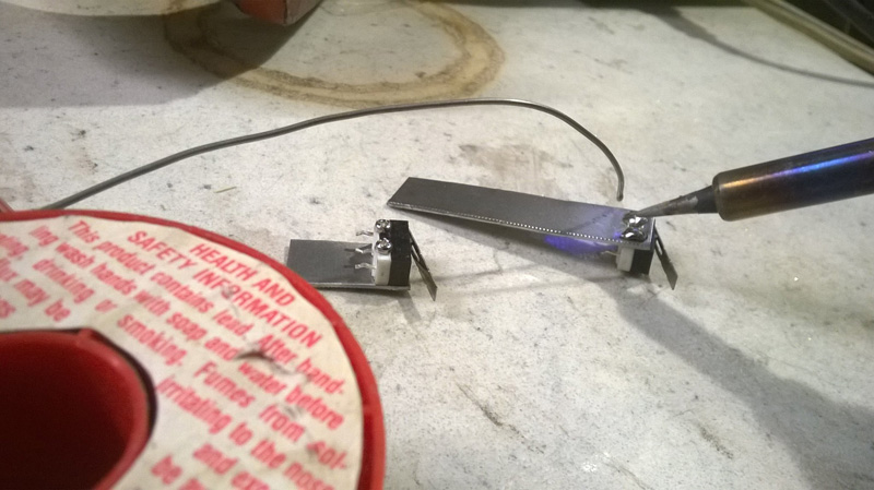

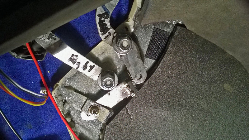

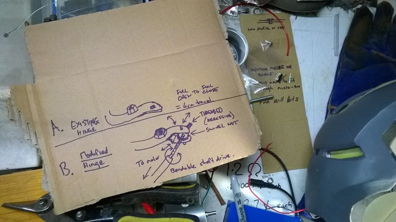

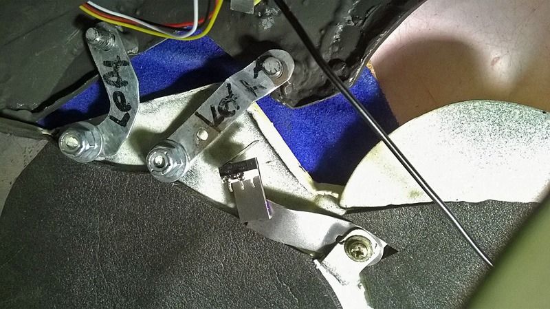

1. Experimenting and making a DIY linear actuator for the helmet face plate.
2. Building tiny mounting plates for micro switches.
3. Micro switch mounted on the upstroke hinge. I've made them adjustable so I can tune their height once the actuator is connected.
4. Micro switch mounted under the downward faceplate hinge. This bracket will be re-made as one piece. I had to make it in two for prototyping to get the angles right.
5. The plotting continues. Linear actuation concept drawing. How to attach the actuator to the hinge.

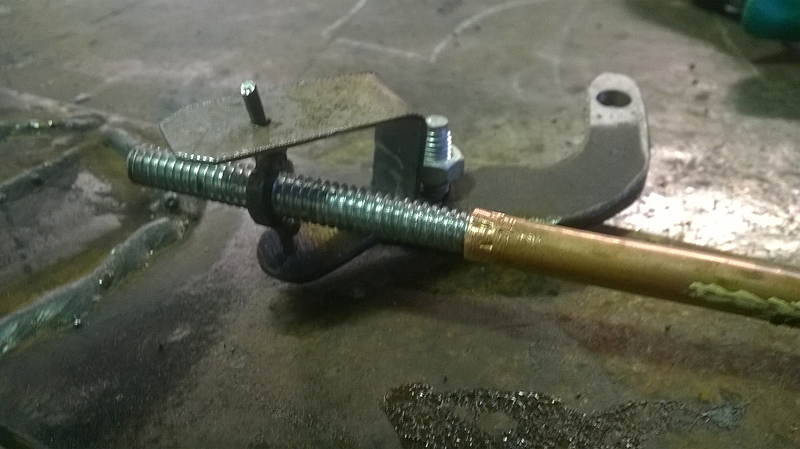

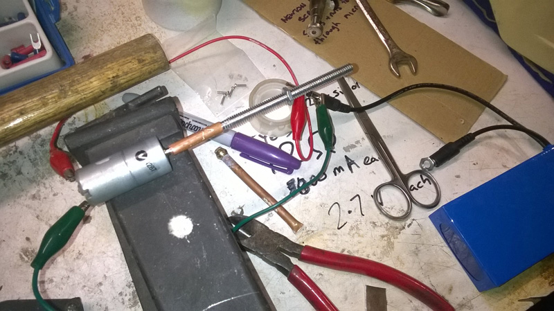

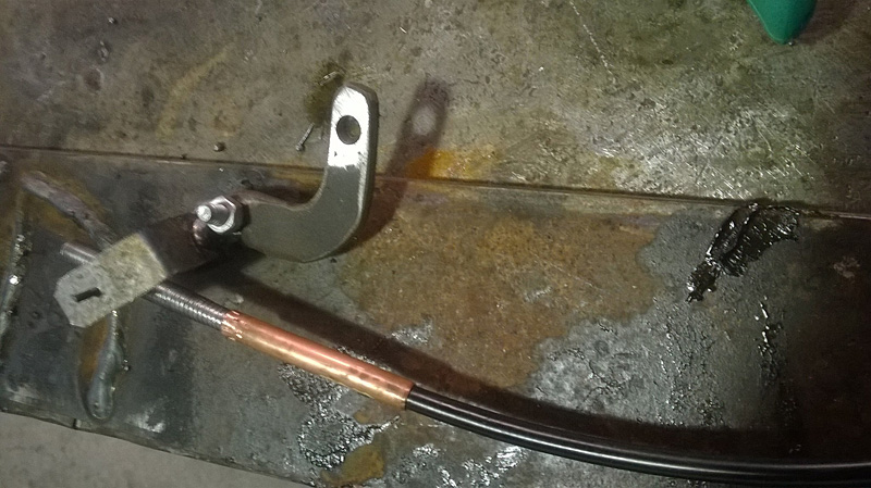

Worked out a rough linear actuator for the faceplate hinges with more junk laying around in the workshop. It works good enough for the bush as they say.
Now to make a prettier, more slim-line one. I can find threads three times as aggressive and thus move the hinge a lot faster but you get the idea.
I've measured the pull on the hinges now and it's around 2.1kg. All I have to do is find a motor small enough, strong enough and fast enough to turn the chosen thread. There's a bit of physics involved trying to work out torque required and the speed needed to pull and push the nut the required travel, but I'm sure a boffin will step forward and assist where my brain chooses to exit the aircraft.

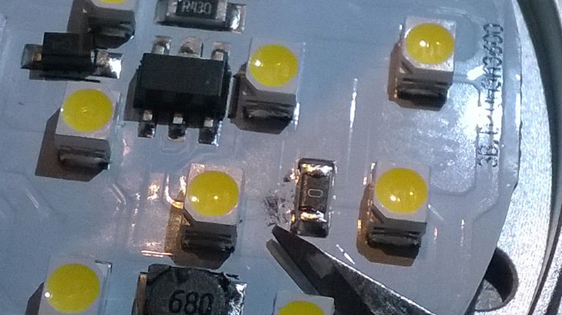

GENIUS!! Thanks to Dan, AKA, "Dakiller" on the Overclockers Australia forum who drew a line on a photo of my circuit board and told me to cut it. Problem solved!!! Arc reactor now powers up and STAYS ON. Touch feature disabled. Done and dusted!
You sir, are a GENIUS! Finding it was so hard, but doing it was so simple!
I know a lot of kids are not going to be disappointed by Iron man's reactor switching off half way through a hospital visit.
So happy!
