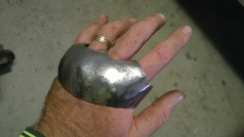

Tonight I cut out plates for the rest of the hand. Modified them slightly. I can't do any beating though as it's late at night and the neighbours might get a little upset.
Instead, I trimmed finger pieces and conducted range of motion test. I can touch all fingertips to the opposing thumb. So far so good.
I'll see if I can get the rest of the hand beaten into shape and welded tomorrow.

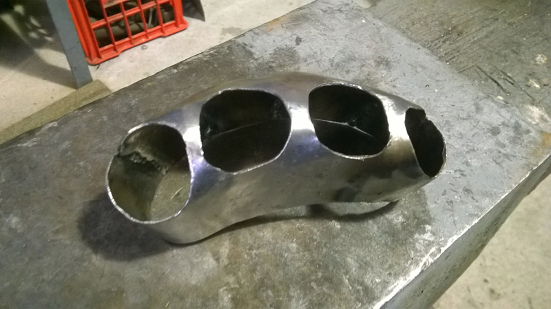

I worked through lunch and stayed back in the workshop after work for a bit of un-interrupted tinkering today.
Lots of fiddly panel-beating. I got a rough and functional form in place, now for trimming and clean-up, before brazing in the steel cables to join the fingers.
I may have asked this already but have you ever made any historical armor? If not do you have any plans to? You have the engineering and craftsmanship down for that kind of work.
Tweaking, trimming, bending, sanding and smoothing edges, every tiny adjustment yielding improved movement.
You might notice the knuckles on the fist are a little out of alignment and open a bit. I will be brazing in a thin steel cable either side of each finger that will keep the pieces together and aligned.

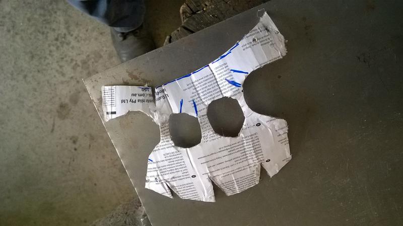

Starting on the next gauntlet with lessons learned from the first one, saving time and metal. See the difference? New template cutout top, old one on the bottom.
