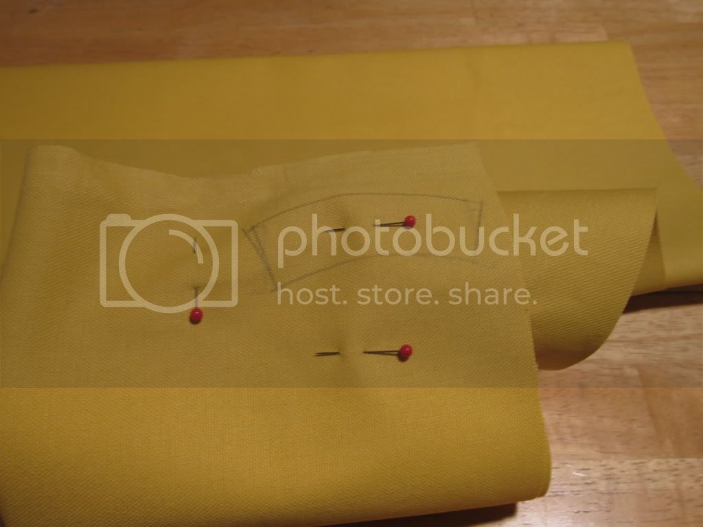

So, this week I got some mostly small stuff done. I did the shoulder boards:

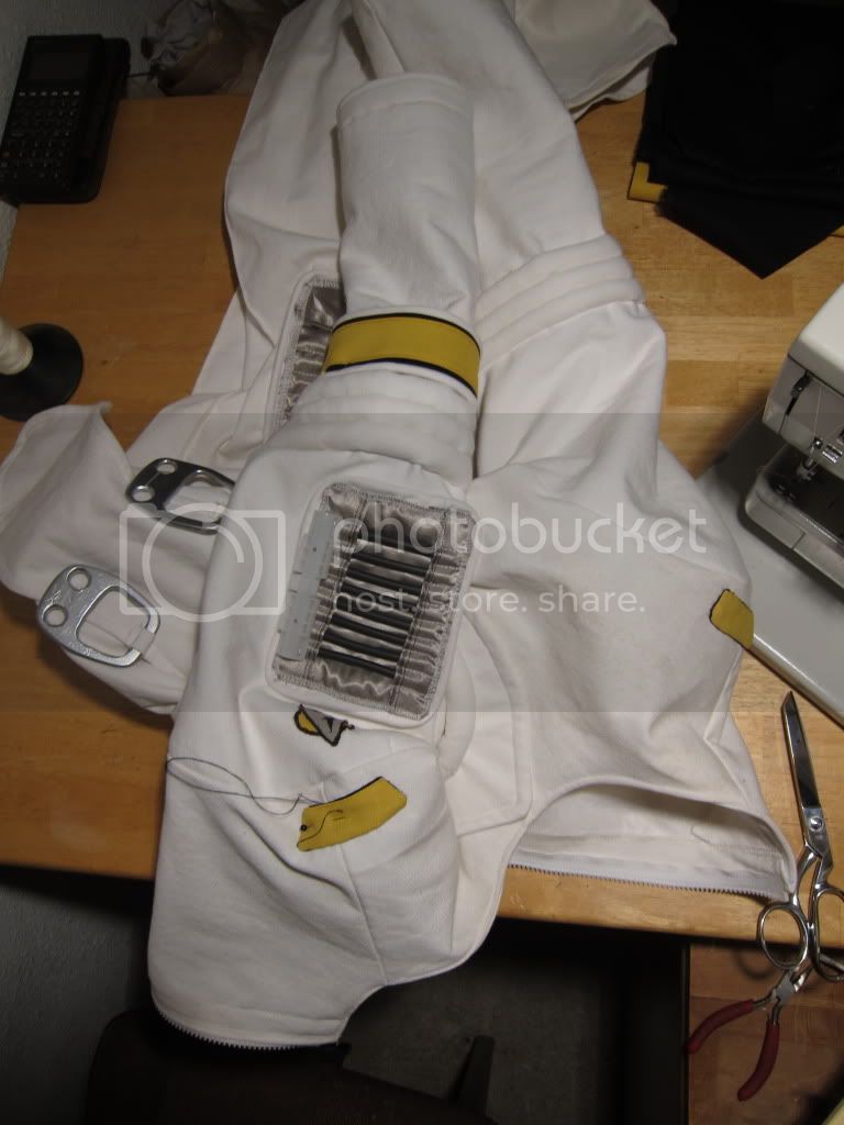

And hand stitched on a lot of other stuff- such as the rank pin 'pillow'
I then convinced myself that the front panel was not wide enough. It just didn't look right, proportionally. So made a new one, and replaced it. (Making a new one is pretty easy- undoing and redoing all the hand stitching to replace it is not... D'oh!)

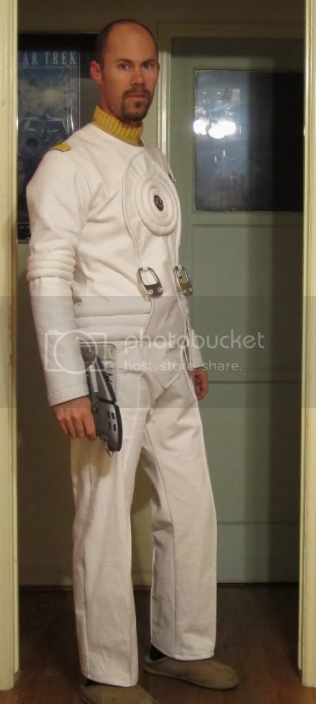

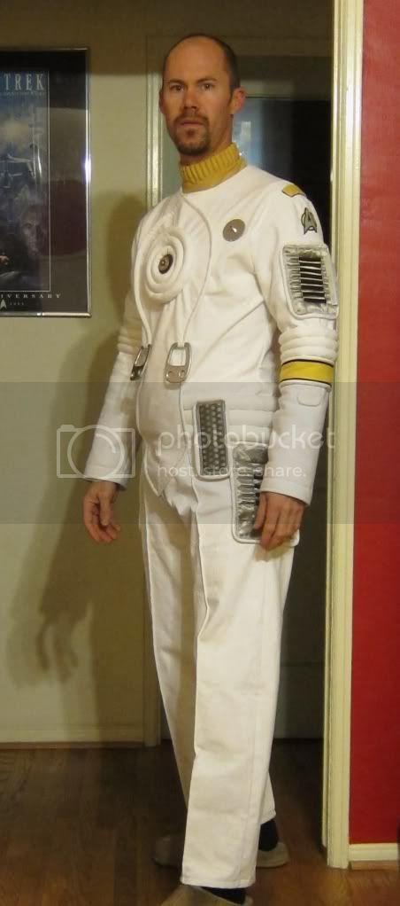

So here's where we are now- the jumpsuit is pretty much done:
I'm thinking all that padding at the hips is making me look fat. The solution to that is usually to pose with a phaser...

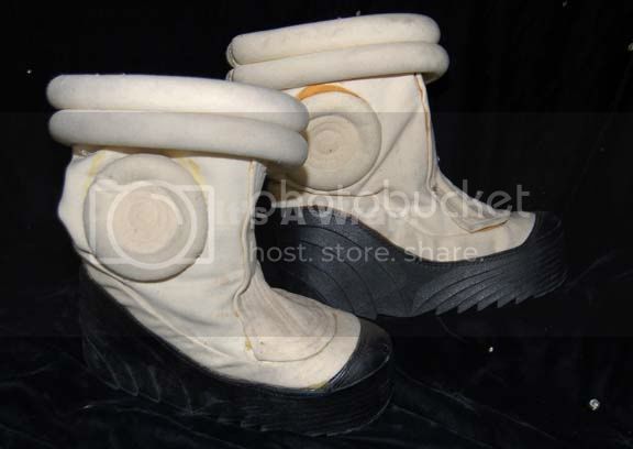

I'll also need to make the boots- here's the target:
It seems like the best approach would be to do what I (believe) they did for the films- find some early '80s moon boots and cover them with material, piping and those circles. But I have not had any luck on ebay or etsy finding any in my size yet- any clever ideas here are welcome!

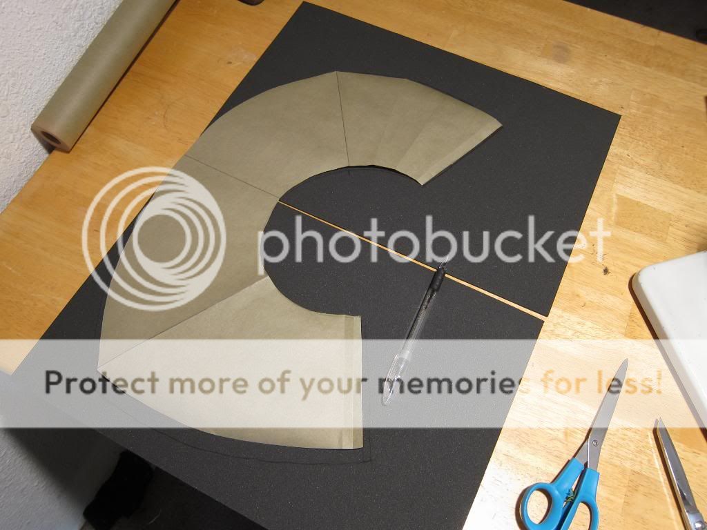

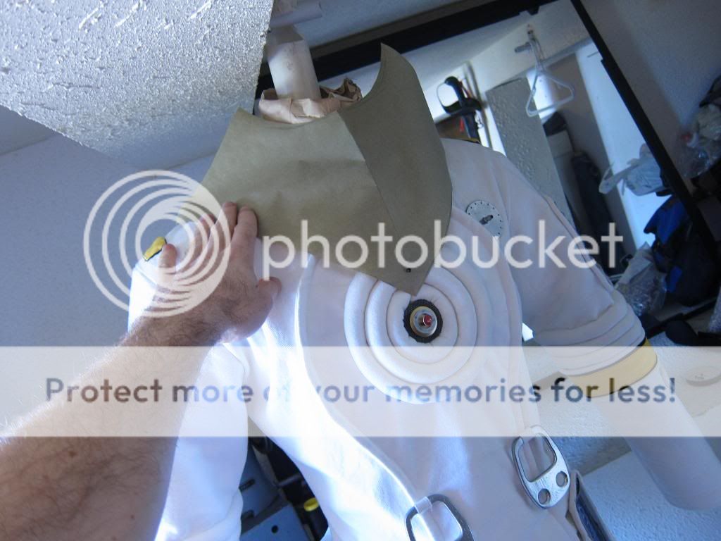

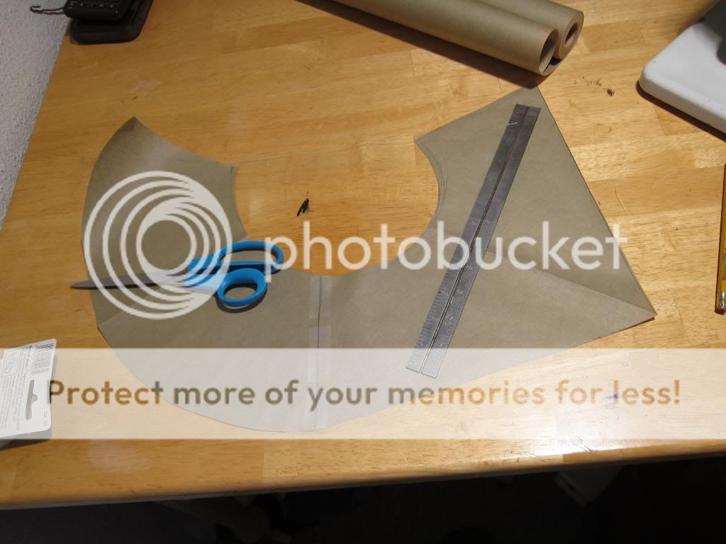

While waiting for my neoprene I got a little bit more done. I made the pattern for the neck part-
And then used it to make a Foamy mockup to test how it lays on the costume.

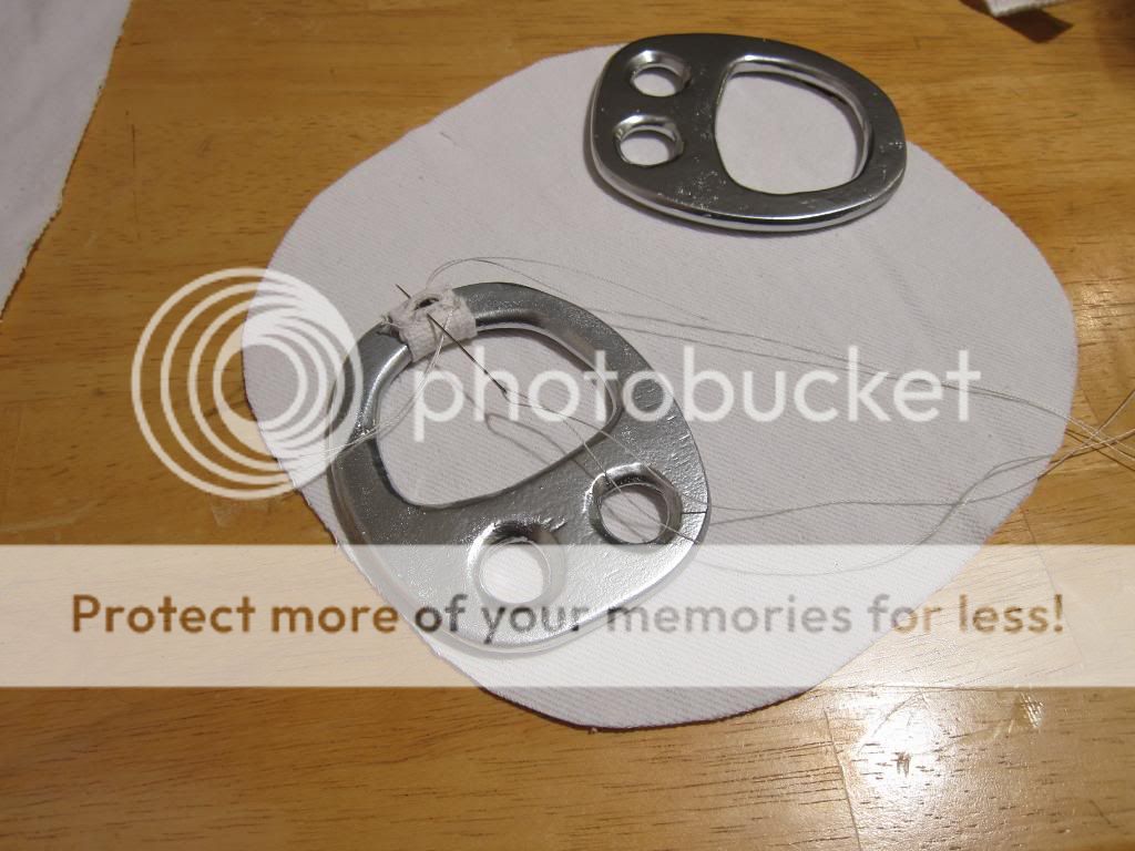

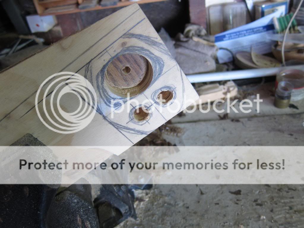

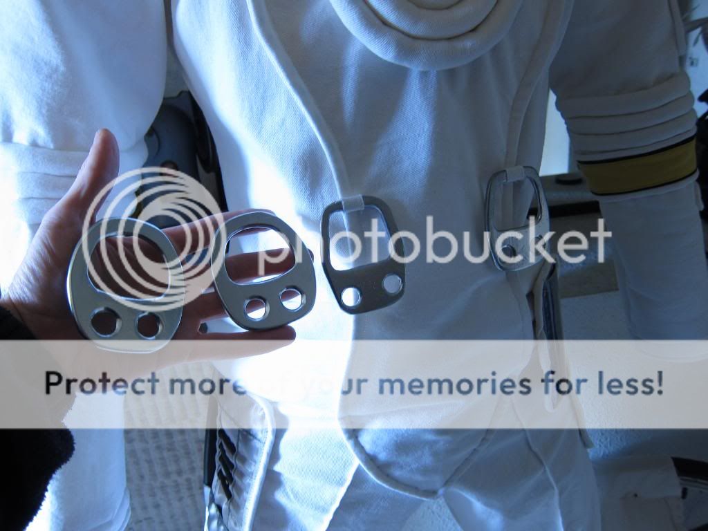

I also convinced myself that my climbing harness loops were not convincing enough looking, so I did a second version of them.
The new shown with the old:

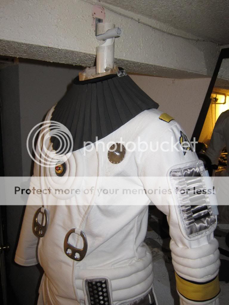

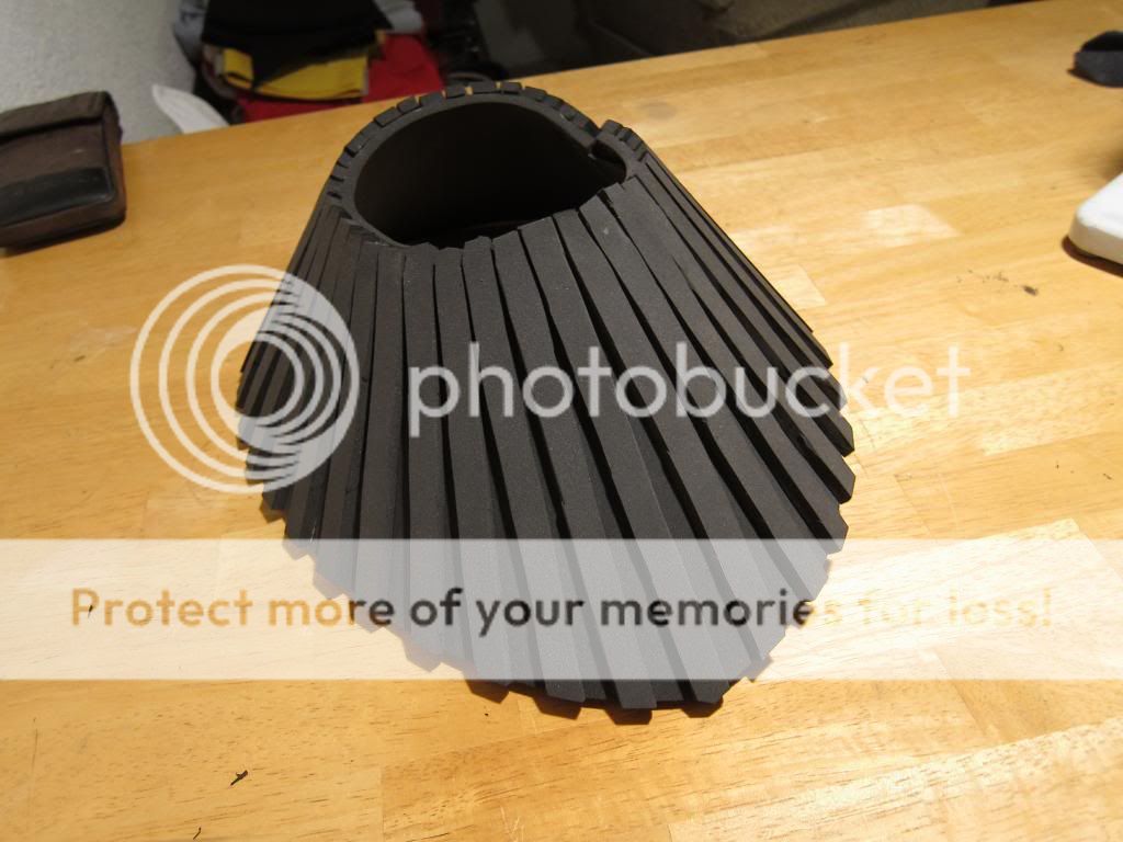

My Neoprene arrived!
So, I've been working on the neck part.
It took a couple of tries to start to get things scaled in right. Pretty much, it's just a big hunk of neoprene, with a whole lot of neoprene stringers glued on, and a velcro closure on the left side.
You spend a lot of time gluing when you do this. I use contact cement, which works really well. (But don't put it in the wrong place, the neoprene comes apart if you try to un-glue it... ) Make a point to keep the windows open with this stuff- (Special Lady hates the smell...)
And that was it for the TMP version. For TWOK, they added a cloth neck roll at the top, and a plastic clasp of some sort.
I haven't figured out what they used- so far I'm going with a piece of plexiglass and some Chicago screws....
So we end up looking like this:

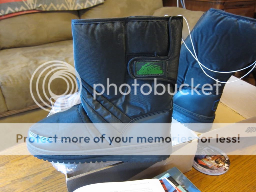

My cheapo moon boots arrived!
They are not bad. I put them on and wore them for an evening- they fit decently and should work well for costume boots.
So I immediately took them apart!
They are clearly very cheaply made- but that's perfect for this project, as I don't feel at all bad completely dismembering them.
Now I'm making patterns for the white coverings- that will be followed by making the poofy fake trapunto details- and it will all end with tons of hand sewing, to re-attach the uppers to sole...
