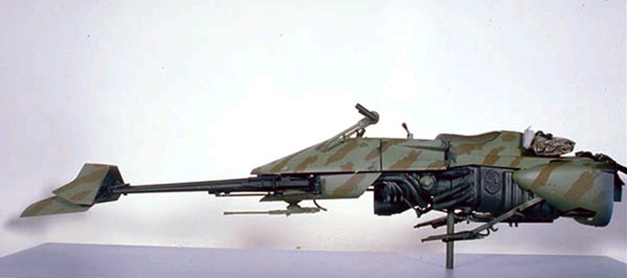

But we all know how accurate "officially released info" actually is. I did a very quick measurement. I scaled up the sideview with the ruler to actual size and imported the 1/12 312T kit scan and scaled it up accordingly.
From the side view I get a total length of 82,4cm or 32,42 inches. The actual nosecone from the 312T, although correct in shape and detailing is too small by a factor of about 2. So unless there were 1/6 commercial kits available at the time, they scratch built at least some of the larger parts for this model.

Id have to agree with Jay, the parts are too large to be donors from the box Marvin.
That back end is BT46 Brabham, and way too large to be the actual kit part bodyshell.
I think a search for larger kits will be futile too, they seem to be all modeled off the Tamiya parts, as i said, its pretty much spot on what they did with the A wing, modeled off the F14/F16, and scaled up by hand.
lee
Yeah I agree too. Parts are way smaller than the filming model. Fun to see that they really did stick very close to the original kit parts. Took little artistic license when they were upscaling. Guess I'll be vacforming these parts then.
