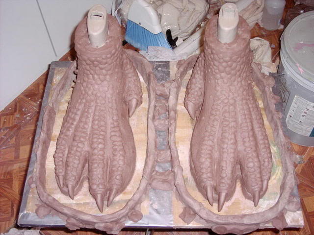

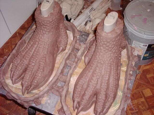

Yes it is possible. Sculpt the foot a little bit high above the ankle. Then mold it in 2 halves. I have done it.
What I would do is stuff the Tabi's full of newspaper or something to make it hold its shape well for when you add clay to it. Then wrap them up with a cling type plastic wrap or possibly foil. Then sculpt away. Or if you want to avoid the sculpting part, I have seen people use claws from monster hands and glue them on the shoe and then blend them into the shoe with latex and tissue,cotton whatever.

Chuck, you never cease to amaze me! Too cool! What is the white thing hang out?
Now, for example, they're sculpted what's next? I've never done any of this before.
But with your and Mel's help, the new one will make my old one like crap.
The parts sticking out are mannequin feet, I didn't have casts of my feet so I used those.
After the sculpt is done seal the clay with crystal clear and mold them with ultracal.
