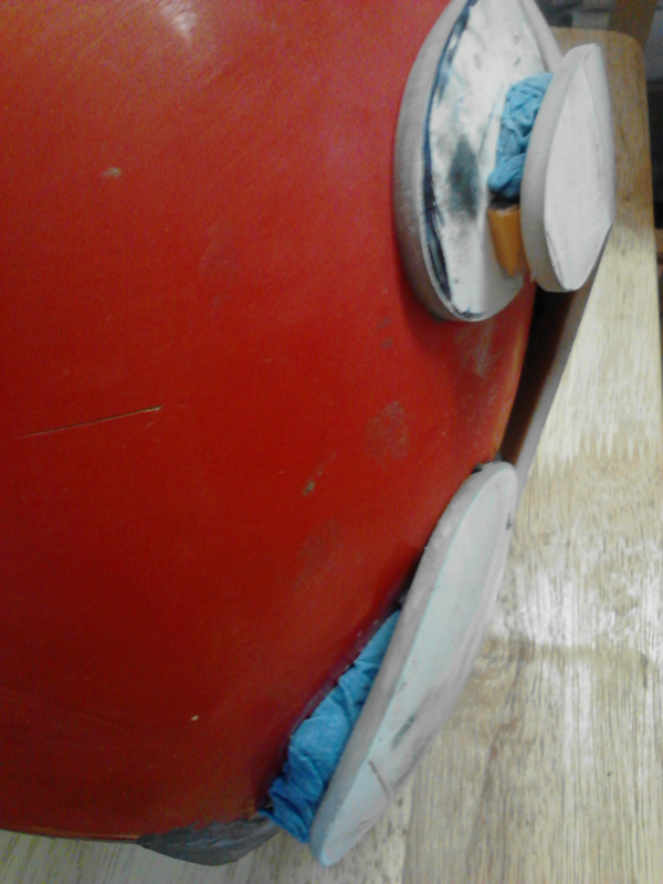

Now we get into some weird... Pencil spacer:
And then I started to bulk things out with a white glue/water mix soaked into blue shop towels. The shop towels soak up a ton of the mixture and set up almost as hard as fiberglass. More importantly, it's light.
