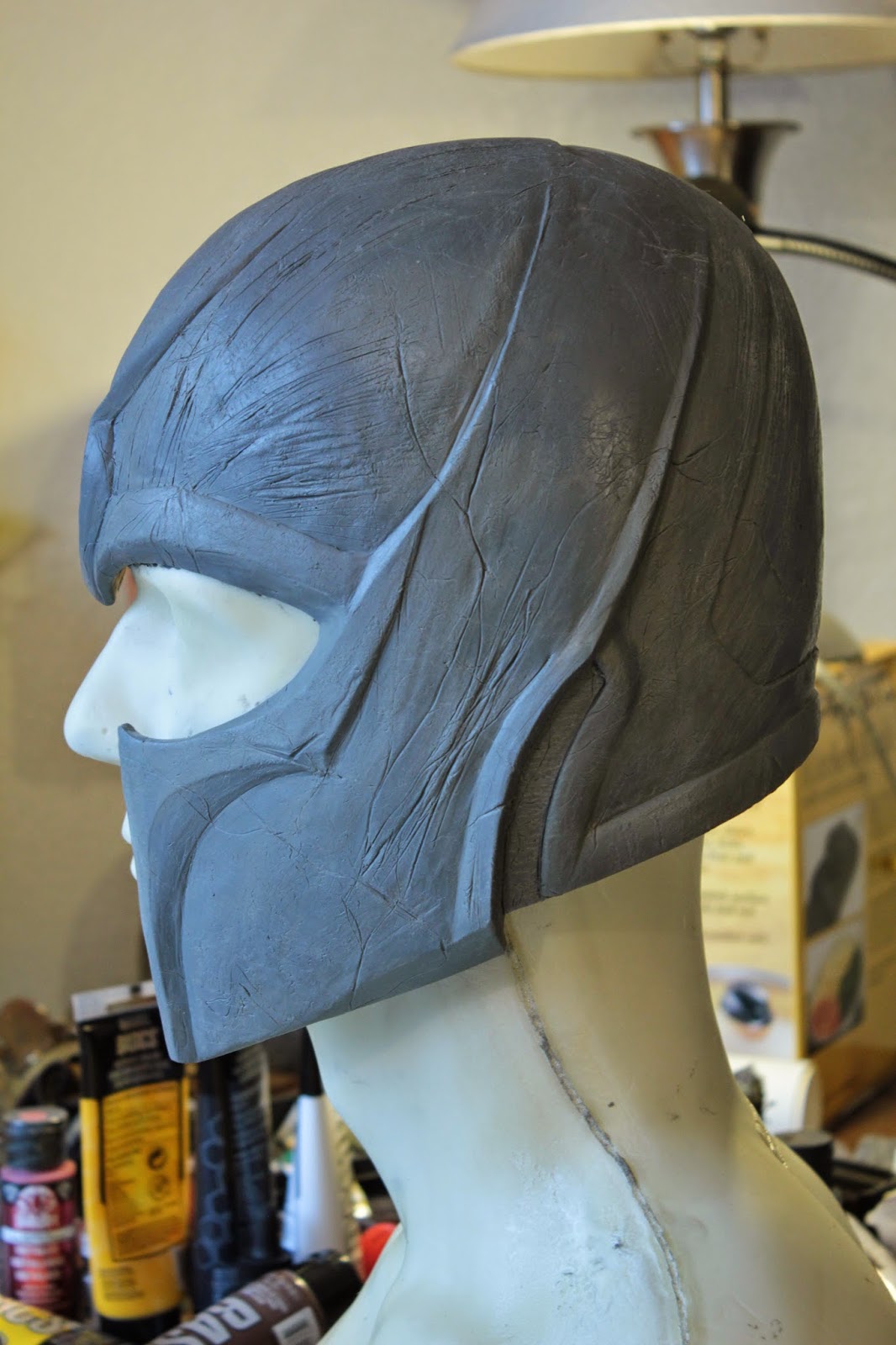

Completely irrelevant by now but I've still been chipping away at this some more in my free time. Some slight reshaping and hacking for the most part but there are some added/refined details. I think I'm happy where it's at right now; I thinking of adding the cracks and scratches next. The surface is semi-smoothed but being the original idea that Magneto made this bucket from various metals, himself, I think a somewhat uneven surface is a nice touch.

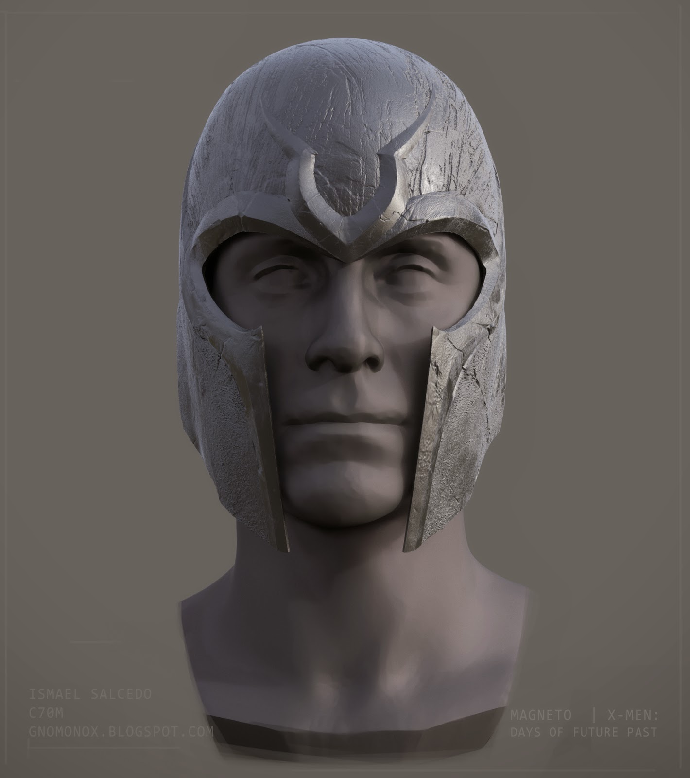

Here's some comp pics of the bucket with the reference pics I'm using (straight from the original designer, himself).
Ismael-Salcedo_Magneto_3D_Print_Helmet_o.jpgIsmael_C70M_Magneto_XMen_DoFP.jpgIsmael_C70M_Magneto_Sculpt.jpgIsmael_C70M_3D_Magneto_Final.jpgIsmael-Salcedo_Magneto_Helmet_o.jpg

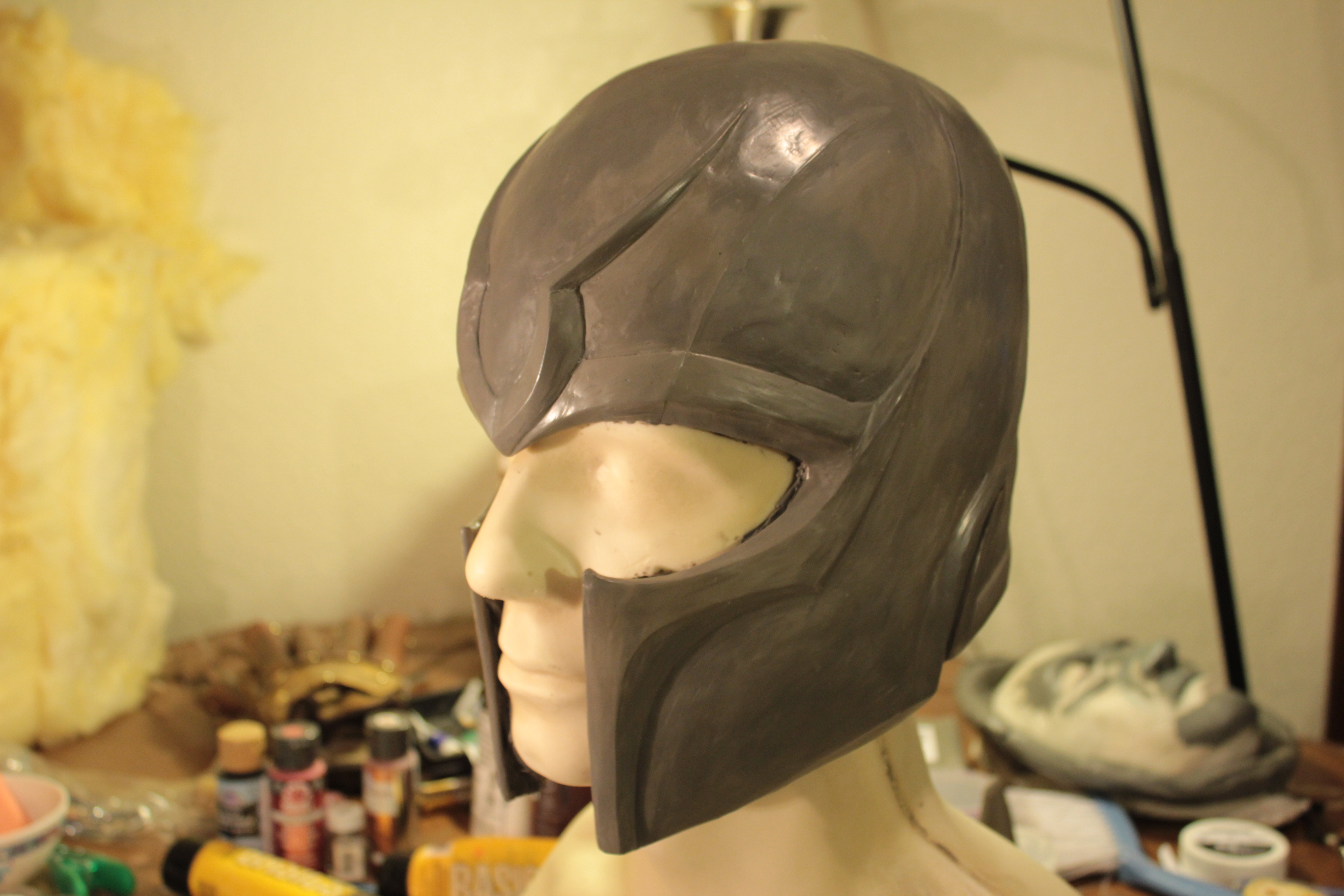

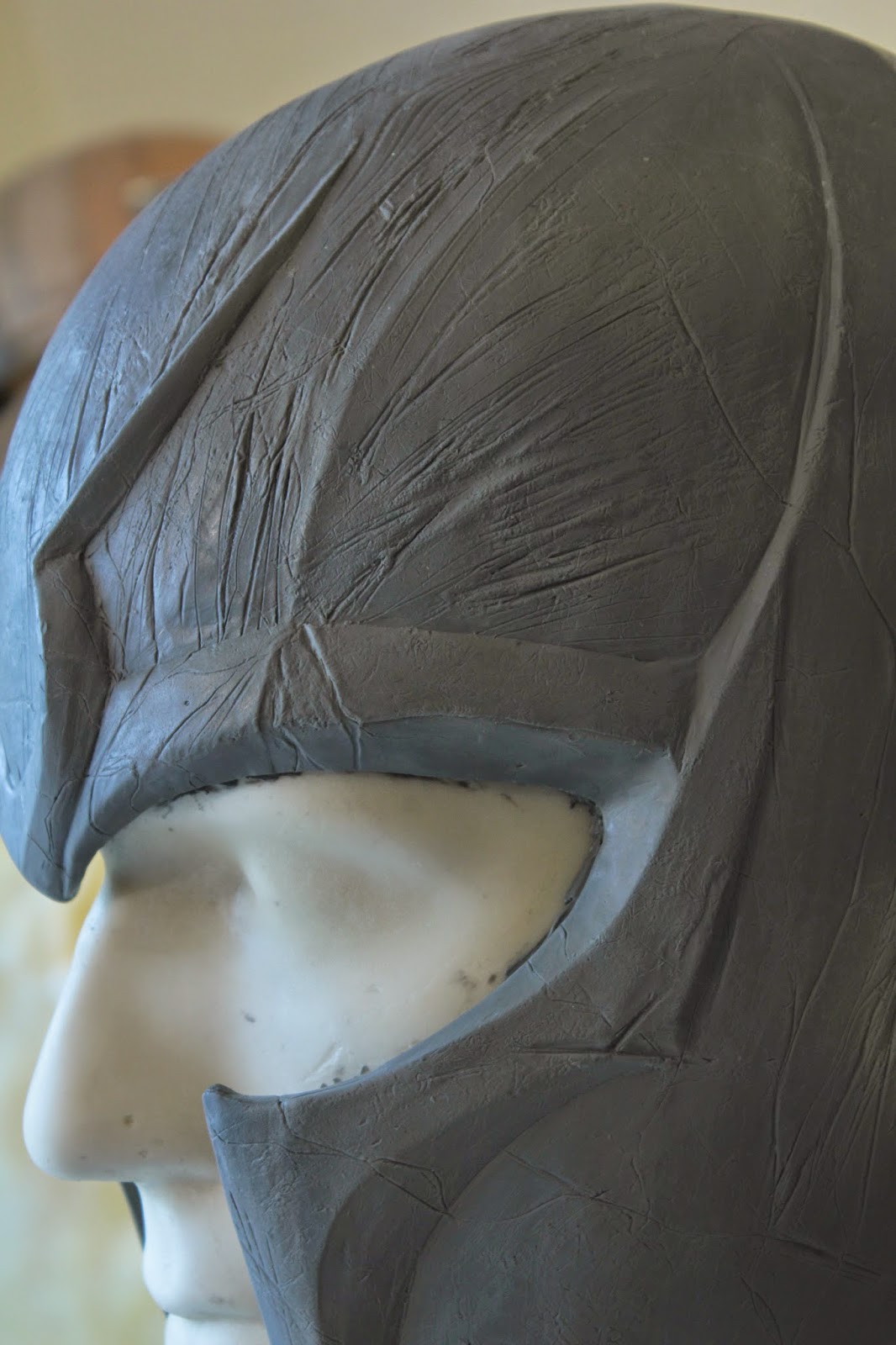

Finished the detailing last night with surprisingly relative ease. Now, with better reference material, I think it came out better than the first time I did this!
PICS!
001.JPG 002.JPG 003.JPG 015.JPG 004.JPG 005.JPG 006.JPG 007.JPG 008.JPG 010.JPG 011.JPG 014.JPG 016.JPG
Onto prepping for molding! Again!

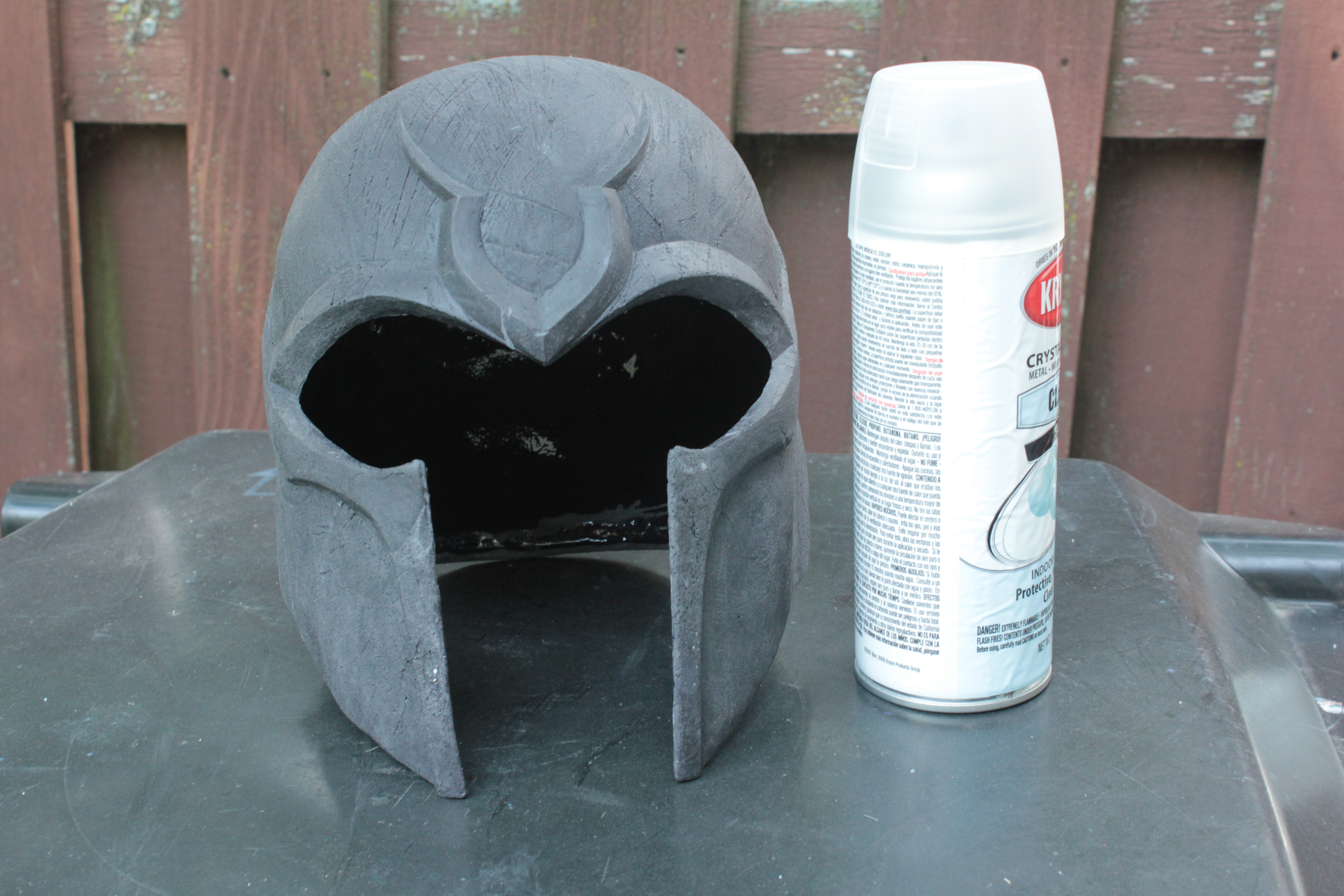

Alright, some updating. Got a little more touch-ups to go through before I sent this thing to molding.
First off, refined the emblem some more. Shortened the wing flare things and added the little hooks in the center where they meet, and tapered it a bit more.

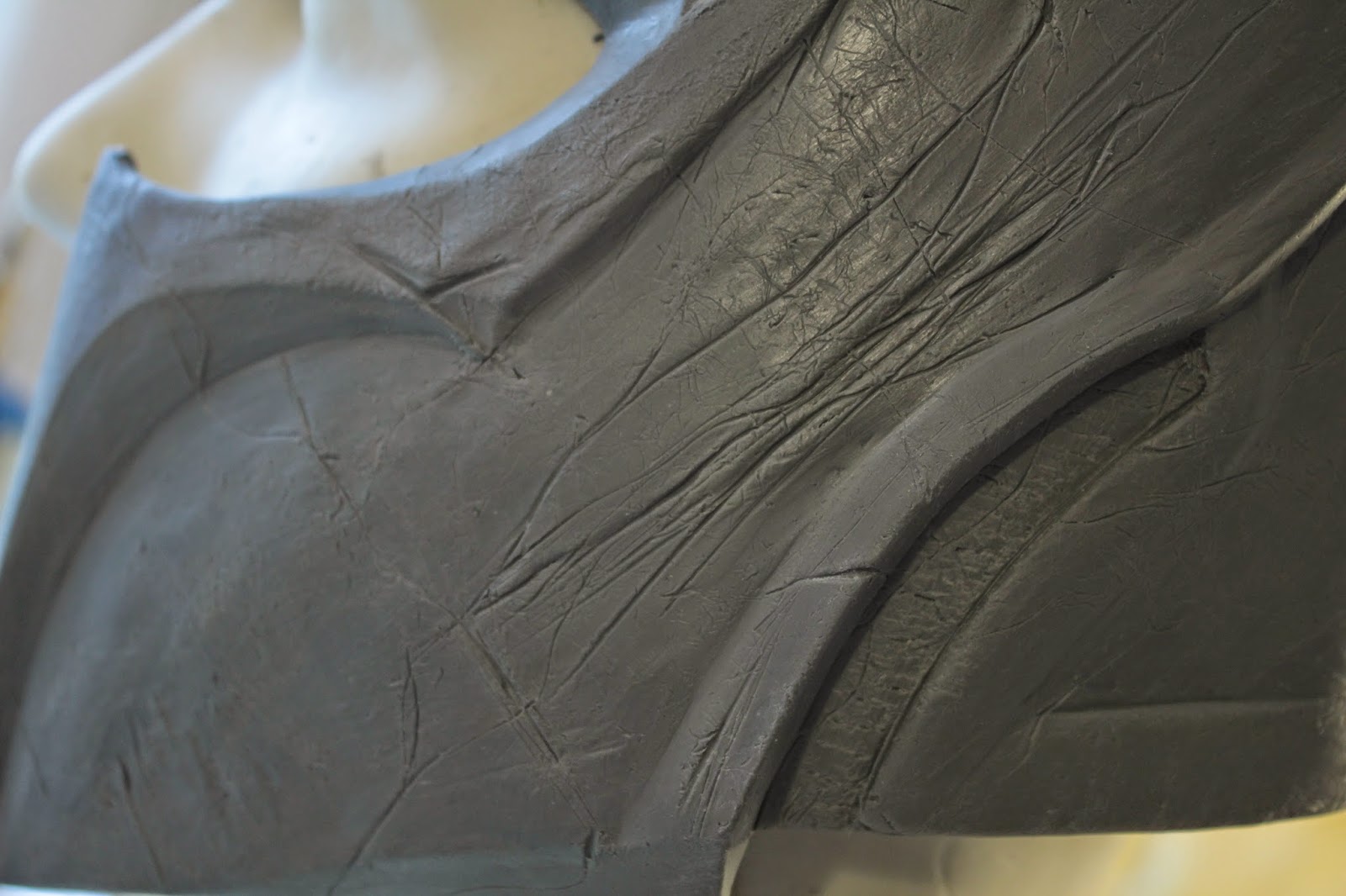

Added the undercut for the bucket and also for the ears (which got a few touch ups, too).
The back got some love, too. Though I snapped the photo at an odd angle that makes it look off.
Here's where it stands currently. Filled in the face and then that's when it's okay to mold. Three layers on it right now (or one whole trial kit), need to add the keys and then another layer. After which, mother mold!
It's getting close, kids! Again!!

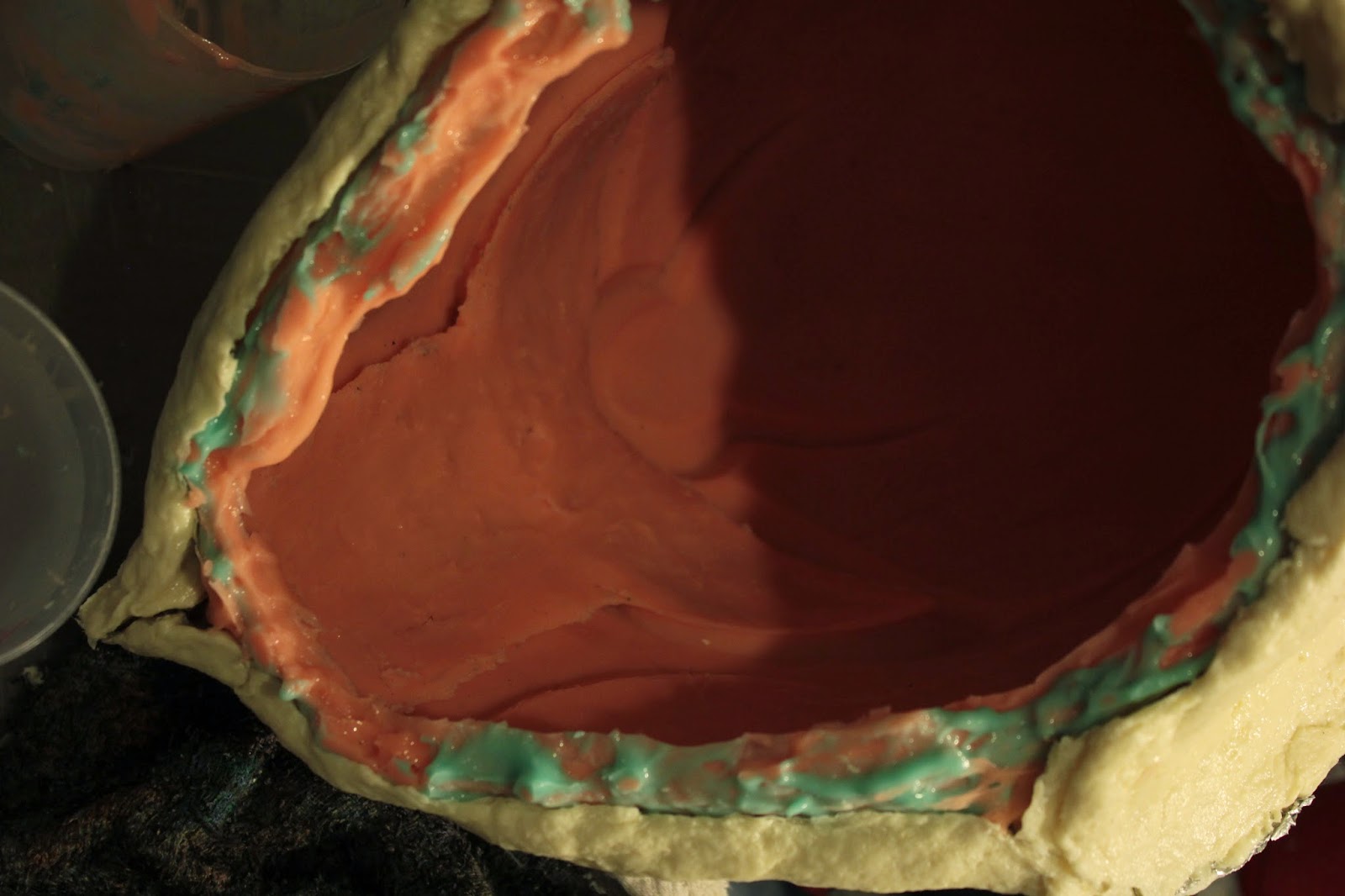

Been a busy bee with some free time I've got recently and have managed to finish this project. Almost, anyway. The buckets are currently airing out the crystal clear but to catch ya'll up to speed:
1) Molding and fiberglass jacket applied. I separated the jacket into three sections so it'd be easier to de-mold; a first for me to actually think ahead in a project like this.

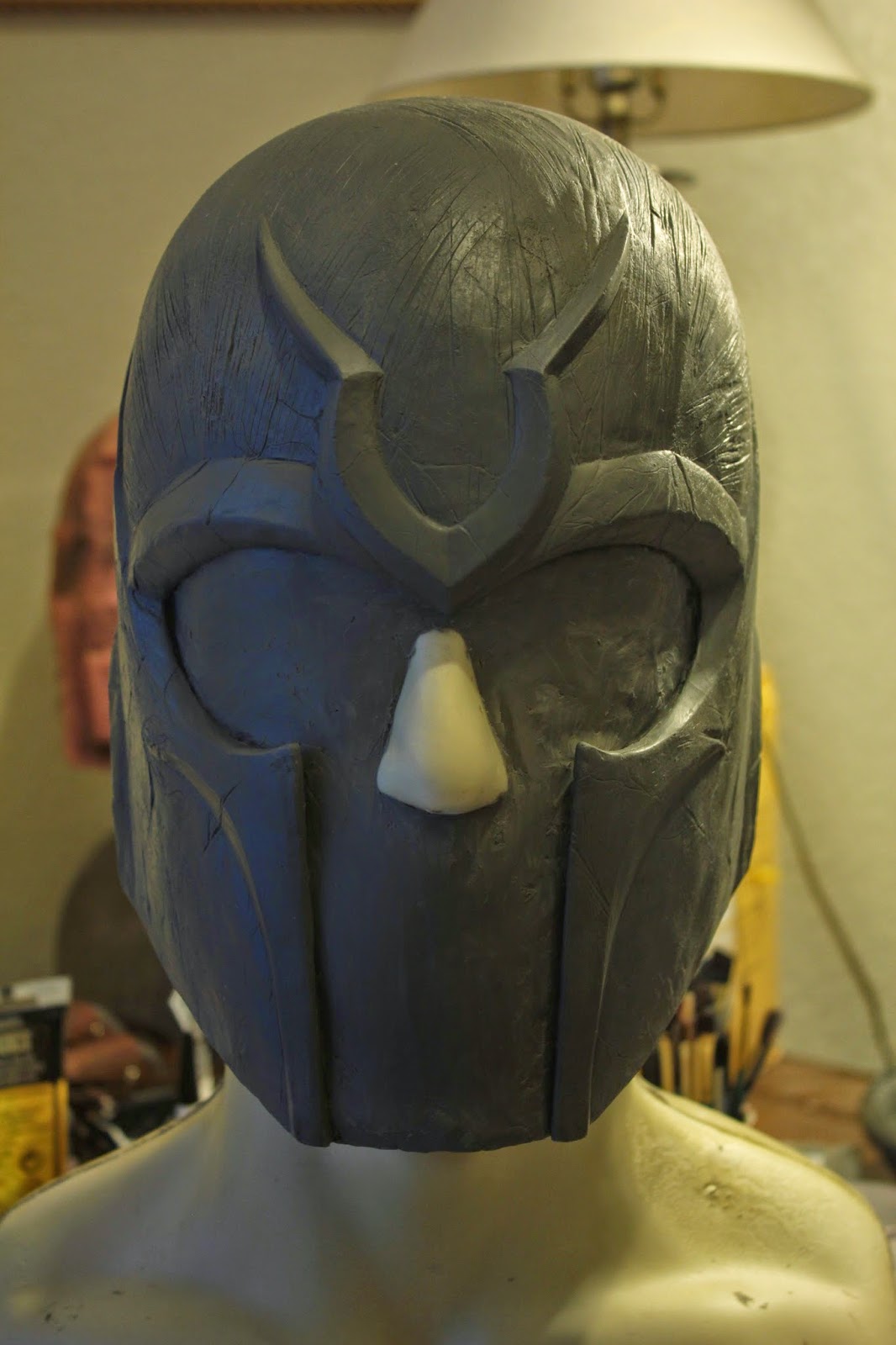

Original sculpt demolded and everything is sexy! So fresh and so clean to where the sclupt survived untouched! Another first! Plugged up the nose with left over silicone to spare resin.

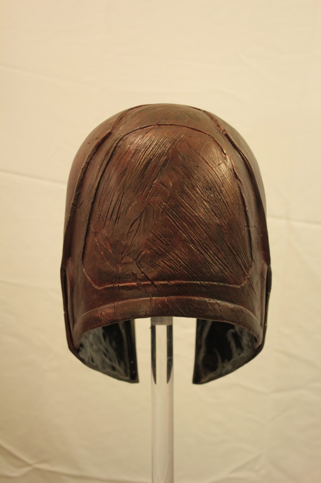

It. Is. DONE! Quite a frustrating process to get to this point but a very educational one, nonetheless.
Painted in acrylics, a mixture of red-metallic, brown, "berry wine", copper, and sealed in a satin finish. No reference was used for the color; all from memory (I've stared at the bloody thing long enough).
I hate saying anything I do is accurate or the "best" but this could possibly be the most accurate fan reproduction of this helmet out there, now that this is done. Of course, that only means something to any who cares about this sort of thing, which I'm sure there are only few of now.
PICS!
