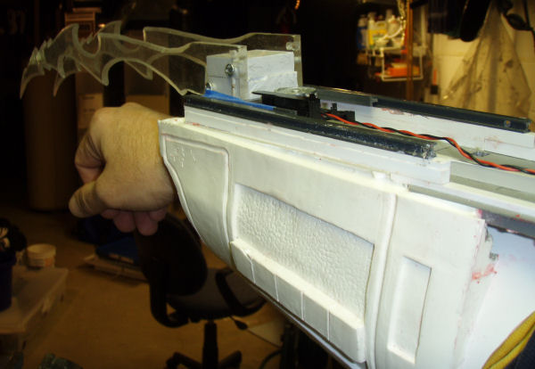

I got the idea to build a motorized mechanism to extend and retract the wrist blades using old computer parts. I initially tried to do it using parts from an old inkjet printer, but that didn't work out all that well. So, my friend Paul let me take apart some old, dead CD-ROM drives that he had laying around. The tray eject motor and its gearing work well to propel the blade out reasonably fast, and the teeth on the bottom of the tray provide the track for the motor to work against.
So, here's my gauntlet, showing the track on the top. I've actually mounted the teeth from two CD-ROM drives so it'd have enough forward/backward range.
Here's another picture with the track and the wrist blades. I took the motor and gearing out of the CD-ROM drive and mounted them on a block between the blades. The motor moves with the blades, while the track stays fixed.
And here's the result, with the wrist blades extended.
(Oh, and when I say CD-ROM, they could have been dead CD-RW, DVD-ROM, or DVD-RW drives. I forgot what was what after I finished whomping on Paul's pile of old, dead electronics. )

Thanks for the youtube video,really impressive.I do have a question about your wrist blades.What thickness of plexiglass did you use?And about how long are they?
thanks,Daren
Elkman
The Plexiglas is 1/4 inch thick, and the blades are about 16 inches long plus the amount required to attach them to the white block.

That looks way cool.I have another question about your wrist blades?Do they taper at the tops and bottom?Also where the blades have the notches,are they tapered there as well?I have been trying various methods to make a set and have been running into a wall,and yours turned out really cool.

The blades are tapered at a 45 degree angle on both the top and bottom. I used my Dremel tool with a cutting tool to cut the original blade shape out of the Plexiglas, then used it as a router with a different cutting tool to cut the 45 degree angles on the edges of the blade. (It also gave me a good excuse to go to Home Depot to get the Dremel drill press.) I had to kind of shift things around a bit to do the routing inside the notches, but it worked out.
As far as activating it goes, I'm putting two pushbuttons on the top of the gauntlet to operate the blade -- one to extend the blade and one to retract it. I also have a couple limit switches in there to cut off the power when the blade is fully extended or fully retracted.
