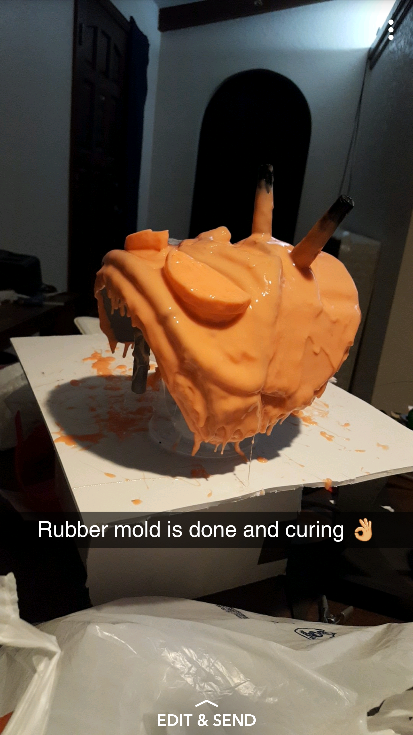

    Once I was happy enough with it, I sealed it with mod podge and a coat of primer. I then used a trial size of brush on silicone from smooth on Screenshot_20171005-183755.png

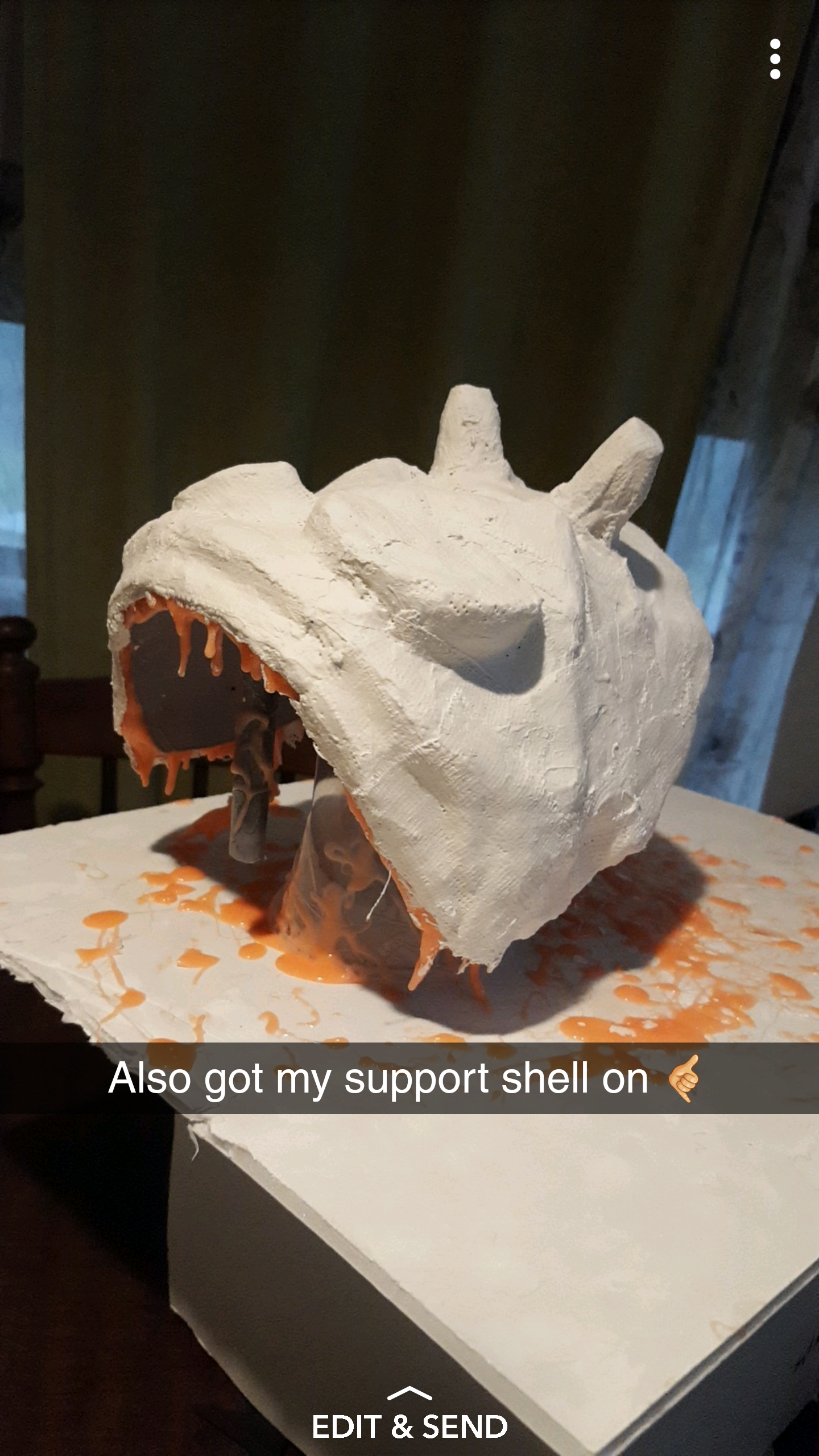

    After the mold was cured I used Plaster Bandages for the hard shell over the mold. This is my first attempt at molding anything so I chose the bandages as a cheaper and easier way of making a shell for my mold. Screenshot_20171005-183807.png
    Once it was all hardened, I split the shell, removed my model, and put it back in the shell. The mold turned out well, not a single air bubble or any imperfections that I could see.

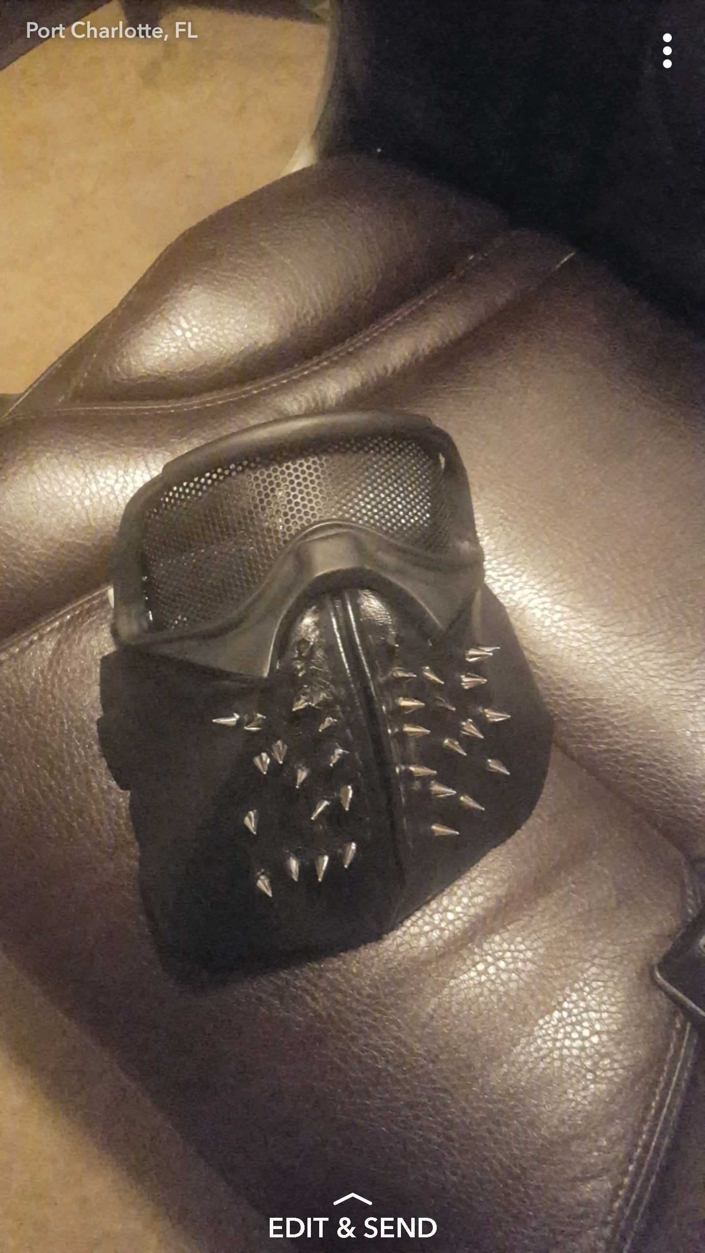

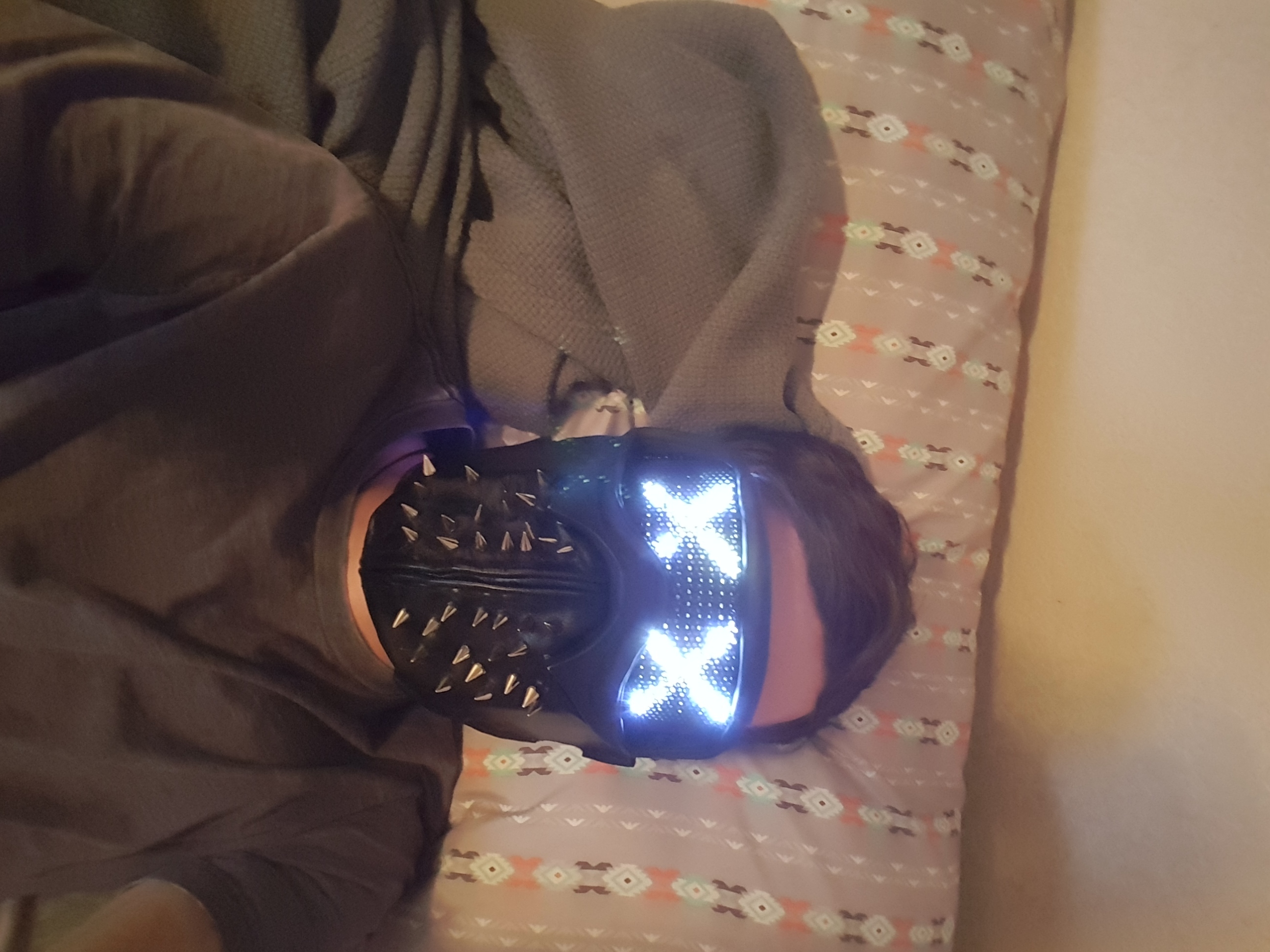

    Small update, I have most of the sewing done. I have the metal spikes attached aswell. I'd say right now the mask is 80% complete. So far it's coming together nicely Screenshot_20171008-185019.png

    I finished sewing, and installed the electronics. I have a few little modifications left I want to do before attaching the harness. But atleast it's all together and working!

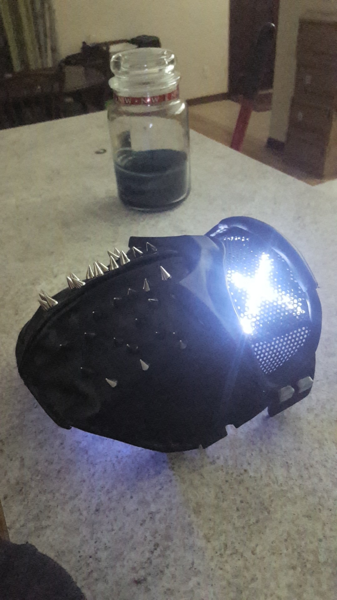

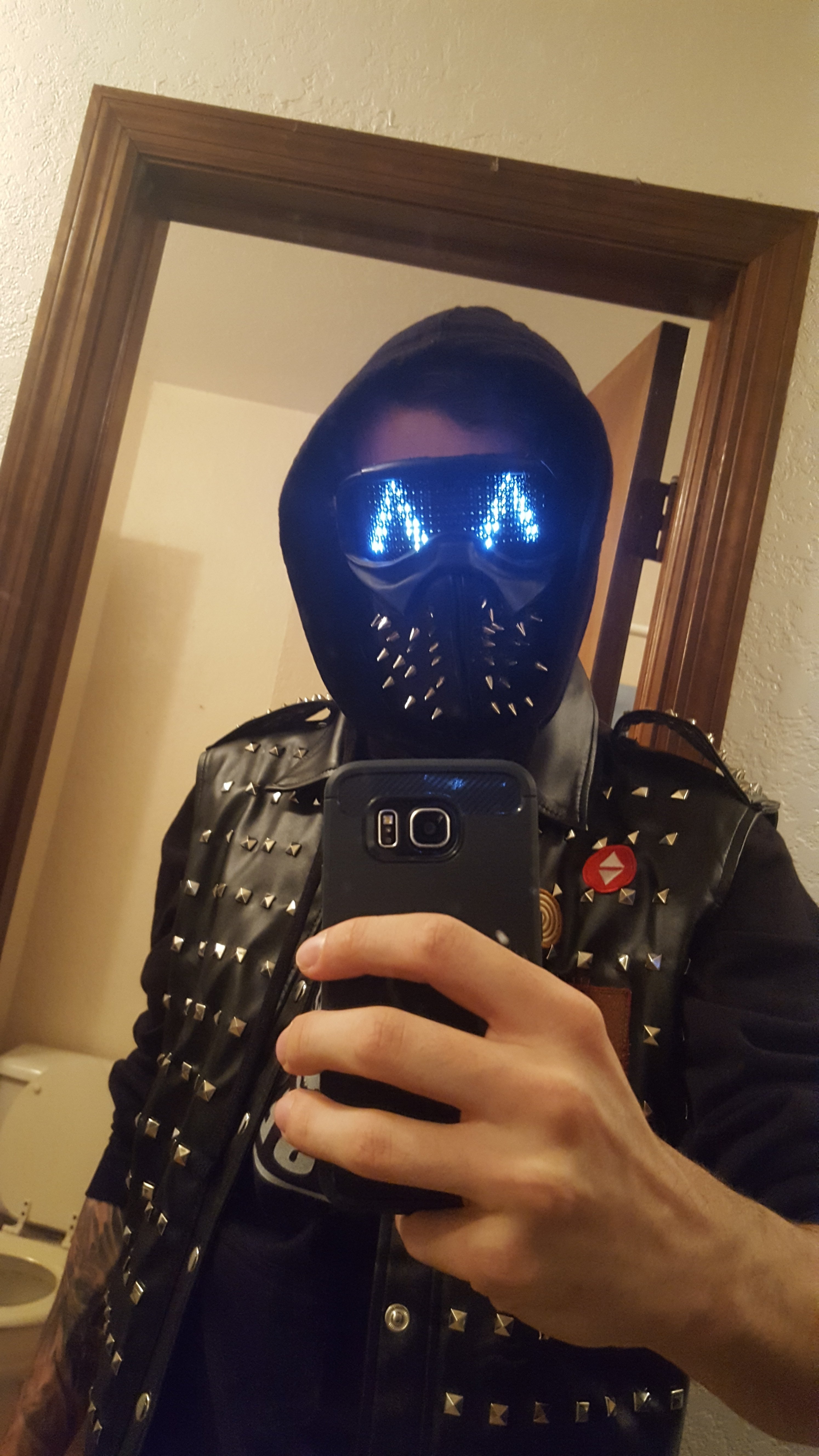

    View attachment 20171012_194641.jpg I'm still looking for something that will work for the silver bars that run along the cheeks, but the mask is done. I may just leave it as is if I can't find something to use for the cheeks.
