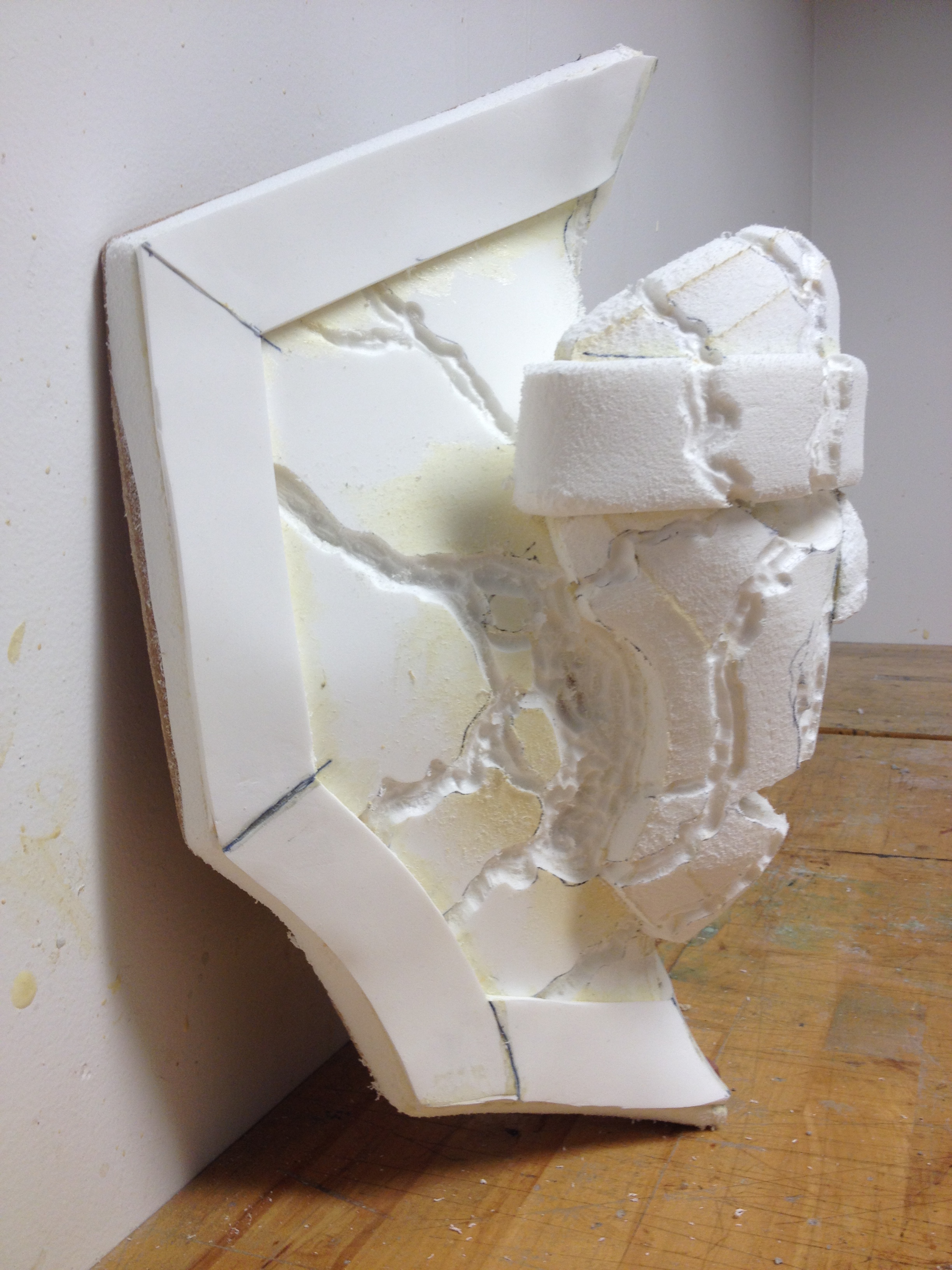

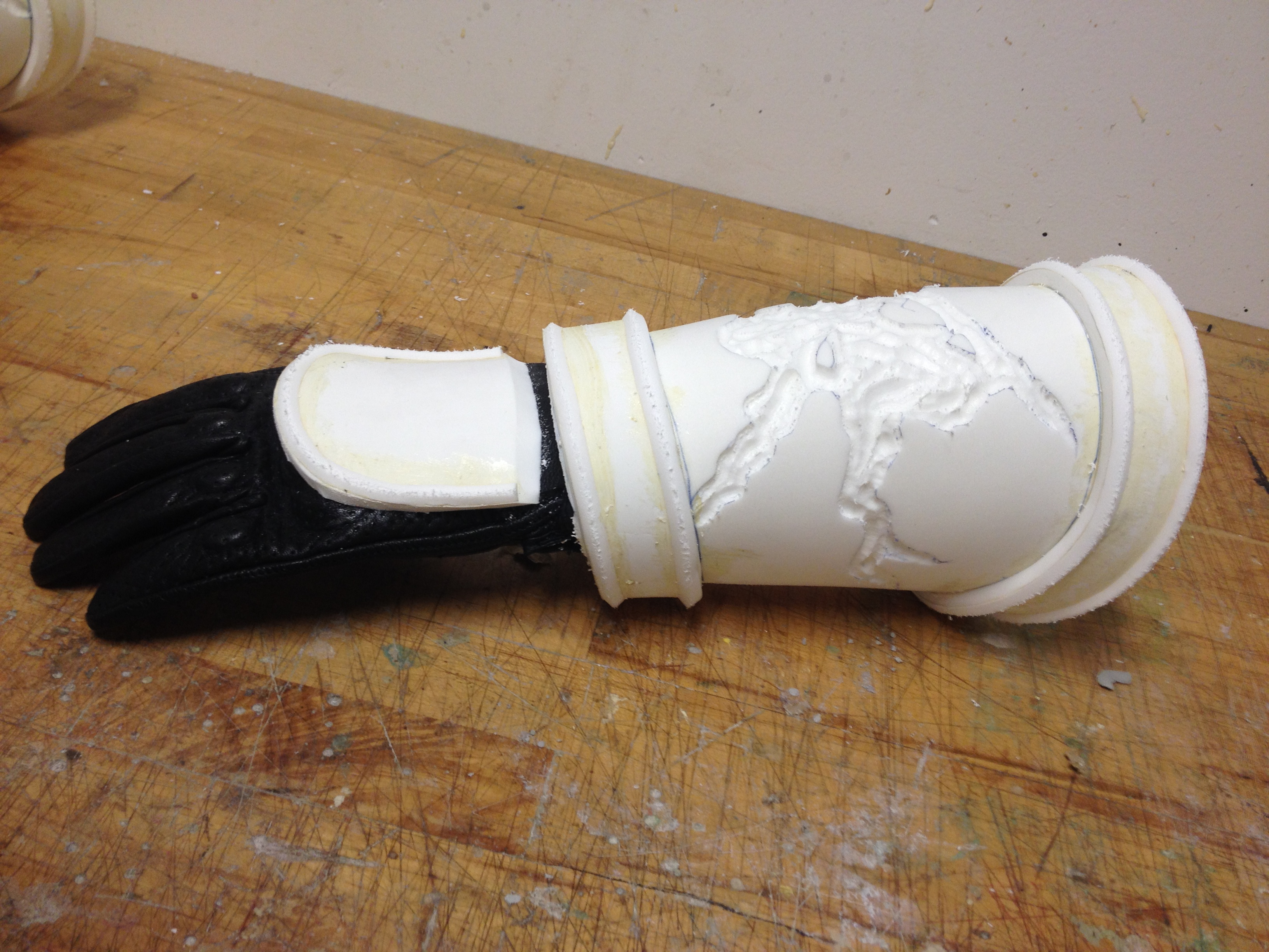

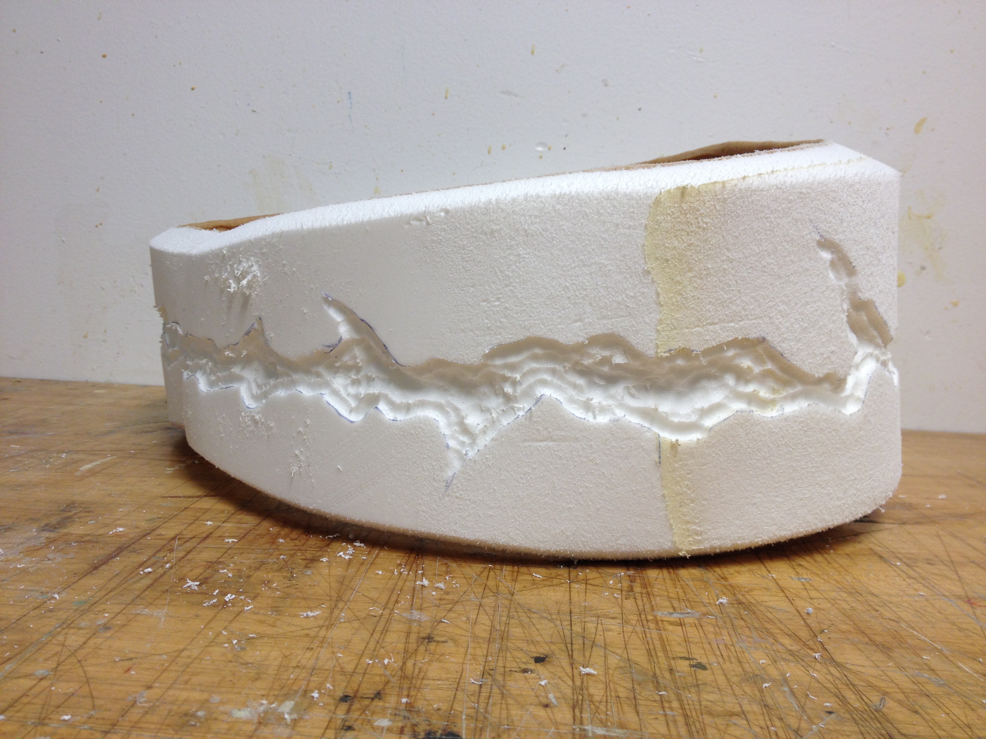

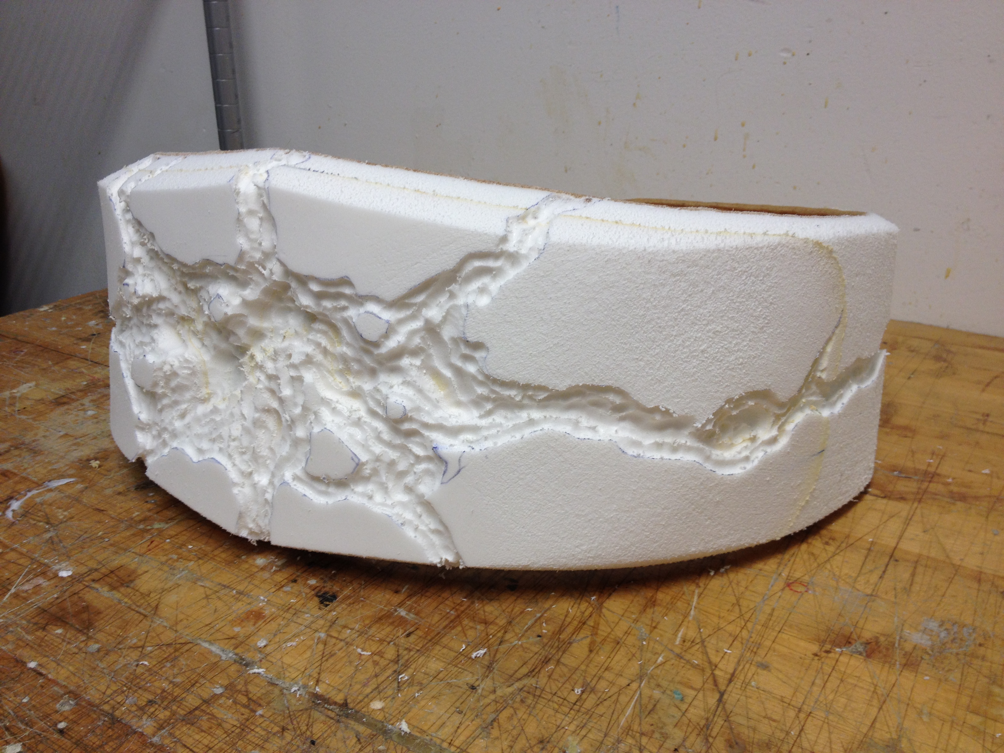

L200 foam is very similar to EVA foam or the foam used in yoga mats. I make all my own patterns for my armor and props, then trace the patterns onto the foam and cut them out with razor blades. The L200 is super easy to sand down(150 grit first, then 100 grit) to the shape you need or if two pieces need to be angled to create a pointed edge, you can cut the foam to an angle and sand it down nice and smooth. All the foam pieces are glued together with the contact cement. I have found that contact cement works best and will hold for a long, long time. All of the lava texture that was put into the Warrior armor was done with a dremel and a round tipped bit.

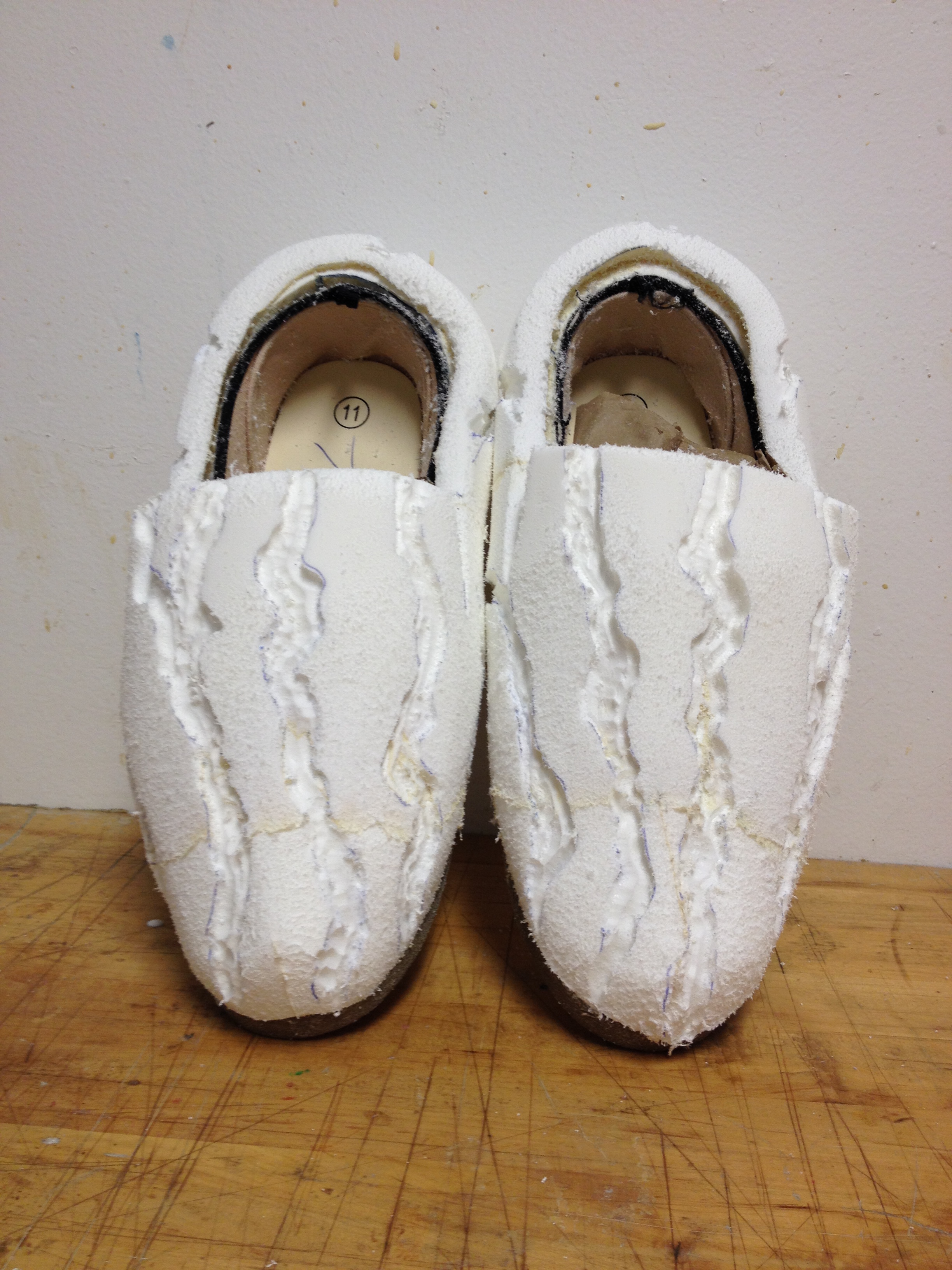

I first bought some cheep slip on shoes from Wal*Mart to use as a base. Those got covered in 1/2” L200 foam twice to build up the thickness that I wanted. After I got the thickness that I wanted, I sanded down the foam to get a more refined shape. Once everything was shapely and smooth. I drew on the lava marks where I wanted them and took out my handy dandy dremel tool and carved away the foam until It had a flowing lava look.

The belt was made almost identically to the thigh guards. I drew up a pattern, cut it out of craft foam, Worbla, and L200 foam. Did everything the same for the Worbla and foam procedures. Heated, pressed, heated some more, formed to my body, glued, carved, the whole nine yards. The only thing was that were isn’t any trim on the belt so that step is obviously skipped. One extra step that was done to the belt, was that I added some elastic on the inside in the back so that I can open up the belt a little bit when putting it on but it will retain its shape when it is around my waist.

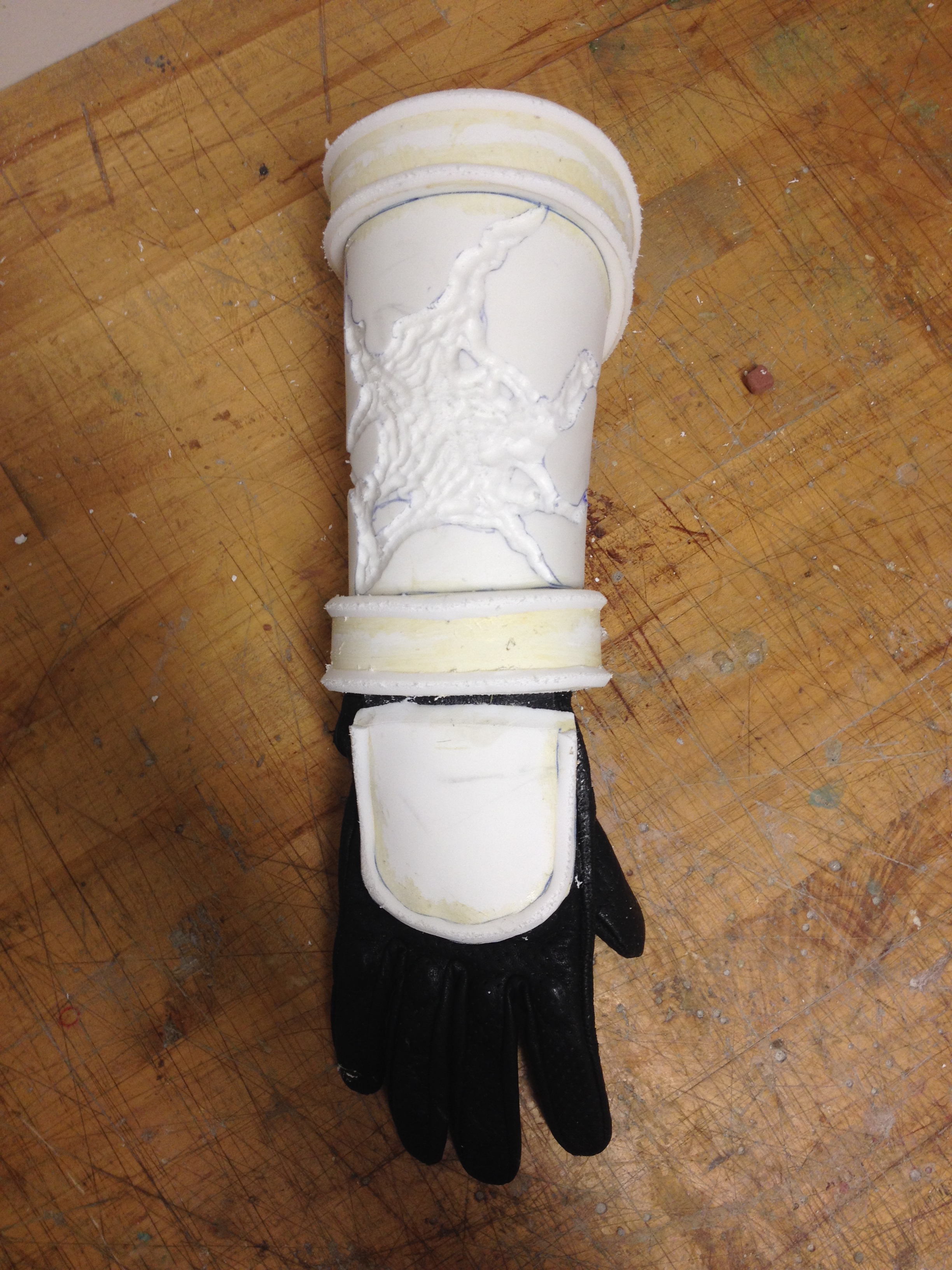

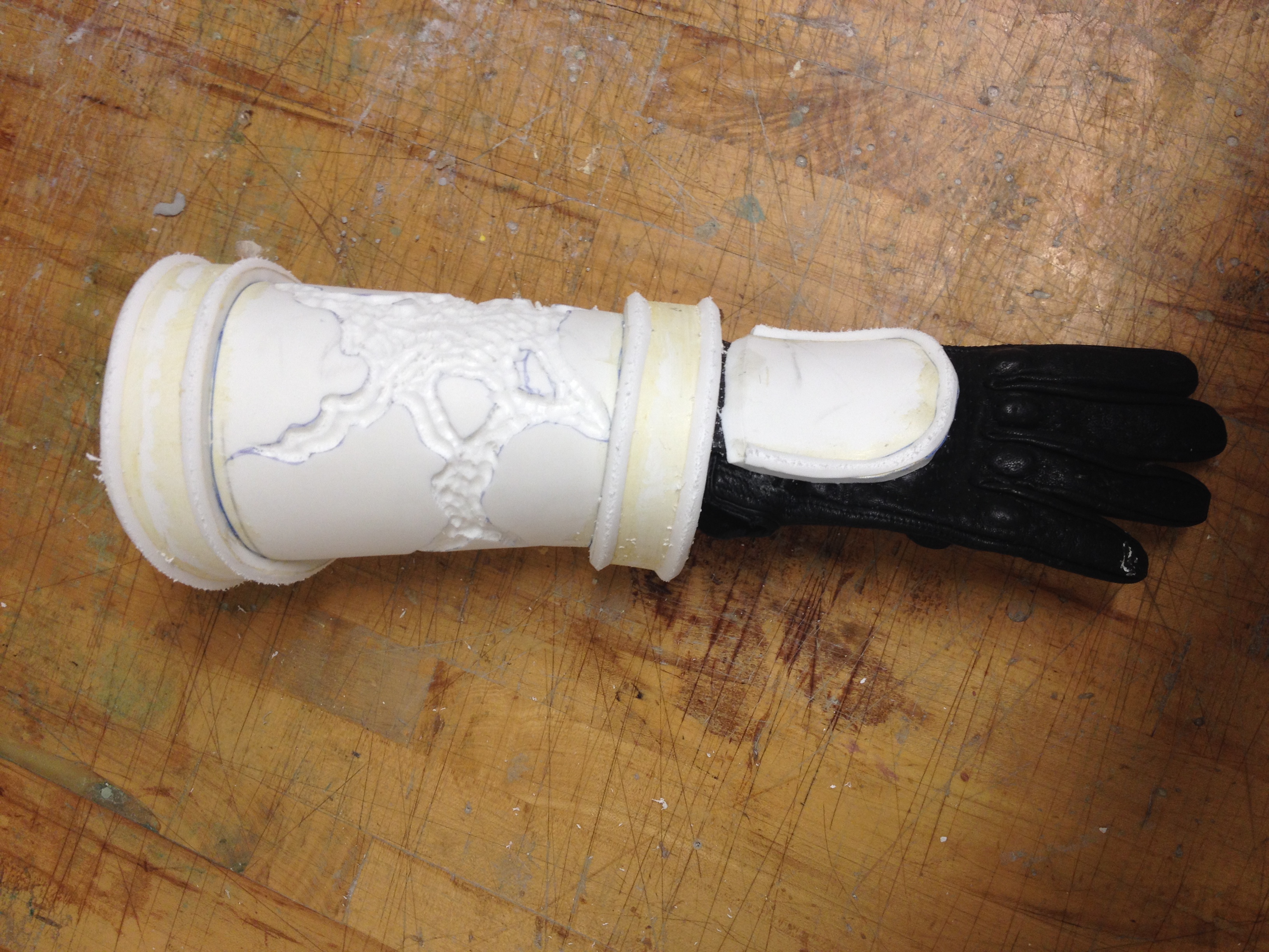

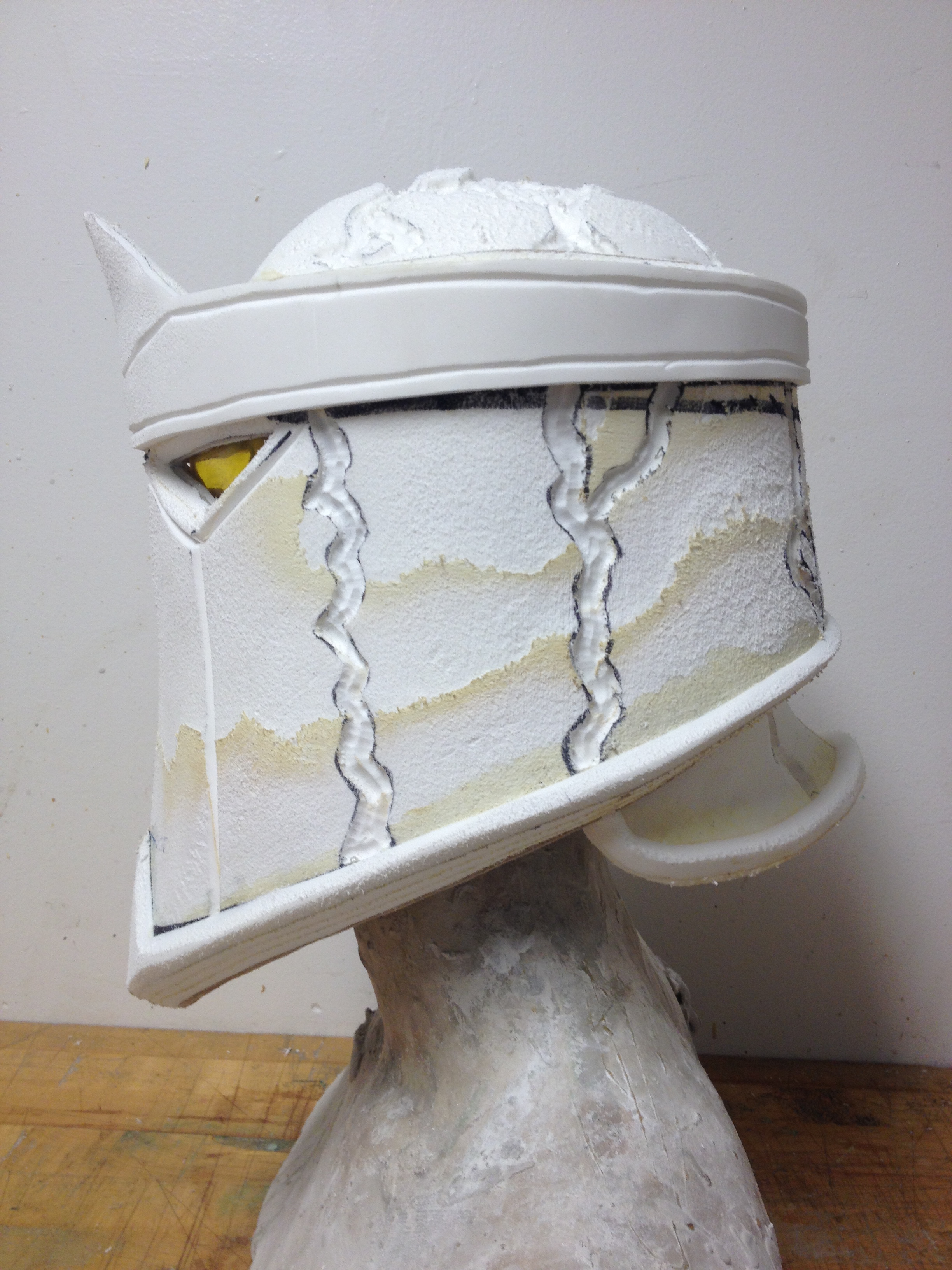

Okay, so I have been working pretty hard the past two weeks as well as I could while prepping and going to a Con. Here are some pictures of what I have been working on. I got the gloves done, helmet and shoulders. These pieces were a ton of fun to make and I am pretty happy with the way they have turned out thus far. The shoulders still need trimmed and final touches to be made all around but nonetheless, here is what I've got...

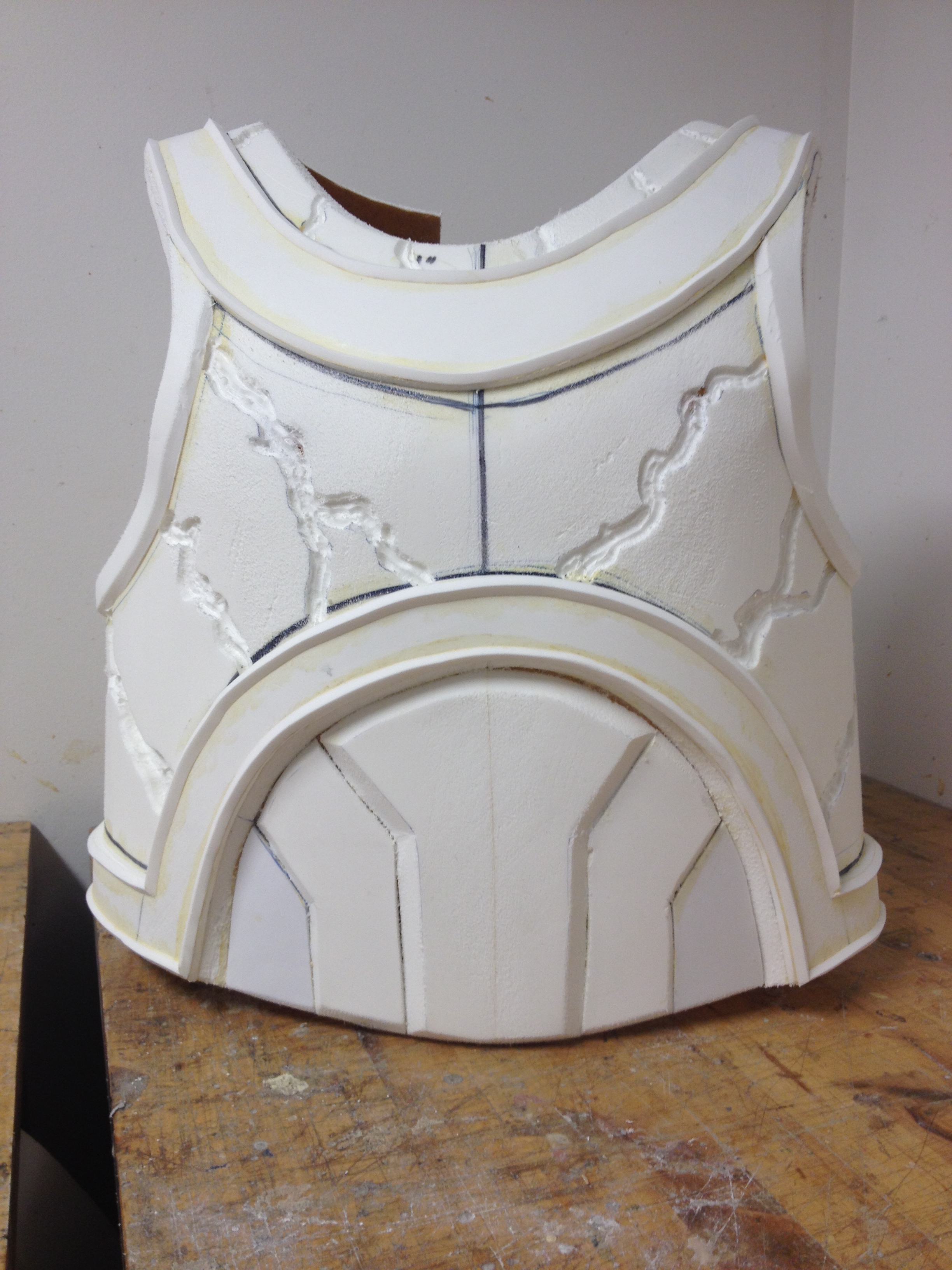

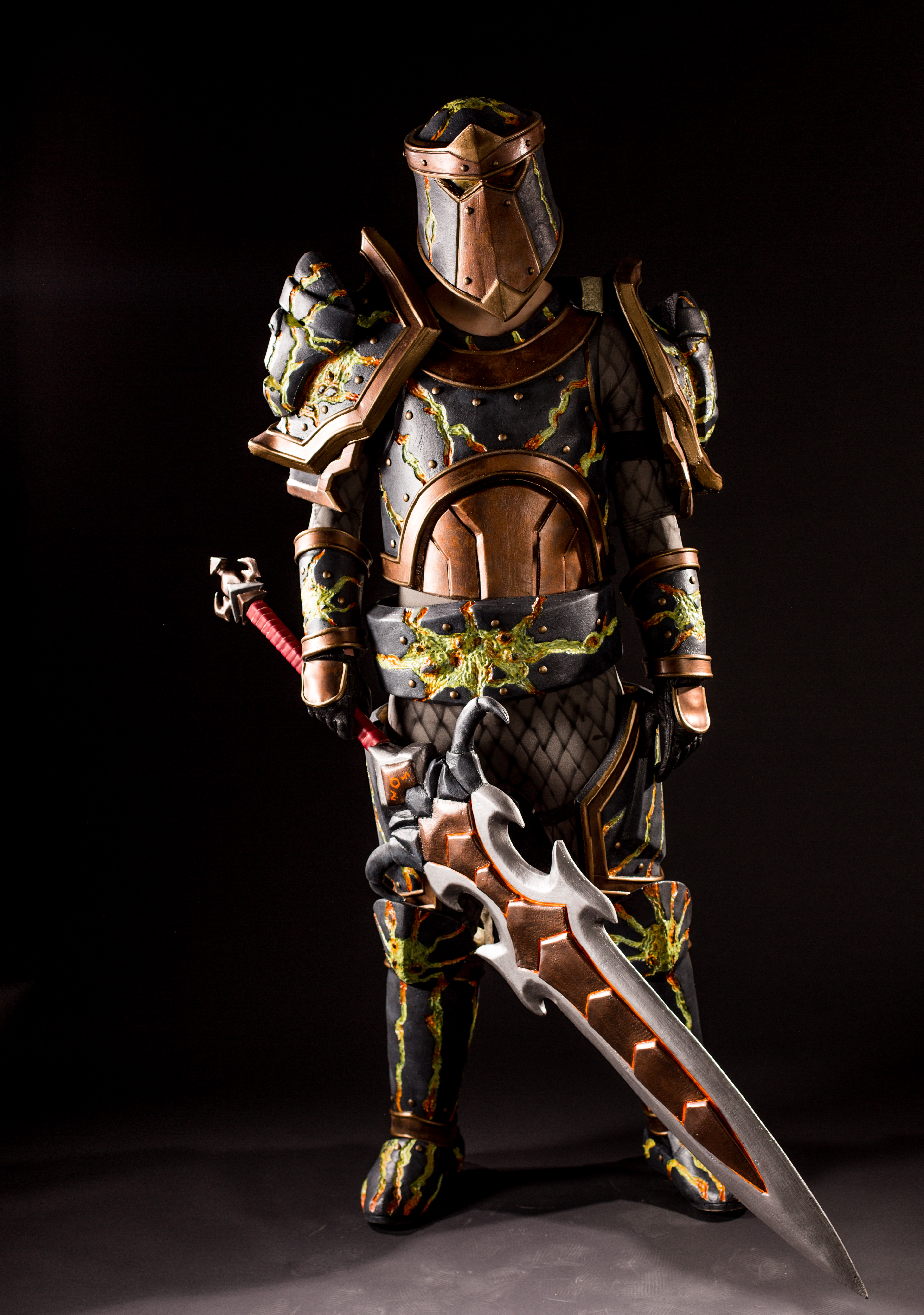

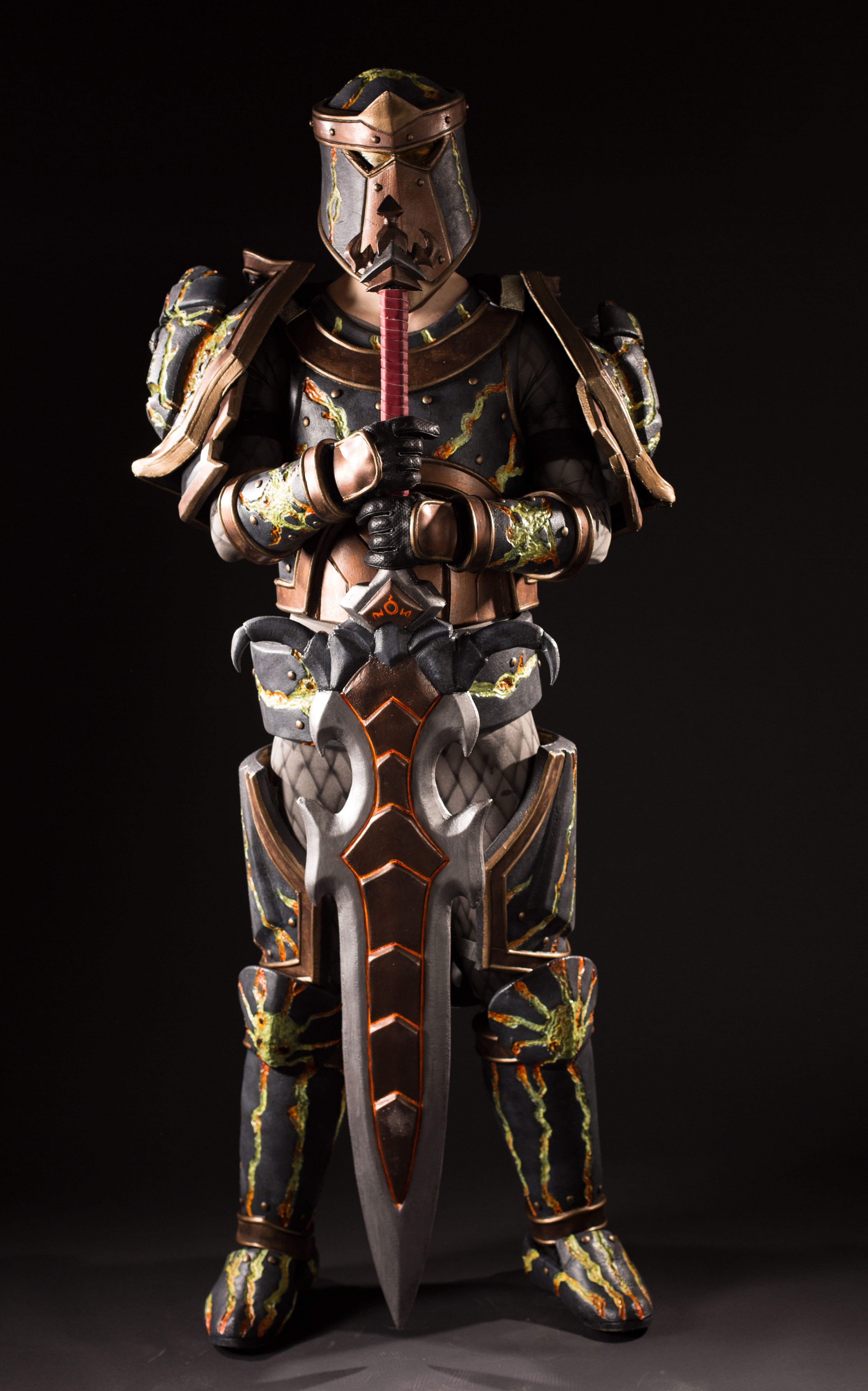

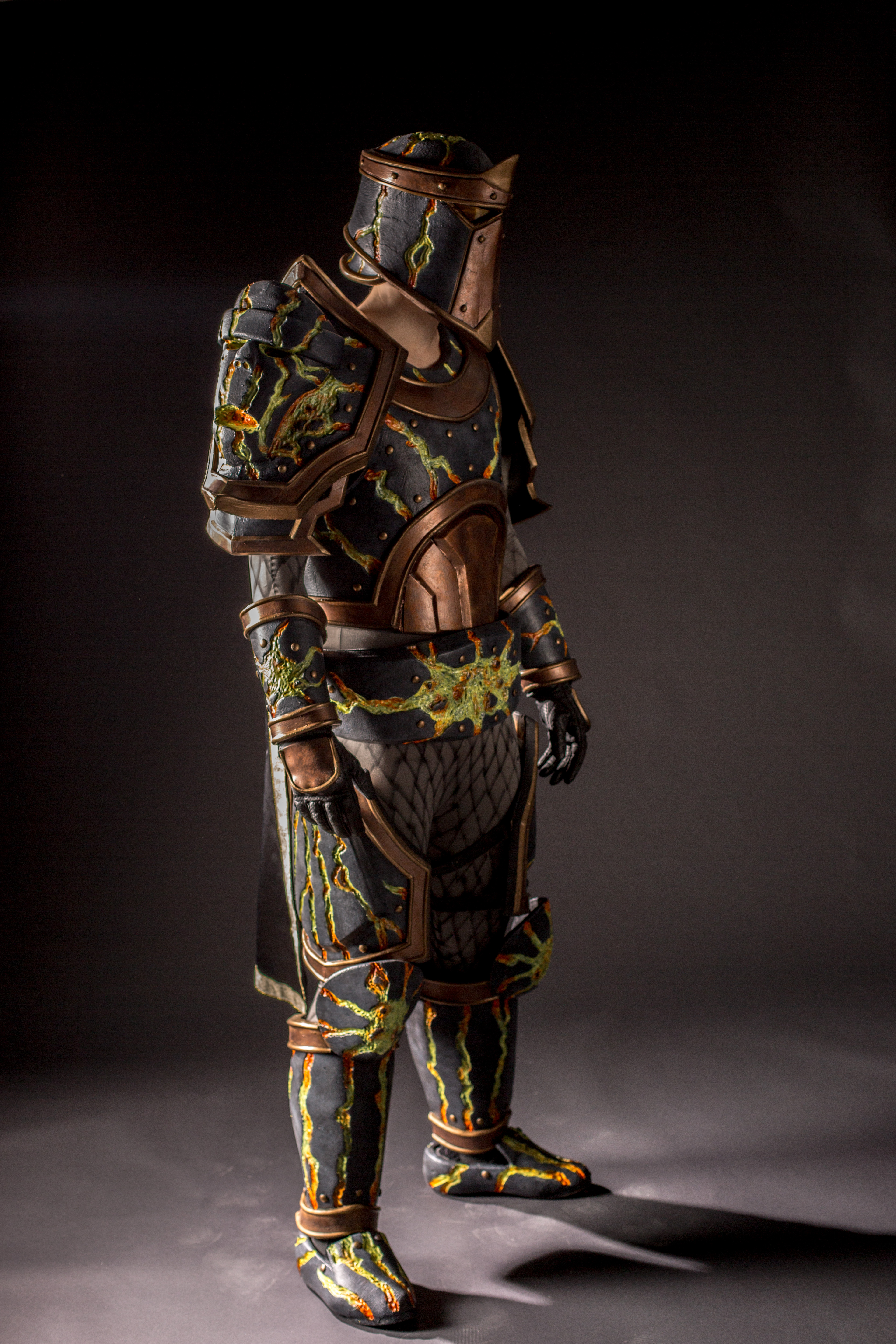

So I have completed the construction phase of this project and am beyond stoked to be moving into the special effect parts and the painting. I will be making the shoulders emit fog and i will be mixing in reflective glass powder into my paint in the lava areas to create a glowing effect. But before all of that here are some final shots of everything before I make the attachment pieces, I.E. the belts, velcro and other assorted attachments. IMG_2496.JPGIMG_2497.JPGIMG_2498.JPGIMG_2499.JPGIMG_2500.JPGIMG_2501.JPG

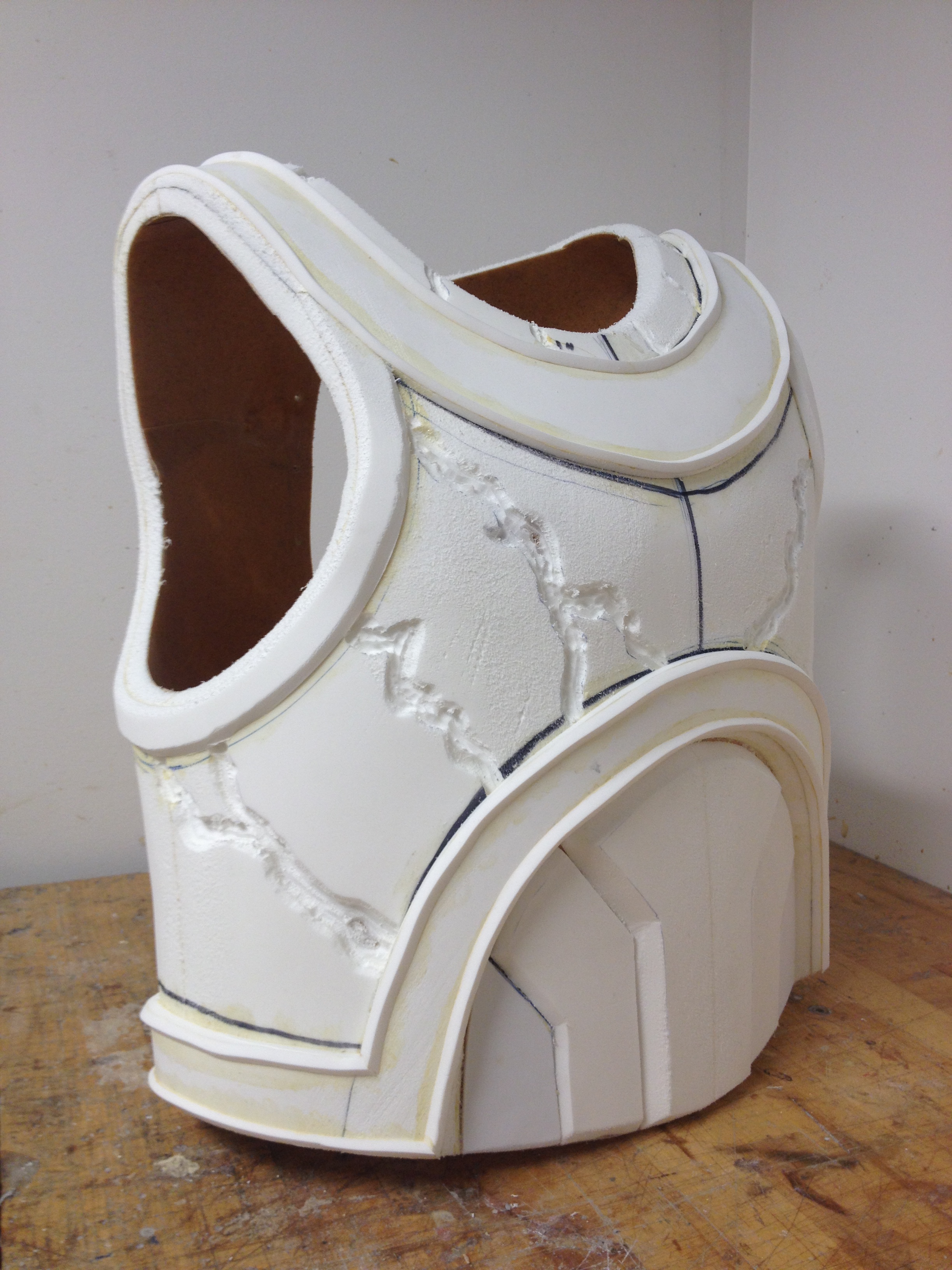

^^Here is the chest piece. This piece was a ton of fun to make until I got to the trim part of it. 6 hours went into trimming just this piece. bleh.
oh yea, i forgot to post pictures of the weapon in this thread too so here is a preview. I will also post a thread in the props section so if you want to see all the pictures of that, head there.
