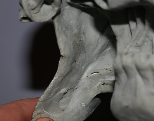

Ok heres a pics damaged area i was worried about, apprently the watery plaster did its job pretty well, as all that can be seen it s small undent.
yay for mrs surps.
the other damage is a few small bubbles in the latex, these are easily patched, and i figure it because ive never had to brush latex into such a detailed mold before, i think i maybe rushed as i wasnt expecting it to work etc, theres about 7 little holes but thats it, and they are all around the mouth area.

Totally happy with this , its very soft still, so it is not holding its shape very well, ive taken a couple of quick pictures anyway as i promised, ive now packed him full of newspaper, which is how he'll stay for a week or so , until hes cured.

Ian, Thankfully all the holes are very small, litterally * size so its just a dab of latex in all i think :D
