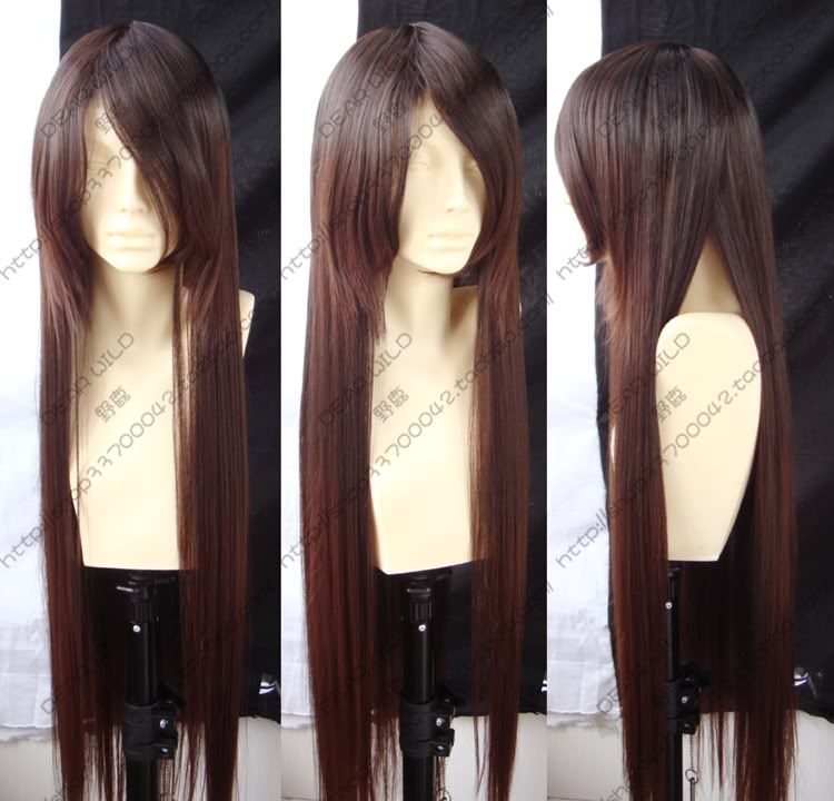

Survived all marine life encounters, so back to work! No new pics of the sculpt but i did get my ebay on and found this wig which while its not perfect looks a damn site better than the fuzzy abused mop that is my hair! Found some better shape ones but they were the wrong colour, seemingly every colour but the one i wanted (grrrr) im falling behind on this i need to get it moulded by the end of the week to have any chance of it dryi g in time. Wank. The boyfriend has also informed me he wants a darkness inspired costume but we will see how much time i have! http://i1281.photobucket.com/albums...287756F9-268-00000036878F2465_zpsb4c143c3.jpg
