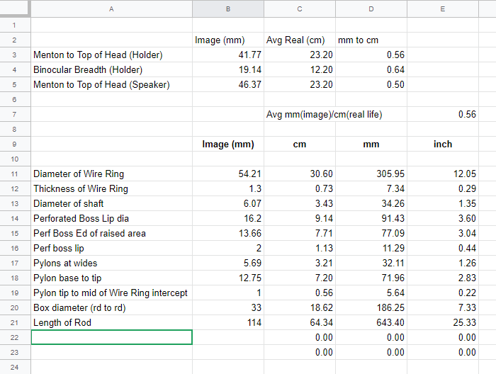

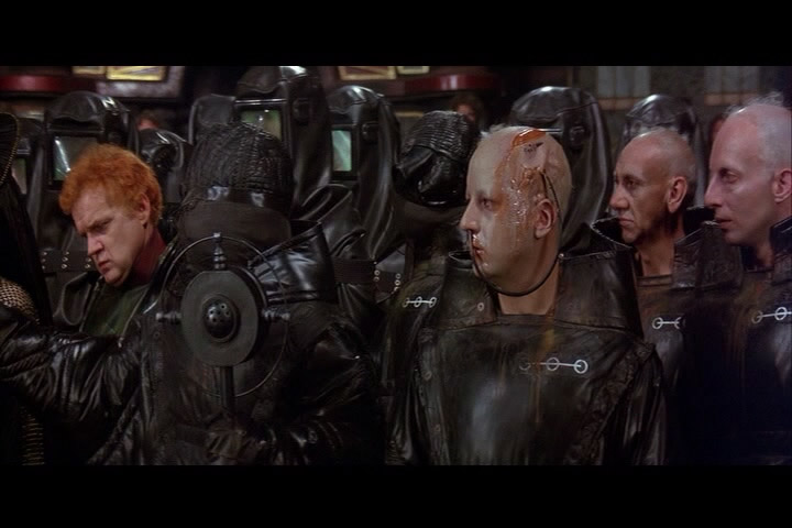

So first thing, measurements. I took a bunch of screen captures. Then I used the one above and measured different facial measurements and standardized them to 50th percentile male face measurements for reference, then took measurements of the staff and converted them to real-world cm. I got this:

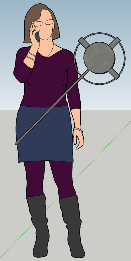

Then I threw some of the basics into Sketchup to check and see if they made sense (Scaled Sketchup lady up to 5ft 10 inch avg male height for comparison, please excuse my basic sketchup skills just started using it today):
So my first reaction was I'm in the right ballpark but will need to refine a number of the measurements along the way, probably need to build a mockup in something cheap and just hold it to see how it looks and tweak measurements, then start breaking it down into components and thinking up materials and best techniques for making them. For one the thickness of the shaft does not see right compared to the size of the main box.

1. The end of the shaft looks like it might have some kind of knob on it but I can't see it clearly in any of the scenes.
2. The back of the box that you speak into is different (see pics below), look slike it has and additional circular component with another circular component inset into the center at the back.

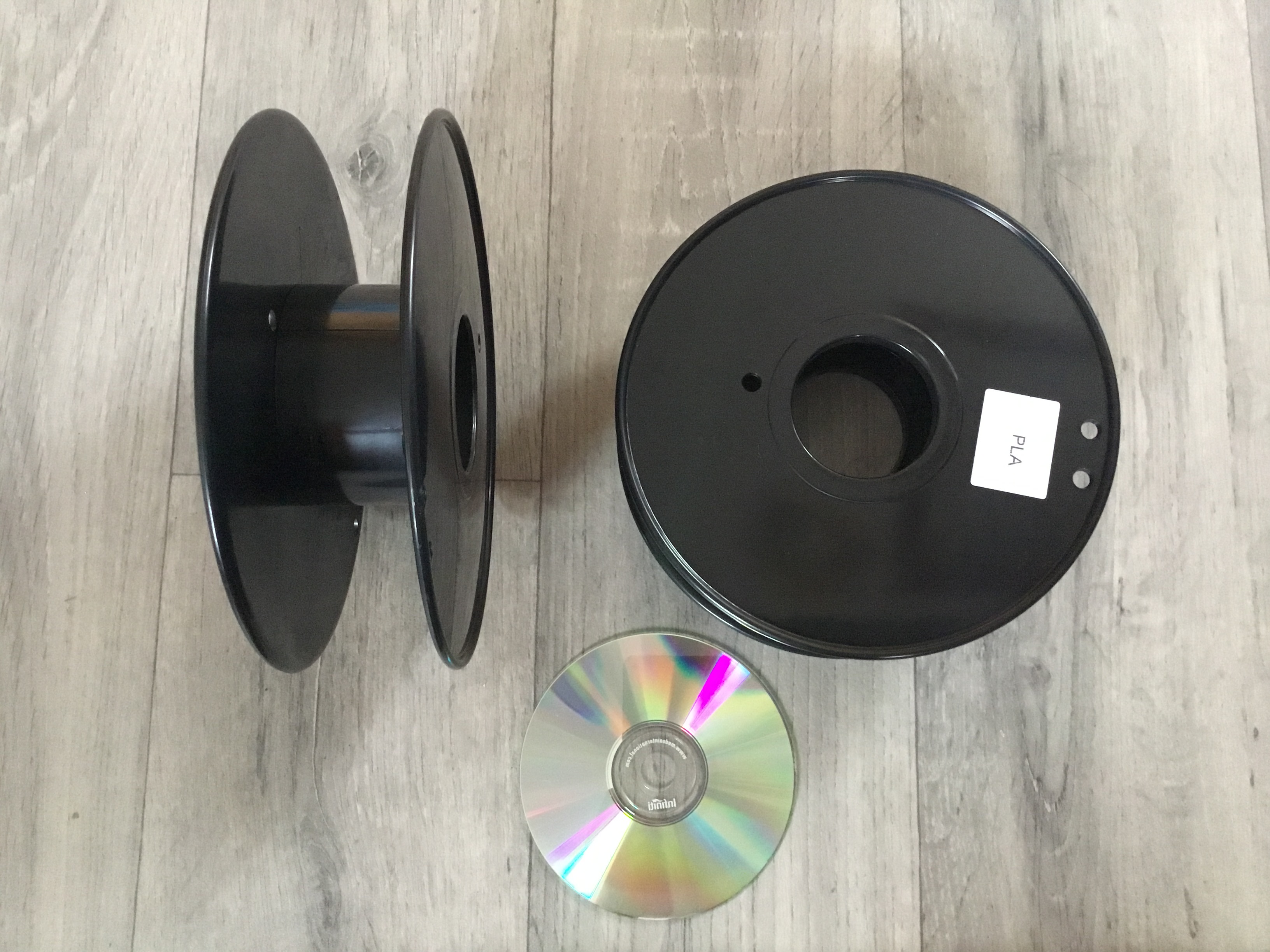

You know the overall size looks close to an empty 3d printer filament spool, that might give you a base to work from, or mock-up.
CD for scale

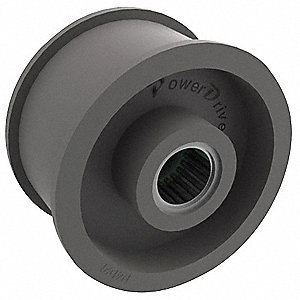

With the beading and slight concave it could be a wheel rim of some sort from a go-cart, or possiblly a pulley idler, either would certainly have some heft. But if you’ve access to a 3d printer it hardly matters.
I see what you mean about the pulleys and rims, definitely has that feel. I don't currently have a 3D printer, I was thinking of designing it and either getting access to a local maker space or using a print-on-demand service, since I'm already pushing far outside my current skills with learning 3D modeling, arduino basics, and doing some electronics.

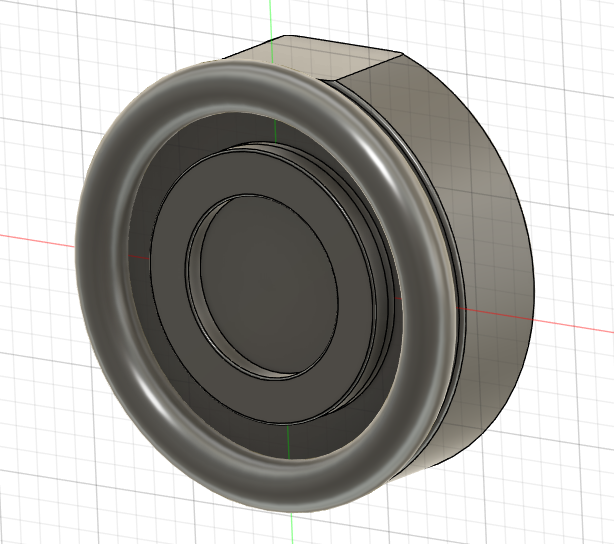

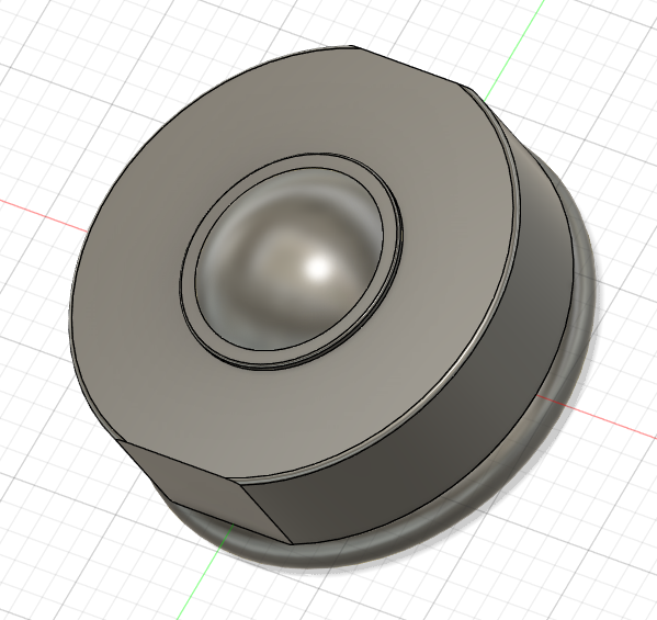

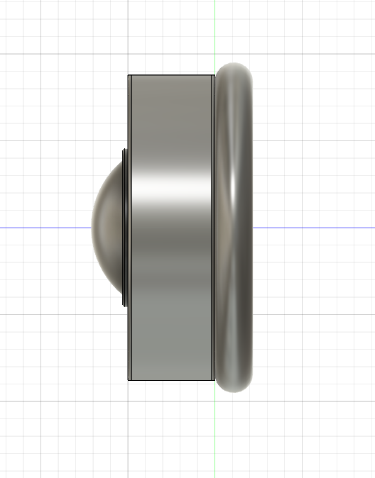

Got 360, it's a lovely program! Here are some quick mockups of the central box I'm planning on 3D printing (still needs internal spaces carved out for components and attachment points for the 3 pylons, the pipe flange the rod will screw into, mounting spots for arduino, battery, speaker, etc).
Outstanding. One tip that might help doing the holes at the front - on the menu there’s a button for ‘merge’ bodies.
Its not obvious from the name but it’s actually 3 tools: Merge, Cut, Intersect
You can cut one body using a second body as the cookie cutter. So for your holes use a sphere or cylinder and Place it where you want the hole and cut it out.
Thanks for the advice, I'll look for a video on that tool. There are a large number of great tutorial videos on Fusion 360 out there that have been very helpful. I was thinking that I'd cut the holes smaller than I wanted them on the 3D print for both the Speaker Boss in front and the attachment points and then clean them up to final size by drilling them out after printing.
I heard something about a pattern feature too that I might be able to use to setup the cylinders to cut holes with in a regular pattern for the Speaker Boss (the part that looks like a pickleball half). So that's in my homework too.
