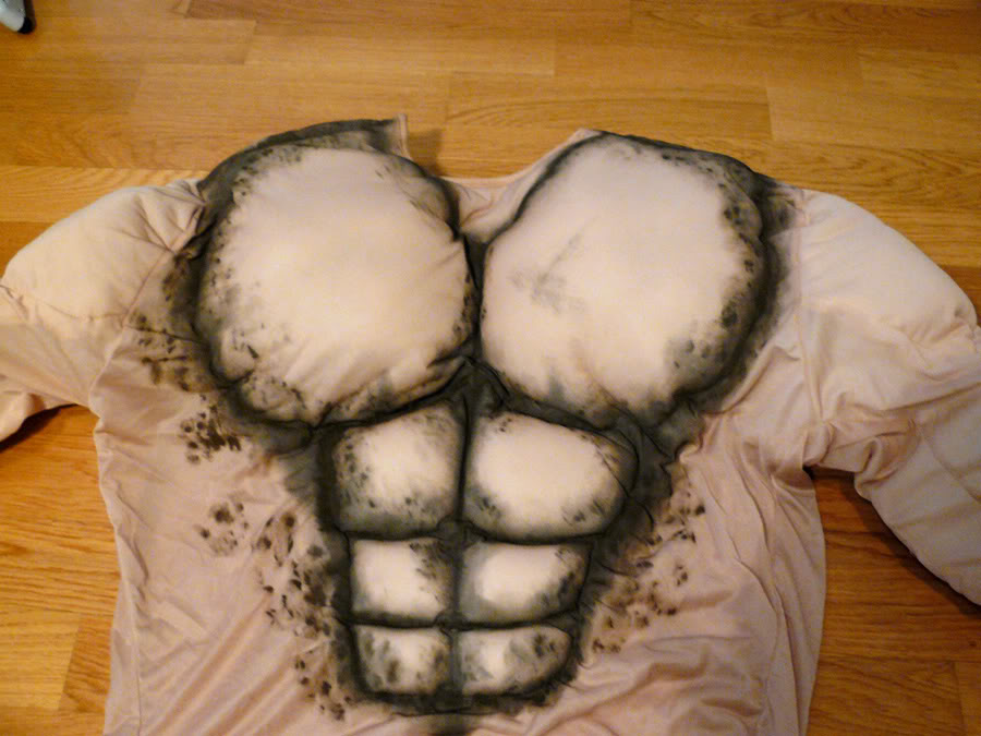

So to get things rolling I decided to start with bodysuit and chose to use rambo shirt as top part because it was really cheap and had suitable base colour. So body suit is going to be 2 piece, I'm thinking getting one of those cheap bodybuilder costumes and cut lower part to use for the predator. I just liked rambosuits muscles more than what you can find on cheap bodybuilder halloween costume.
I don't want to buy a airbrush and I've done dry brushing with foam before so I decided to go that route. I had quite a good selection of browns and earthcolours as acrylic paints from model making so I used those. First I shaded muscles with lighter shade of brown and then highlighted darker areas and added some spots here and there. Right after that I laid first layer of latex when acrylics were still bit moist so latex makes it "bleed" and blend more.

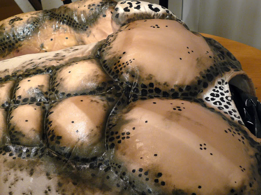

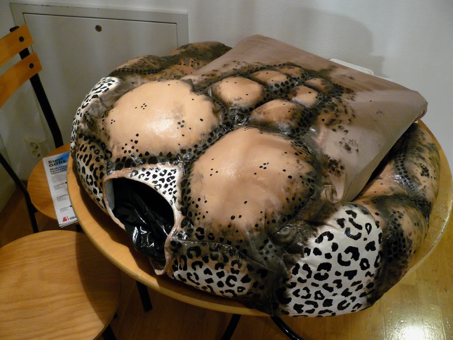

After first layer of latex was cured I drew on black spots and leopard camo with permant markers and laid another layer of latex on top of those to seal.
Arms and chest area are now done and now I'm going to do sides with similar method. I didnt want to do whole suit as same time because I feared that latex will stick to itself while I work.
So here are photos where I'm now. There are quite a bit stuffing inside the suit to prevent shrinking so it looks bit bulky to say the least :D

Couple of pics from the first steps on my costume project. First ones are from the rambo top that I try to turn to more beast like :)
Here is the top with first shadings, just to test colours
More shades and white areas painted for leopard camo
Chest area after first layers of latex
Shoulders with latex on

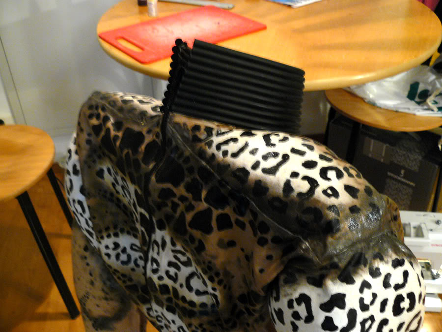

Here is shots from the neckring. I wanted high neckring and one that is attached to suit.
I made ring from round 6mm thick insulate foam stripes that I glued together with CA and reinforced with fabric and CA from the inside.
I glued fabric strip to lower section of the ring so I can attach the ring securely to suit
Ring being glued to the suit
From the front/side view
From the back

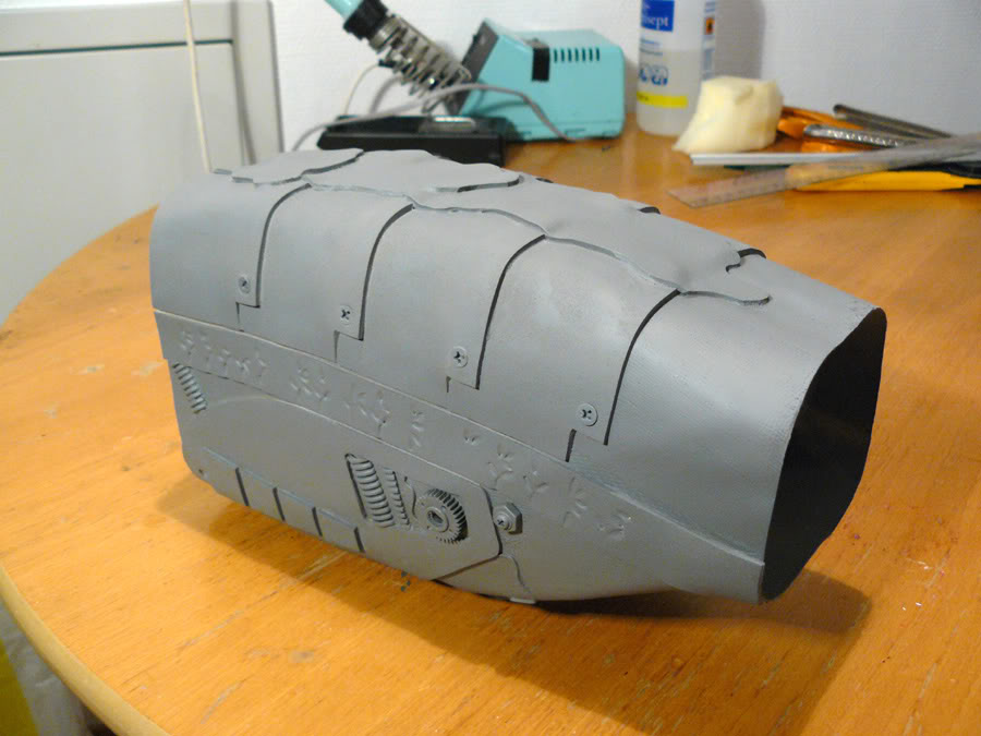

And here couple quick shots from my gauntlet plug. I didn't find persil bottle or anything that would be close enough for gauntlet plug, so I cut smaller bottle to segments and rearranged those to my liking. Then I covered whole plug with clear packing tape, waxed the plug and fiberglassed couple layers right over the plug.
After the glassing was cured I cut fiberglass gauntled from the plug with scissors, peel it off and glued it back together using fiberglass tape and CA.
Plug before taping it
First fiberglass gauntlet base
Fiberglass gauntlet waiting for detailing.
First foams and details added
Primed, blade part is going to be its own piece and its going to be secured with screws to fiberglass core of the gauntlet
I think I add more details, but I don't it to look to busy looking. I like clean simple lines

Thanks for the kind words :)
Now I have 4 thin layers of latex on both arms (totally covered), on chest, stomach and back. Sides are still without latex and now I think i test how suit looks with armour and fishnet/netting before covering those. If it looks decent I leave those without latex so that thin strech part works for ventilation.
I dont want to build suit too thick, I'm quite happy with 4 layers because I can add more shine just applying silicone oil to shine the latex in use, for example for events etc.

That another great idea, I just made my gauntlets out of foamies on top of foamies. What you gonna make the details out of? Awesome start my friend
I'm going to use craft foam a lot, but I wanted to have rigid structure underneath and because I've build many RC airplanes from fiberglass I have bunch of glass and epoxy resin left overs so I will use those as well. Glassing is really fast, I laid first gautlet over the plug in 30minutes, let it cure over nigth and its ready for sanding/painting or what ever you want to do with it :)
