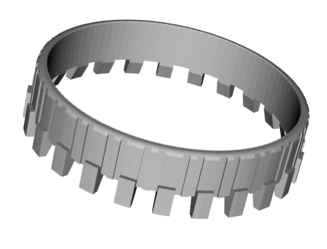

The Bandai 1:5000 Star Destroyer looks pretty good. Only real thing I noticed is that the engine bells don't have that gap between the bell and the outer ring.
Anyone interested in something like this? The resolution of the 3D print is less than Bandai's injection moulding, but the payoff is the thin gap between the ring and the bell.

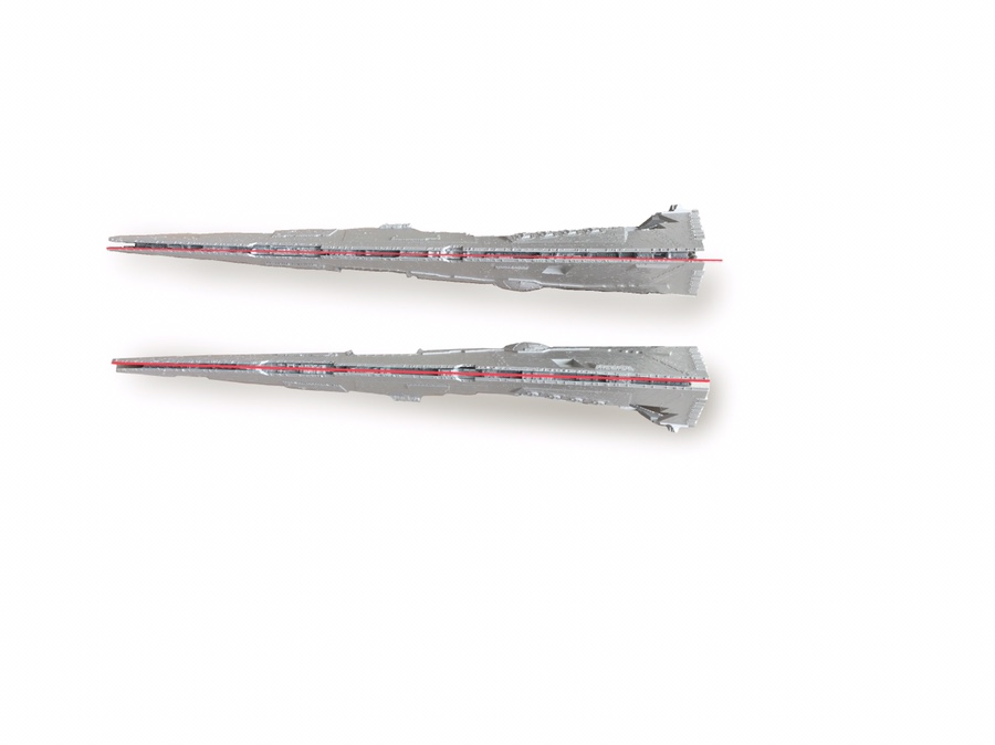

since I received my own SD, I spent the two last weeks looking at it and admiring how much Bandai has increased their modelisation abilities in order to give justice to this incredible OT design.
Then I started to put the main parts together to check if my fears was founded or not. indeed, my upper hull was quite warped and reading this thread carefully, I hoped that my star SD would not have this ridiculous smile we 've seen on some builds.
Helas, I got the smile and in addition, the left end side of the upper hull is falling suddenly !
I put the 2 views together to show how much deformation it has.
What the hell to have such an amount of detail and missing the bulleye with such an important aspect of this jewel !
First time that bandai desappointed me! I should have all their model and it was apleasure each time to build.
Another point that ennoy me are those massive panel lines. putting together, the kit has a scale issue: two much micro tiny details and big panel lines. looking at it it's kind of weird.
something that makes me feel that the Zvezda kit is somehow right at his scale, even missing some bits here and there...
Will carrefully follow your builds to see how you all great modelers are going to overcome this warping issue

hi there! today brought together its set of. I can say one thing-the regular lighting scheme is not convenient. every time to remove the main superstructure and its interior to turn on-off lighting is a bad decision. tangled wires, latches do not always fall into place, the gap between the body and the superstructure... I redo so as to not have to disassemble the model for turning on a light. very well received by those who ordered the kit without lighting.

Have only test-fit my hull, but it seems that the front peg, right in the prow, is what is pulling the whole thing out of alignment. Having some thought of cutting the peg off and gluing there instead...

I collected using glue. side elements of the belt glued to the bottom of the body. I've just attached a ruler-the bow-to-stern arc is present. I'm afraid this is an unpleasant feature of this model.

It really is unfortunate that so many seem to be having issues with warping. I was hoping that it may be that it’s not until it’s fully put together that everything self aligns and falls into place, but going by the above, it doesn’t seem like that’s the case.
I’ll have mine in hand this week so will see if it has the issue, and if so how bad.

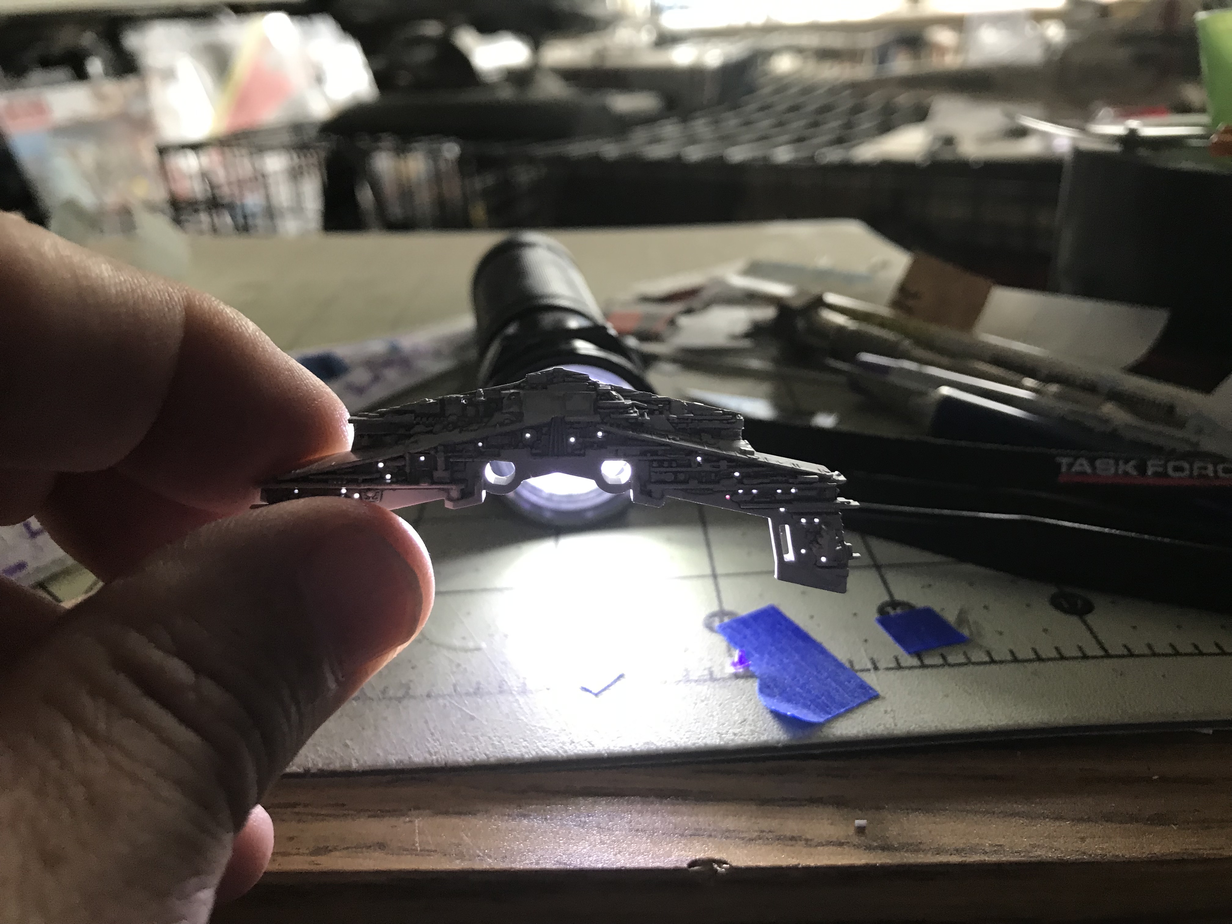

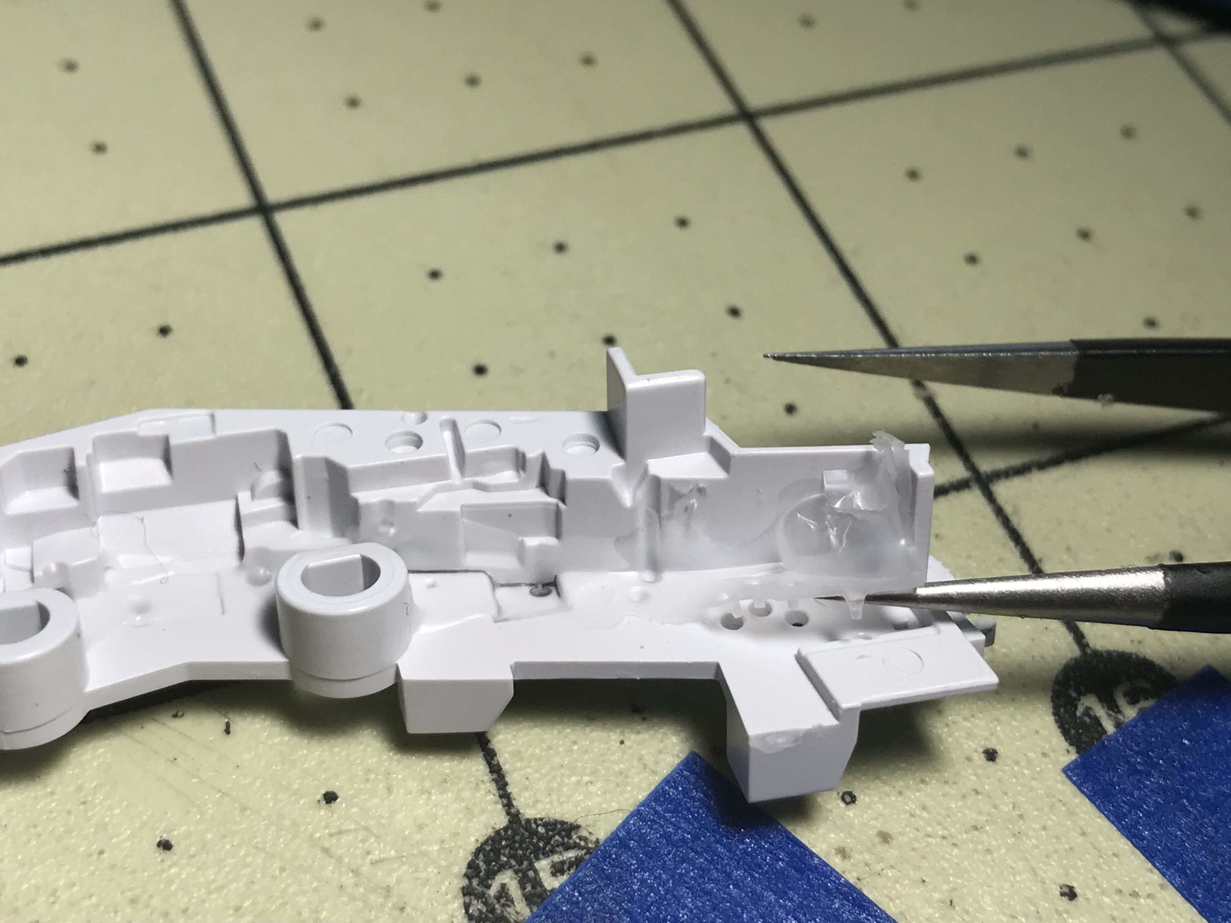

While working on cutting masks for airbrushing hull plating - decided to try Omnius' idea of putting glue that dries clear into the holes from the rear of the superstructure, bridge tower and trench pieces and filling them with paint marker red to create lighting effects without the use of fiber.
Did some trial and error by using some craft glue that I have been using to secure the fiber on the Zvezda. Dries crystal clear and worked well in terms of filling the windows and accepting translucent red pigment to create 'red windows' when backlit. The glue dried super clear and on windows without red pigment - you get hot spots of the LED twinkling through as your eye moves across the model.
So then I was looking for a glue that might dry off-white and act as a semi-diffuser of sorts and cut down on the hot spots and also still accept red pigment to shine through some of the holes. Did a few trial and errors with several glues and finally settled on: "ELMER'S WHITE GLUE". Yup. Plain old Elmer's white school glue. Overfill the holes and turn the piece over so the glue can seep down into the holes from behind and the glue dries into a cloudy clear off-white that when shining an LED through - gives great light BUT eliminates hots spots altogether. However, I think I will have to go with an enamel red paint to fill the holes rather than a permanent red paint marker to get the red to shine through sufficiently.

Those "hot spots" are what had me worried about not running fibers. I had seen quite a few videos that pan along it, and those hotspots really detract from the effect making it look literally like a hollow model with some LEDs inside
Elmer's glue might be the ticket rescuing me from running all those fibers

Interesting. So did you just slop a coat of glue over the whole of the inside, or pick out each window? It sounds like the former is a totally workable solution, and if so hooray for sloppy!

Works for me. No hot spots.
Sloppy. I do not have a precision applicator for the Elmers, so I just globbed it into the whole inside structure, making sure to push down and squeeze into where the window holes are to 'fill' and left it turned over so it would shrink and dry while filling the holes.
All I can suggest is do a test on one of the superstructure pieces and see if it fulfills what you envision for your model. Elmer's is somewhat pliable when dry so if you do not like the effect it achieves you can just pry up an edge and pull the glue off the model with a pair of tweezers very cleanly.
I suppose if you wanted to take the tedious time of filling only each hole individually - one could invest in an applicator and spend the time injecting the glue into each hole.... but why waste the time? I have hours of time to spend cutting frisket mask for airbrushing hundreds of hull plating on the surface.
