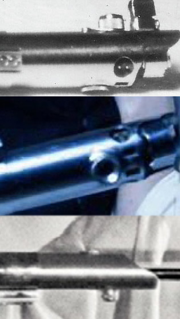

ESB doesn't tip its hand much in terms of super close up details, save for this one we all know and love:
Given what we can make out "NEW YORK" in the engraving, this makes this model an early Folmer as it was the only model to spell out New York. All of the buttons used on all the variants are full-knurled.
Because ESB used multiple belt-hangers and stunts, and we don't know if the Graflexes all came from the same lot or were sourced from various places, it's impossible to know if every single one was the same model. But for sanity's sake, looking at this one example from a short-bladed stunt...
Verdict: ESB uses at least one early Folmer.
For TFA two of the key details are altered-- the eye is ground down to brass, and the endcap is covered. Additionally, there are no super-clear definitive shots of the pins. The Disney Launch Bay versions are made by the TFA prop team, and are Graflex inc versions, leading us to assume the TFA onscreen Graflexes are as well.
But in comparing these two shots with Scott's images....
...I feel like they could be Graflex Inc. or late Folmers.
Verdict: Unknown! Help!
Similarly, in TLJ, the glass eye has been modified and the endcap is obscured. There's a ton of profile shots, but not many that show the eye at an angle to judge the bezel. But I think the pins show enough detail to be called as Graflex Inc.
While the "white-glove" Graflex can't be guaranteed as being used onscreen, it certainly looks identical in every other way.
One outlier-- this TLJ display version:
From some angles that looks like a Graflex Inc eye, while from others, an early Folmer. The pins are Graflex Inc., and again there's no way to confirm this one was used onscreen, but why can't me eye make up its mind?
Verdict: TLJ most likely uses Graflex Inc versions.

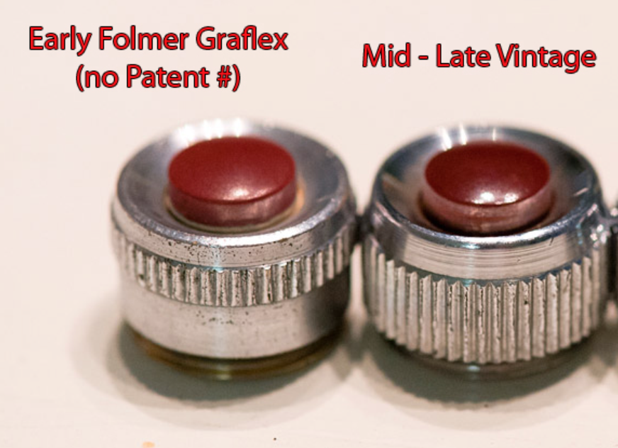

Don’t forget surface finish. Some Folmers have a shinier finish.

The finish on my Folmer is substantially shinier than on my two Graflex Inc. 2-cells. They almost look matte by comparison. (That's another thing that made me wonder about parts swapping – the finish is consistent across all the parts, which makes me think it's all Folmer. But then why the pns?)

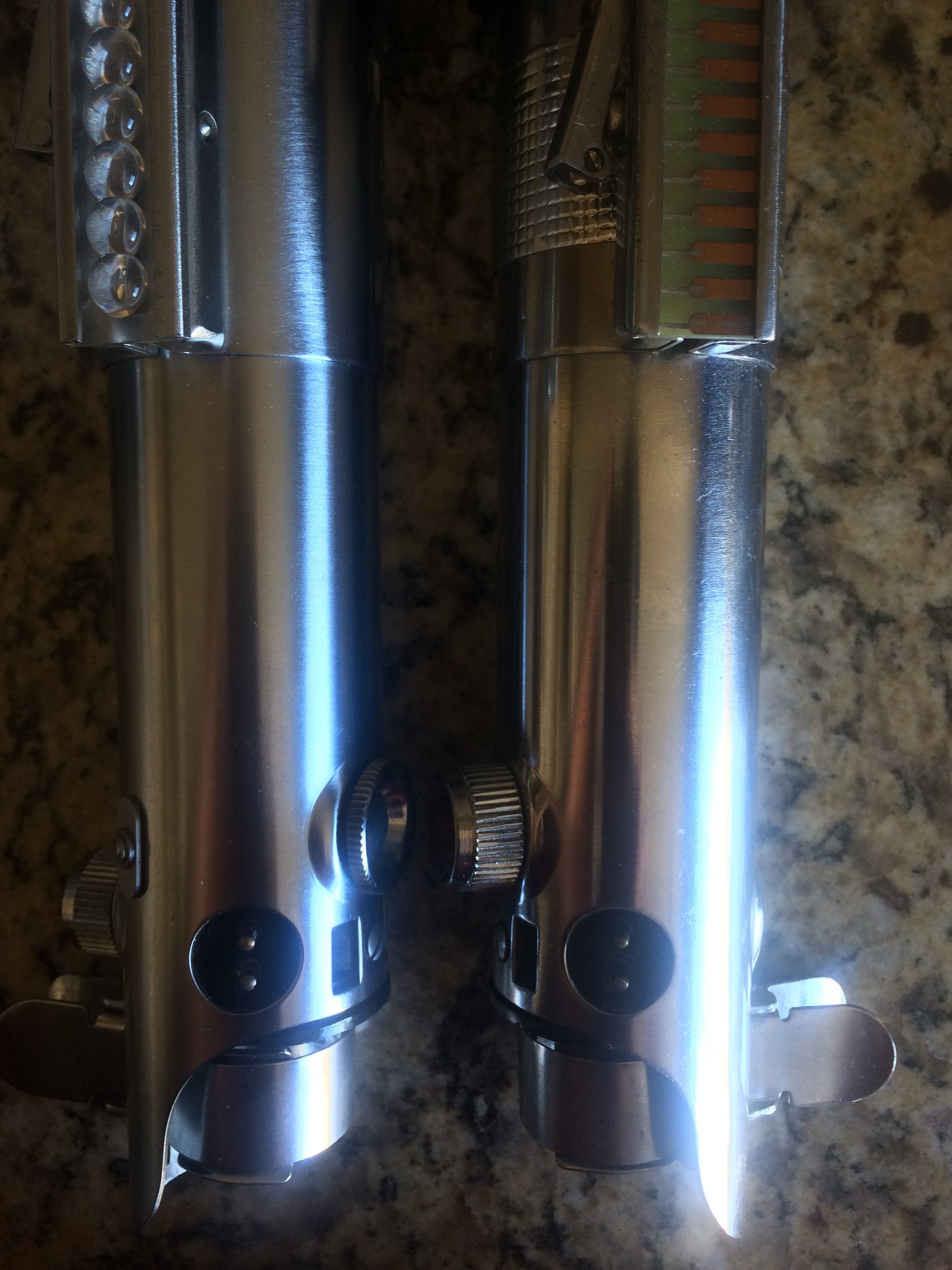

The mystery of what other "tells" might be out there, as alluded to in this thread, prompted me to get out my original GRAFLEX flashes and take a look.
In this line-up, going from left to right, the first 3 flashes are later flashes with stepped pins, non-blackened GRAFLEX lettering on the clamp, and brushed finishes. The last 3 flashes on the right-hand side are early flashes with chrome finishes, blackened GRAFLEX lettering on the clamp, and smooth pins:
The difference in the finishes is easy to see in-person, between the early and the later flashes, but hard to see in photos. Here, a chrome early flash is on top and a later brushed finish is on the bottom:

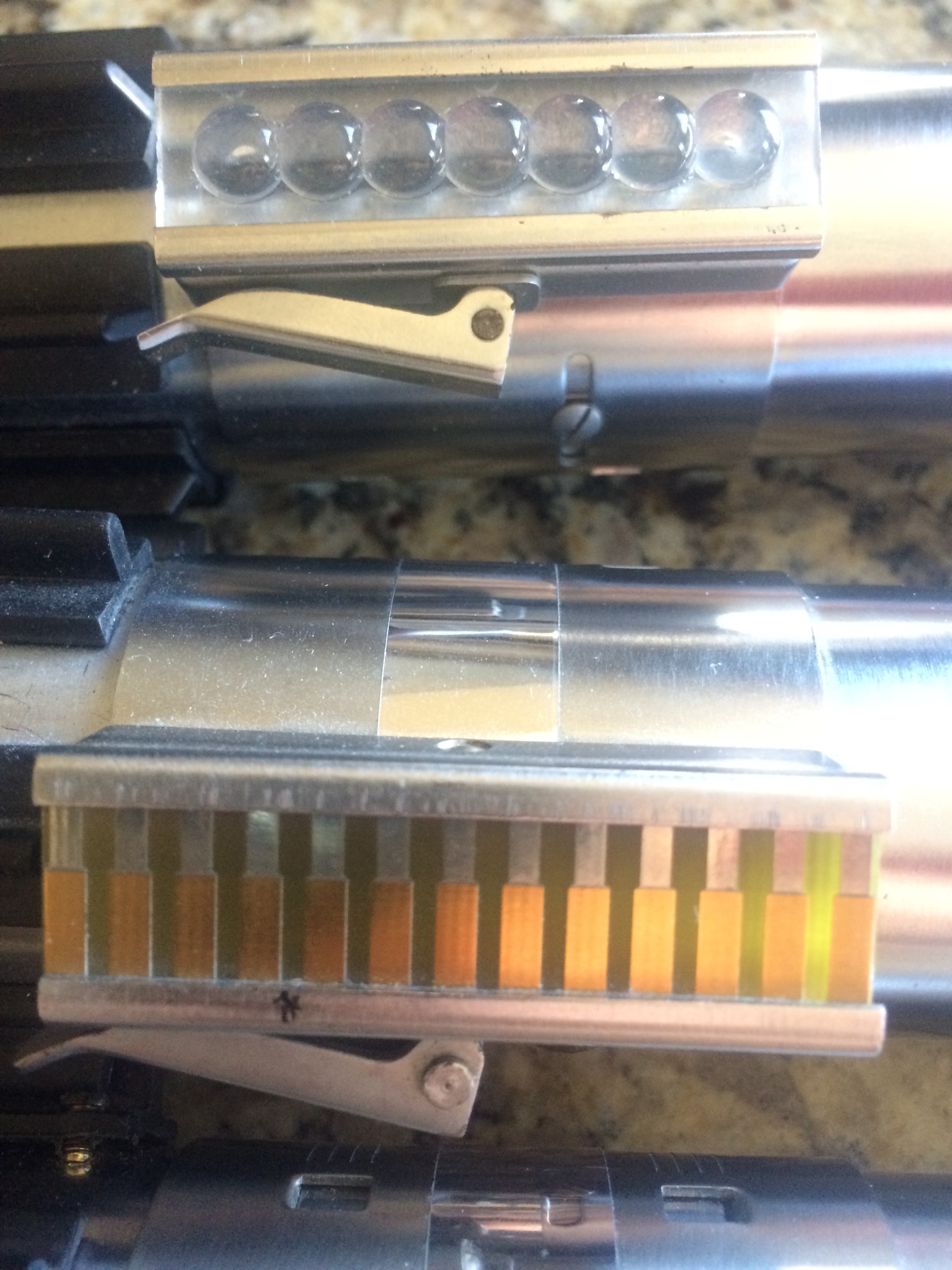

I did find a key difference between the early flashes and later flashes that has not been discussed before--and it has to do with the clamps. Specifically, it as to do with the post/pin in the hinge of the clamp lever. Is this the other "tell" being referred to?
In the early flashes, with the blackened GRAFLEX writing on the clamp, the post used as the hinge pin in the clamp lever is a simple post with no head on it. In the later flashes, with no blackened GRAFLEX lettering on the clamp, the post used as the hinge pin is a traditional post with a flat-head on the top of the post (like a nail). You can see differences here in this quick photo, below...
The early GRAFLEX is on top--with a simple post with no head on the top of the clamp lever hinge pin. The later GRAFLEX is on the bottom with the post with the large, flat (nail-like) head on the top of the clamp lever hinge pin:
I found this difference in the clamp lever hinge pin posts to be uniform in all of my flashes with all early flashes having head-less clamp lever hinge pin posts and all later model flashes having flat-head hinge pin posts.
Older model is on the bottom, here, and the newer model is on the top:
Older is on the left, newer is on the right:

You can see the difference between the hinge pin posts here, in profile.
The early model head-less hinge pin post is on the left and the later model flat-head hinge pin post is on the right:
