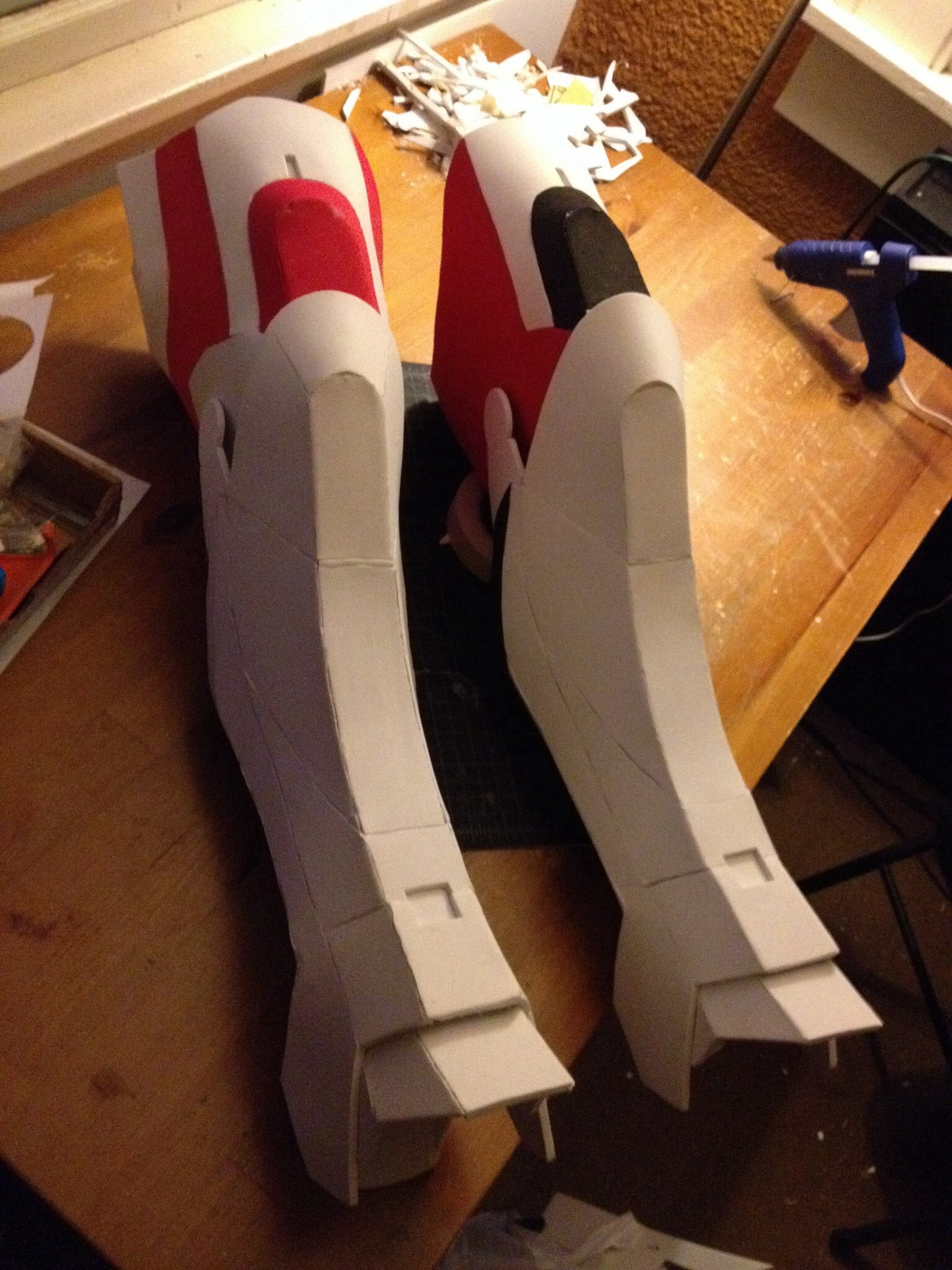

  11. BlueSteel
    BlueSteel Guest
    Oh and here's some pics of my foam work (First build):
