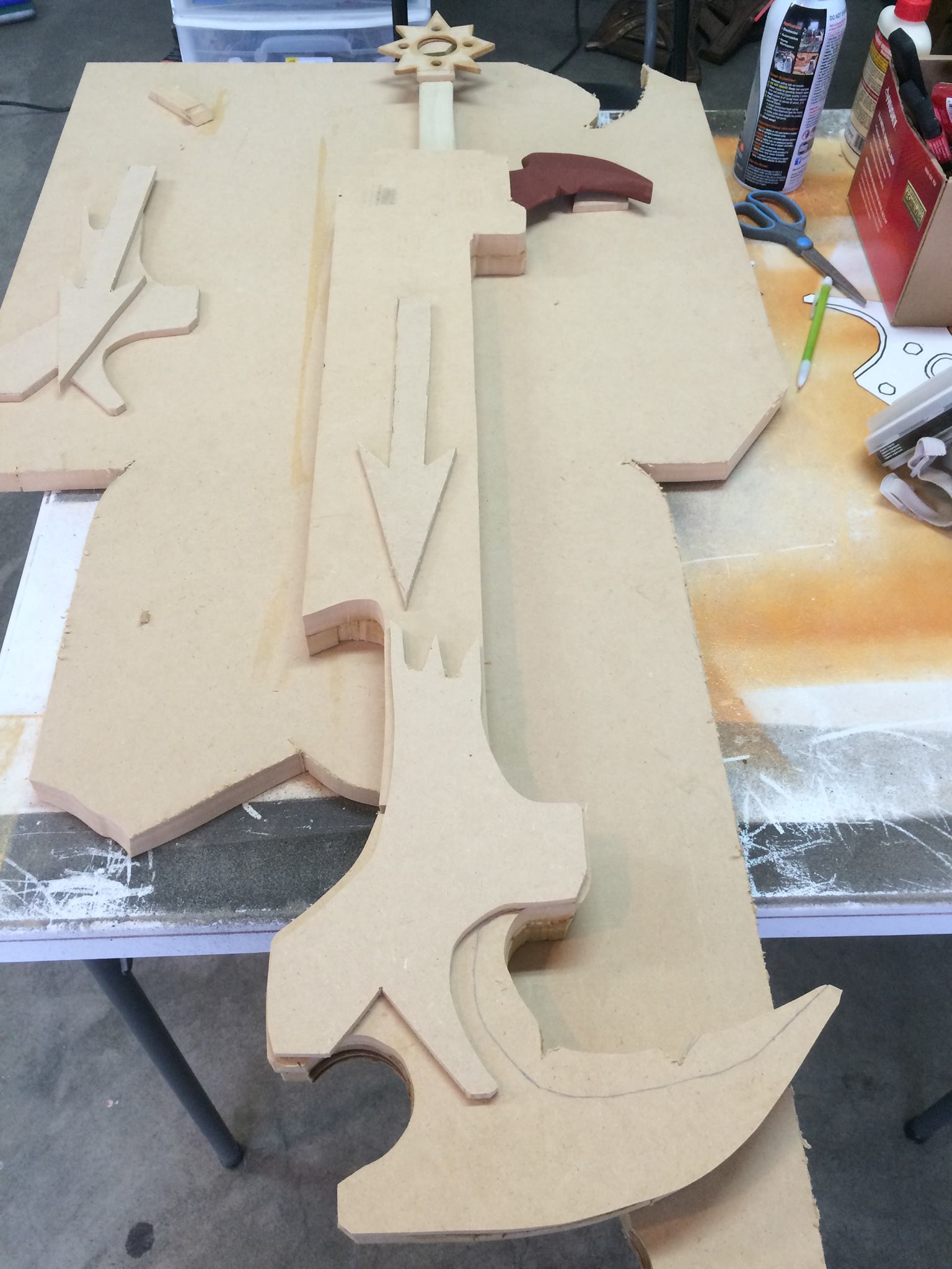

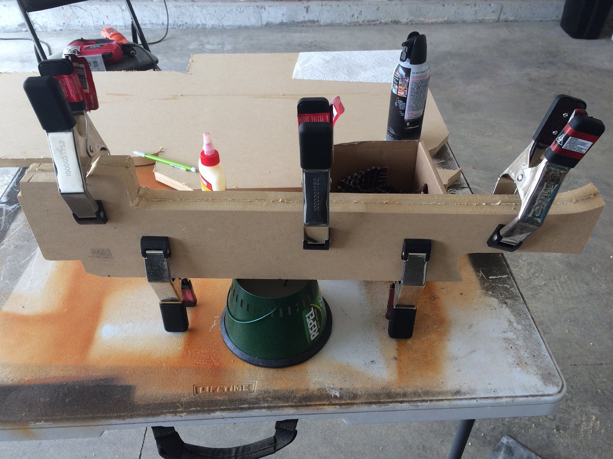

Now that I look back I think I could've probably made the body portion extend all the way up to the top, but this made shaping the top MUCH easier. Lots of waiting while the glue dried..
I put all the pieces together after some rough cuts, and still have some more parts to cut out, but I wanted to get a couple pictures.
