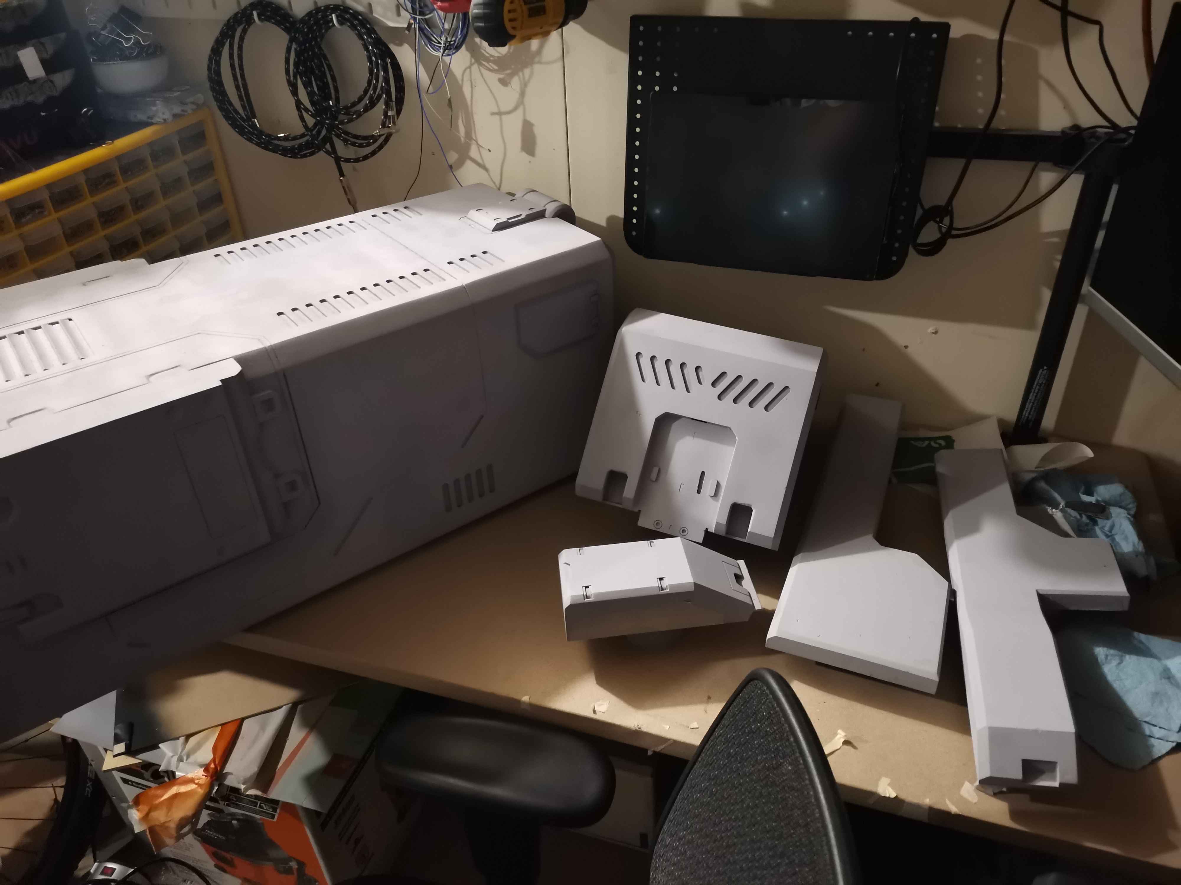

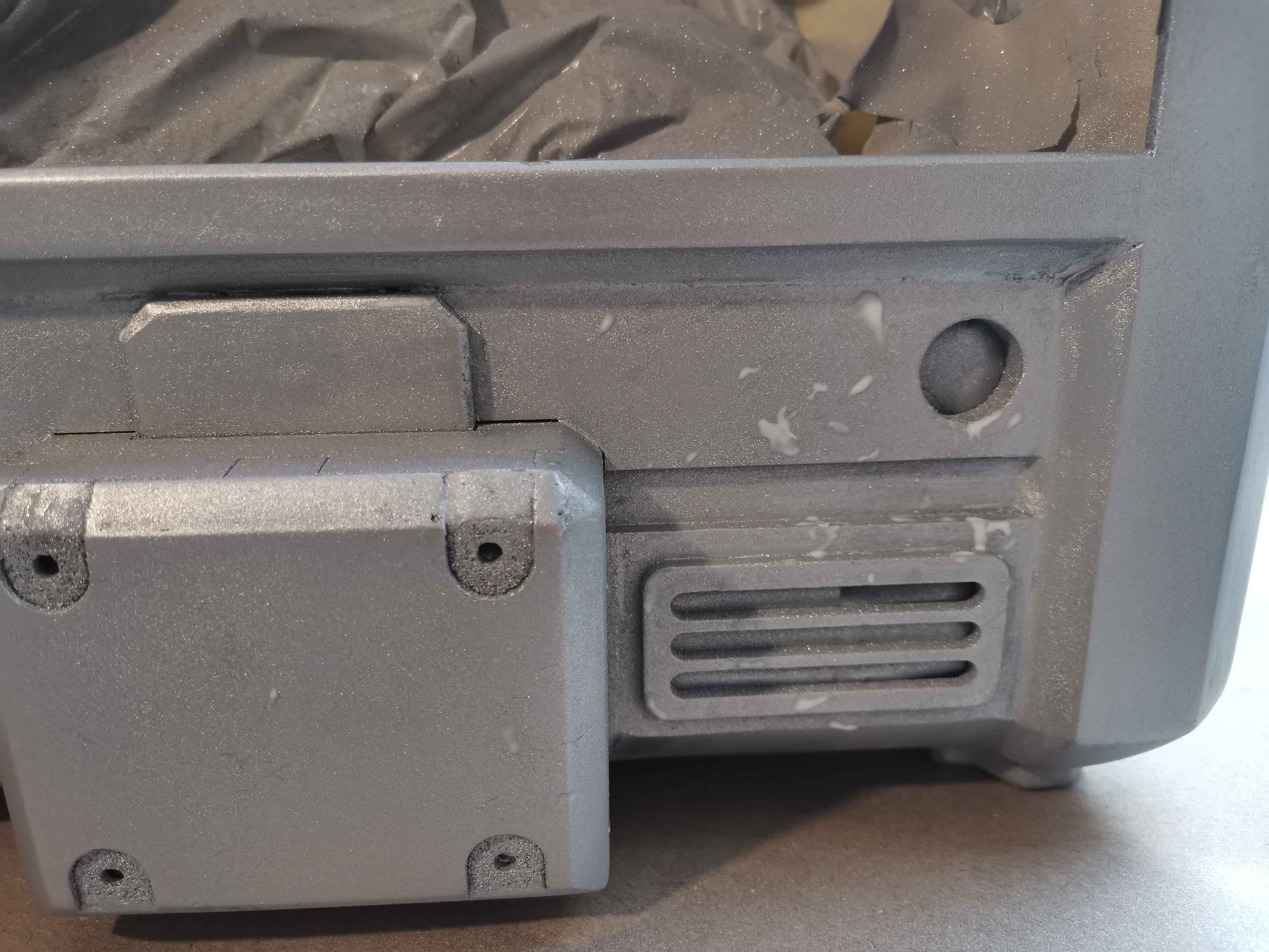

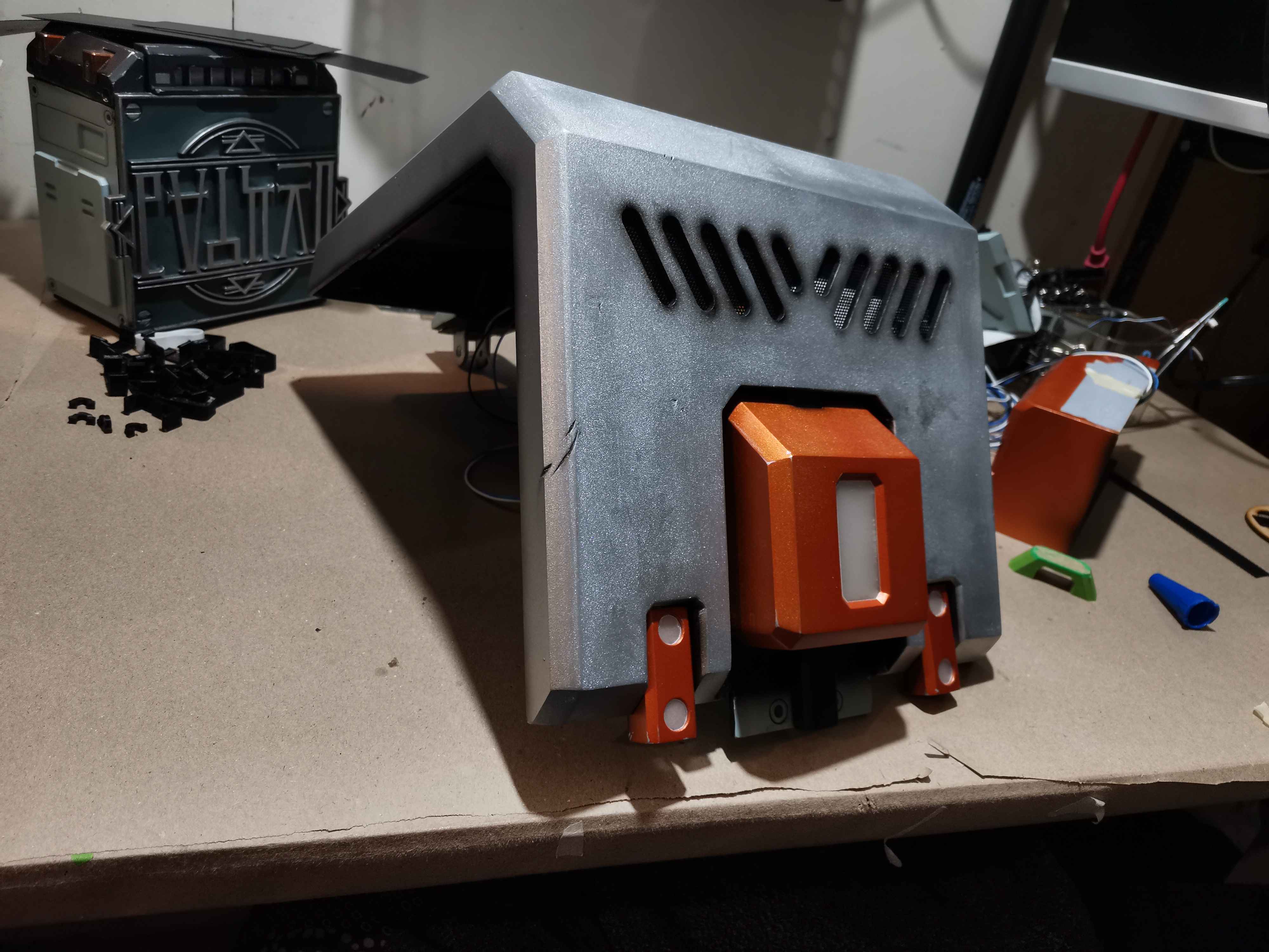

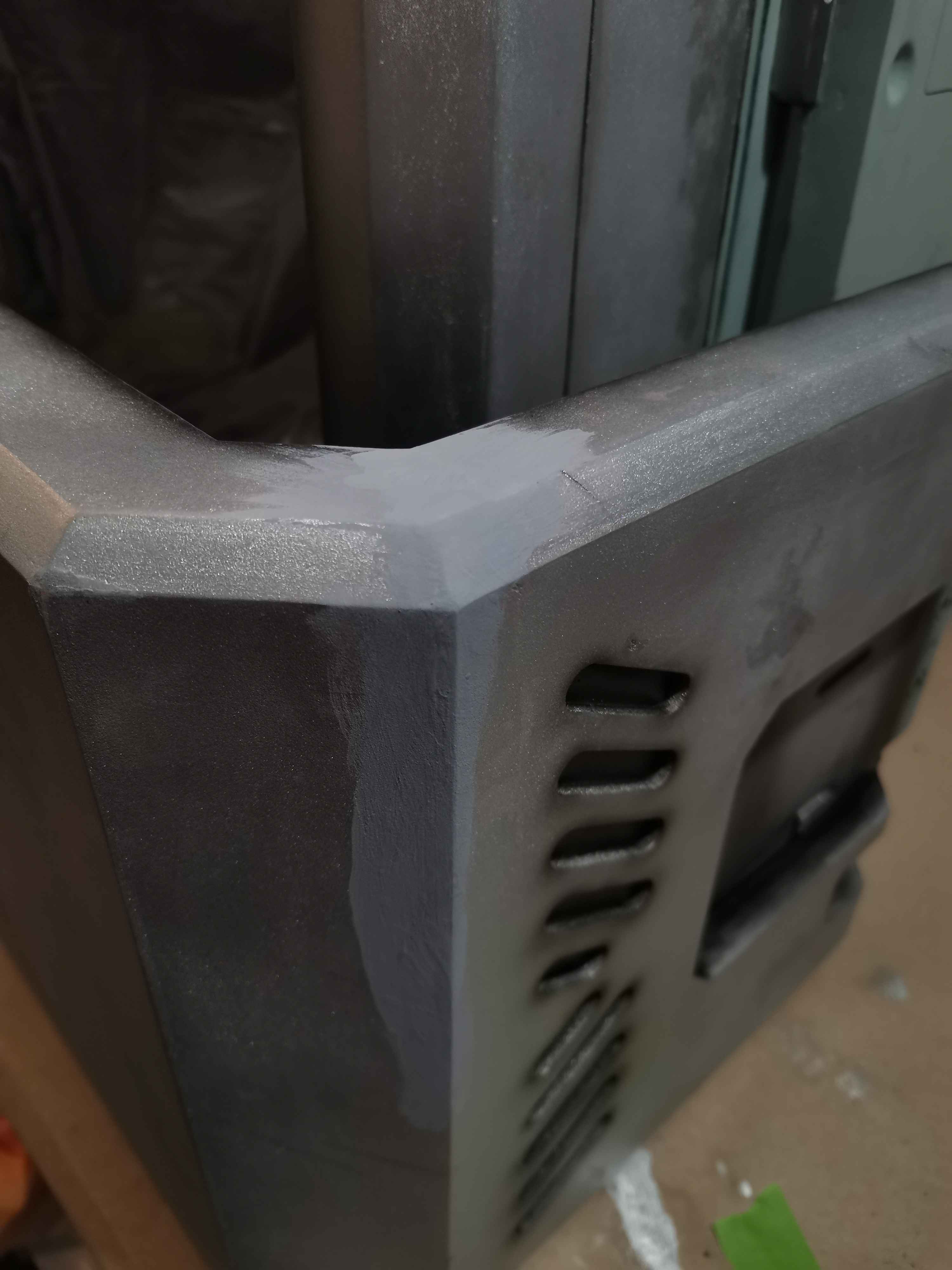

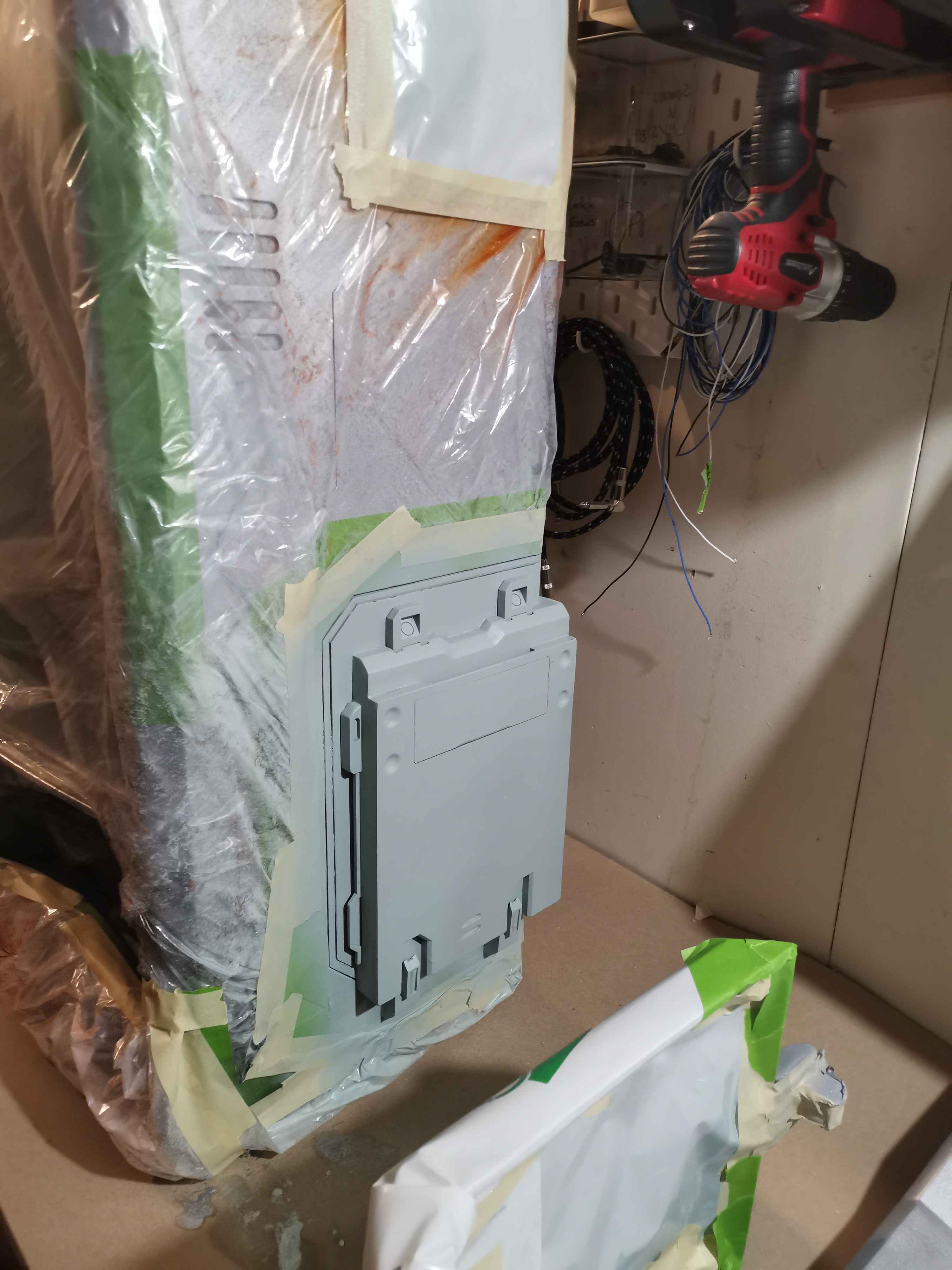

Catching up a bit more on the progress. Finally got to the painting stage, which was mildly terrifying tbh. Attached those little clip looking things and filled in the gaps, then masked off all the inside parts, then got to priming everything and then more... sanding.... yay.
I think it took like another full day of sanding everything with high grit before I got around to doing the basecoat for the silver paint. I'm masking off all the little scratches and stuff with some latex, hence the all over silver coat. Honestly I was struggling pretty hard with this paint, even when using the recommended airbrush size, psi and amount of reducer it was still clogging up my airbrush like crazy all the time. I'm not 100% happy with the silver coat but there's not really anything I can do about it anymore at this point so... yeah. Doesn't help that the basecoat/sealer and the actual silver paint look pretty much exactly the same so it's really hard to tell if I missed anything. The sealer actually didn't give me as much issue as the paint itself, either.

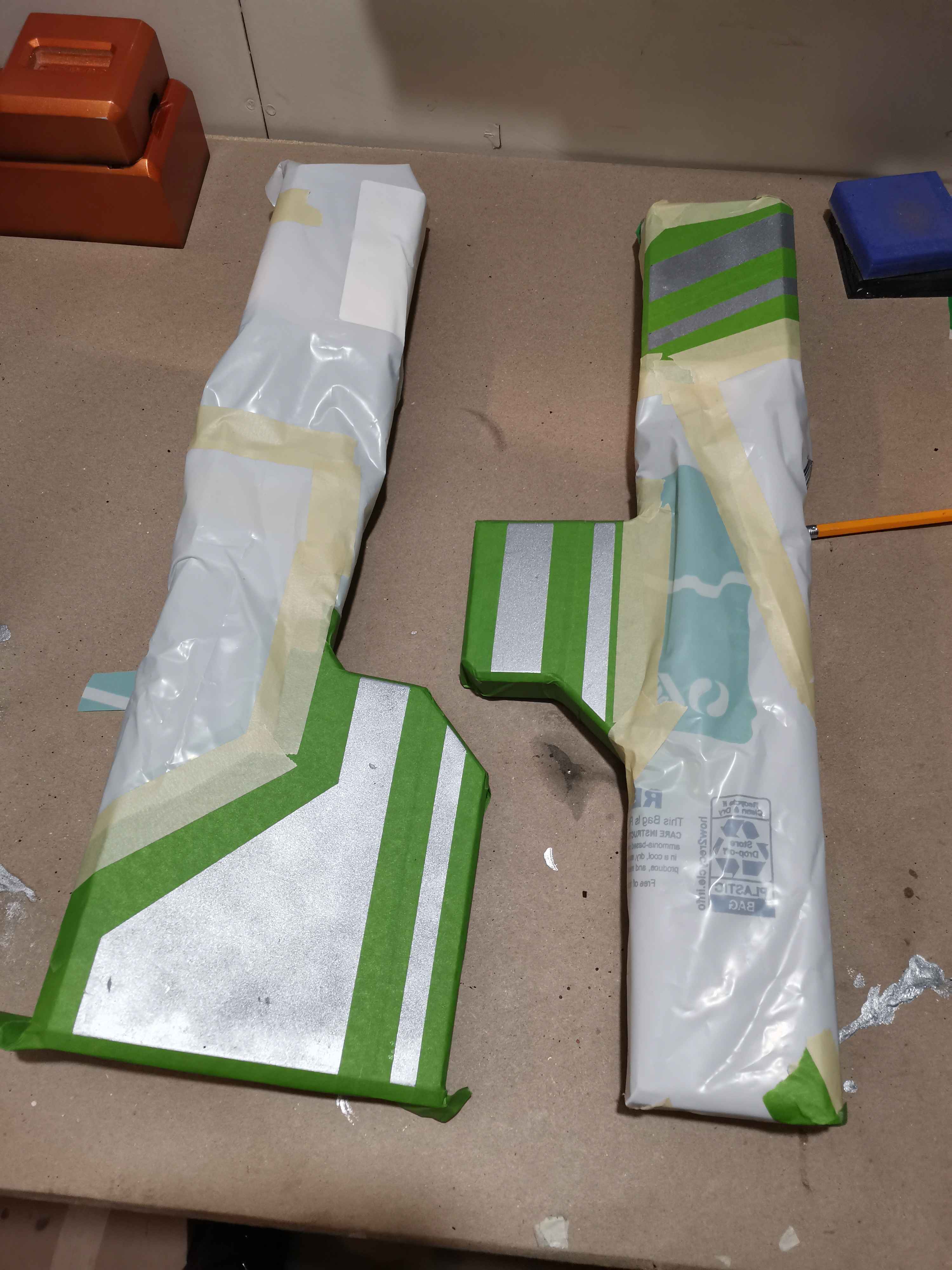

Then more masking and more painting. I had like juuuust enough of that orange paint, but ran out of the blue half way through obviously and had to get more.
Also added some light coats of black airbrushing to the vent slots and some of the hard edges. I'm not quite confident enough to do that with the panel lines so those just get some watered down washes with a brush.

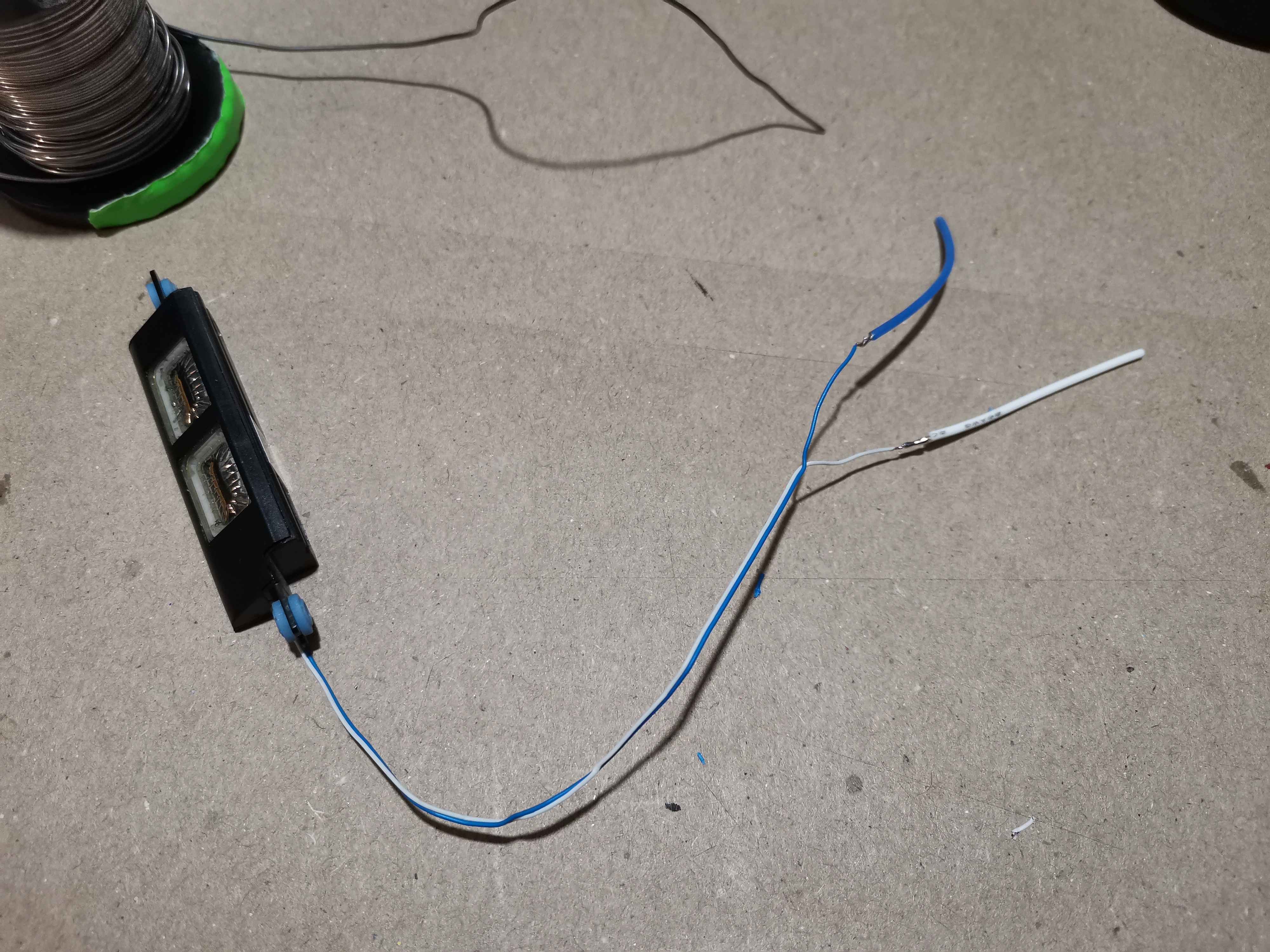

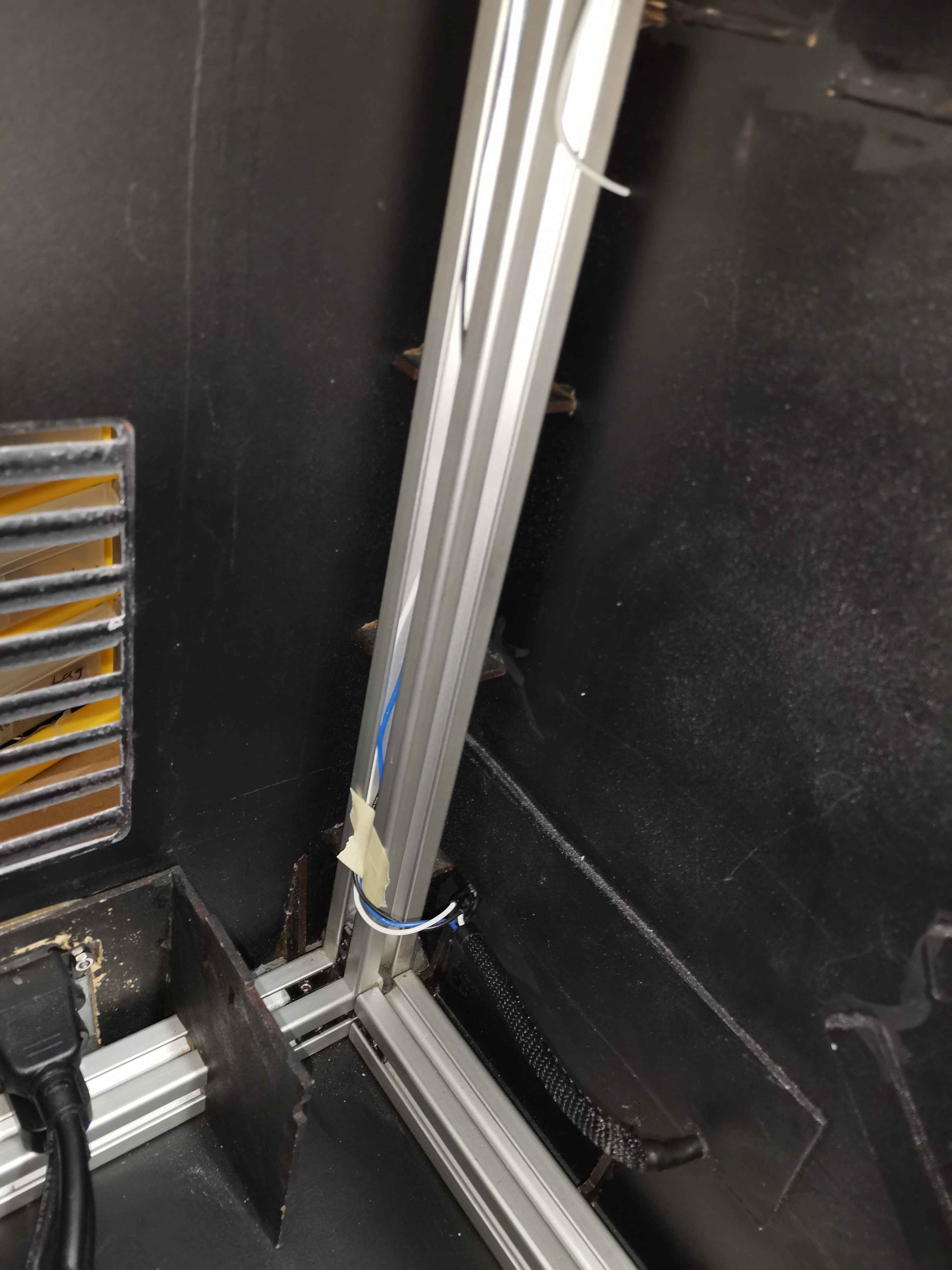

Then it was finally time to plan out the wiring for the LEDs. I'm trying to keep them fairly hidden, so I'll be running them inside the grooves of the aluminum rails. You can see where the LEDs for those little latch looking things on the side panels attach through the inside on the second pic there.
Speaking of LEDs, now's also the time to finally add all the diffusion for the LEDs on the orange parts.

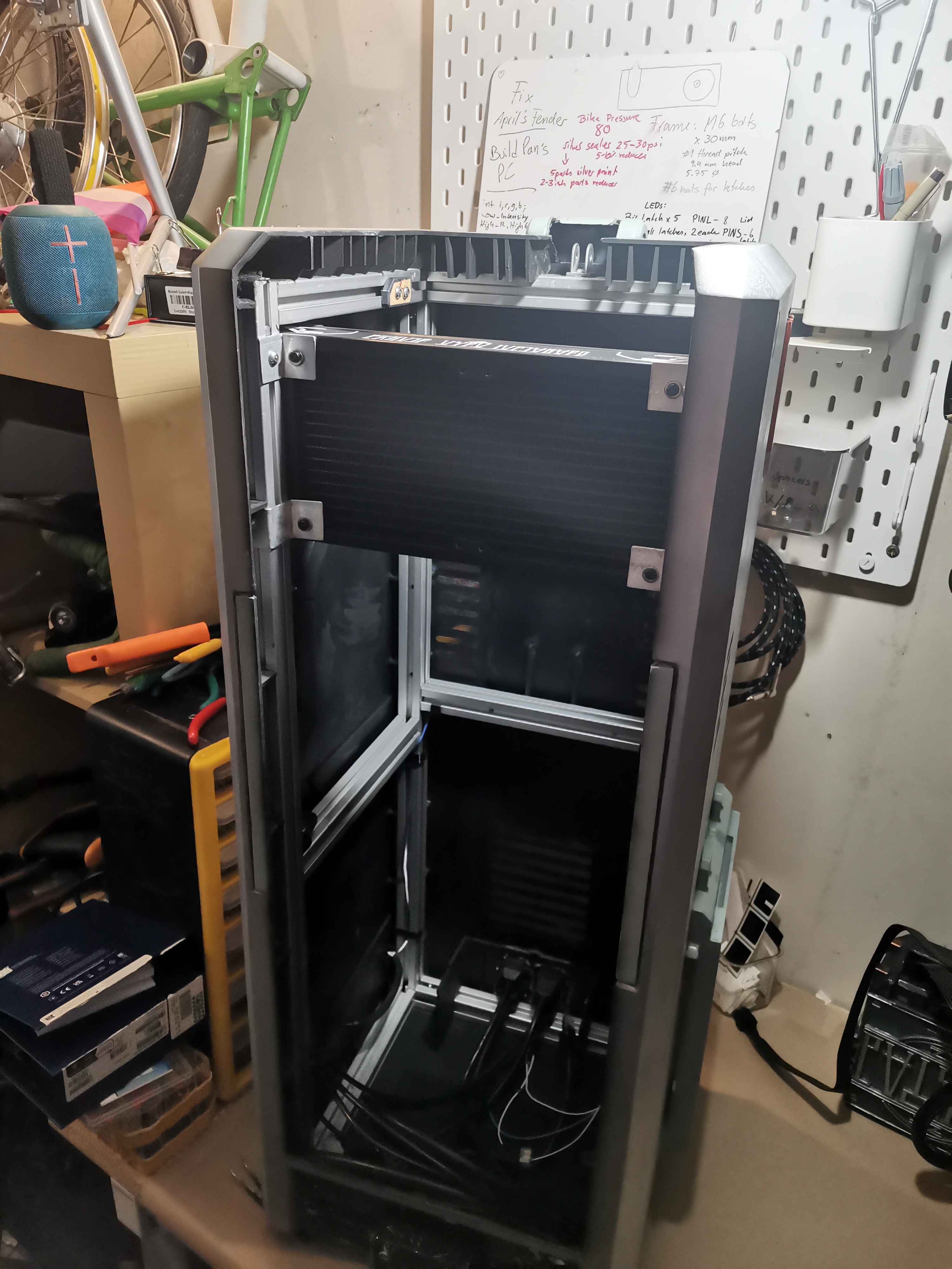

I wish I could say that the hard part is now done, but it's very much not since I still need to fit an entire pc inside this thing. Finally attached the radiator brackets and test fitted the radiator (it somehow fits, even with my questionable alumnium bending skills lol). Somehow I also forgot to unmask the ports on the back of the case after painting so I freed those as well.

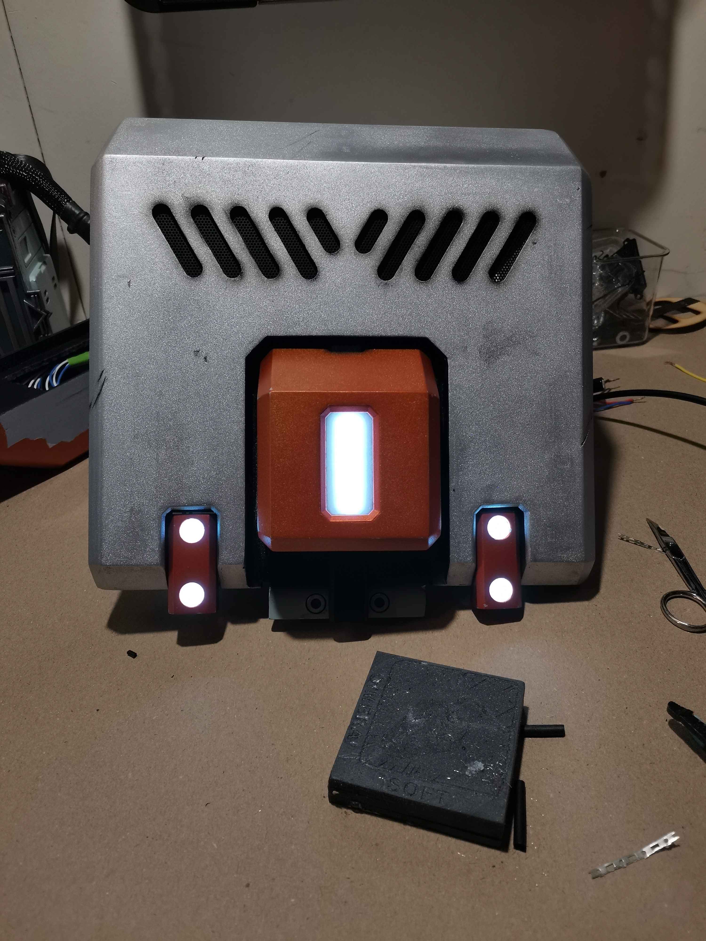

Also, time for some lights. Doing all the cable routing and making sure to test everything as I go. I did end up having to pull one LED back out of one of the latches bc it wasn't working for some reason and replaced it with a fresh one, which was definitely nerve wracking to say the least.

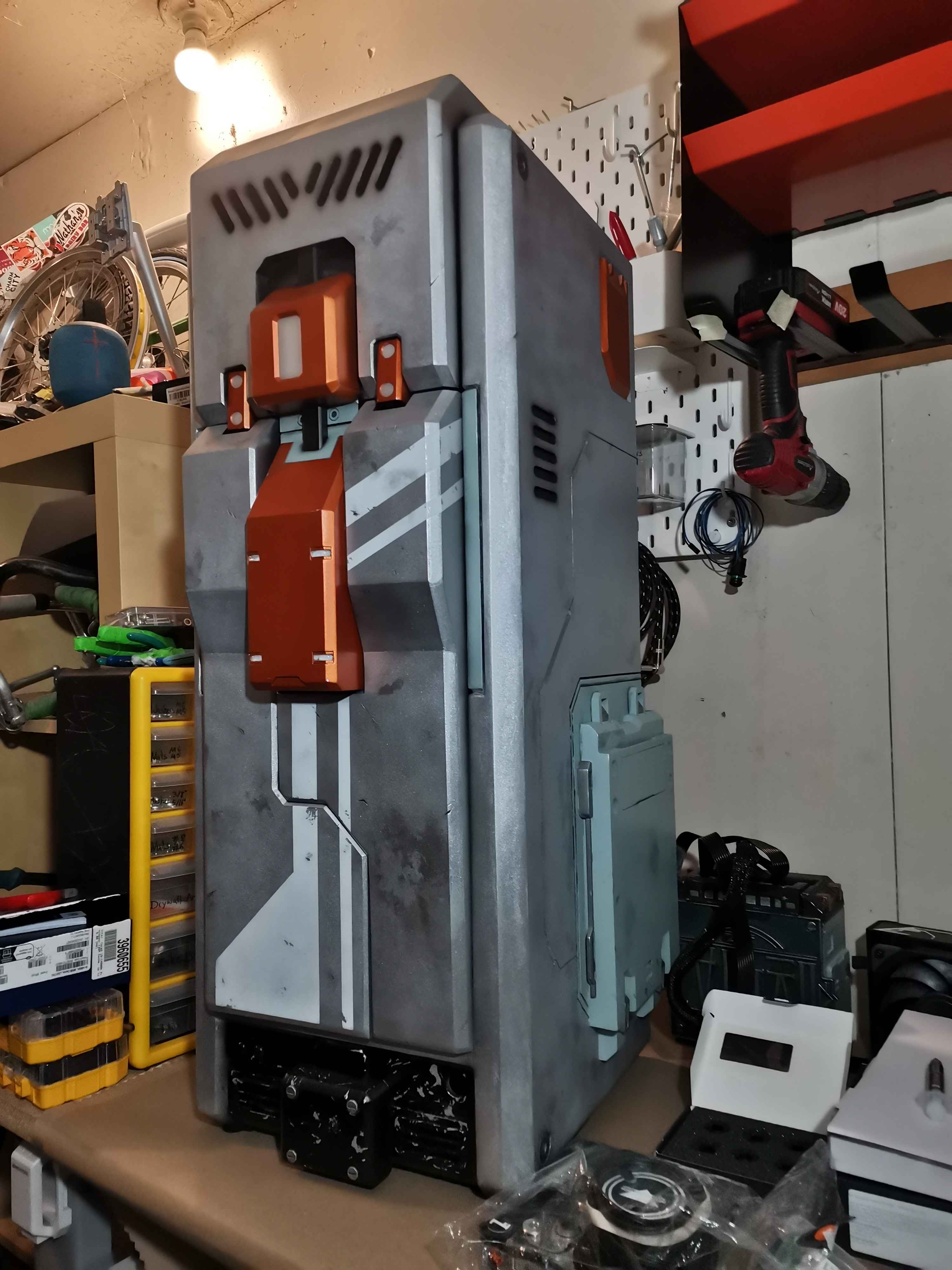

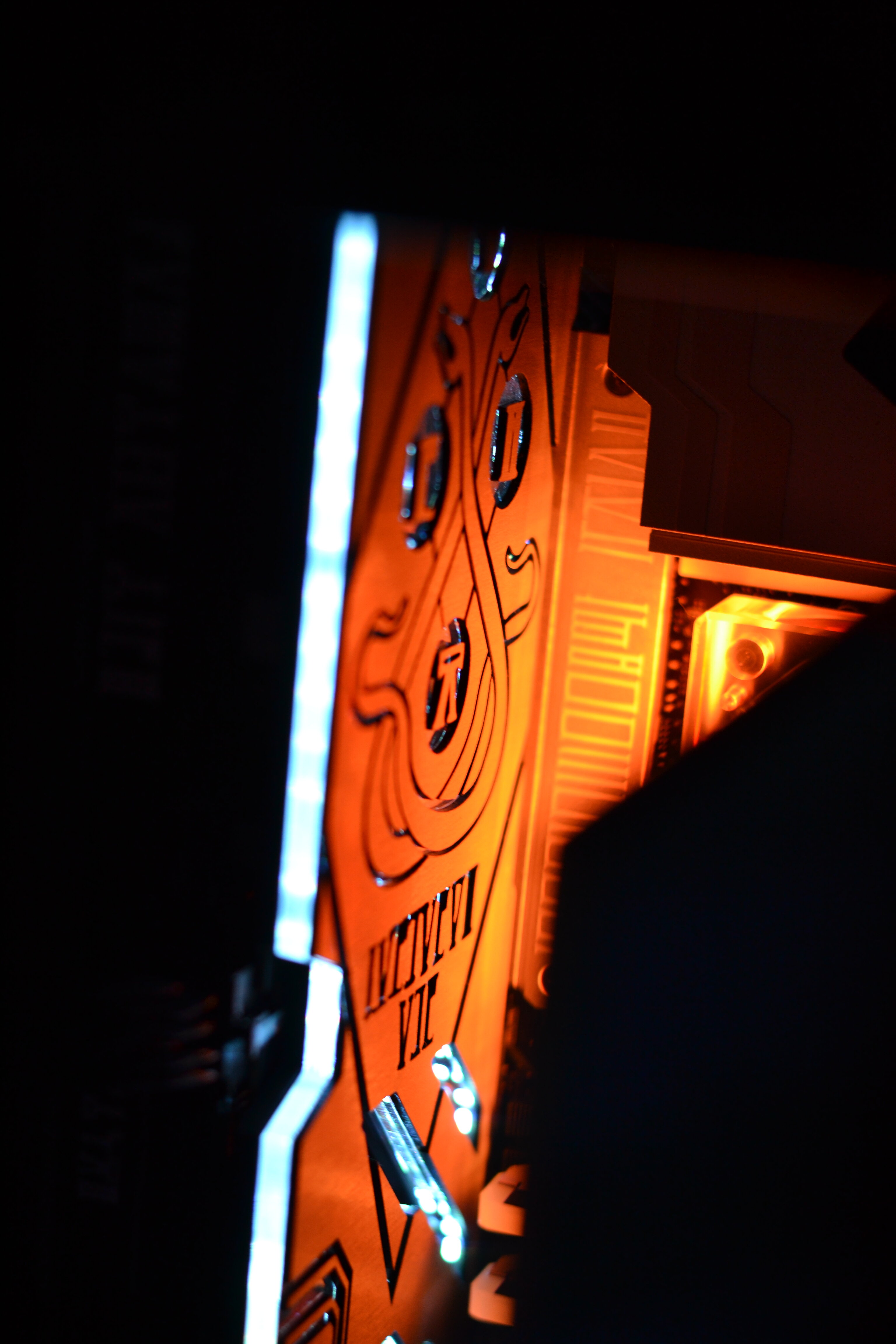

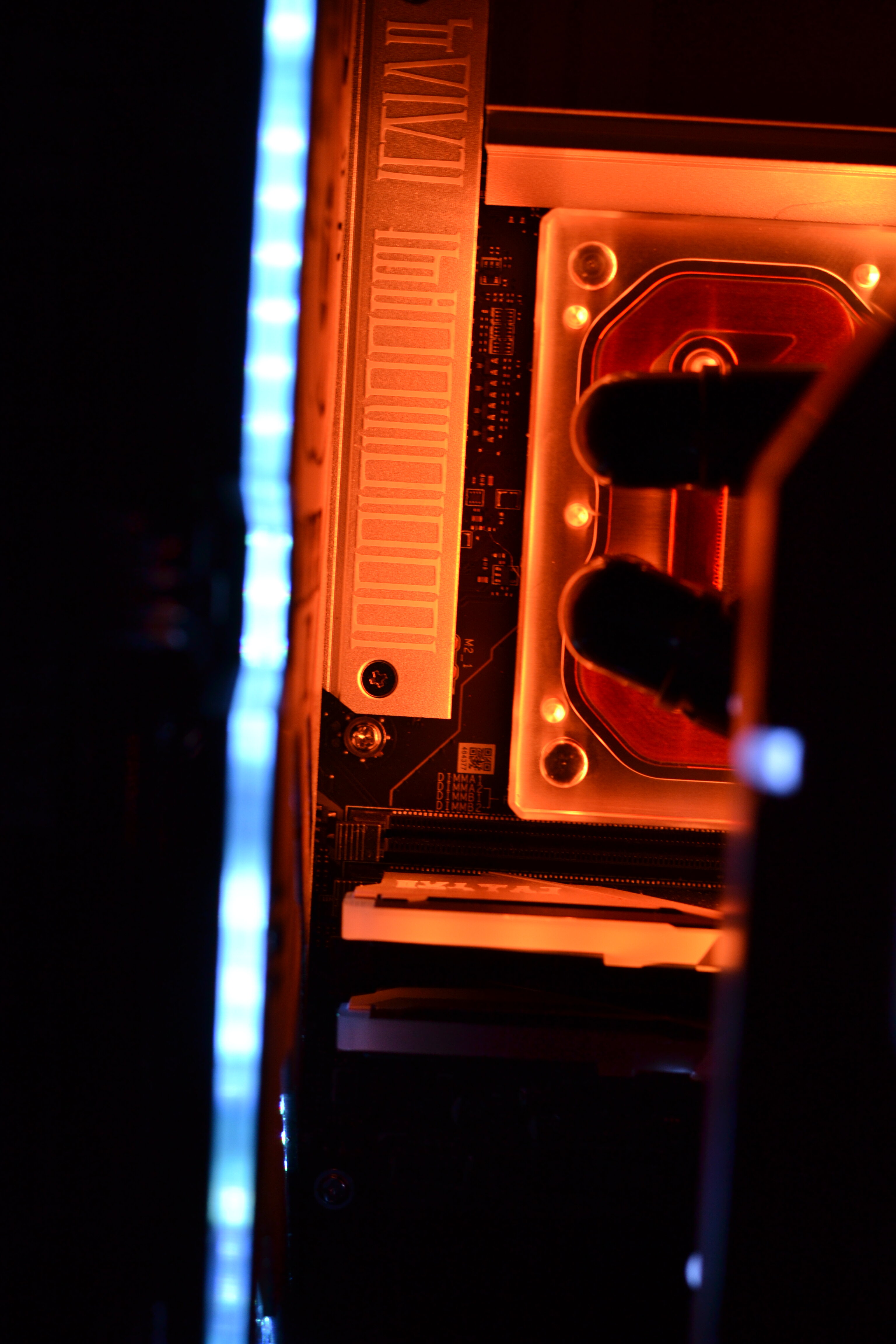

And the it's finally all done!
And here's some more fancy photos (courtesy of FaultyVi) from PDXLan, where I entered in the case mod contest with it and won first place!
