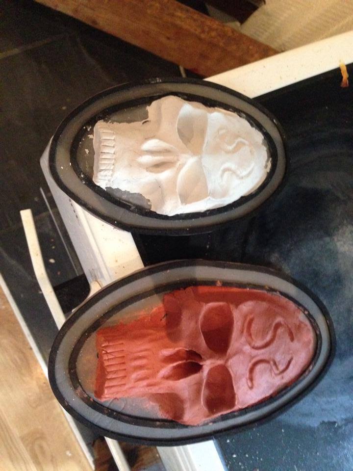

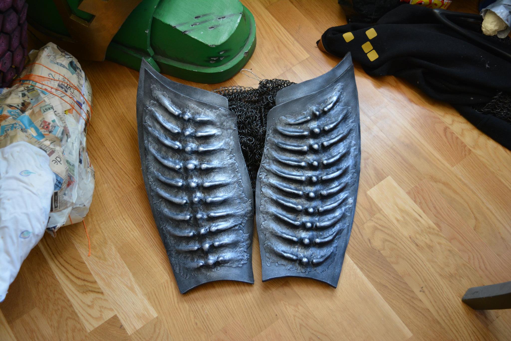

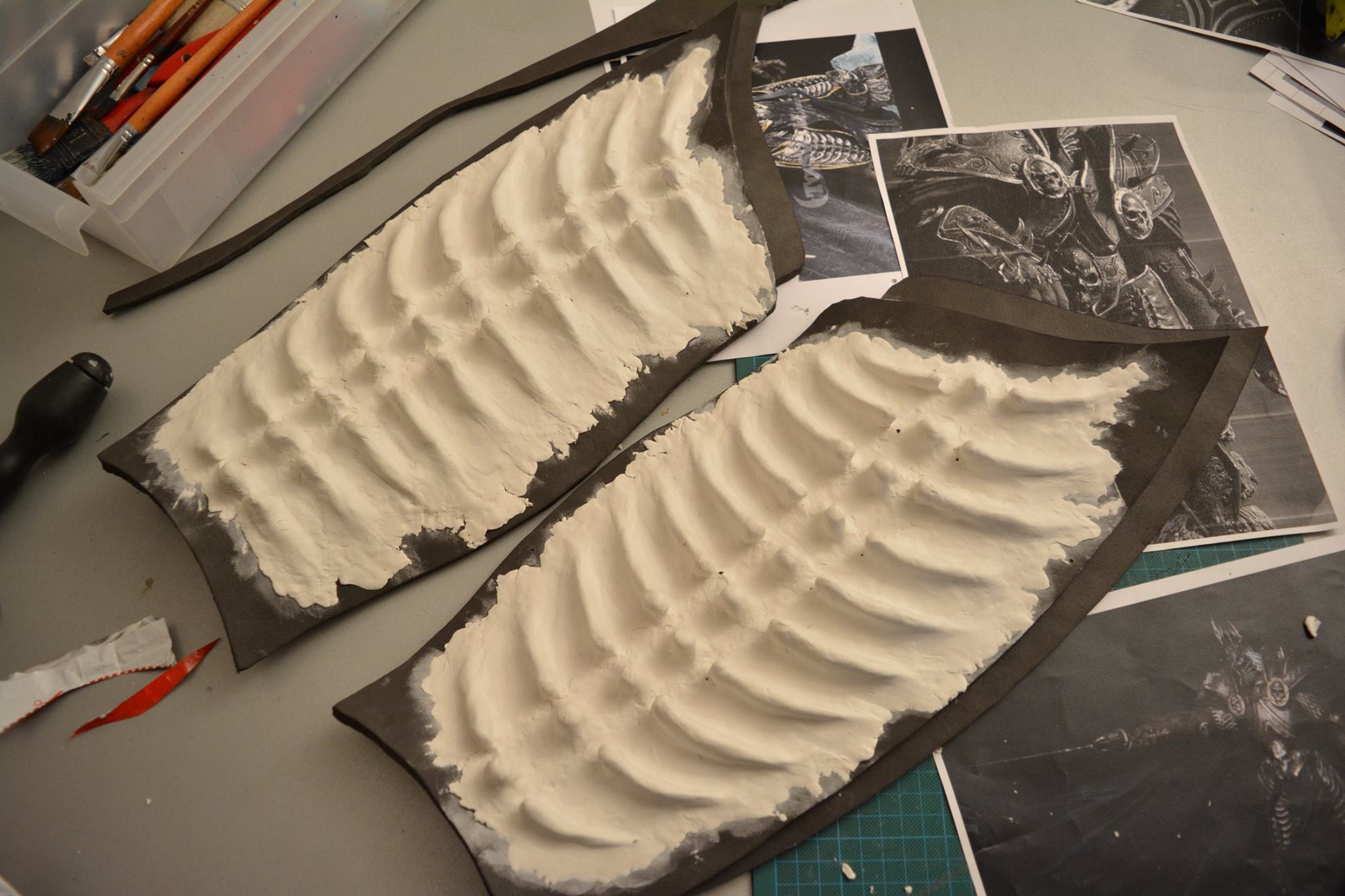

With the sword finished, I've set to work on the armour parts again. Now the thigh plates, or whatever the proper armourial term would be...
11121990_494725174025924_1357706929574903037_o.jpg 906023_496678873830554_2343863871238661084_o.jpg 10631247_496678880497220_2396059406955089834_o.jpg
Only missing the gold trim now.
The shape was made with ordinary paper clay, formed around a core of hot glue to give solid adhesion to the foam underneath. I considered thermoforming something over the clay, to keep it from breaking or to replace it entirely, but it seems to hold together. If it breaks, I can always replace it with whatever I shape over it.

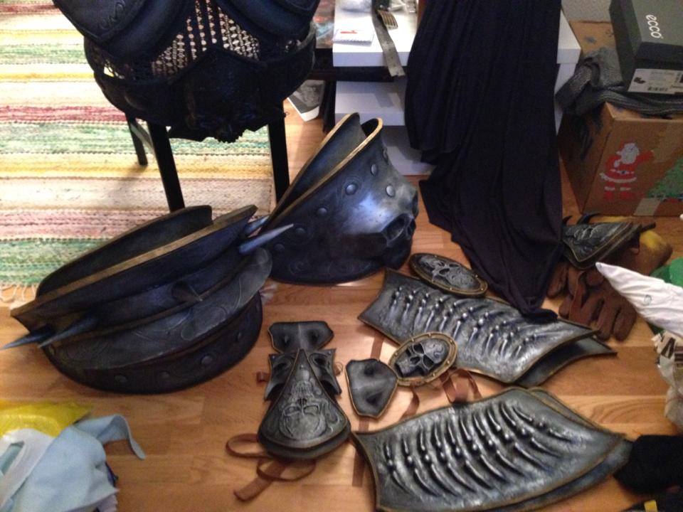

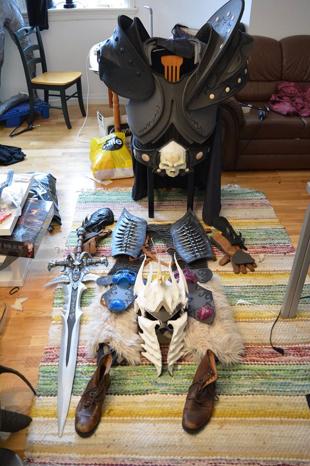

Allright, so in a mad rush of creation I (almost) finished the Lich King in time for Närcon in Sweden!
Photo by Daniel Häggmyr, for Närcon Summer
For your reference, I'm including the WIP shots as well, to see how it was built.

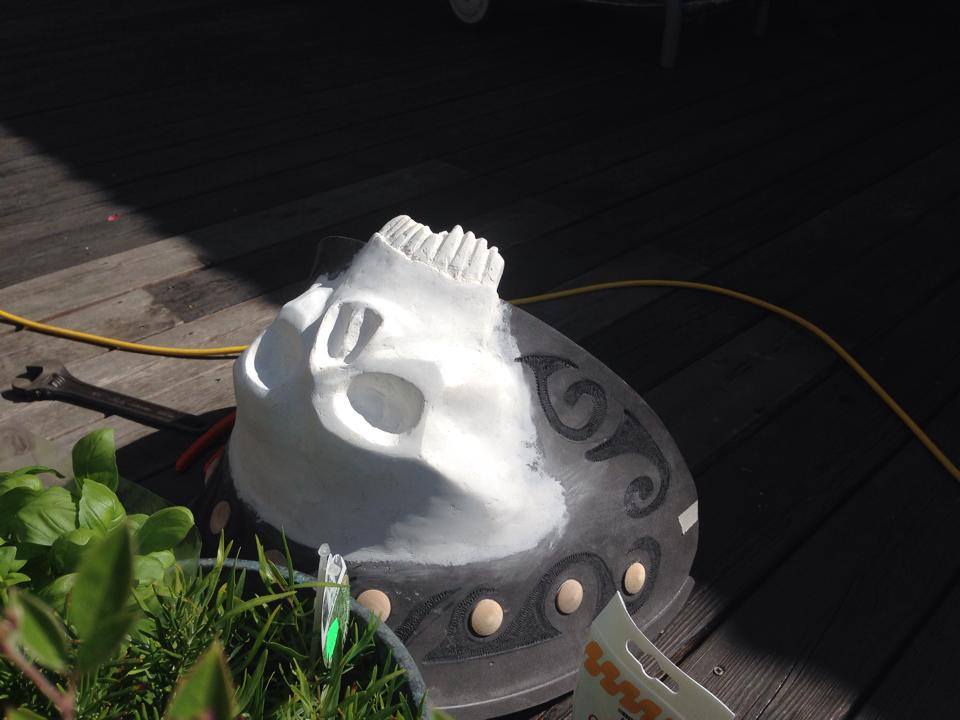

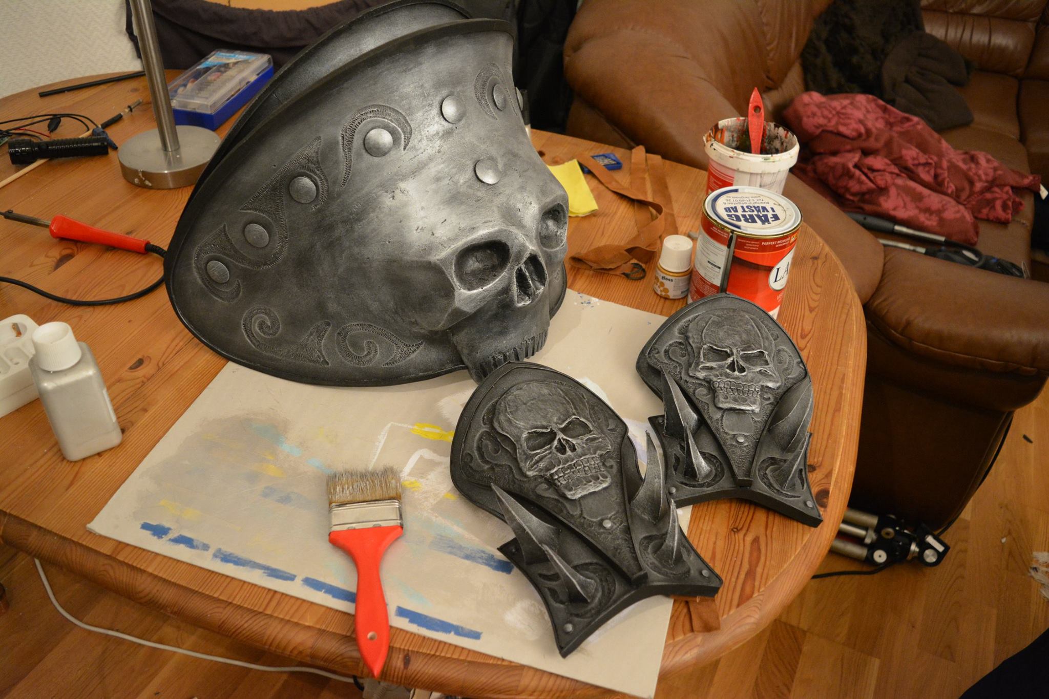

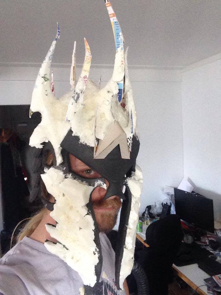

Bulk parts were constructed from cereal package and covered in expanding foam. Then carved into shape.
And then covered with lightweight spackling compound, sanded, speckled, sanded and well, you know the drill...

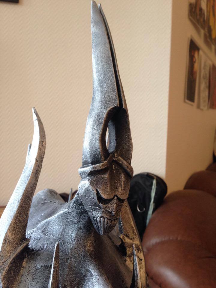

I didn't have time for much bisect work, so everything was covered in black wall paint and mashed with silver.

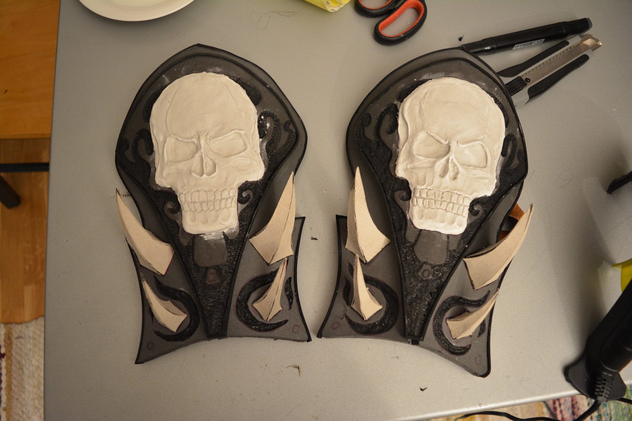

Some parts (like this cuddly, undead bunny) were sculpted from insulation foam, simply because there was no time to do it properly.
Others were made from clay and quick-dried in the oven.
Had a friend not been there to force-feed me chocolate and put me back on the chair when I missed it, I would not have made it. But with only a few leather straps to adjust and additional rings to attach, we went off to Närcon! Success!
definitely a success! I was following the last few days of your build on Facebook and holding my breath hoping you would get it done in time!
