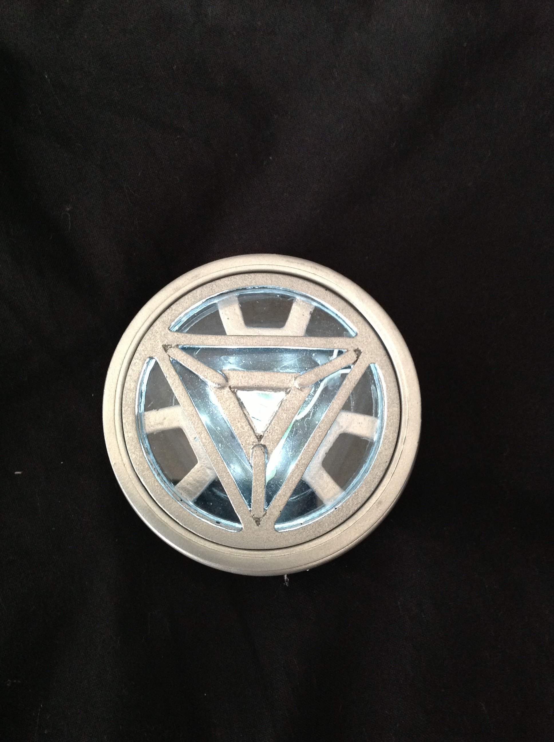

Ok guys, here's my new Reactor I'm working on. Tell me what you guys think.
Was expecting it to look a little better, but this is the best I was able to get it at.
Great work man!:) :D

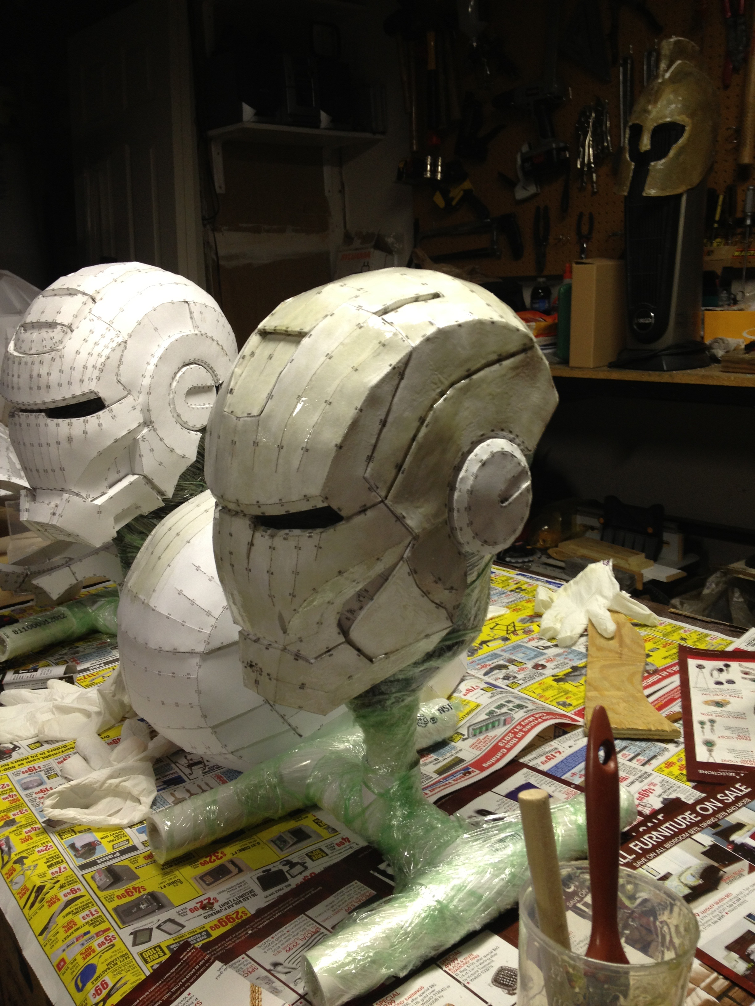

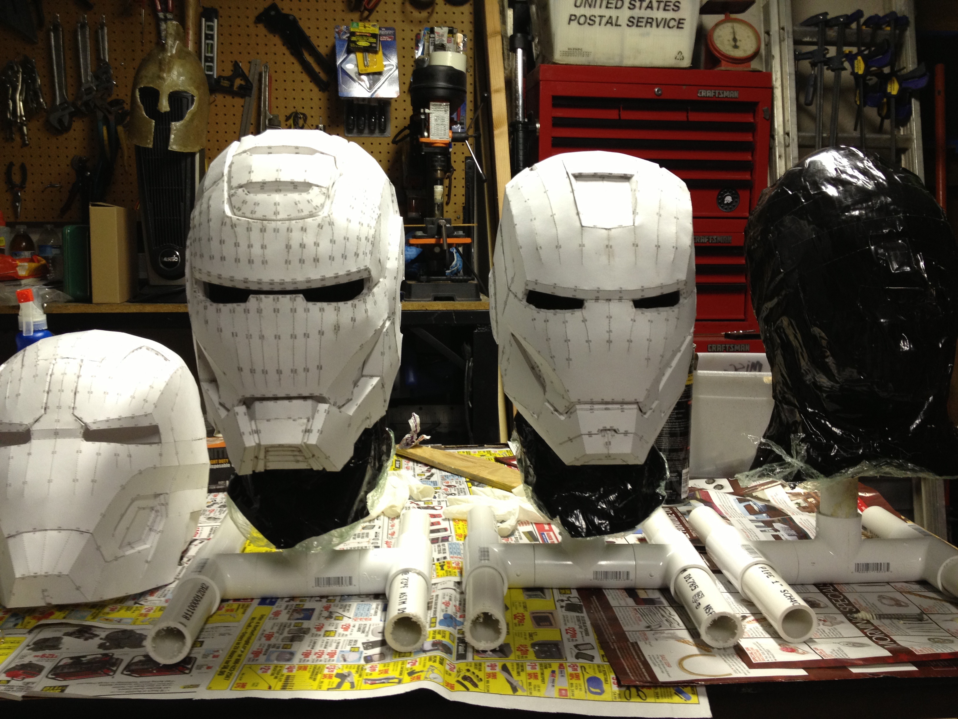

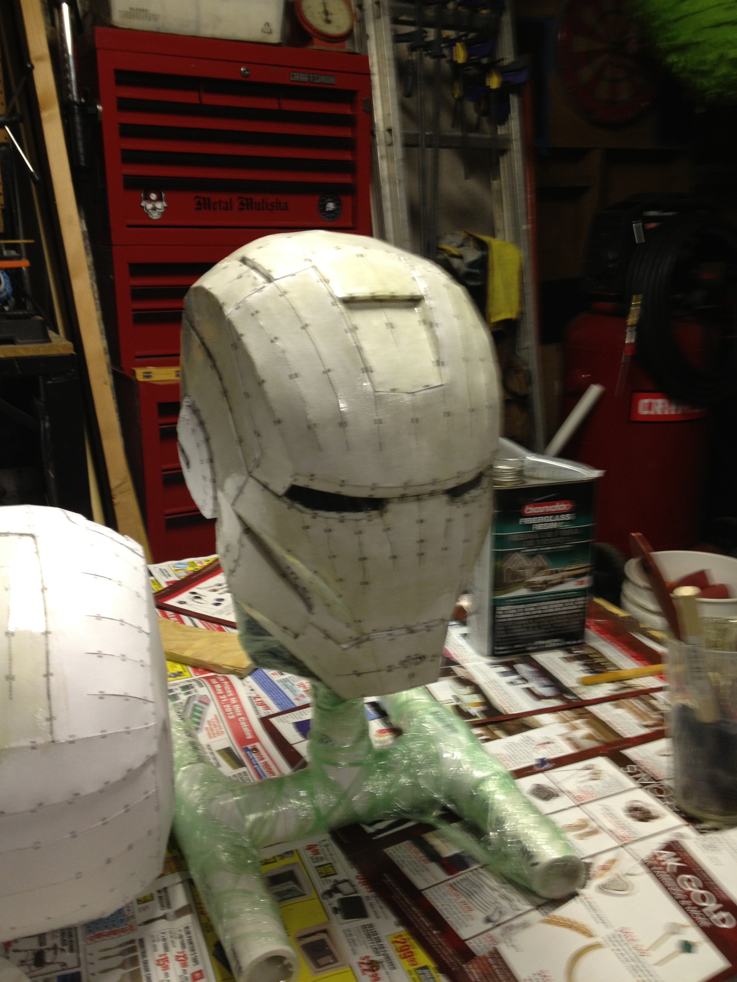

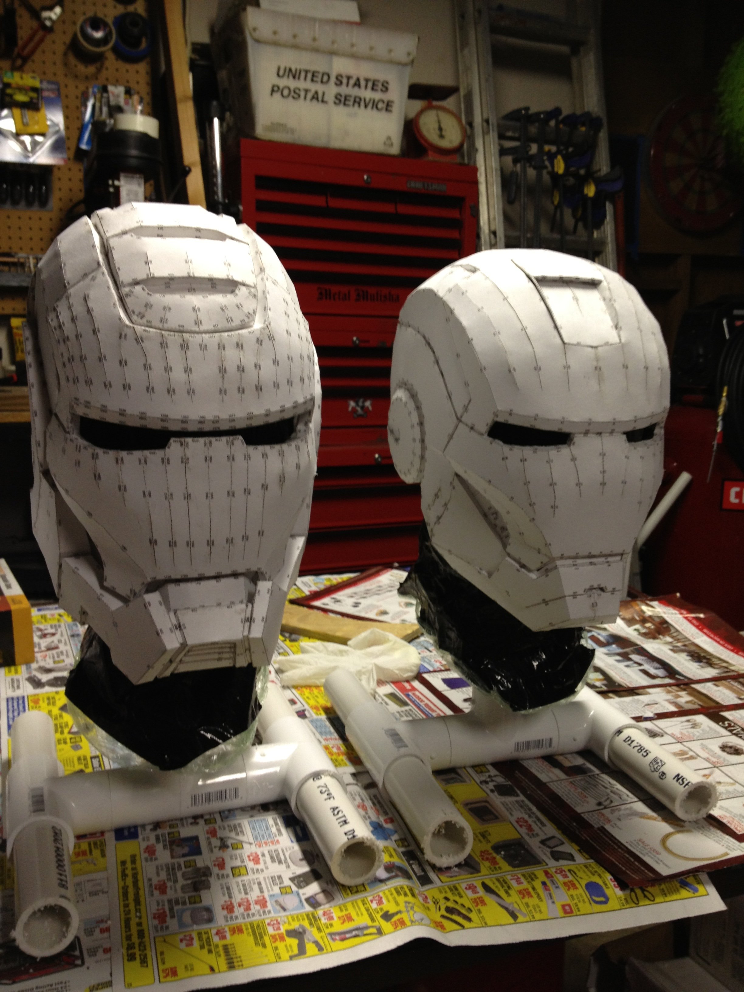

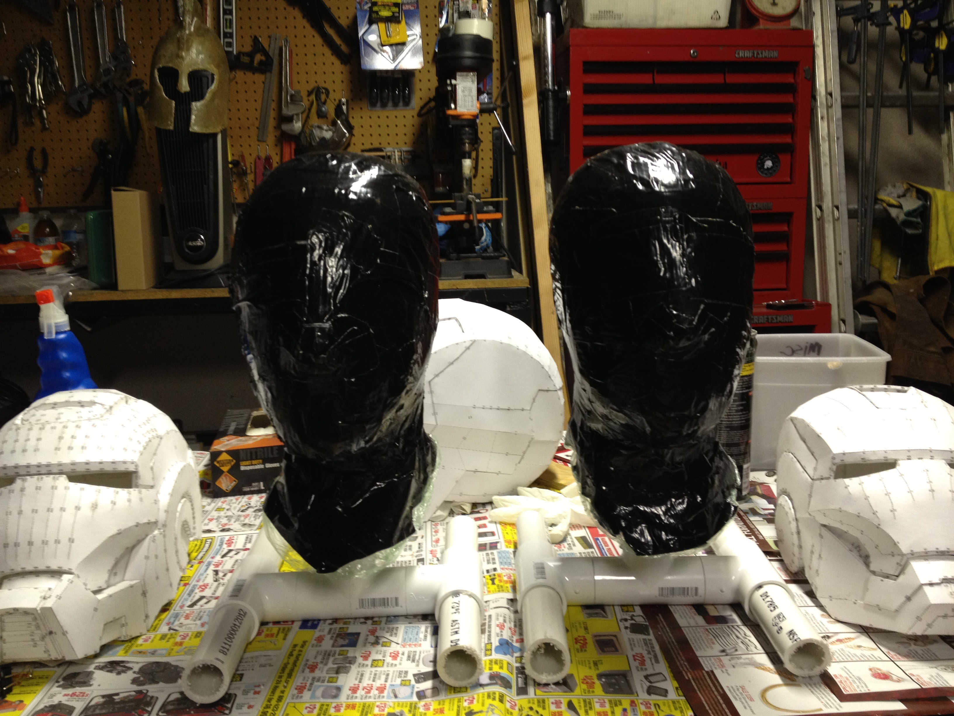

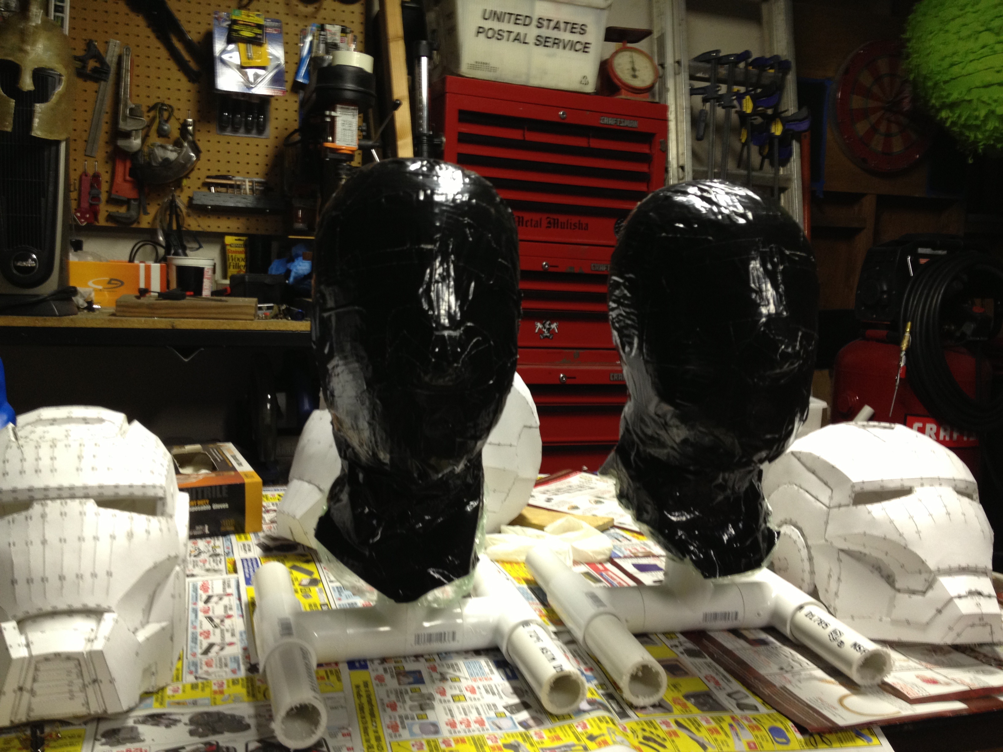

Made my head manikins. Ready to fiberglass the helmets.
Shrink wrap roll, get it at Home Depot. Small roll with handle. Roll of black duck tape, also at Home Depot. 1 inch PVC piping, with (3) T fittings. First you wrap your head with the stretch wrap, then duck tape your head. FYI: have somebody do this for you. And make sure you can breath, lol, #1 rule:D. Cut it from the back and take it off and re duct tape it back. Tape up the mouth, nose, and eyes. Place the pipe inside and stuff it with paper, newspaper, etc. and towards the end a little expanding foam, also from Home Depot. Hope this works for you. Pm me for more info. Ttyl bro.
