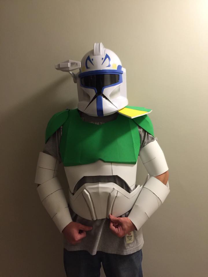

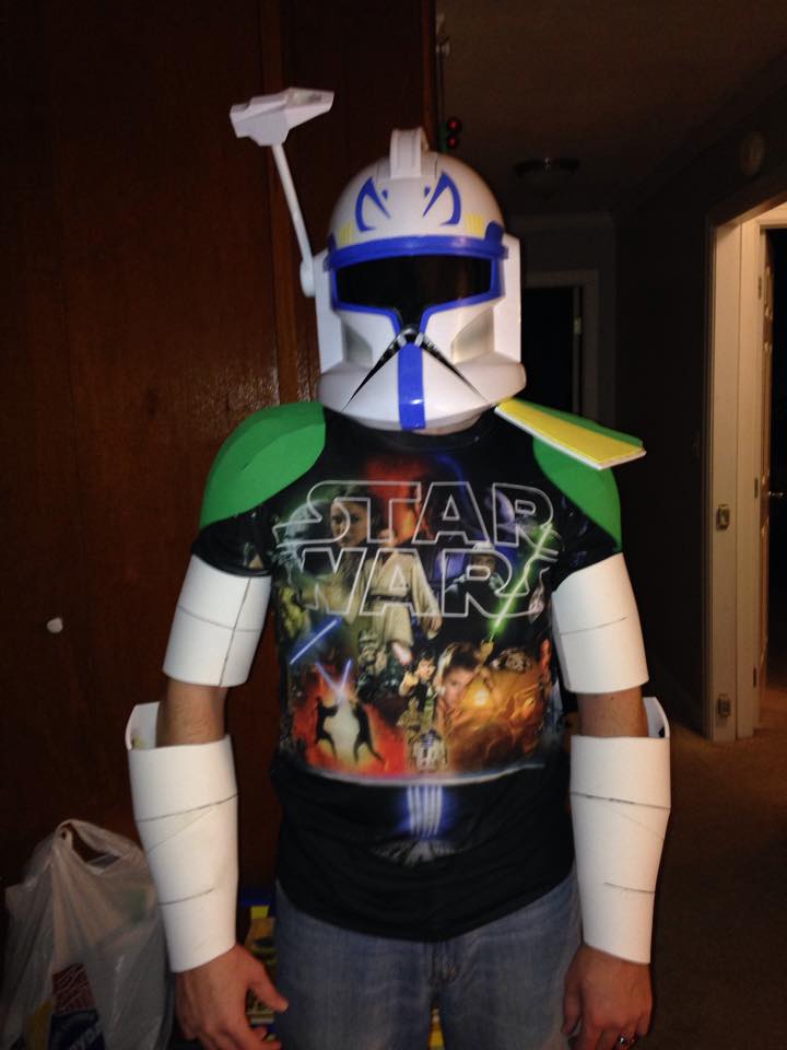

:confusedI was just curious if anyone had ever tried painting foam with a Wagner Paint Sprayer and regular latex interior house paint. I have heard that the latex house paint is flexible on foam and as long as you have a good base layer and a nice protective layer that it may work.
My idea was to plasti dip the base coat. Spray the armor with regular interior latex paint (House paint from Lowes, Home Depot, etc..) with a Wagner Sprayer. Then I planned on capping it off with a clear coat of plasti dip as a protective layer.....
