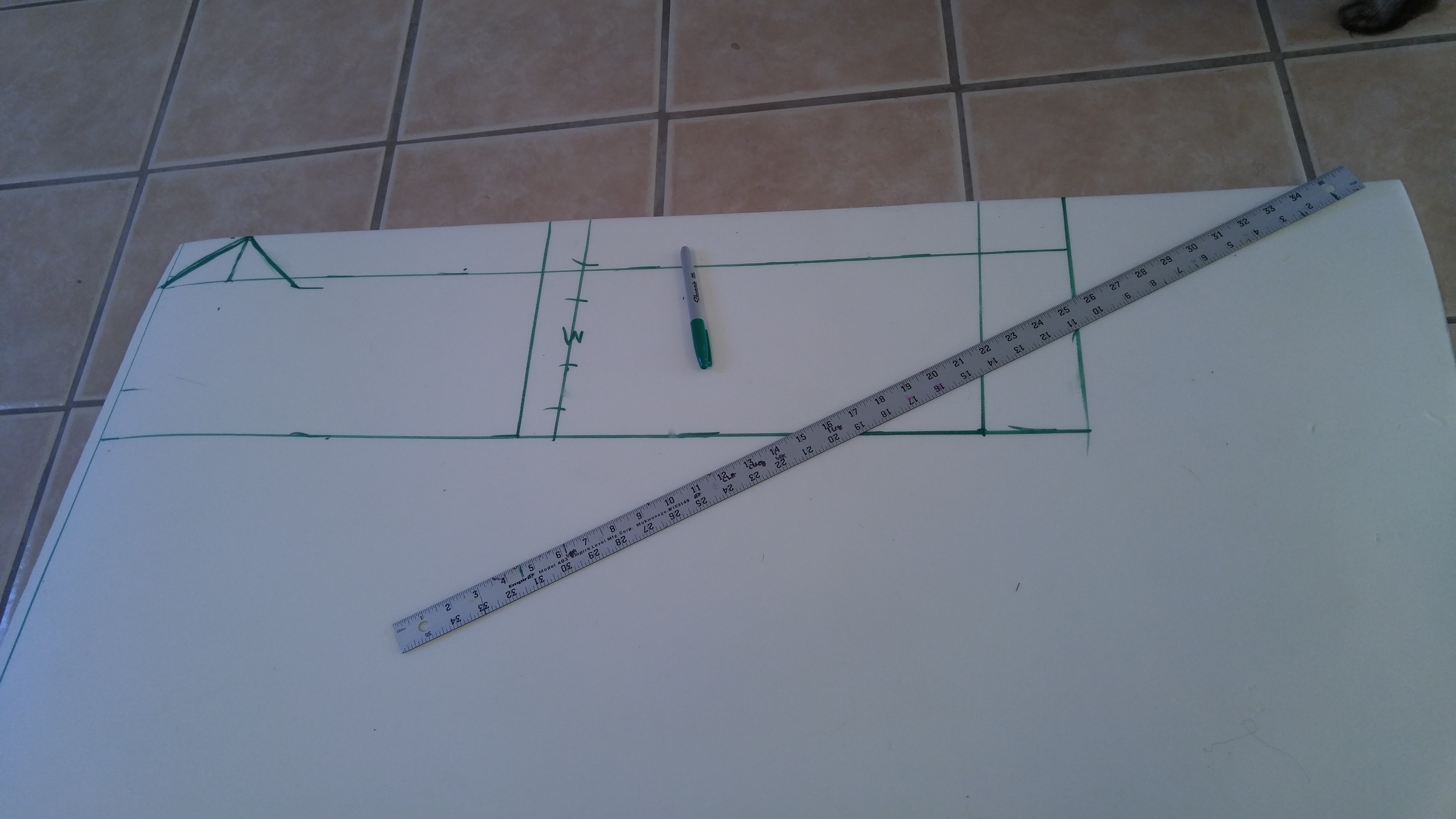

After securing the wrap with some masking tape I used my reference art, my own schematic drawings and some sharpies to draft out the patterns....
When I was comfortable with the draft I cut out the patterns and laid them out for review...

I started with the chest piece as that seemed a goof place to begin and I felt most comfortable with the pattern for that item. Once all of the little pieces were cut (I used a VERY sharp utility knife - be prepared to go through LOTS of them OR have a sharpener as foam dulls knives quickly) I placed them together to test the fit then began gluing them with contact cement. NOTE: Contact Cement is TOXIC - wear gloves, a respirator and be sure to ventilate the room your are in. I used Weld Wood Contact Cement for this project (you can buy small and large containers of this at about any hardware store).
The next step in this process was applying detail to the 3/4 foam chest plate. I used 1/4 inch foam cut into strips (a trick to get straight cuts: lay masking tape down on the foam first and use it as a guide for cutting - it's MUCH easier than trying to hold a yard stick down or following a sharpie/pen line) then applied them in layers using contact cement.
