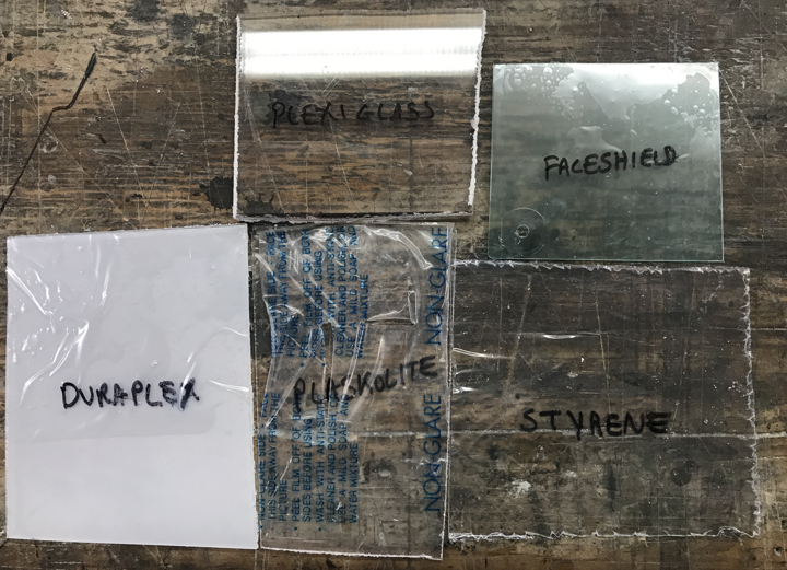

I will be testing all these products on a variety of plastics that may be used for visors in various cos play projects. Standard Plexiglass, Safety Face shield plastic, Duraplex, Plakolite (with one non-glare side), and Styrene.
So for these tests, I wanted to first establish what products worked on what plastics so I applied each product according to the directions. This means that they all were fairly thick and non-transparent just to see which products produced a mirror type effect. Also, for the Spaz Stix, I used a black backer paint as directed by the instructions. I only painted the black backer on about ½ of each sample, that area is marked by the arrow and dotted line on each Spaz Stix sample.

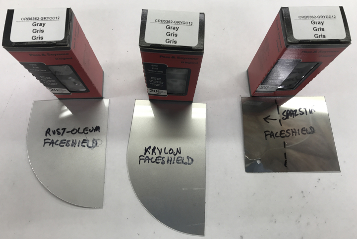

Ok so first up was the plexiglass. I used some boxes with text and color on them to judge the reflectivity of the paint. Here you can see that Rust-Oleum was only somewhat reflective and very dull. Kind of like a stainless Steel or brushed steel look. The Kyrlon was a bit more reflective like a shiny steel look. The Spaz Stix was very reflective and clear.
Next up is the face shield plastic. On this medium, the Rust-Oleum failed to produce a reflective look. The Krylon was only barely reflective; however, the Spaz Stix was once again a mirror finish.
