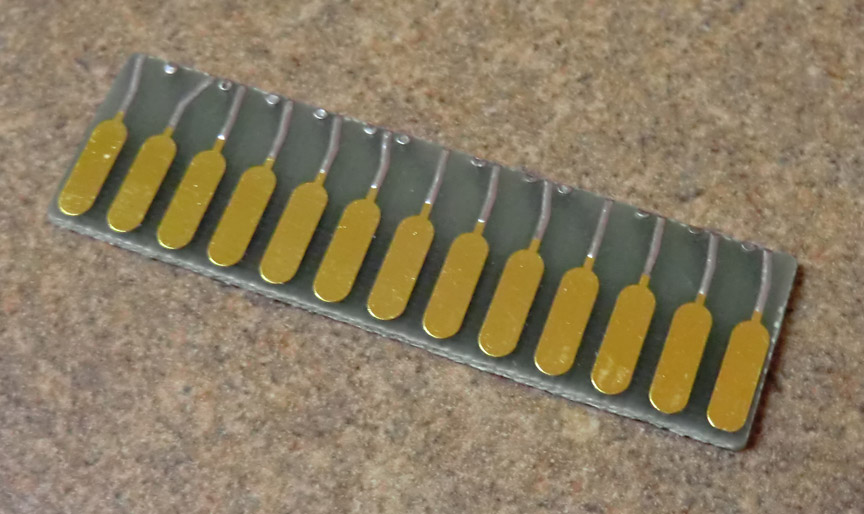

I got one from him too:

The real ESB card had rectangular leads. We've now seen two real relic props that fit the bill, the graflex in the archives that traces back to the films, and a casting of the Shared Stunt during production. the HP was an early theory, but it seems HP boards have leads that are very round indeed.
Also, the correct plug is a 22 or 44 pin connector. Even then, only some have the right sized gold leads and silver traces.

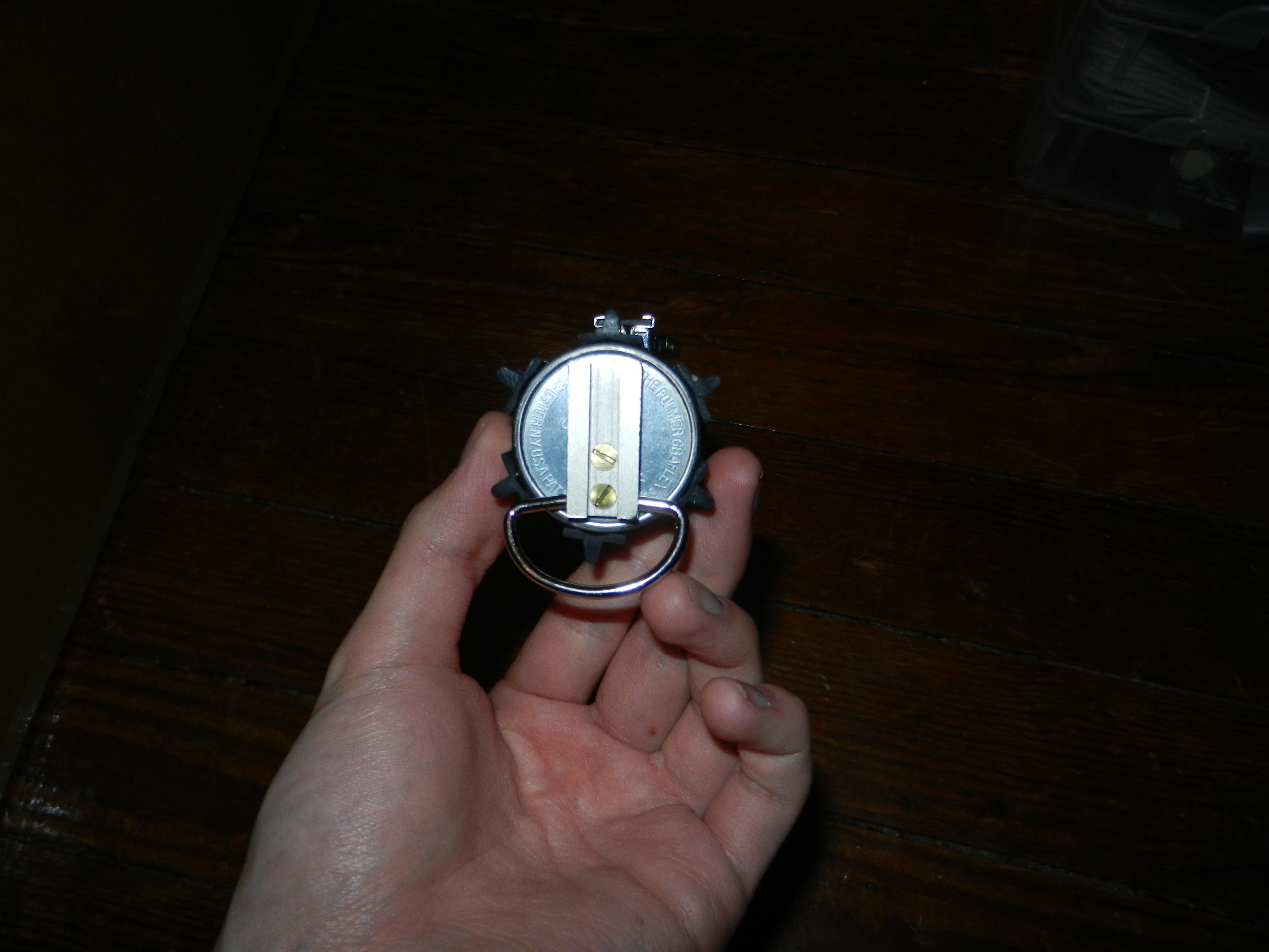

Yep! Roy's Kobold Clip was a great thing for this community. Yodas House, or Blast-Tech had pretty good parts for the day, but he's now out of business anyways. Here comes roy with an awesome personality, and much higher quality parts :lol
redbutton and I both have one of Roy's Kobold Clips on our ESB sabers. lets see if I can find a good pic of mine.
