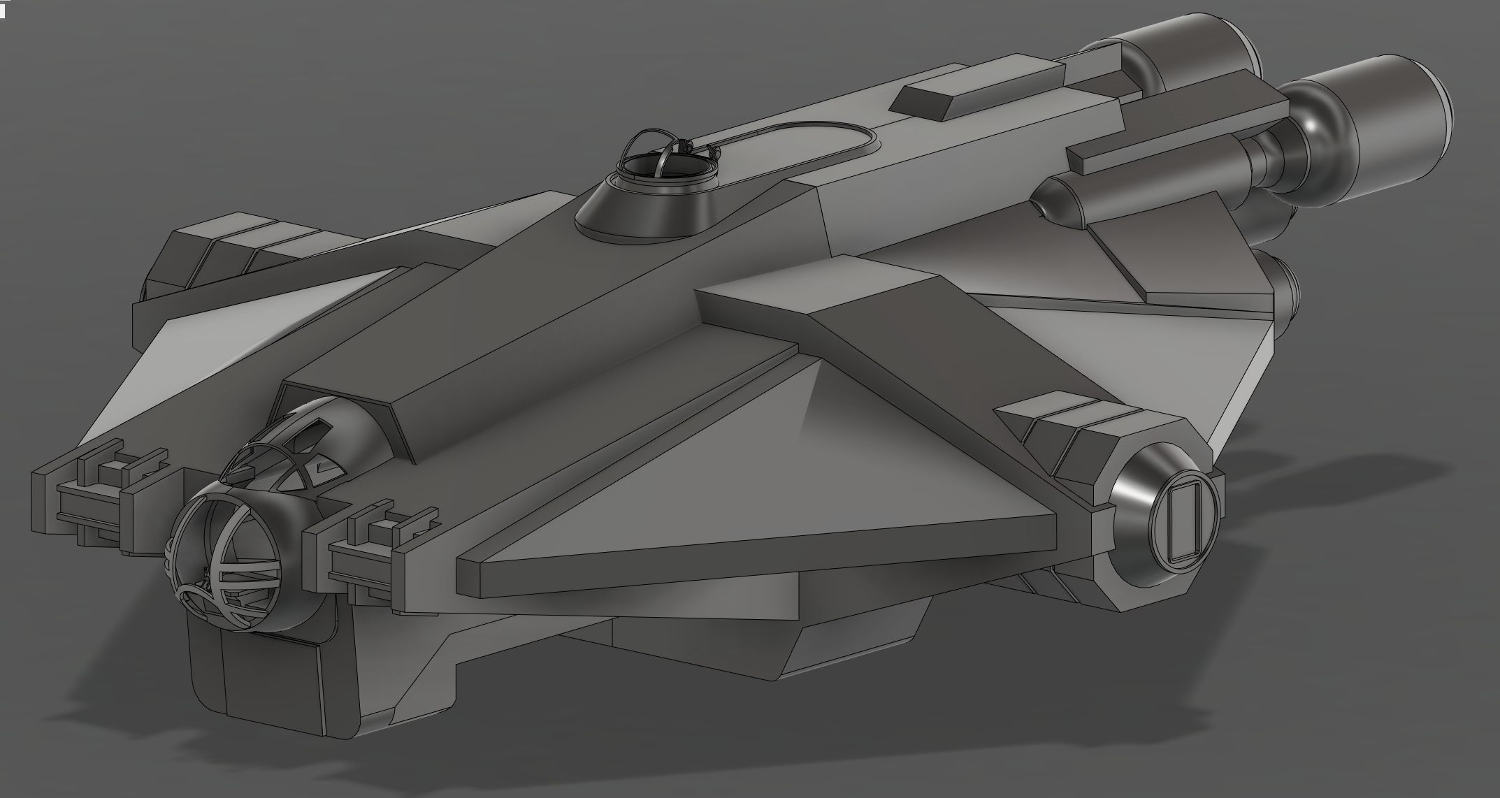

This is my turret so far. I had to make the frames a bit thicker to be suitable for printing.

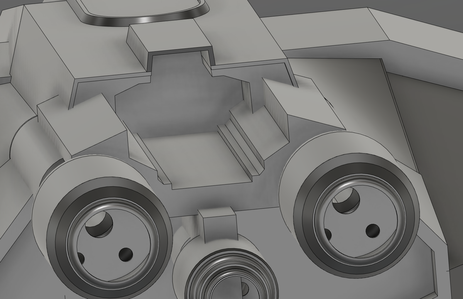

This is also my first pass at the Phantom dock. It gives space for the cockpit if forwards and the engines if backwards. I may have a look through the show and see if there are any shots of that area.
The dock needs to be deeper to accomodate the shuttle's nose. If you can make it out on my drawings, the plan view top has the space defined by green lines. Take a look at the relationship when it is docked facing forward:
Also, the smaller engines may be arranged too high in relation to the larger engines, by just a bit...
Sorry if I seem to be critical, just hoping to relay some of the findings I hammered out while I was doing my similar adventure...
Regards, Robert
The dock needs to be deeper to accomodate the shuttle's nose. If you can make it out on my drawings, the plan view top has the space defined by green lines. Take a look at the relationship when it is docked facing forward:View attachment 1714713
Regards, Robert
Not critical at all, and I'm extremely happy to have the help! You have saved me a ton of research and I'm so grateful, thank you.
As I said, the docking space was a first pass and is easily alterable, as is the secondary engines. All of this will improve my Ghost, and hopefully lead to a much better file for everyone!

Well I'm calling the exterior shape and base details done and locked in;
