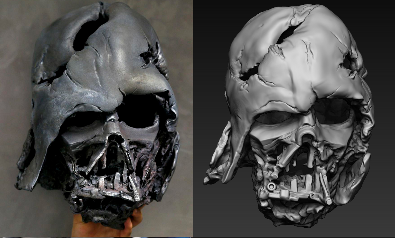

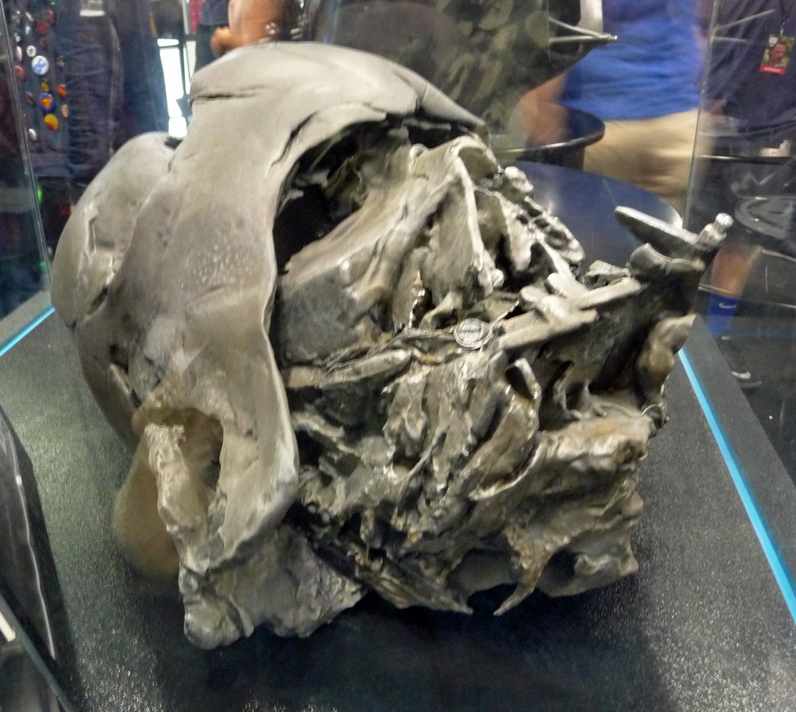

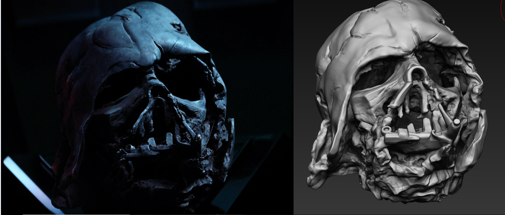

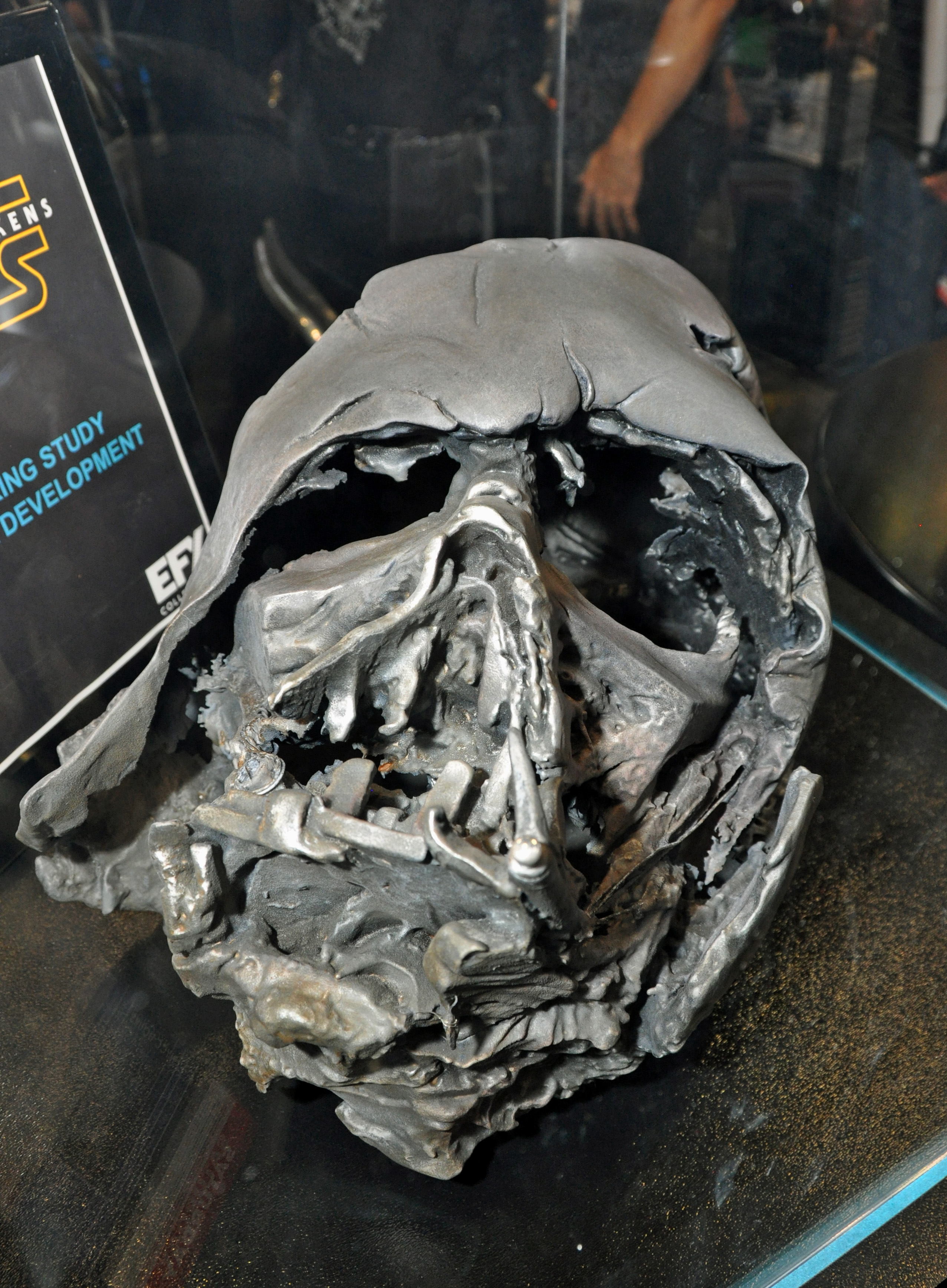

Could you make a direct frontshot of the helmet like this:
Great idea actually, thanks!
I took apart the print again for priming and sanding, but I will make a photo or two this weekend... But for now I can do that with the actual 3d model, so you can see it in comparision!

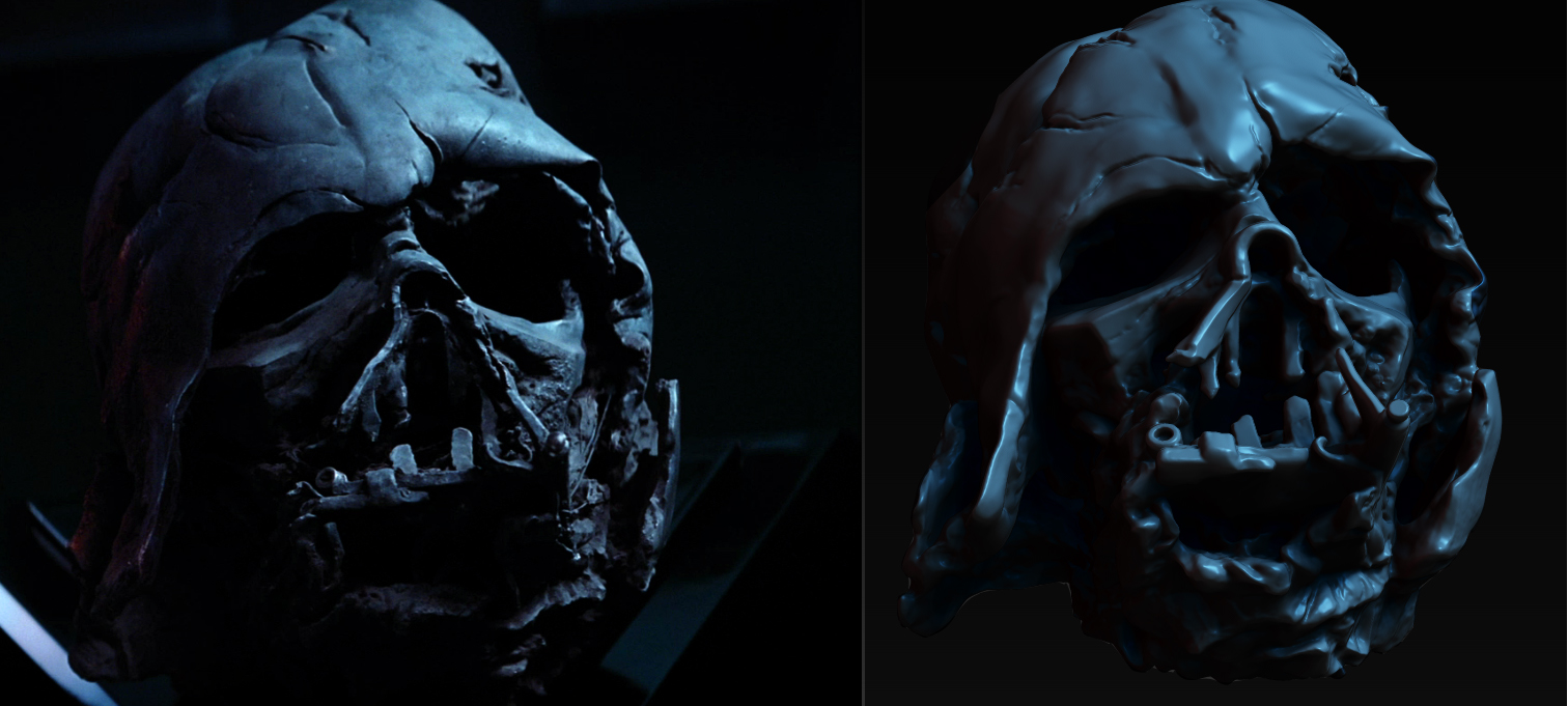

...and as a goodie, with a roughly matched up light setting:
Let me know what you think!

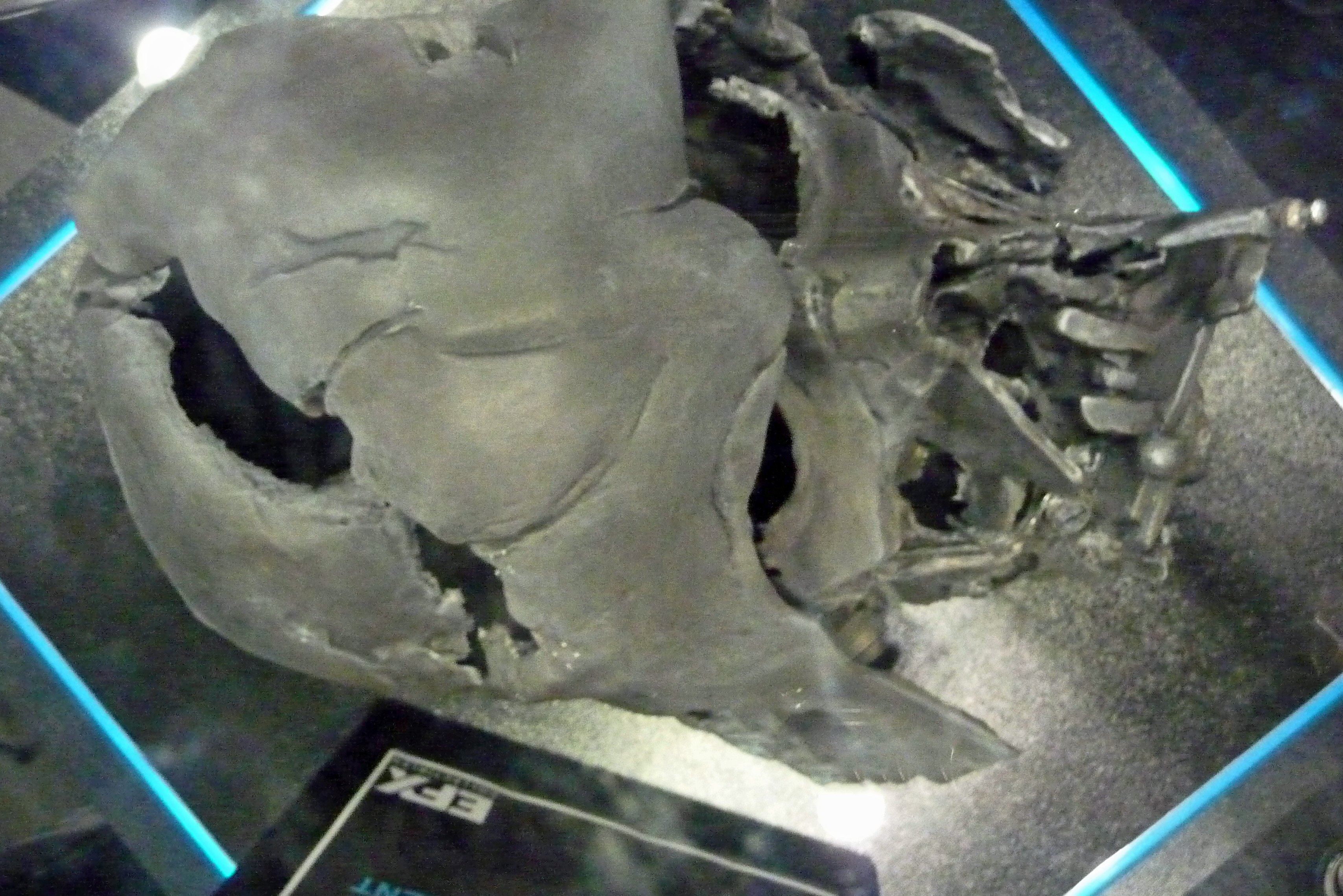

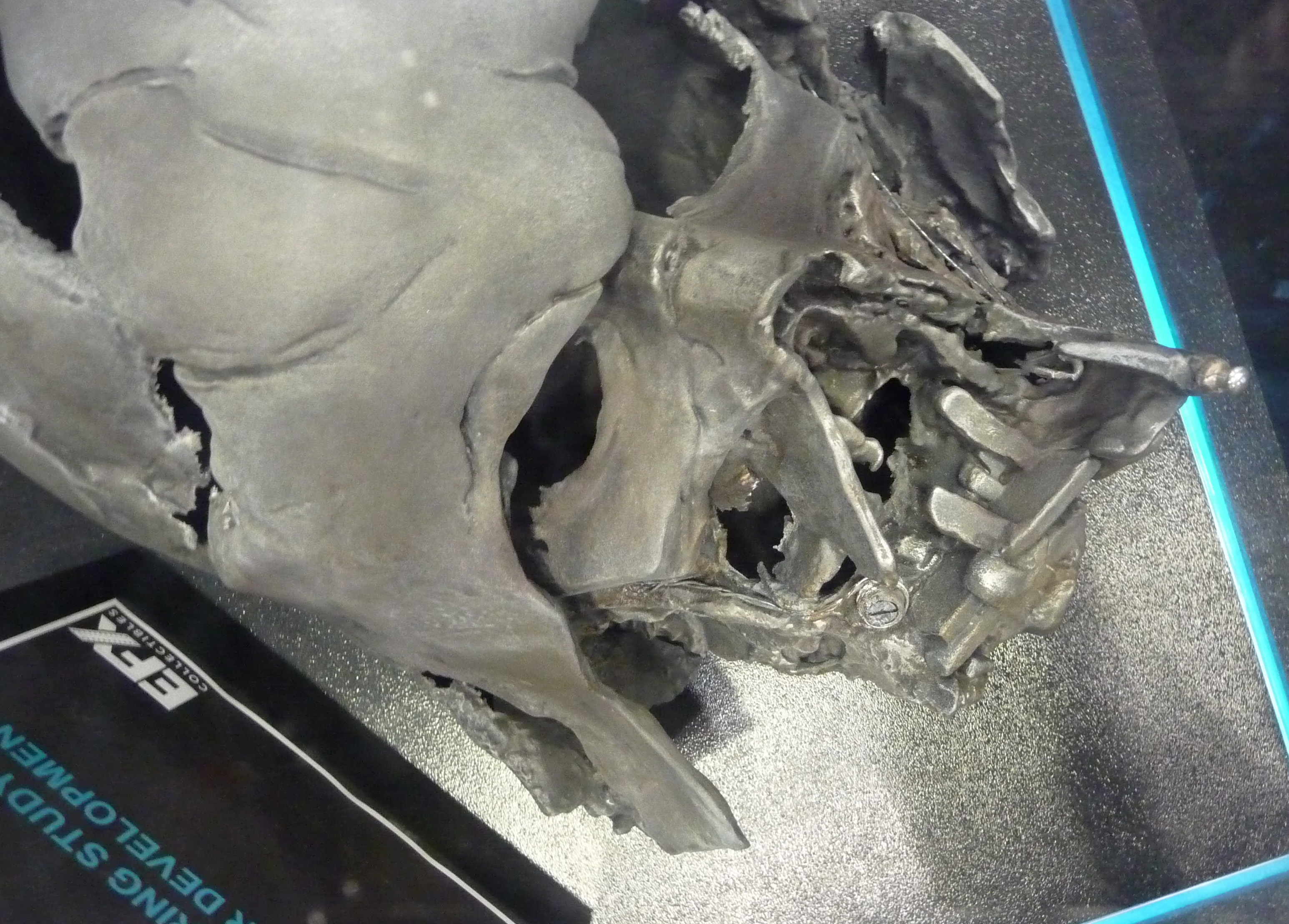

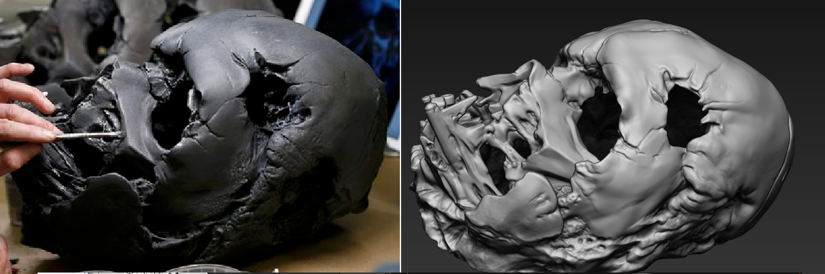

Thanks..the overall look is very nice.But its a little bit out of shape in some areas...look at the nosearea.I marked some wrong areas on the pic..I think that is easy to correct.
It can be that the nose is from a different angle...and the big hole on the top could be also wrong on the propshop one???
Thanks for your critique, unfortunately, for some of these changes it is a bit too late, since I already finished printing. I will still work in some micro detail with my dremel on the final master-pieces before mold, but some of these changes are difficult to do now.
For me most important was to get the overall proportions and "feel" right, of course to a certain extend I had to interpret some of the detail, since I didn't have perfect reference on all of the angles.
So yeah, I know it's no Propshop Helmet, but I still hope it's a fairly decent take on this sweet prop!

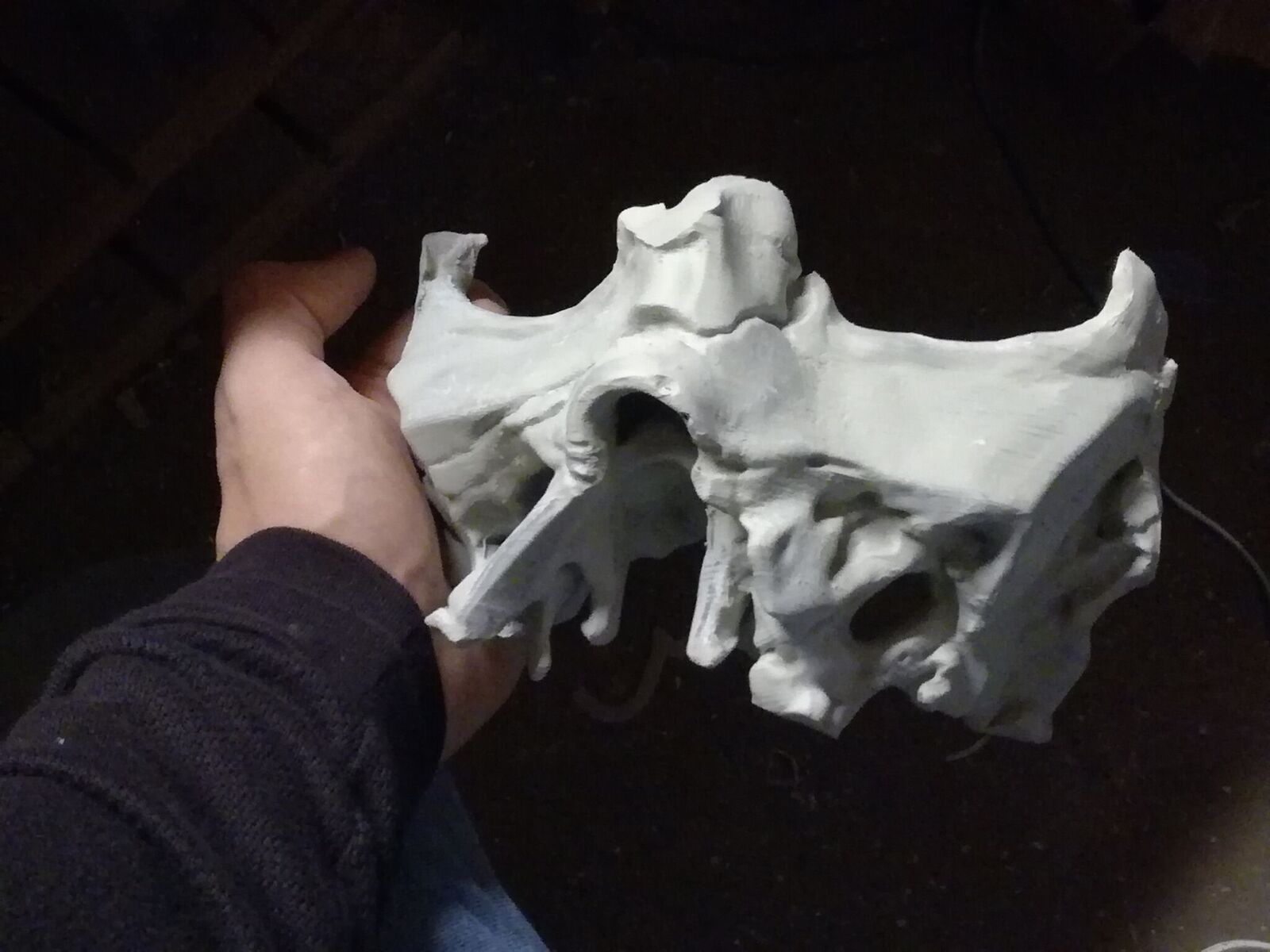

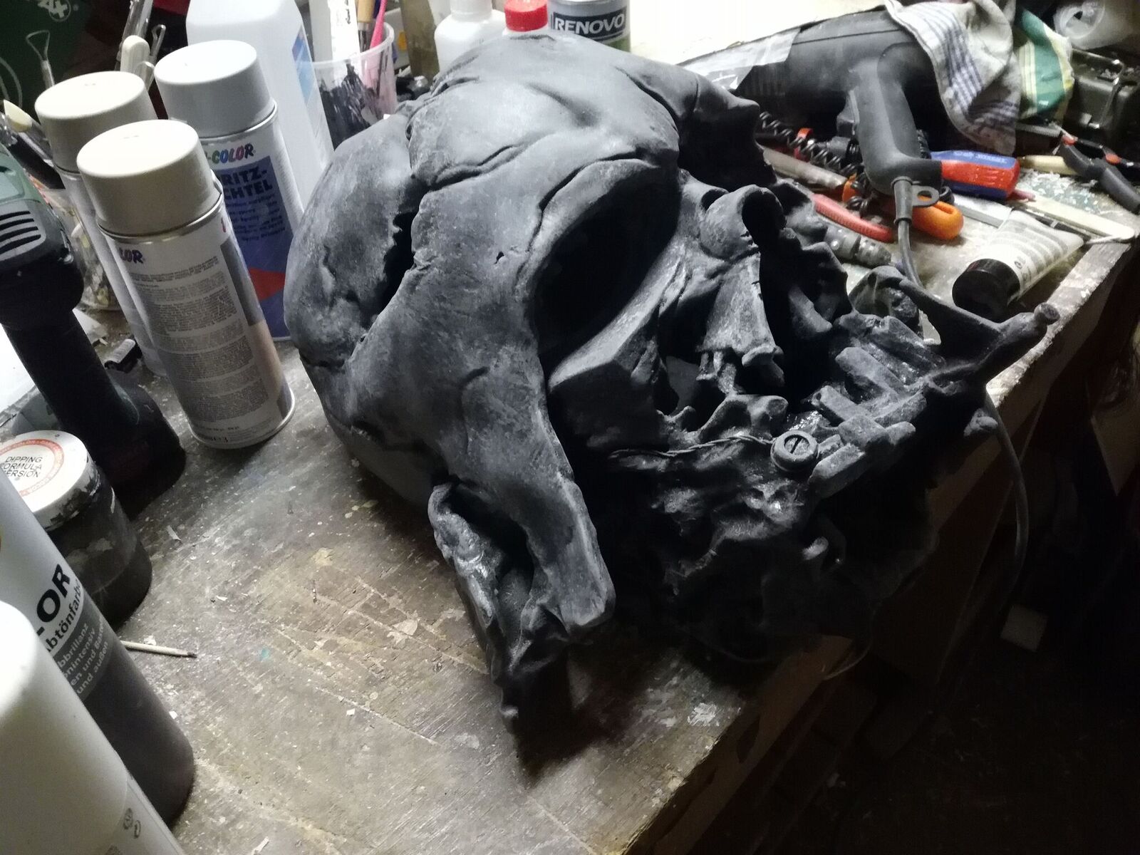

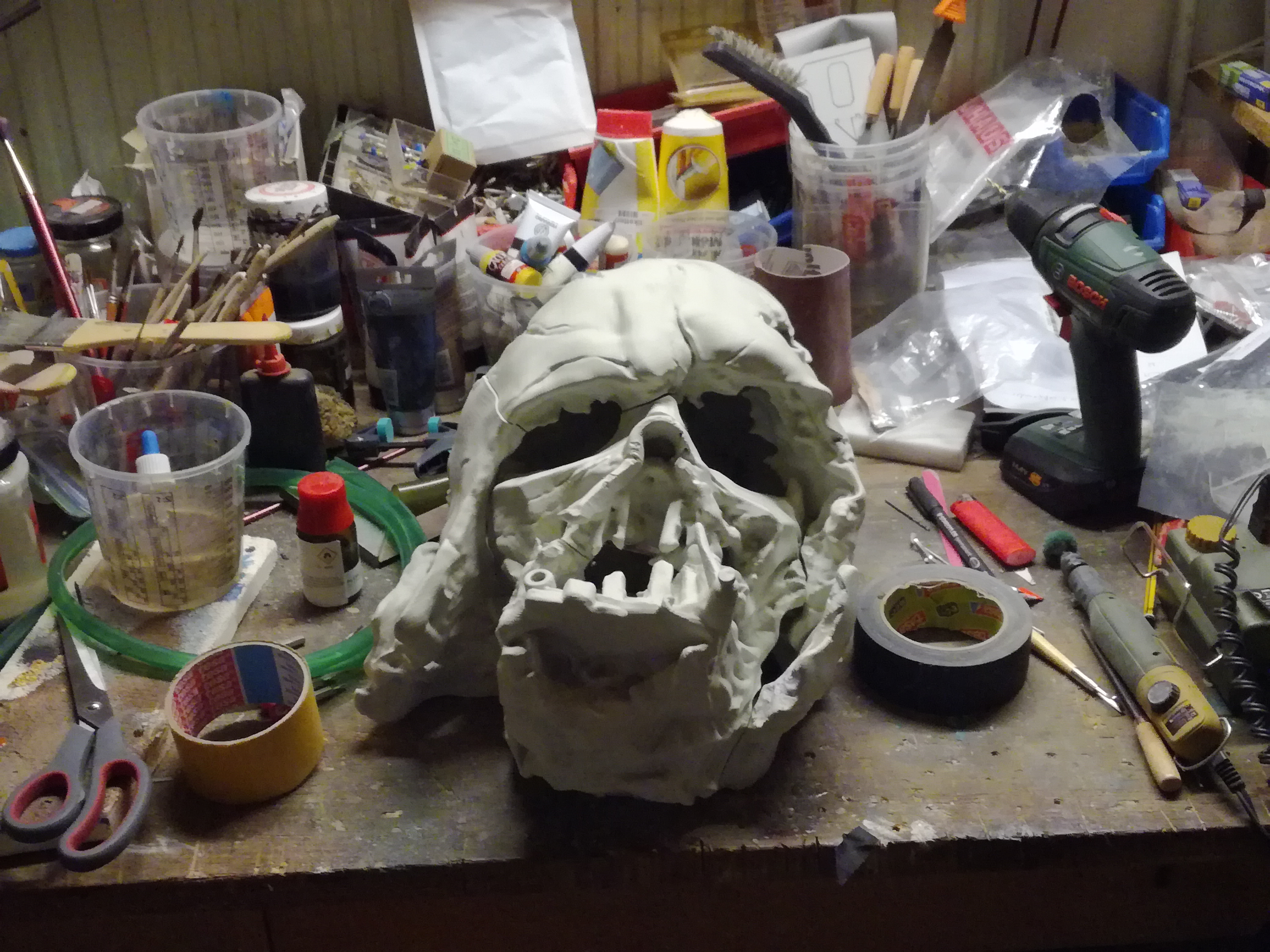

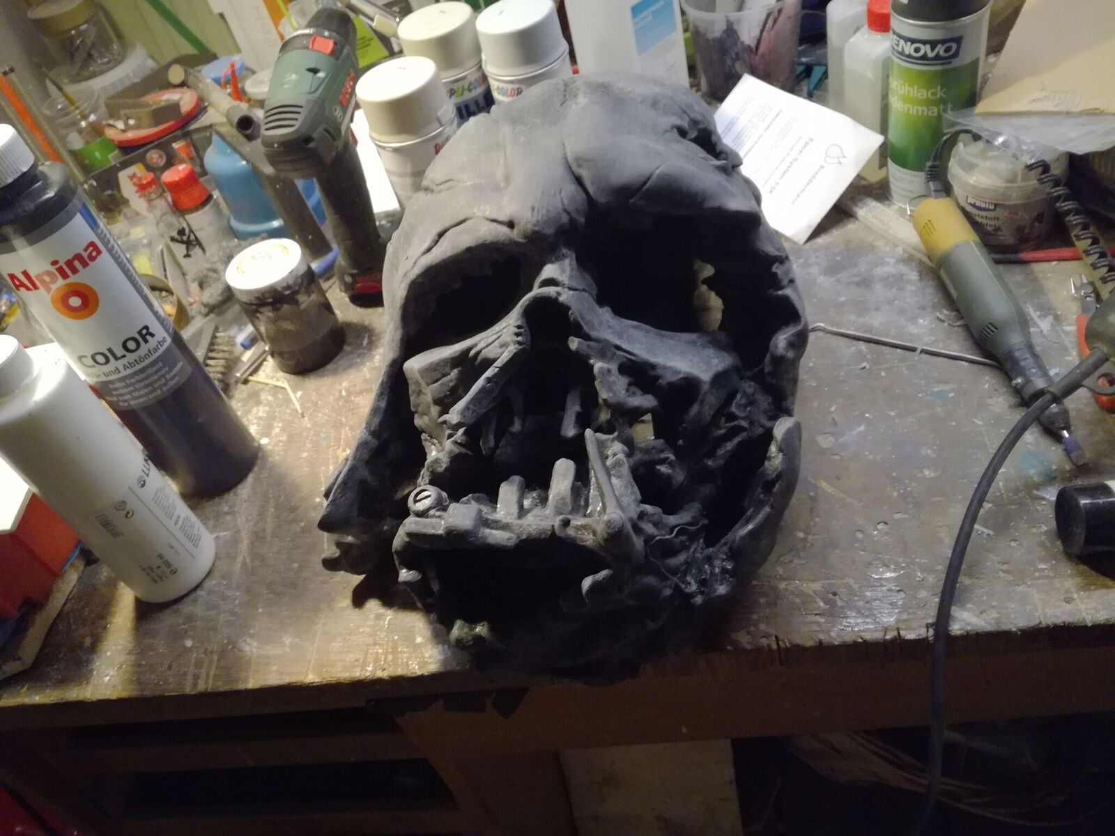

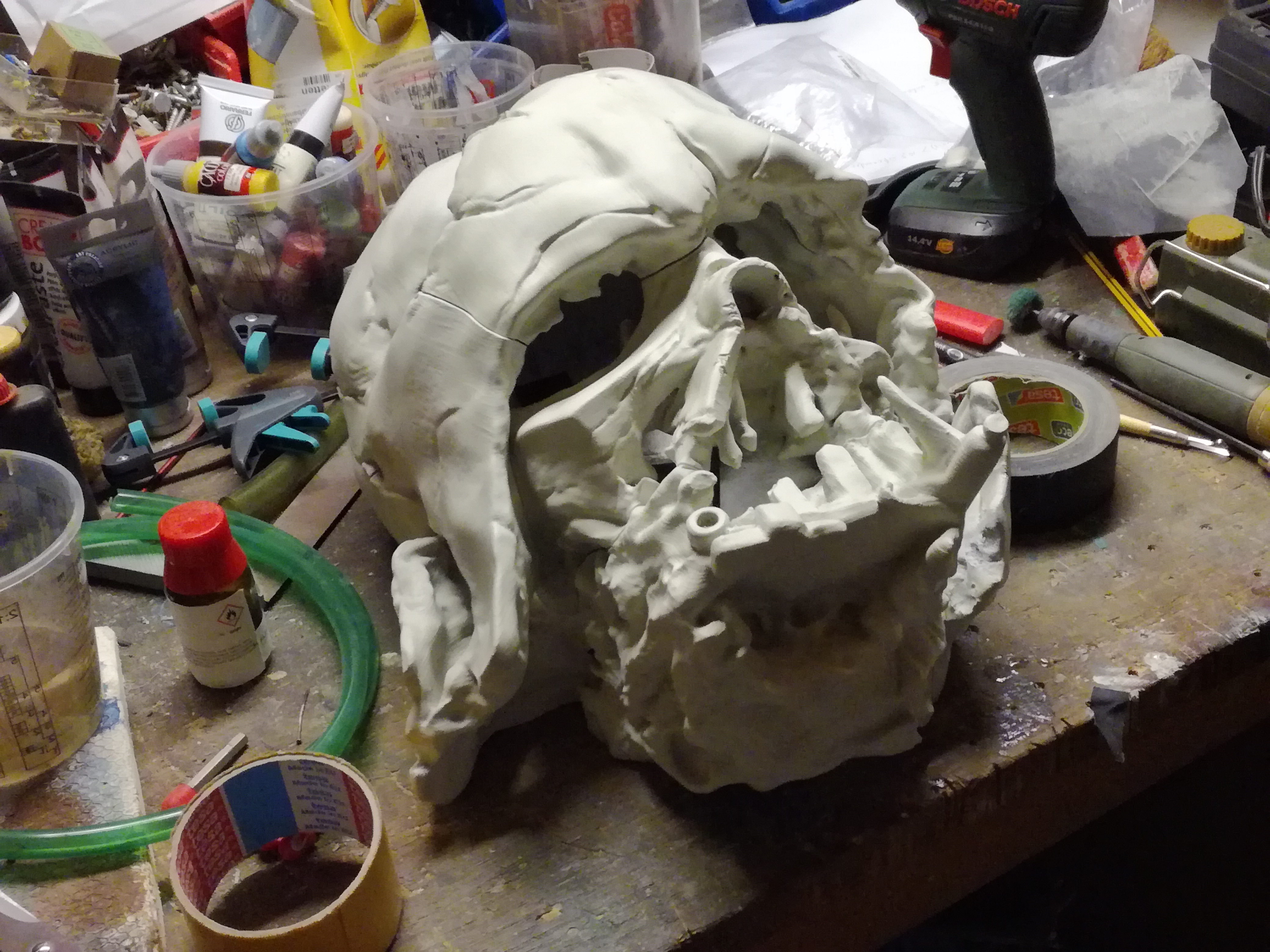

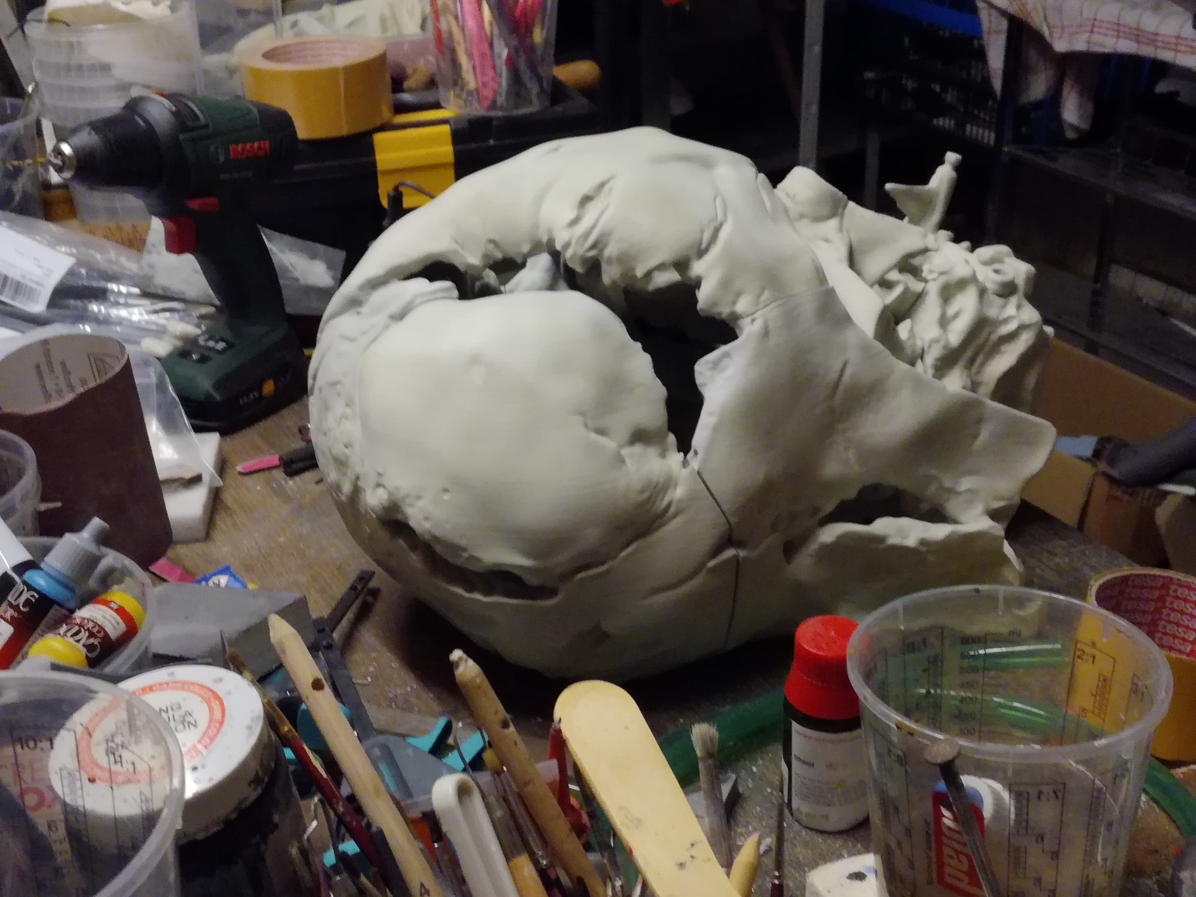

Meanwhile I'm spending every free minute polishing the pieces... Carefully sanding the surfaces, spraying with fillerprimer and reworking some detail into them with my dremel.
A small WIP from last night:

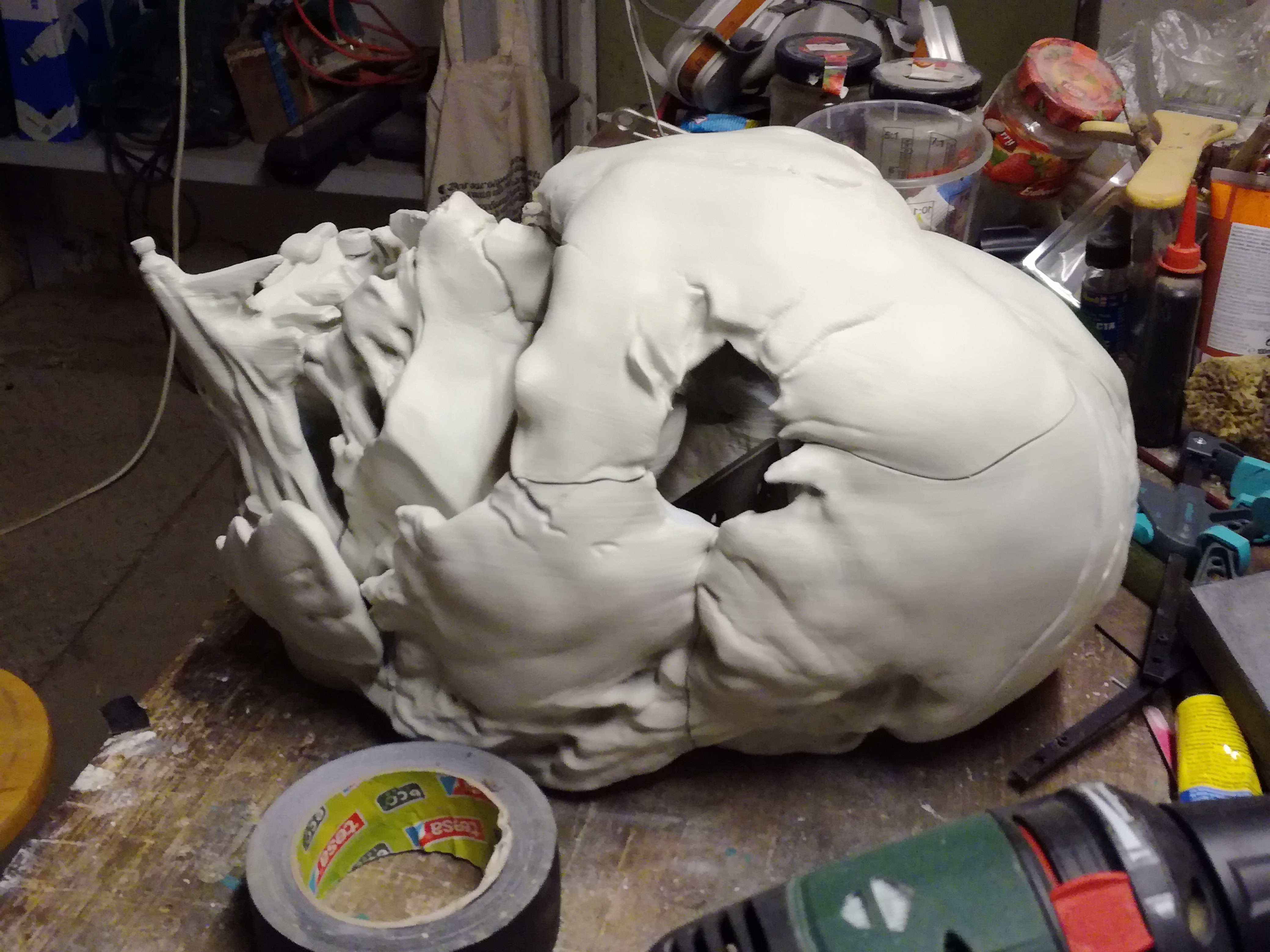

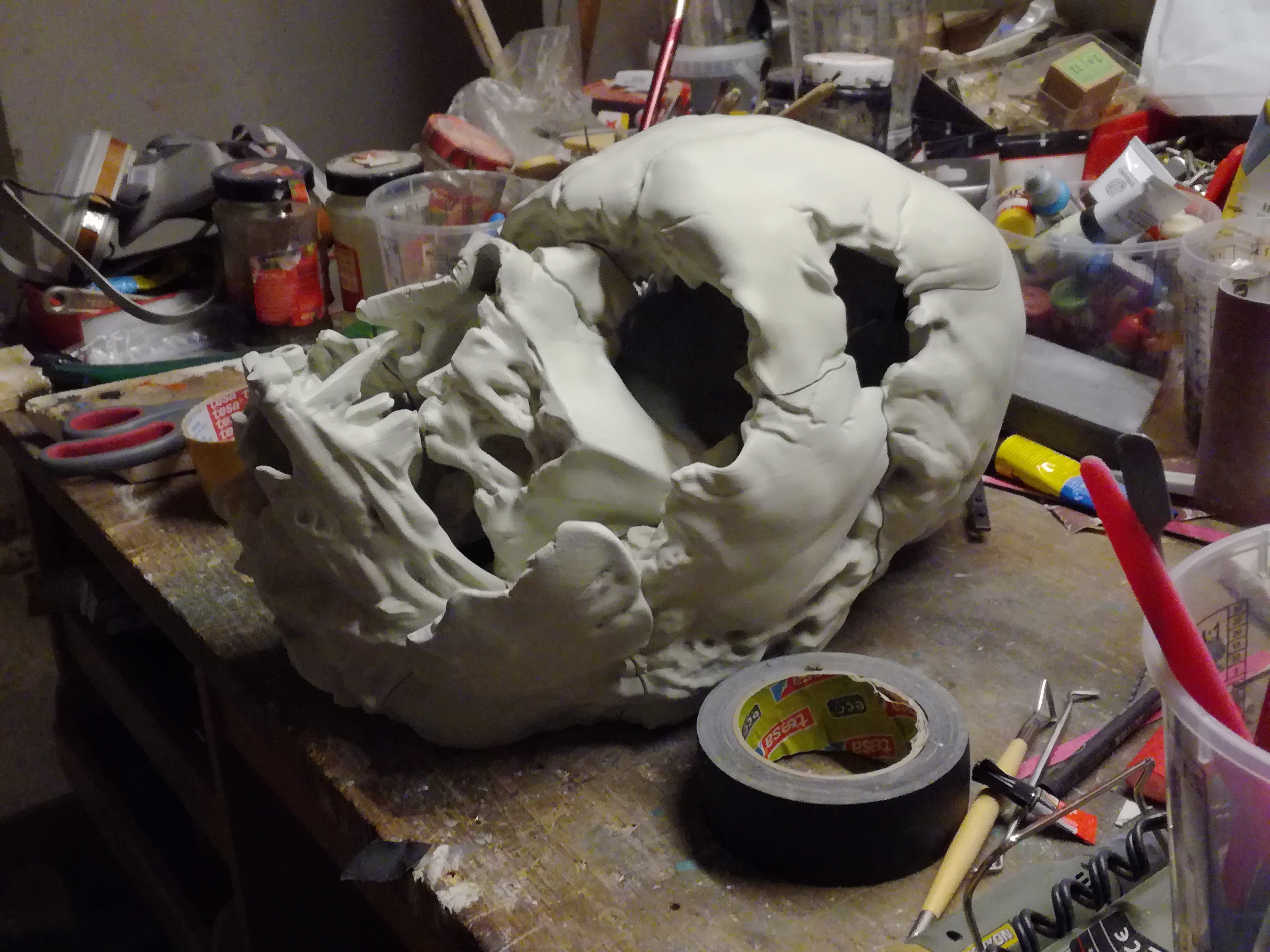

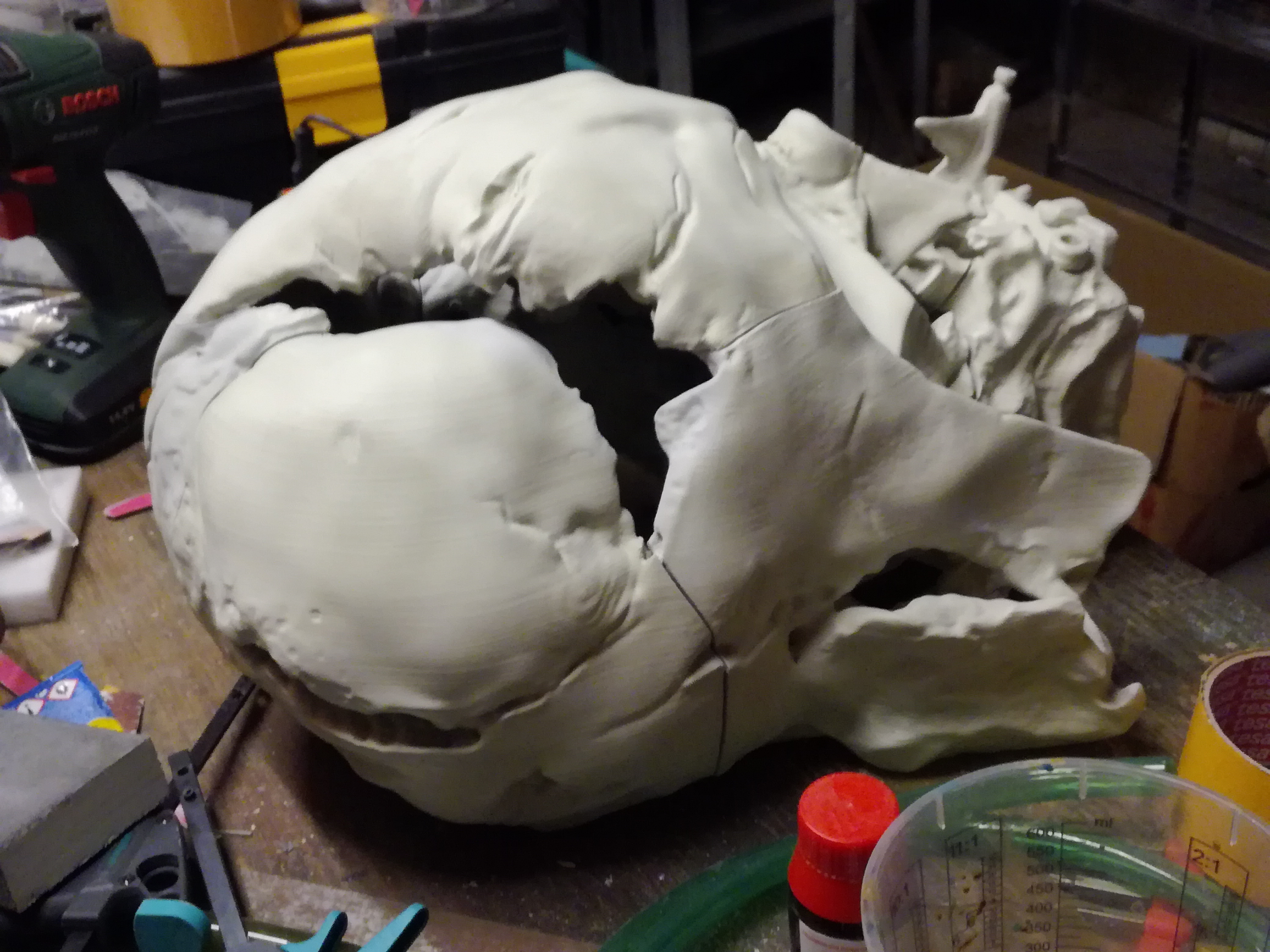

I'm alive!

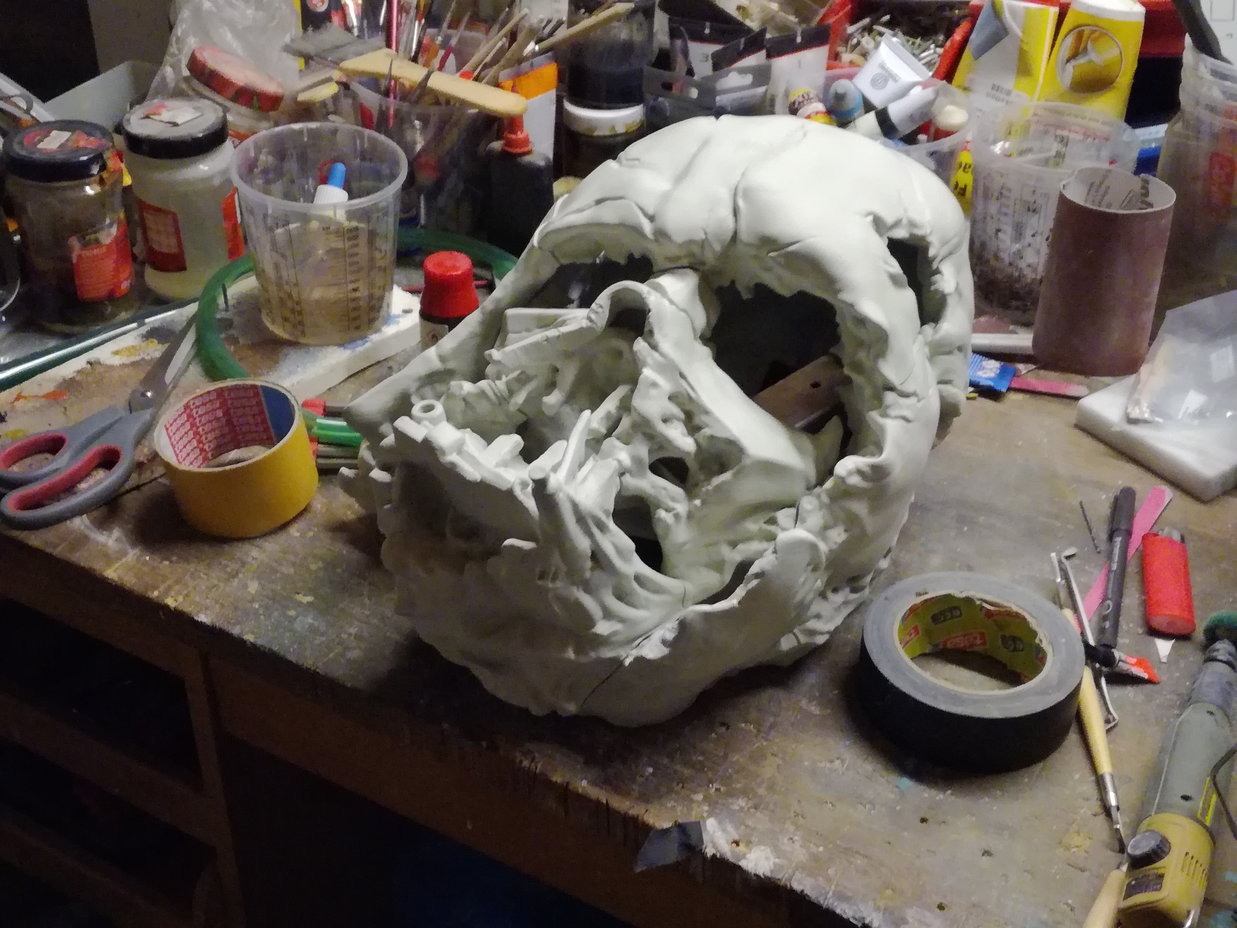

I'm burried in freelance work, so this didn't move on as fast as I wished..
Today I put it together again for a small shooting... still WIP but shows the smooth surface I got. Soon I'll start making molds.

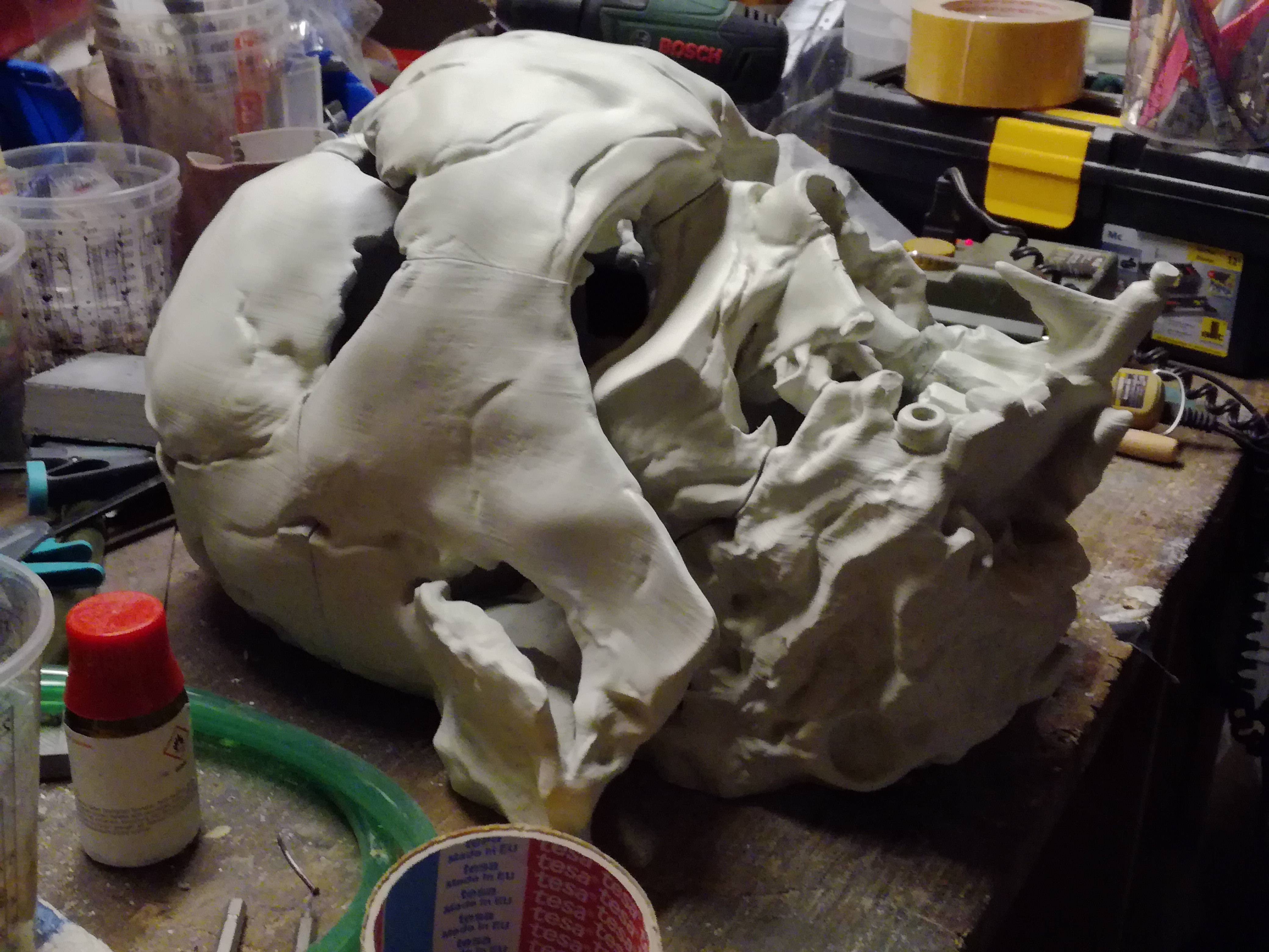

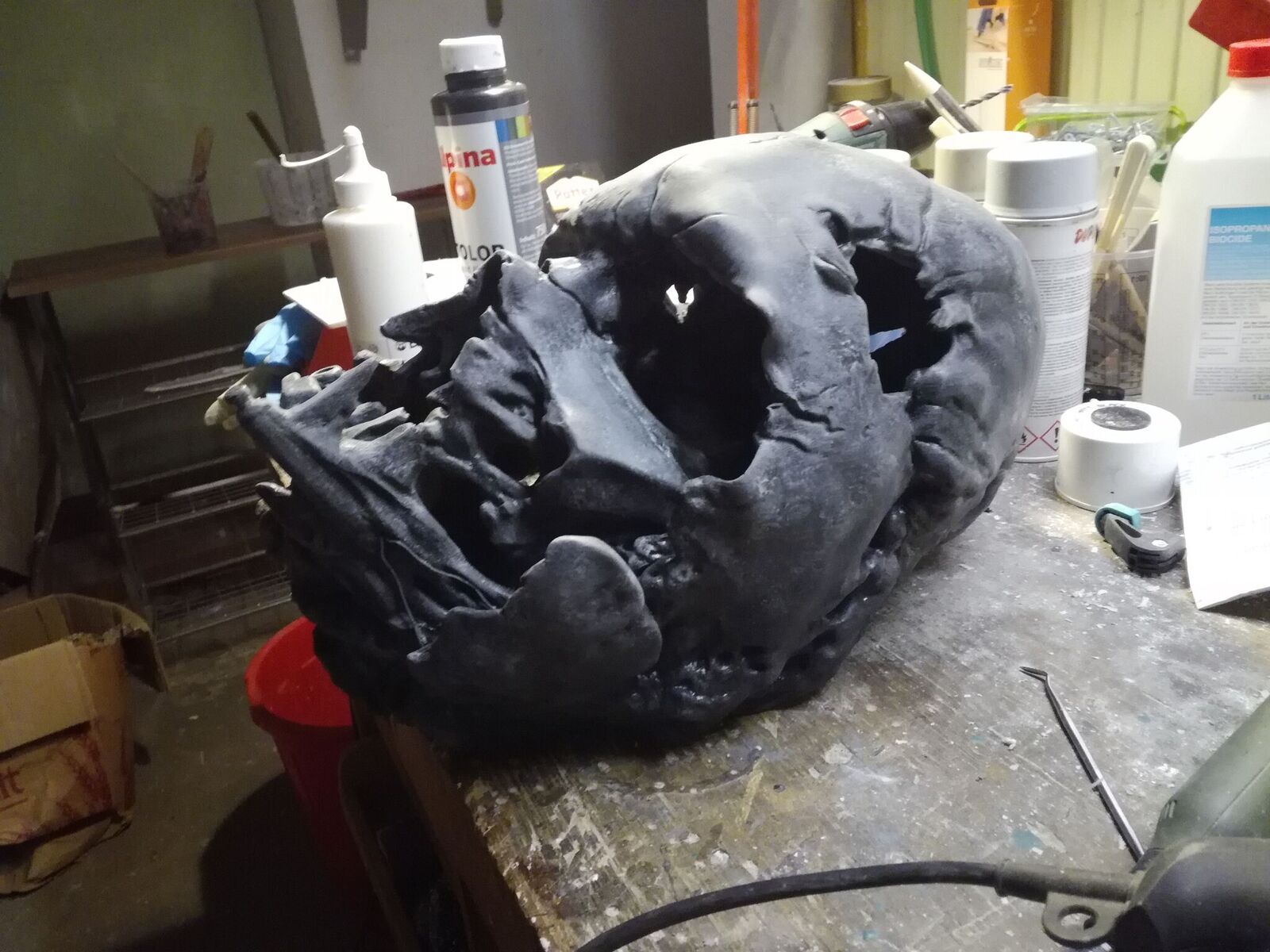

To update this as well, here's a teaser of the WIP paintjob of the first completely assembled cast:
OZFQklCjCkX4xzDpxqiwdDHbx4pk9OYiMm5nzHiQZgo.jpgQi0zFGweSI3O-s__ARXctnIxVdZc3E4XX8UrPWyzVlk.jpgwvF-yj_UiwMx_1iZVb0qzqNswOmGWCEy_m4TzD9hT_Y.jpg
I'm very happy with how the first cast turned out - the pieces fitted together nicely and it was very easy to fill and sand down the seams. Im super stoked by how this looks even with just a bit of botchy grey slapped on! I will finish painting this tonight and will make a proper photoshoot on friday, so big update coming then!
