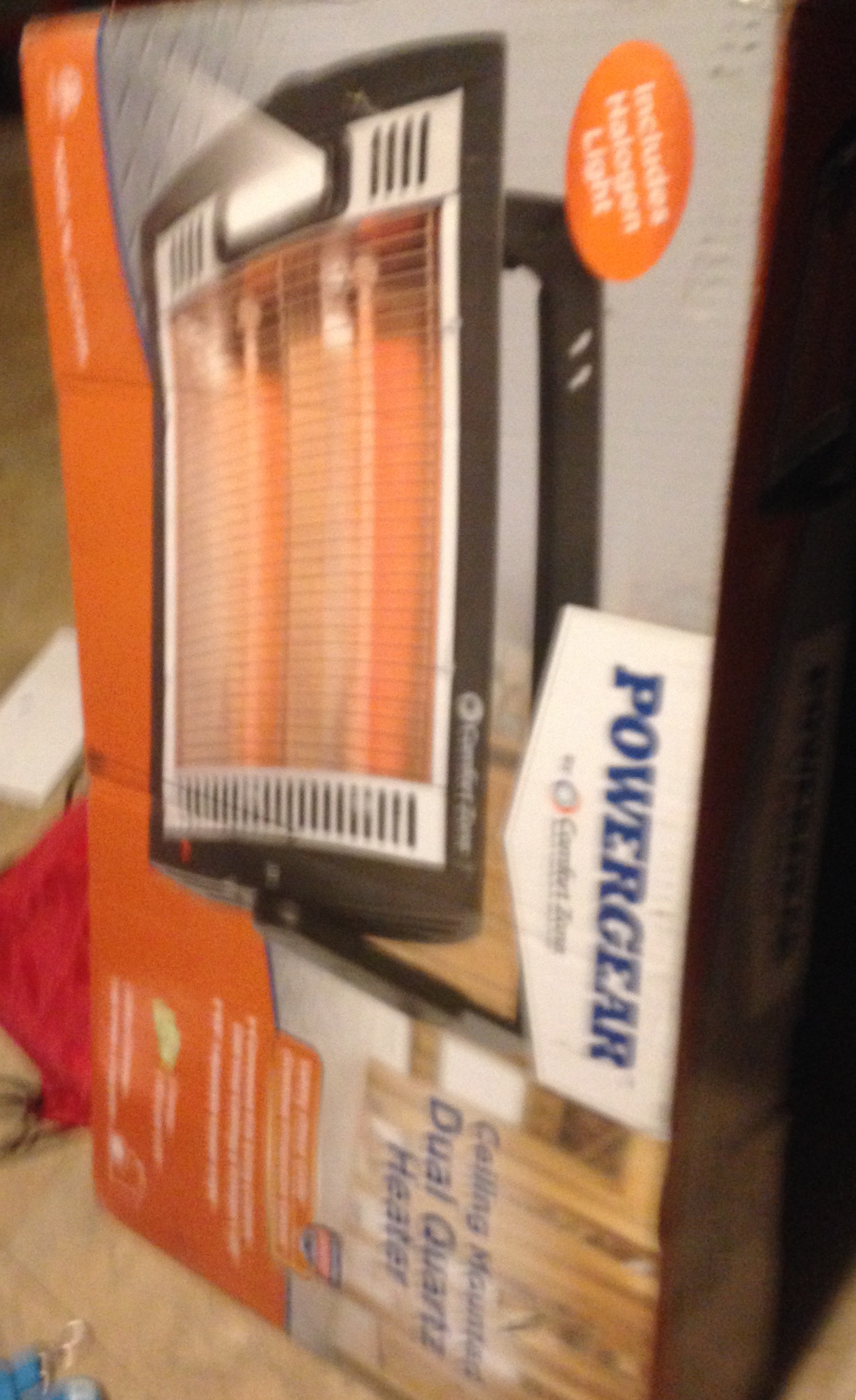

And I talked to my grandpa earlier about my situation and he just went ahead and ordered the heater that was mentioned a few comments ago since it was recommended for this and we've seen a lot of people using them. So I think I'll at least be up to par on that area... maybe.

ALSO! The new heater came in just now. Thanks to clonesix for giving me the reccomendation and link.

Strip heaters are OK, but they do take time to get hot and I found the one I was using did not heat evenly. It started at one end and worked its way along and took ages to get hot right the way across. The other thing I noticed was heat differences between the strips. .
My redesigned heater unit now uses 4 x 500w halogens (Australia's power is 240V/50Hz). They will smoke softer plastics from as little 3 minutes. Soon I will add a fan to make it really hot. I made the lights pivot in so I can aim them into the centre. What I need is a nice thick aluminium plate to stop the heat passing through the plastic and dissipating into the air and make this a true "oven".
