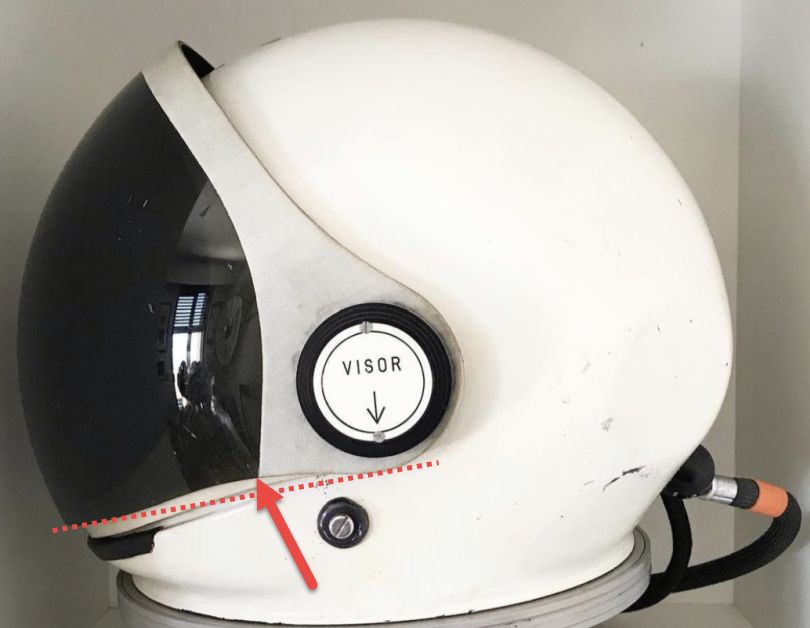

I think I can be of assistance here. I got all of the different HA helmets so I took a picture of the BF Goodrich A/P22S-3 helmet for you. You can see that the lower edge of the visor follows a straight line, just as on the Mk-IV., while the lines of the tinted and clear visors of the HGK-13 are curved.

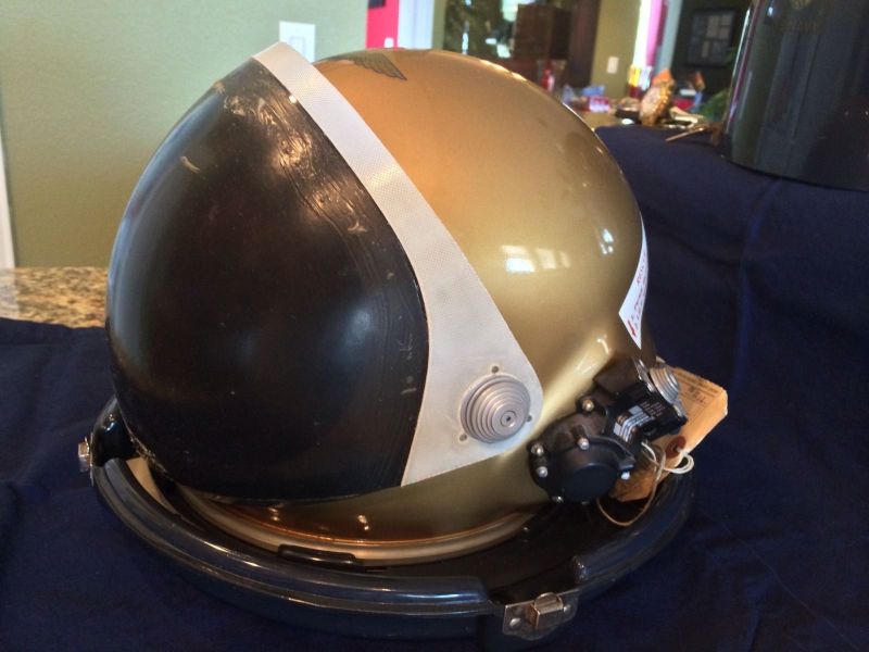

The vast majority (163 of 199) of flights of the X-15 used the A/P22S-2s suits that comprised modified HGK-13 helmets. The other flights were performed using the MC-2 suits. So unfortunately none of the X-15 flights had the dark visors installed on the HGK-13 helmets. All of the dark visors had been removed on the modified HGK-13s so the dark visor cannot have flown on the X-15.

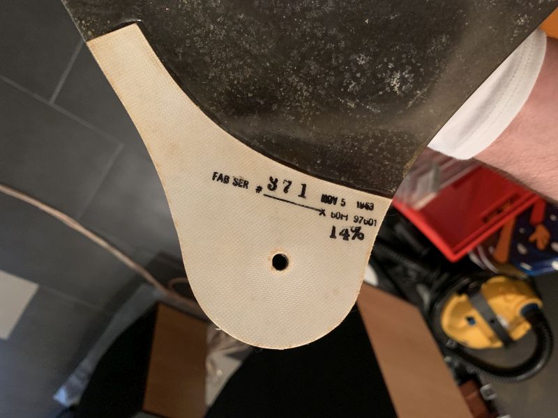

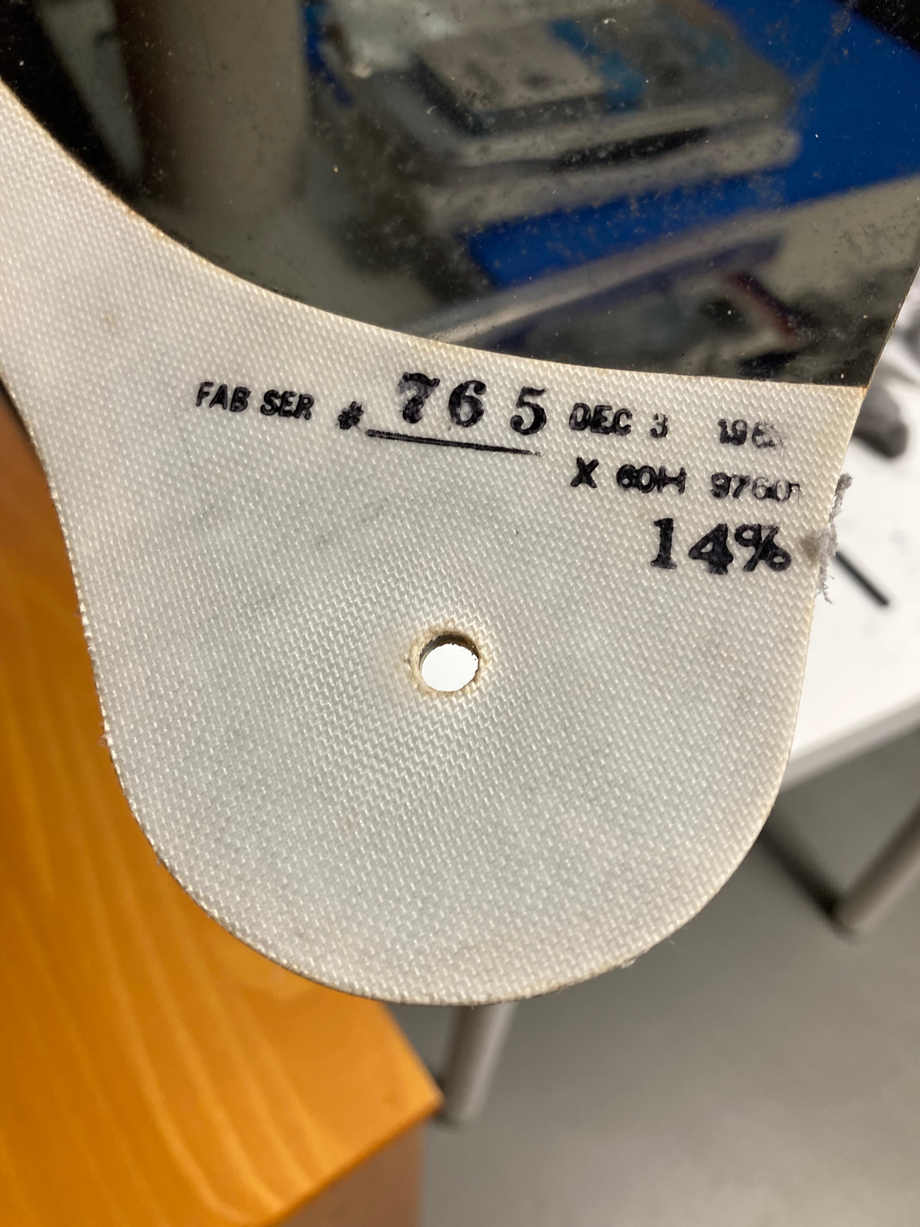

Under Pressure, I contacted Flighthelmet and the gentleman informed me that I could have a refund if I wished (I purchased the visor in 2017!) which was great of him, but it is about as close as I think I'm going to approach the real thing...he asked for a picture of what is stamped inside so he can identify what I have...here's the photo I took today...
I know the owner of Flighthelmet. He´s a real gentleman. I wouldn´t go for a refund if I was you since the visors are really rare. It may not be the identical one but it´s still the closest you will probably get, unless you want to wait years for one to emerge. Flighthelmet may not have known details to keep the different visors apart. Sending you a picture of one of the HGK-13 visors I got. The translucency data on the visor is identical to what you have.
Under Pressure, as I said in my post, I wont return it and indeed the flighthelmet.com folks will always get my support…I intend to use it on my helmet build

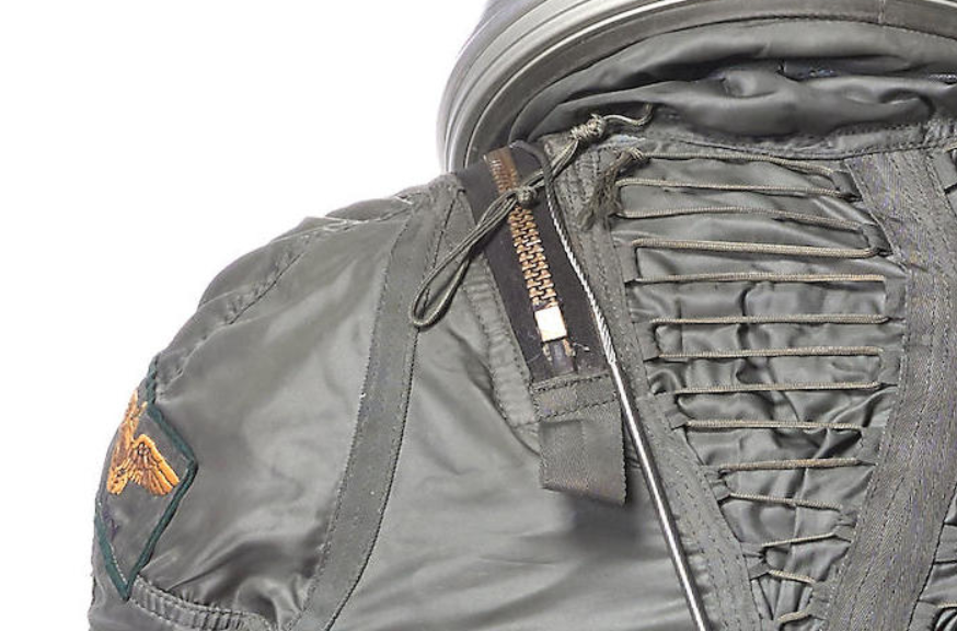

Excellent job on the patches btw, they're what really caught my eye here. Just to check, how do your custom patches measure up? I took a quick image measurement, and it seems the USN chest patch is approx. 4x2.5". The suit actually looks quite good, especially for just $25. It's a cold weather suit, right? It would explain the shiny material and soft fabric cuffs. How far down the back of the shoulder does your zipper go? There's a great pic of the back of a suit from a Bonham's auction that shows it goes down maybe another 3-4" past the shoulder seam.

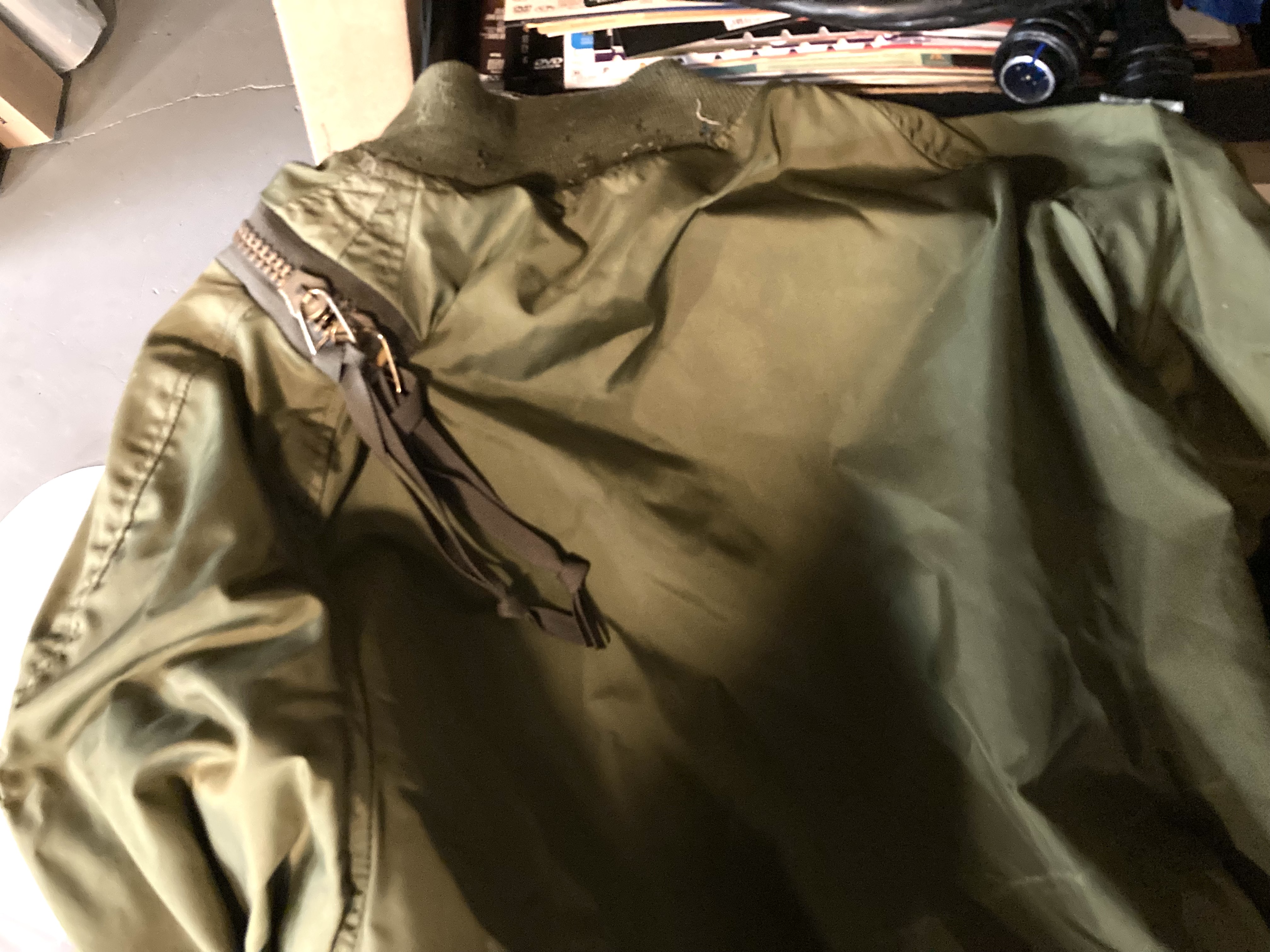

Hi...I finally found the box with the suit project in it...heres a shot of my suit's back where the zipper ends...and also, my chest patch is
4.25"x2-5/8" and the right shoulder patch is 2.25x1.5 inches...

The tinted visor shown above is from the HGK-13, it´s not the correct visor for the Mk-IV. The Mk-IV was made by BF Goodrich while the HGK-13 was manufactured by David Clark Co. They did their own visors. They do look alike but are just not identical.
