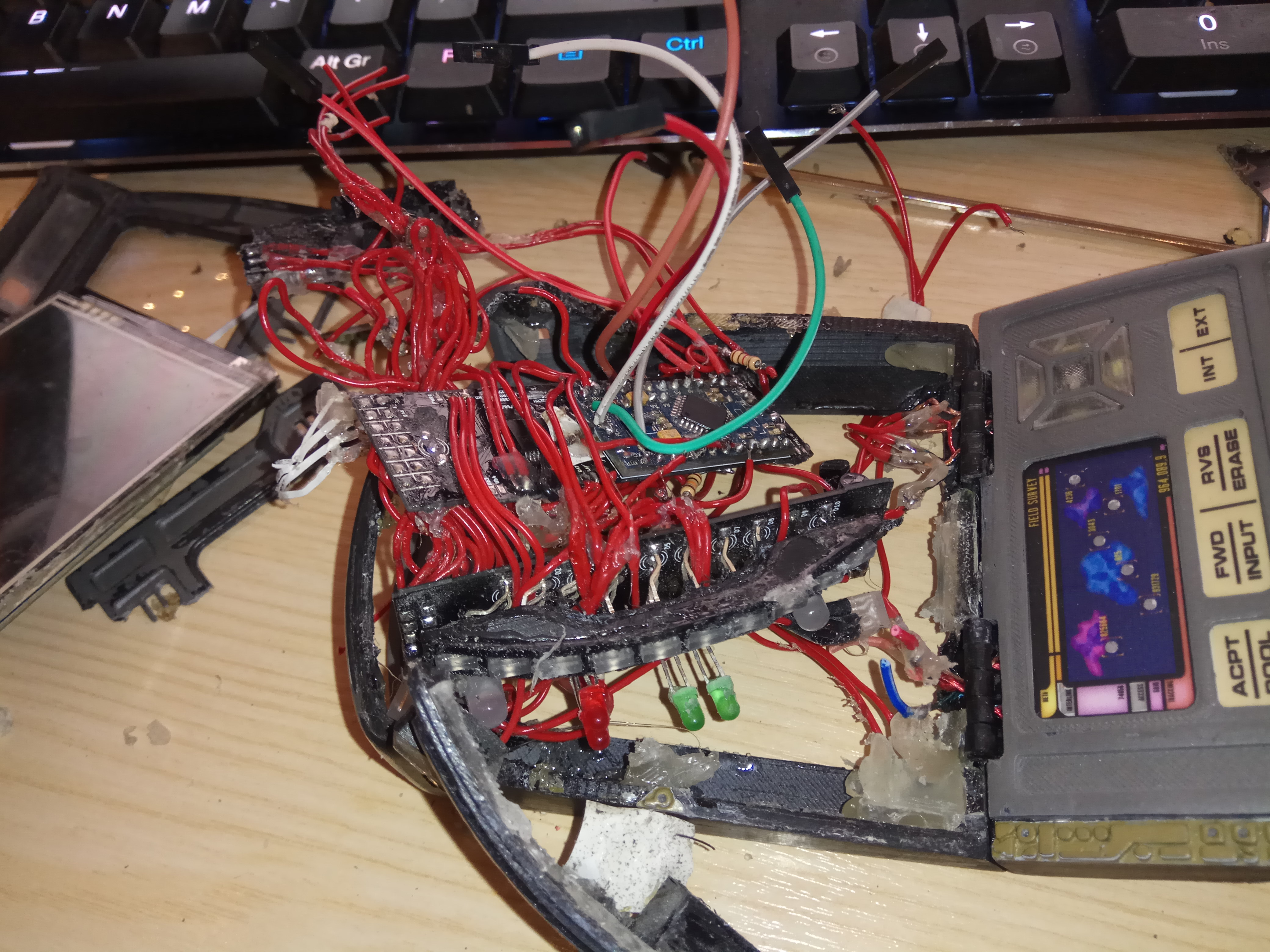

Yesterday I went back to the prop having a couple of days spare to do a few things. I decided to try and unbrick the arduino with a hv pump programmer to try and reset the programming fuse...
Well that didn't work... Something about the way the projects wired up blocked it...
So I desoldered the chip and replaced it with another spare... I found optiboot, it's meant to be a replacement boot loader with a 60ms startup time.... Mangaged to install that but for some reason I now can't program the chip through serial. And uploading via programmer removes boot loader and project won't start..........
This is of course starting to turn into a nightmare.
Also the led behind the gel pack window has now developed a loose connection.
These problems are starting to mount up and made me start to debate abandoning this current build.... Go back to the electronics design make all the changed I previously wanted to do on a v2, take out the arduino, replace it with either a pic or a stm32, stm32 being far easier to program and easier to get fast booting without having to fiddle with bricking fuses.... Or incorporate a controller direct to the pcb to save valuable space...
But doing all this means scrapping my current build. I can recover parts from the old pcb, but this means literally destroying the build to get to them.
The trouble is, if I carry on with this build. The best I'm going to get is a prop that doesn't start the moment I open the door but a second and a half later. So delayed ratchet effect. And it will have a loose led connection on the led behind the gel pack. And the led scanner on the front light bleeds led to led...

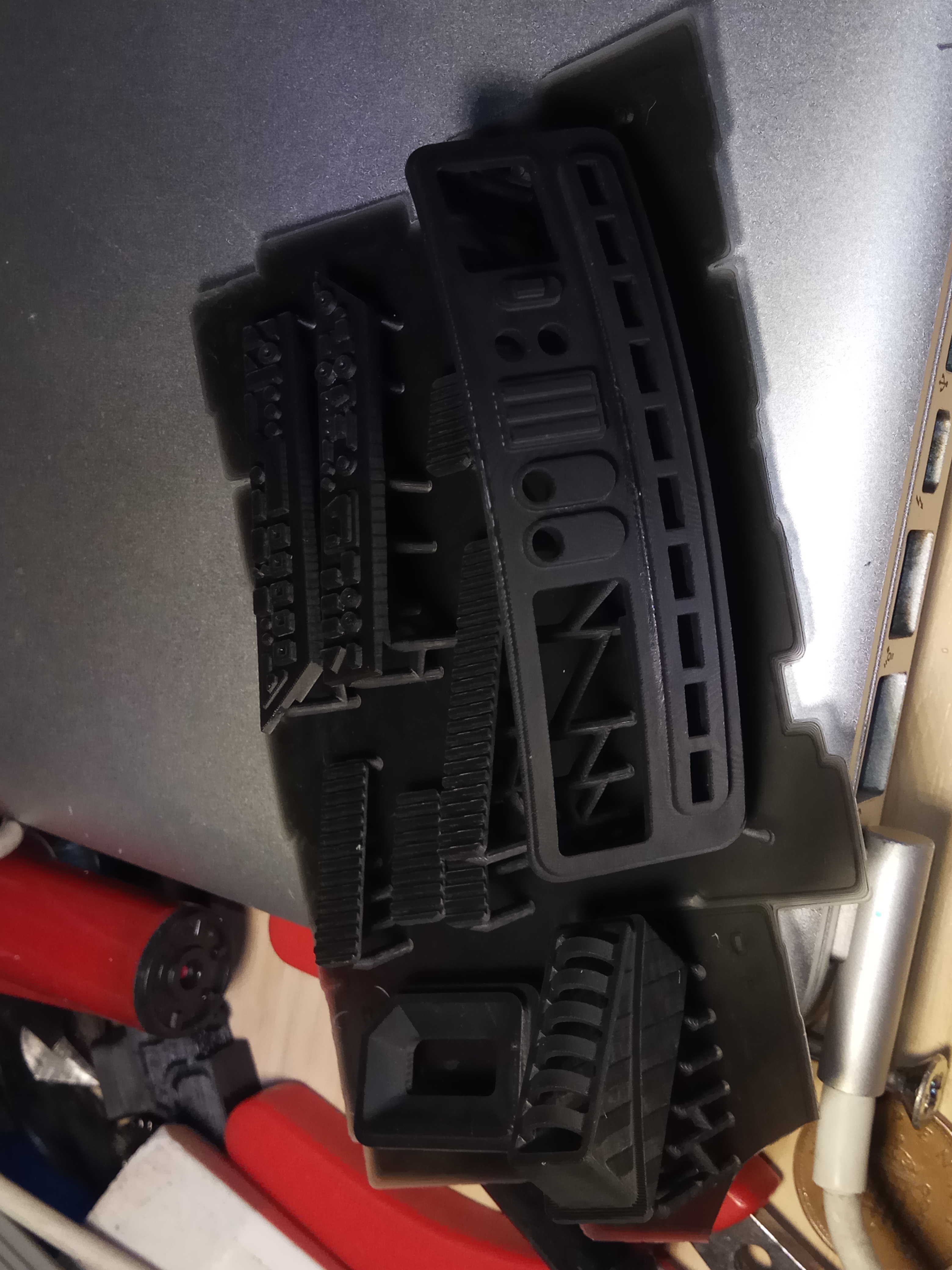

So was 2 things, a test print on the new resin, but also wanted to see how well the new parts print in it... The sensor clusters came out amazingly...
Im currently reworking the PCB, once I have that done ill place an order and start printing the rest of the case on the FDM...

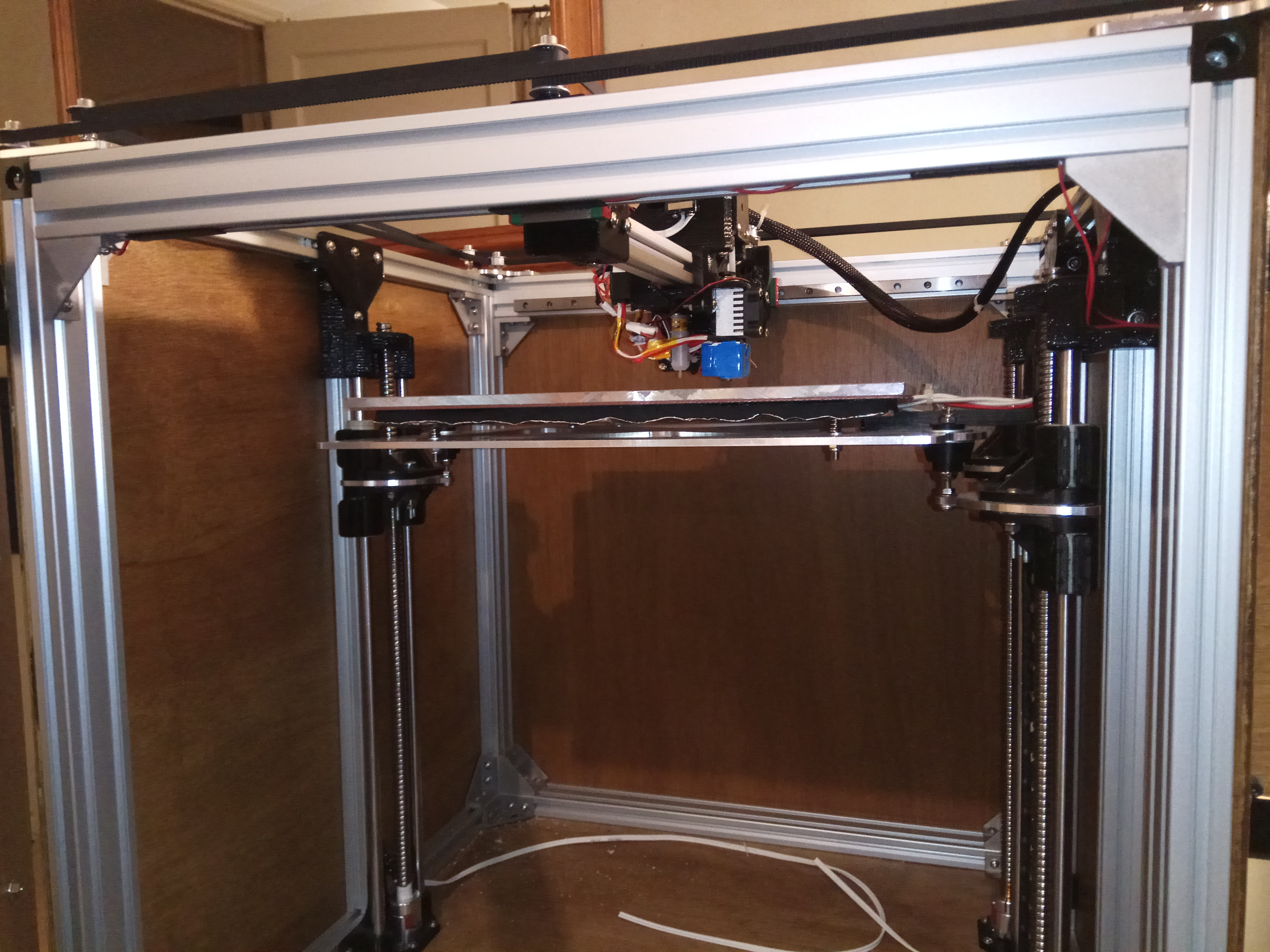

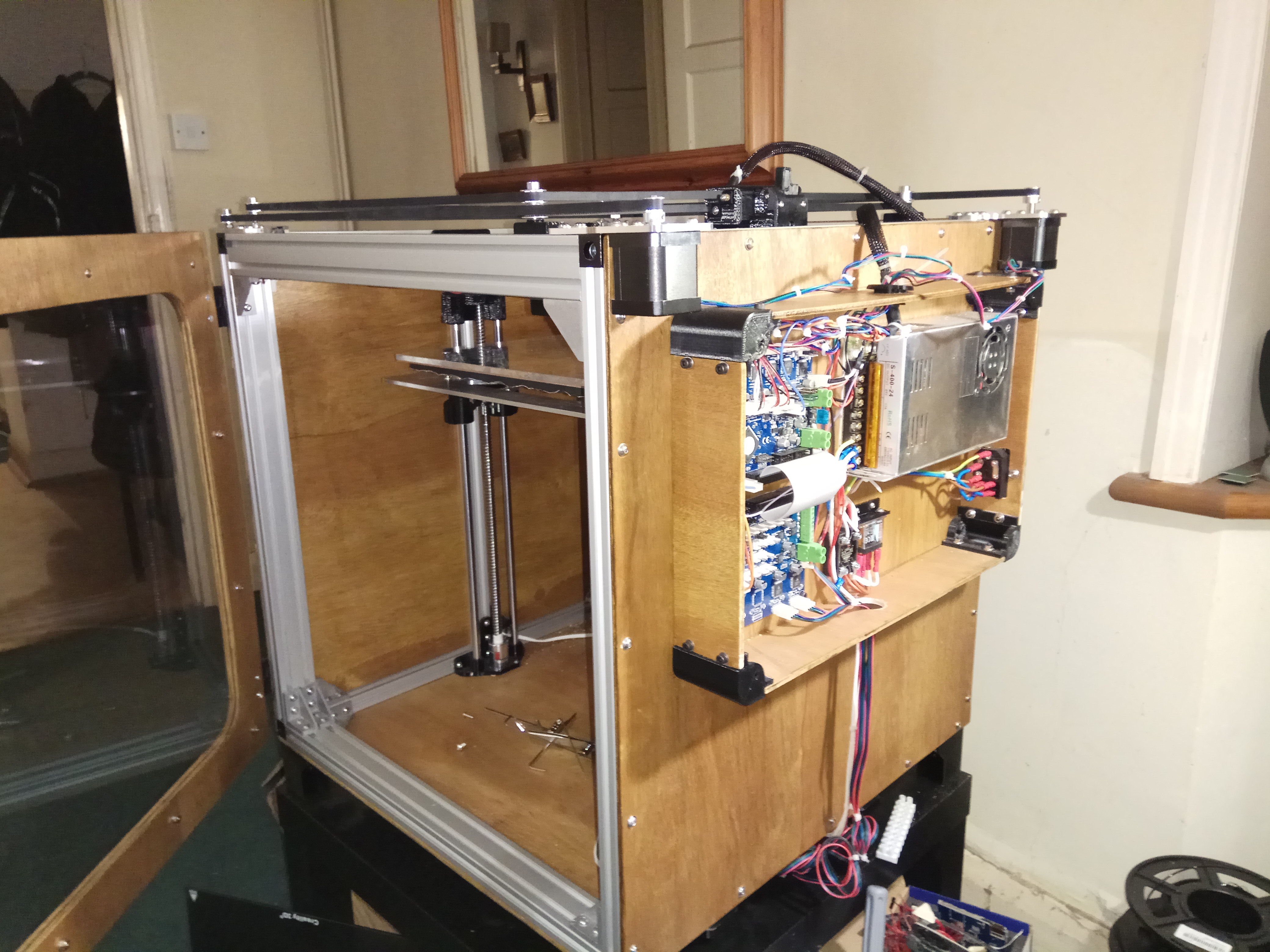

Im really sorry for the incredibly slow updates. The things thats really holding me back now is my new printer isnt finished being built... Its getting there but right now. Its about 80% done. Before i can print ABS I need to sort out a lid/top for it to trap the hot air in... Ive really been wanting to print the case on the new printer as my old one is not doing too well at the moment...
I could print the case on the old one but will need a lot more post work than usual...

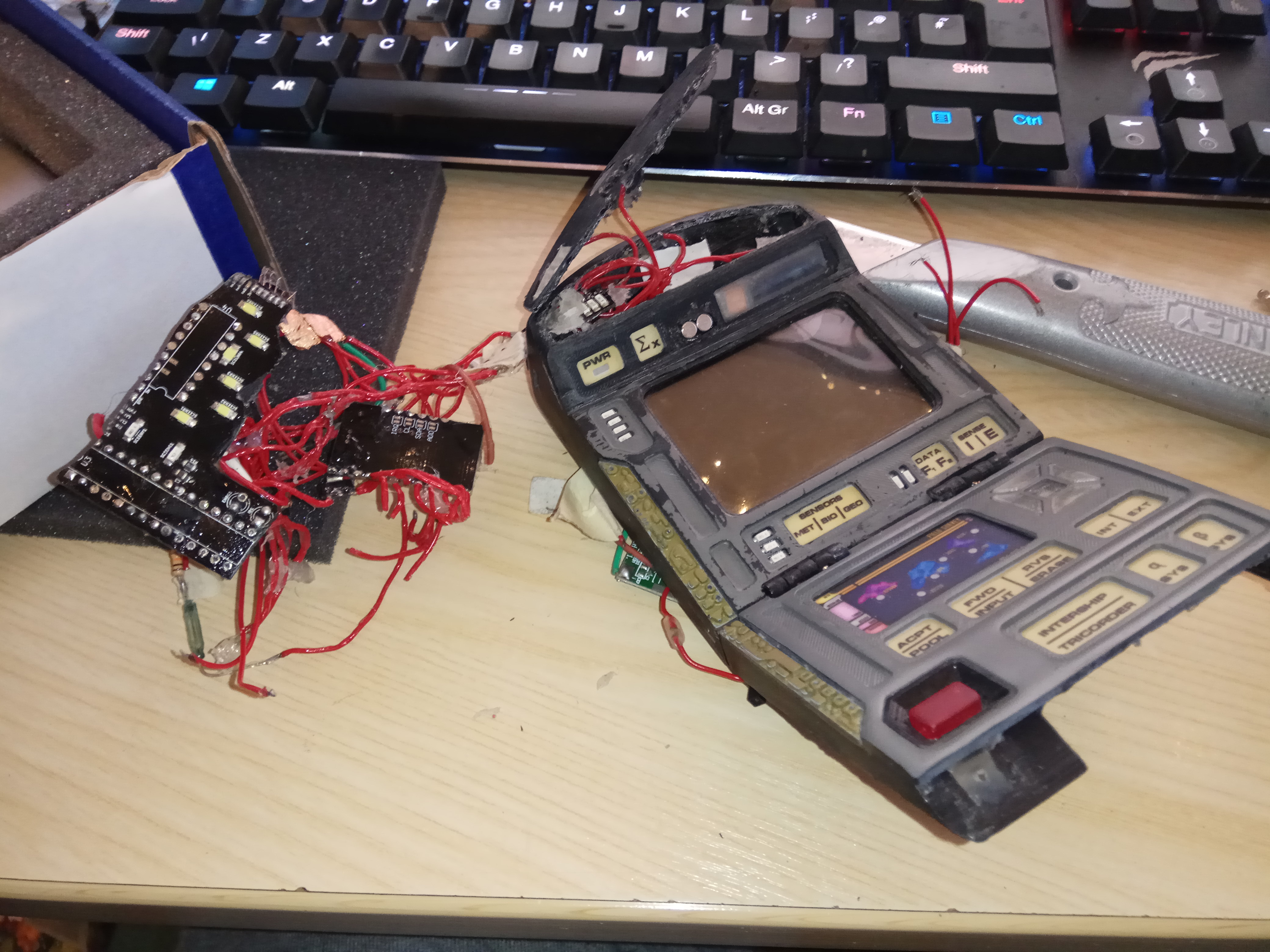

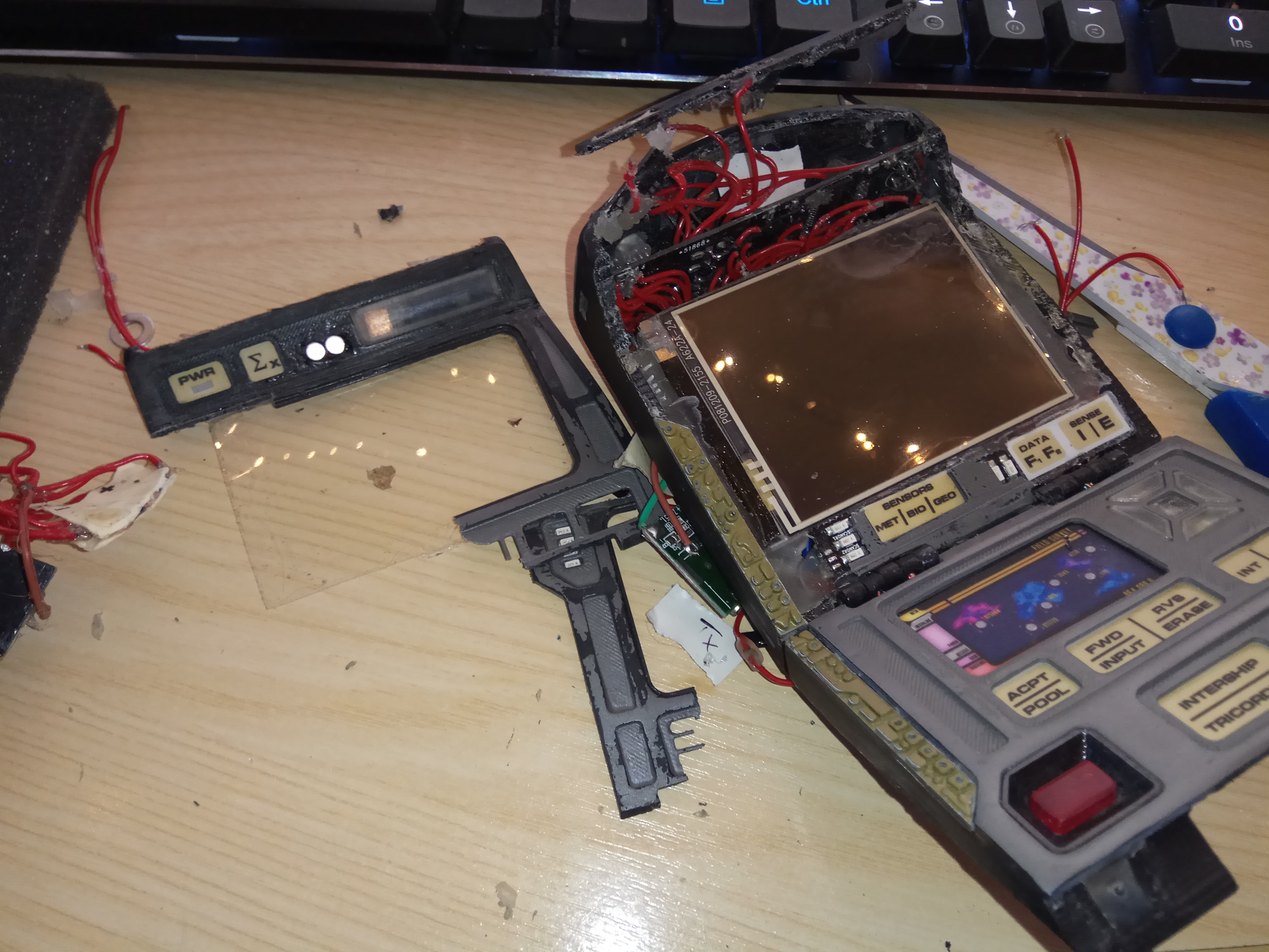

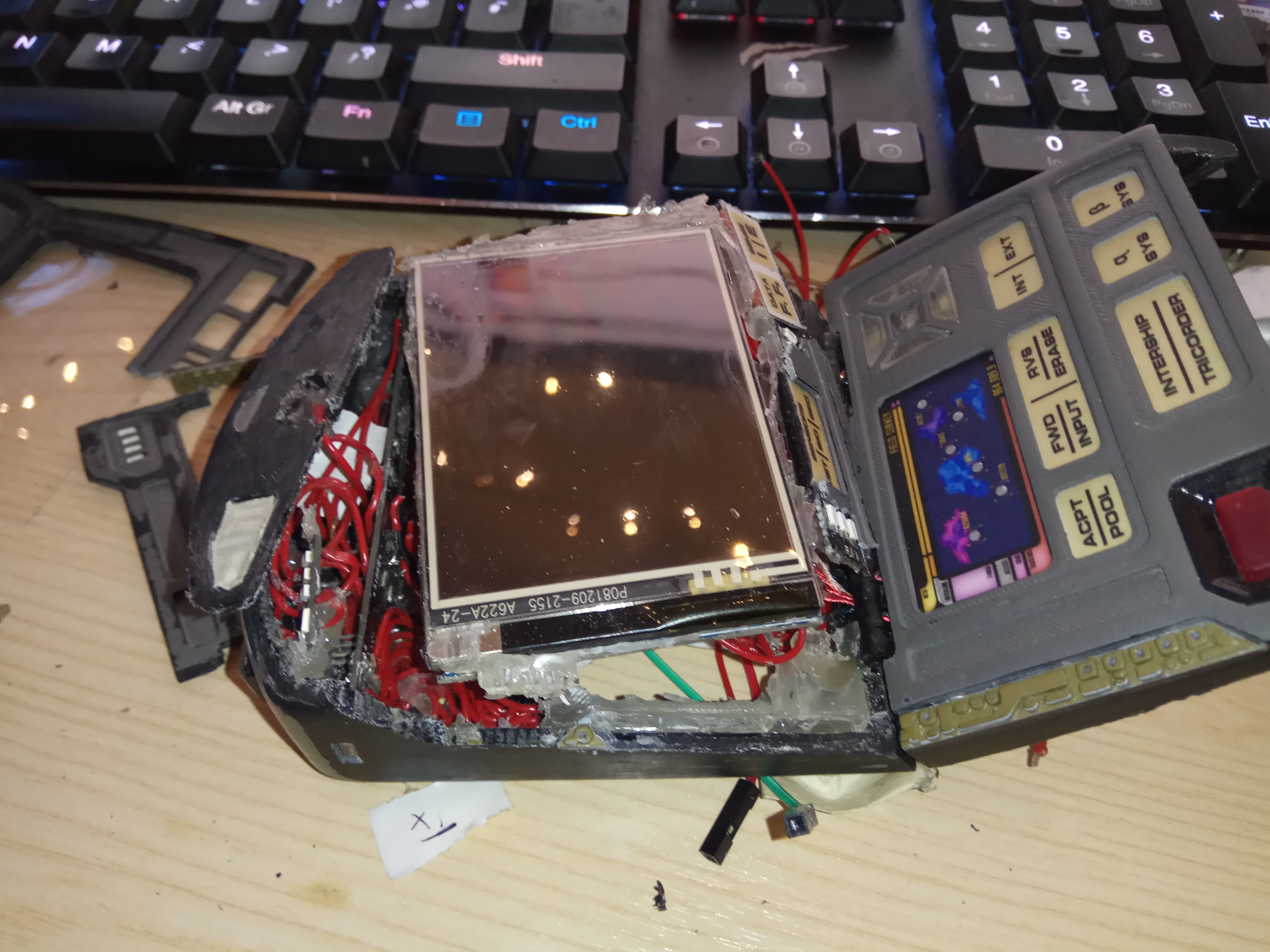

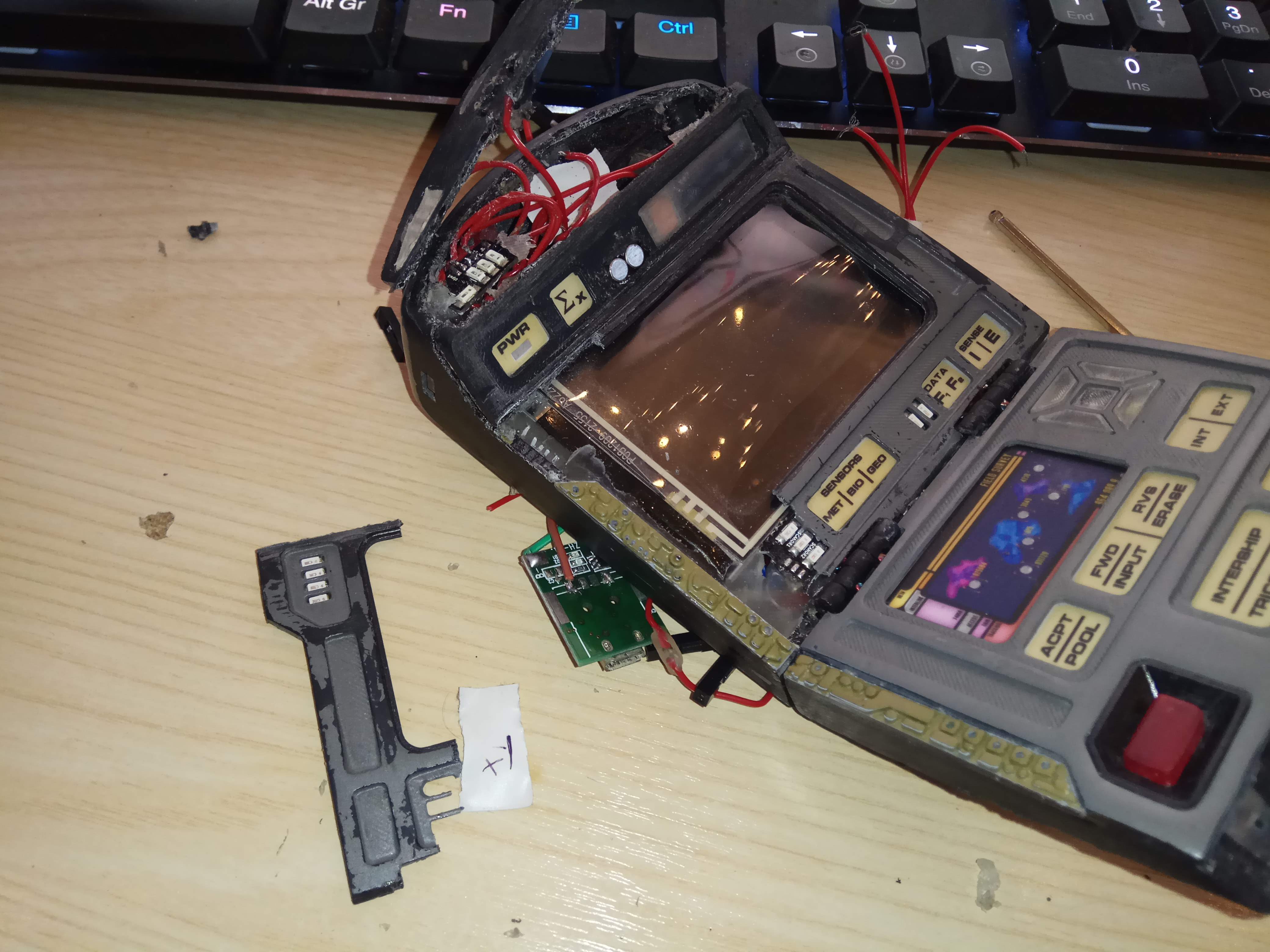

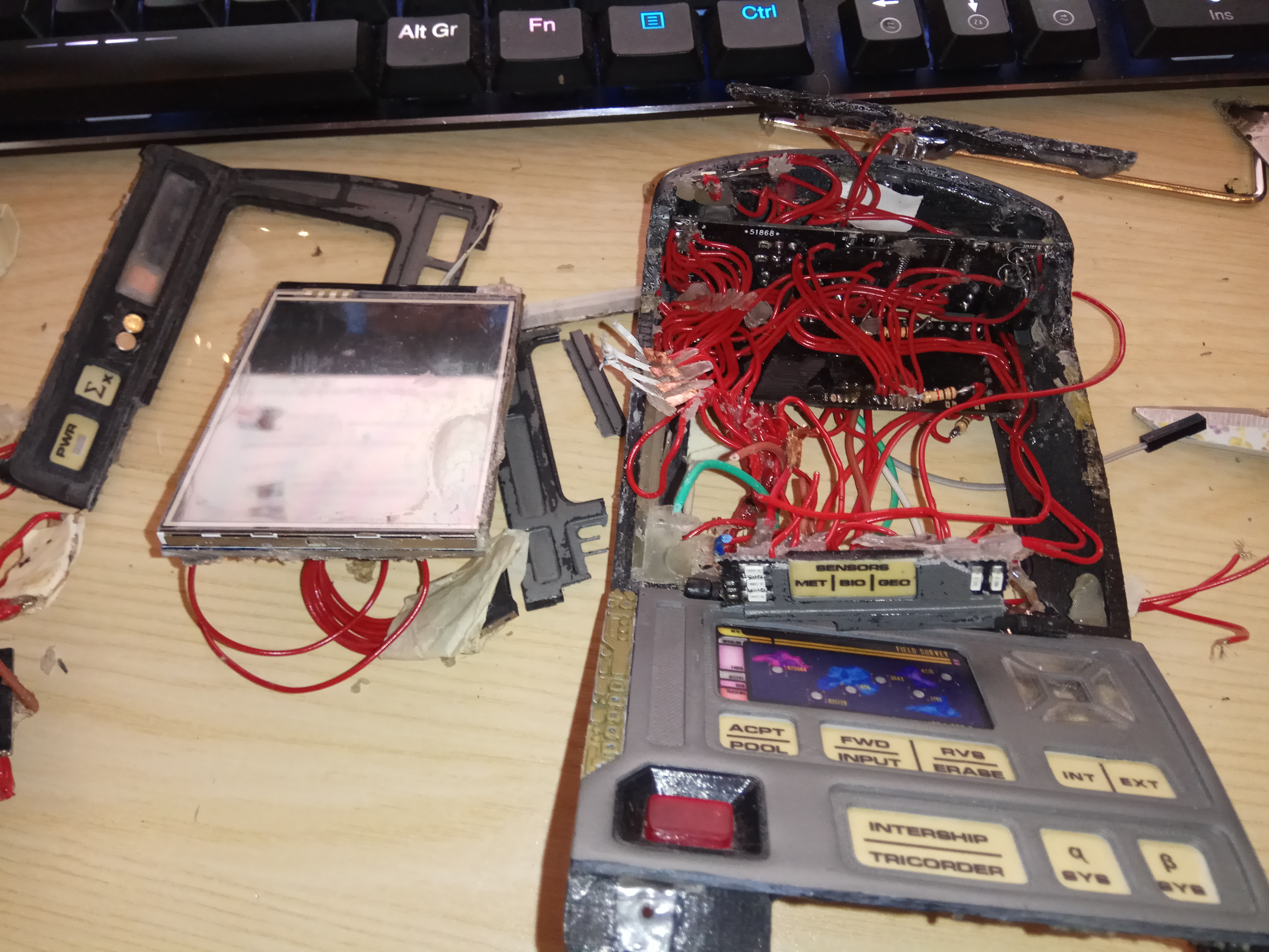

Ive also just destroyed the old tricorder to get the parts to salvage. Mostly the LCD screen and TLC5947 PWM drivers.
There are far too many wires in this design too... The new PCB design also means less wires... And ill be using wrapping wire from now on too so thinner...
Also there was plenty of wires as I did a fair number of little fixes and hacks which obviously made it more messy...

Right yes so where am i... well ive actually been working on the printer again this last few days... Finally got the mains powered heat bed working and I think ive worked out how im going to do the lid... This printer could be less than a week away from being fully functional (give it 3 weeks :p ) But like i mentioned before I might not wait that long before I start printing some of the parts in my old printer.
