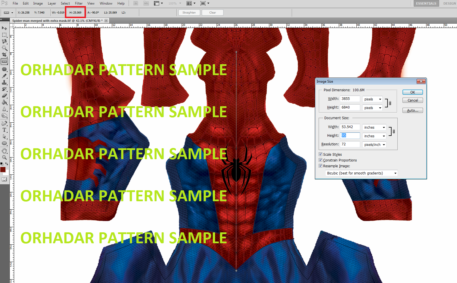

I bought a pattern from the very talented Orhadar. He has been helpful in instructing me how to resize the pattern to my height. The pattern by default will fit anyone from 5'9'' to 6'1''. I'm 5'3''... very short for the default size. So there was work to be done.
Resizing the Pattern:
  • First, I measured the distance between the MIDDLE of the mask and the BOTTOM of the belt using the Ruler Tool in Photoshop.
  • The default distance of this is 29'' (for someone who is 5'9'' to 6'1''). And since I'm only 5'3'', I need to subtract 6''.
  • The way I resized the pattern was I went to Image -> Image Size. On the Document Size portion, I noticed that the Width and Height linked (when I change width the height changes too). I kept them linked because that's how they were sent to me.
  • The problem is, even if I subtract 6inches to the height, the distance between the middle of the mask and the bottom of the belt doesn't become 23inches. So I did trial and error until I achieved the distance of 25inches. I subtracted a total of 15inches from the size of the pattern. Please see the picture below:
I decided 25inches because when I make the preview 100% and put my hand up against the computer screen to measure the gloves, I find 23inches very small for my hands. Even 25inches seems small to me. Or is that normal?
Please let me know if what I did was correct in terms of resizing the pattern. I want to be sure I did it correctly so people can refer back to this thread if they want to resize their patterns. And I also want the suit to fit me... And if you have any tips on how you resized your patterns, please let me know as well. I will greatly appreciate it.

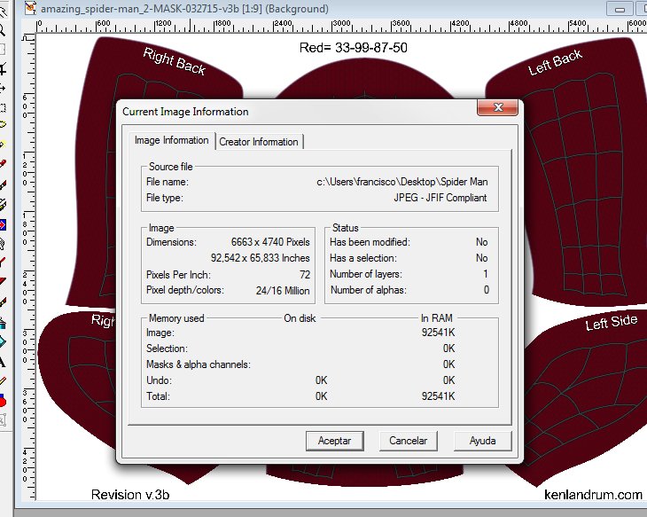

You show the picture of Ken`s mask,,, I`d like to ask you a question if you don`t mind ....... did you have to re-sized the file of this separated mask??
I don`t have photoshop, what I have is Jasc Paint Pro Shop, and when I open the file of this mask, the current imege information in inches is 92.542x65.833 .....way to big... why?
ok, I think I have to re-size, what is the correct size for this single mask ,,, anyone?? Thanks a lot !!!
