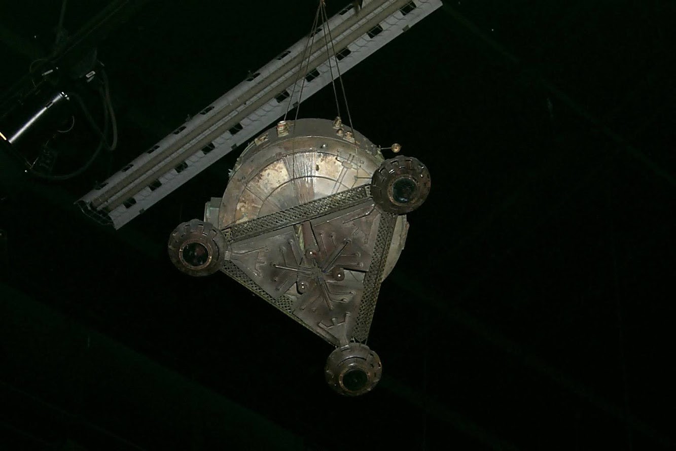

I've notice a few discussions here and there about the Palomino ship not being on your landing platform, the free 3D files available of the ship does seem to have all the details like the real model. But this person seems to have the most accurate one available, 3d Files Palomino, but it is not free.
Here's a few pics I took back in the year 2000 when the real model was stationed at MGM studios at WDW. (using an old Kodak DC265)
Palomino (Pic2)
Palomino (Pic 3)

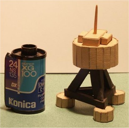

What my 10 year old self thought what the Palomino ship looked like in 1979, with no reference photos :p. using cereal box as main material.

Thanks for the kind words and the Palomino pictures. I grew up in Orlando and my wife worked for Disney the first 11 years of our marriage. We made one trip to the studio park but had to leave early because of a prior commitment. I find out decades later that the Black Hole hero models (except Cygnus) were on display out there. I was annoyed about that. The pictures will help when I build my big Palomino. I’ll find the scale but I think it’s 1/196 scale. It was sold at Kremmen’s shop at the former Shapeways. This is the guy who is the guy who helped with Primitive Dave develope Cygnus.
