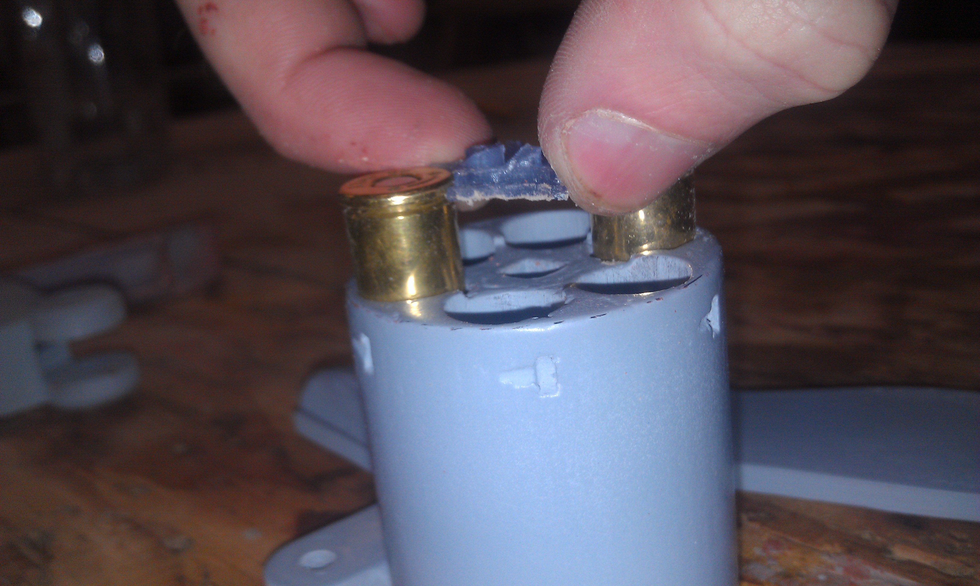

As you can see, I finally got around to priming and polishing the rest of the external parts. I managed to get ahold of two .45 colt rounds to get the new cylinders properly sized. I went ahead and made the original fluted cylinder as well, which looks way more aggressive and super cool.
The plan is to include six cast bullets and six empty casings with each cylinder. The ejector fits perfectly, and the bullets catch, yet still fit loosely enough in the cylinder that even the painted resin ones shouldn't stick at all:
If the ejector mechanism ends up working as designed, I'm going to spend hours just reloading it over and over :D
