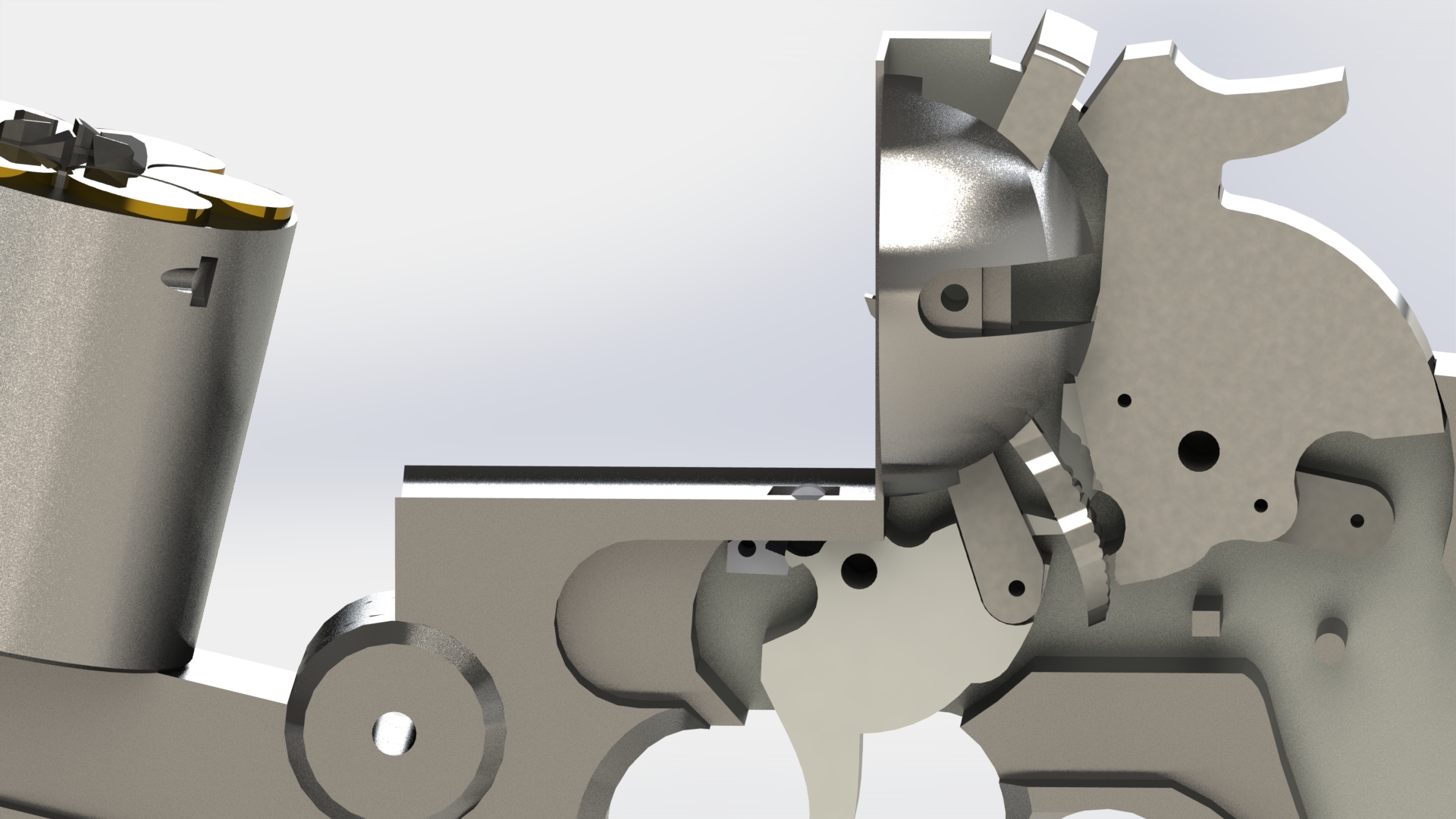

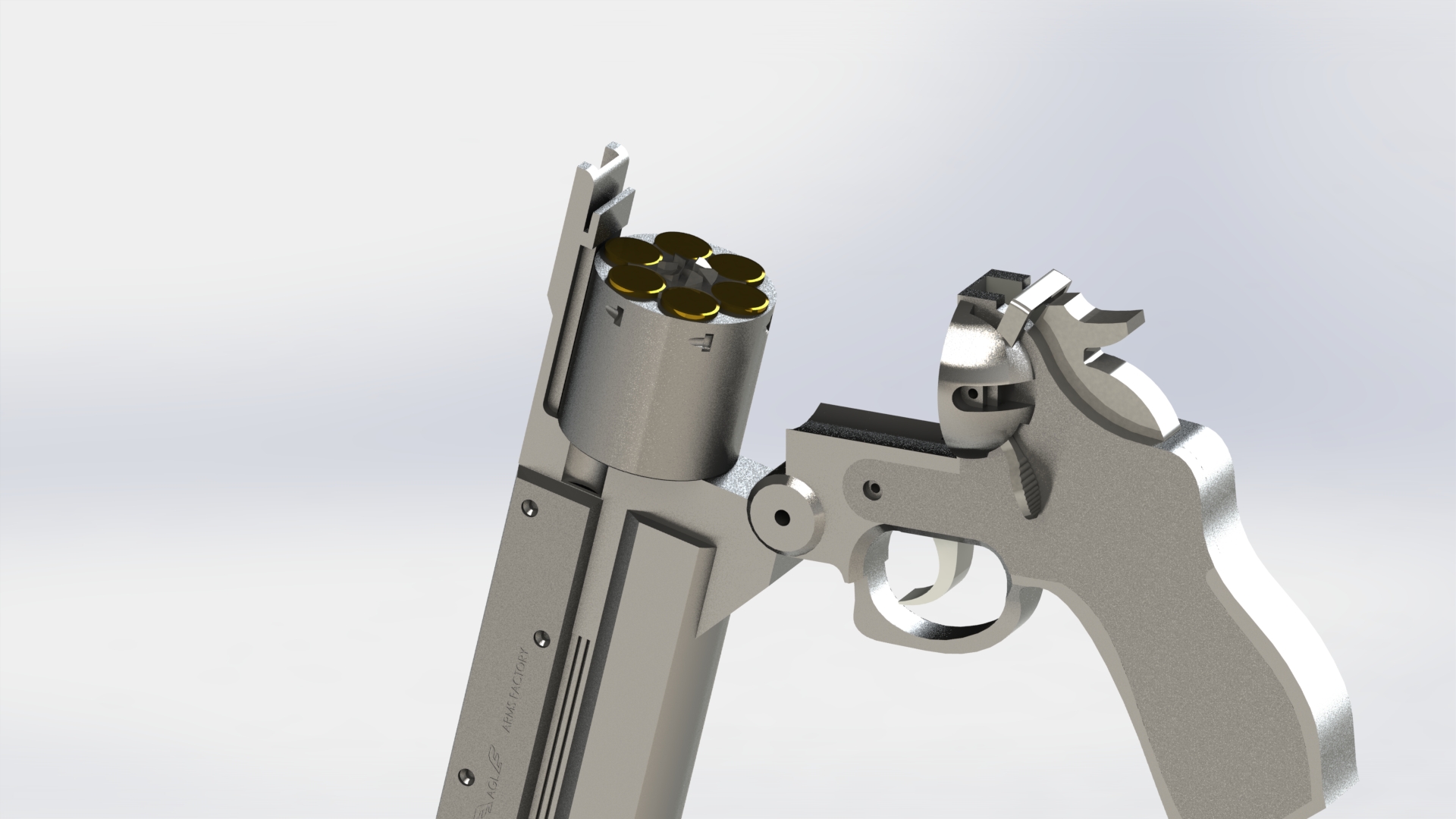

Have some more shiny renders:
Cracked open:

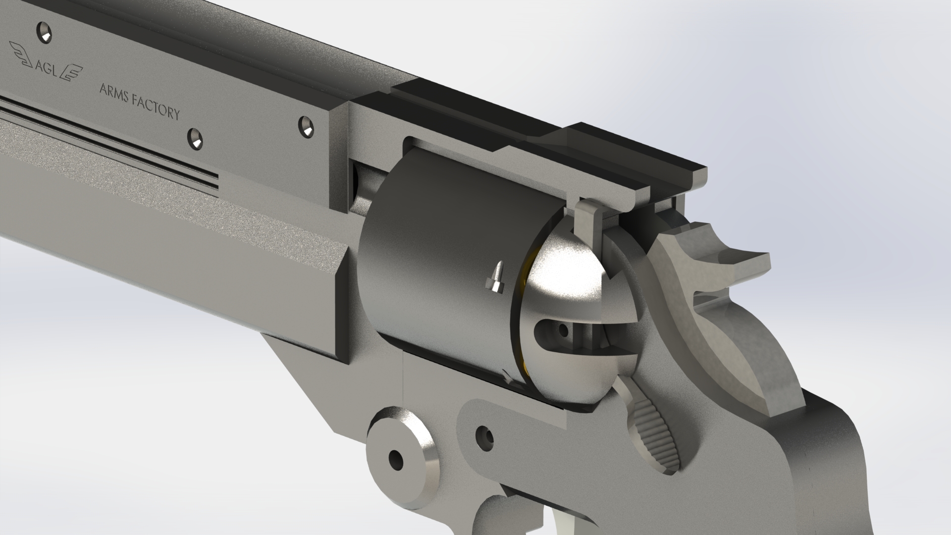

Finished the cylinder stop, so all it needs is a spring:

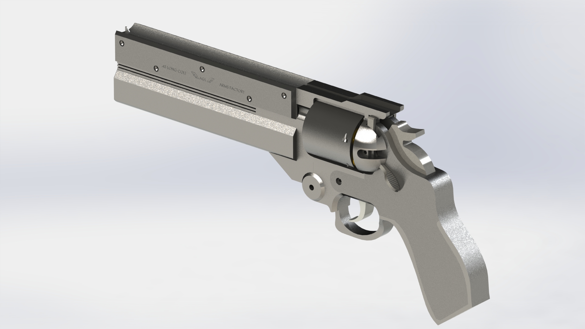

..and the whole thing so far:
All the functionality is there, except for the auto ejector, which is definitely going to be a PITA to get working. Everything else is just aesthetics: trigger guard, text, screw holes, grip, and power cell parts.
I'll be fighting badguys in no time :)

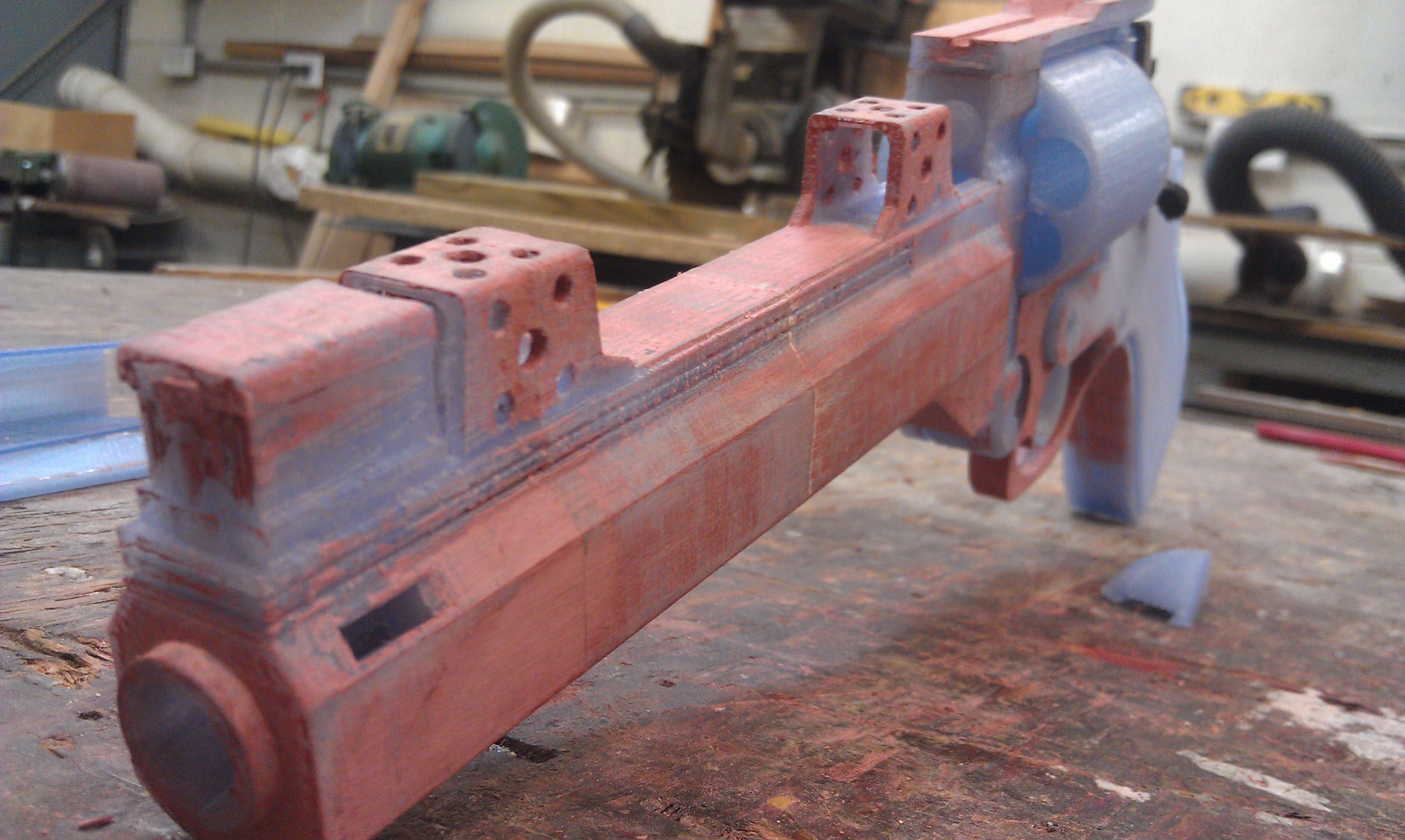

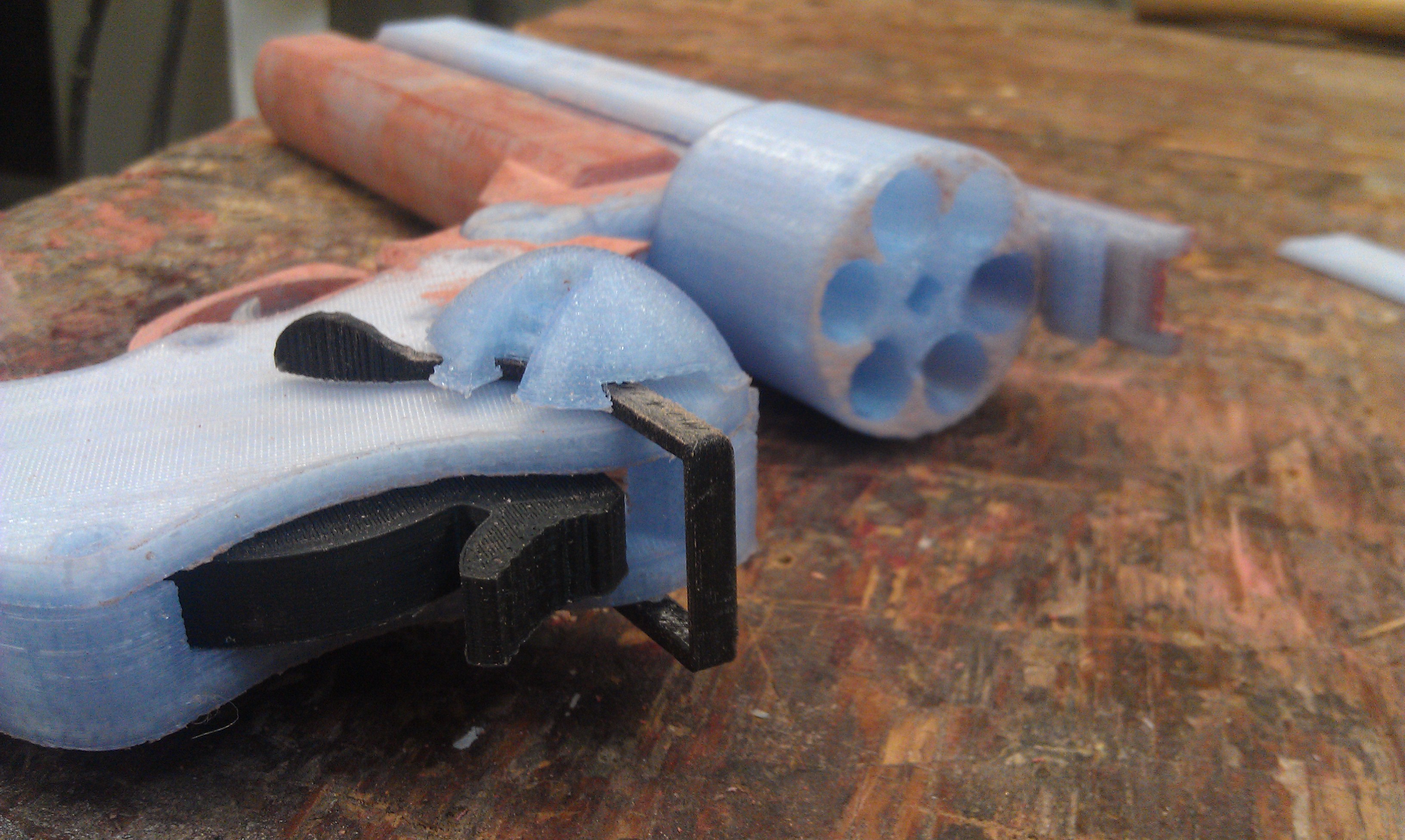

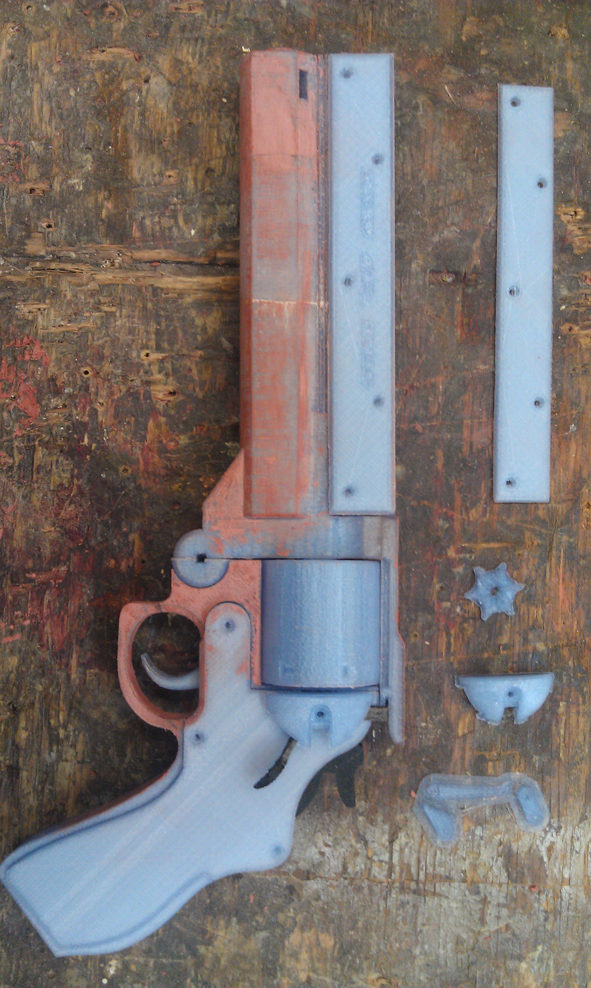

Ok, my 3D printer has been working all week, and I've gotten most of the printed masters done.
I've finally started cleaning and filling the prints, so here's a quick update with some test fittings:
There's still a few days' worth of epoxying, sanding, bondoing, sanding, priming, sanding, and sanding left to go. Then I get to move on to sanding.
I want to get everything as shiny as nickel-plated steel before making the molds
I decided use the first ejector design, since it will be more sturdy. Basically, there's an arc-shaped slot that goes through the barrel to hold the auto-ejector lever.
It's going to be a pain to mold as one piece, but it will make the finished product way nicer, with much less noticeable seam lines than doing it as two halves. I might have to use a three-piece mold, so that'll be fun to learn.
If all goes according to plan, there's a possibility of a cold-cast metal run. More updates soon!

Pardon me for asking (and yes, it's a great build so far; SolidWorks rocks) but instead of sanding, couldn't use acetone to remove the ridges left from the printing?
