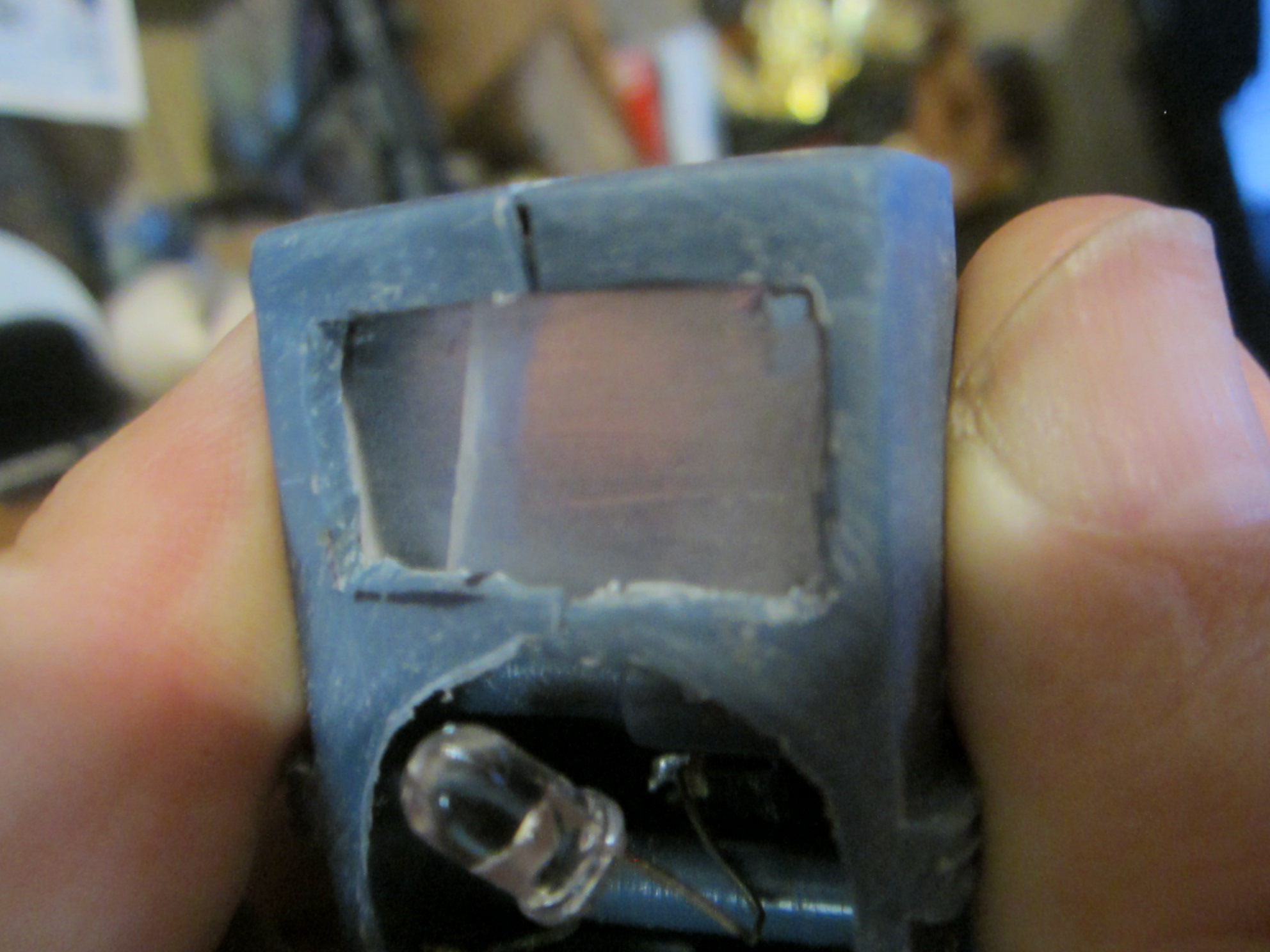

My attempt to use two pliers to break the P1 viewing window in the P2 failed miserably. The DS / AA acrylic BENDS instead of Breaks. This created an unfixable white mark inside the acrylic. I'll have to replace it.

My main plan is to quickly try and duplicate the external appearance of the HA HERO phaser using a Diamond Select / Art Asylum's stock toy phaser.

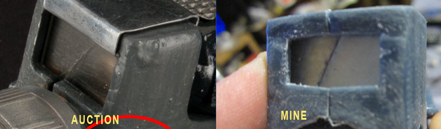

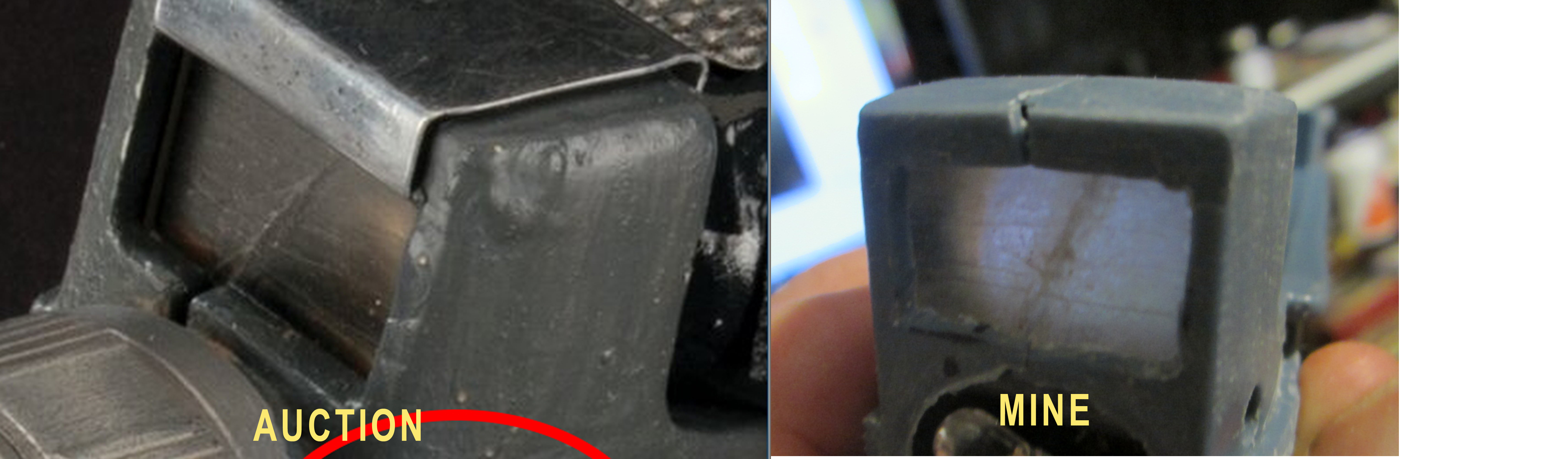

The DS / AA has a view window in the front of the P2, but I had to cut a window in the back of that area to show the P1, as is the auction piece.
Once I posted my comparison pic, it looks like I'll have to enlarge the view window in front and cut a new acrylic piece anyway.
Since I wanted a specific line, I tried cutting that line with a jewelers saw. I'll try your method, next.
Lots of sanding and cutting, but nothing that a "GOOD" paintjob won't cover up !!!!! laugh 2.gif

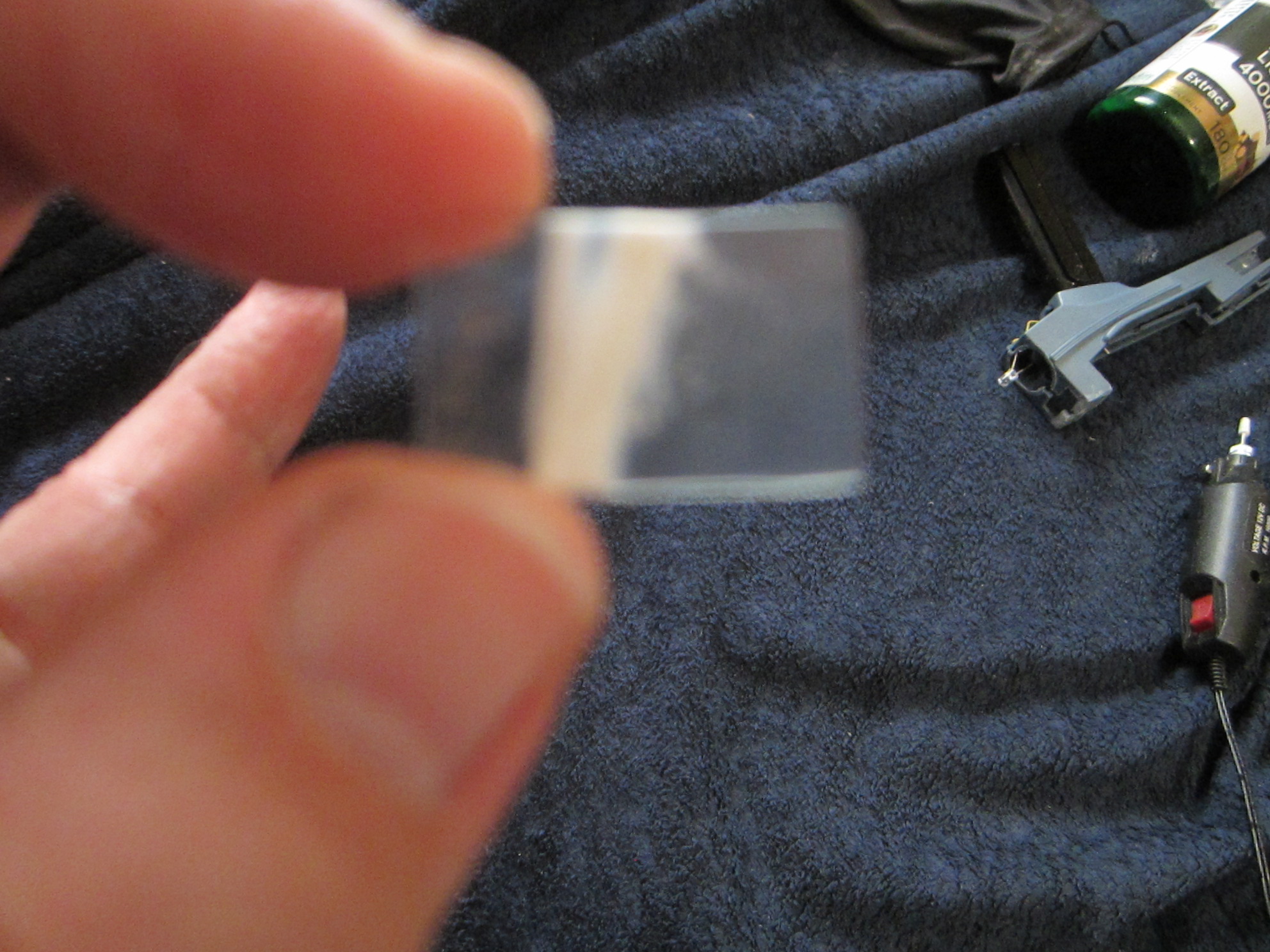

Also, I coated my acrylic with fingernail polish, to give it that SEMI-transparent look like the HA Hero.
Tried normal acrylic without any freezing. It did well enough. Clearly the DS / AA is just a softer acrylic and not suitable.
Now, just how to break on a specific line.

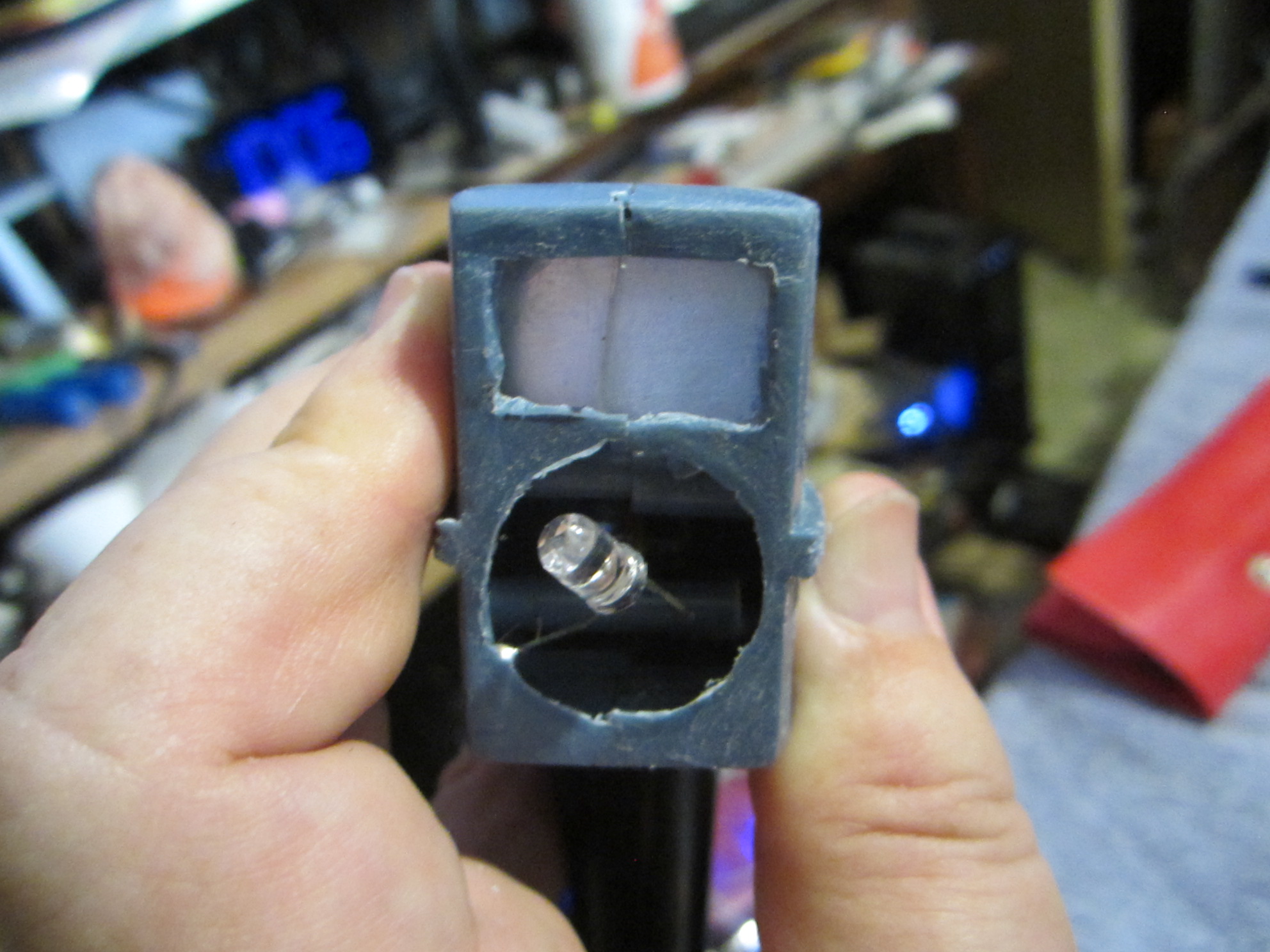

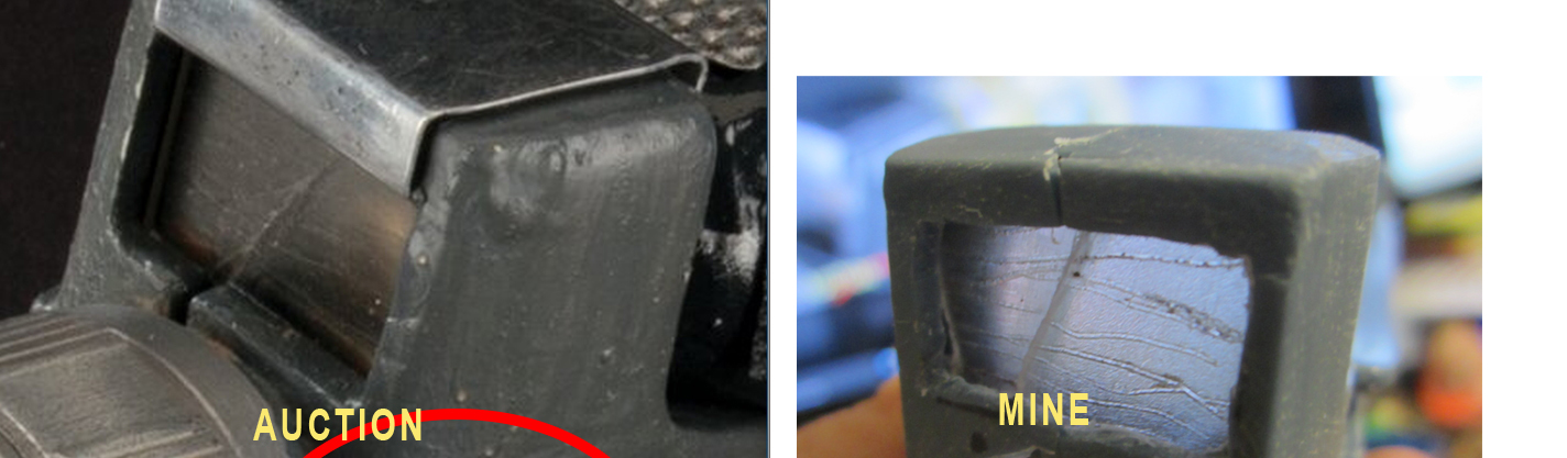

I enlarged my window, cut a new larger acrylic, and broke it. (intentionally) Then I coated it with clear nail polish.
The method I used to break it was to put it on a solid metal table, put a heavy block of steel on top, with a sharp edge lined up with the sharp edge of the metal table. I then just put pressure with my fingers on the overhanging edge of the acrylic. It snapped off easily.

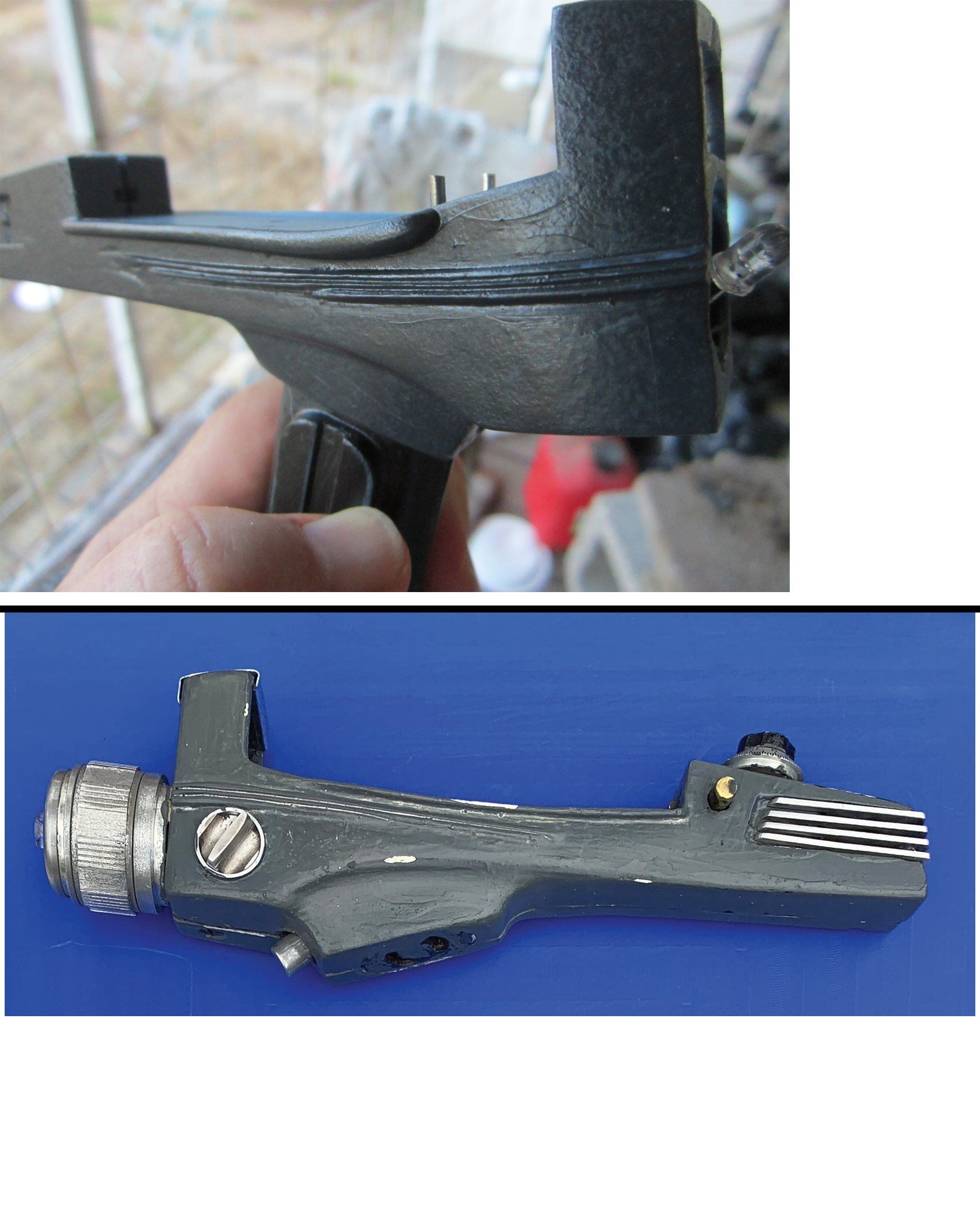

Trying to get the angle and position right, now. If you were making this from scratch, you could put it anywhere. But I want to at least try to match the HA Hero position and angle.

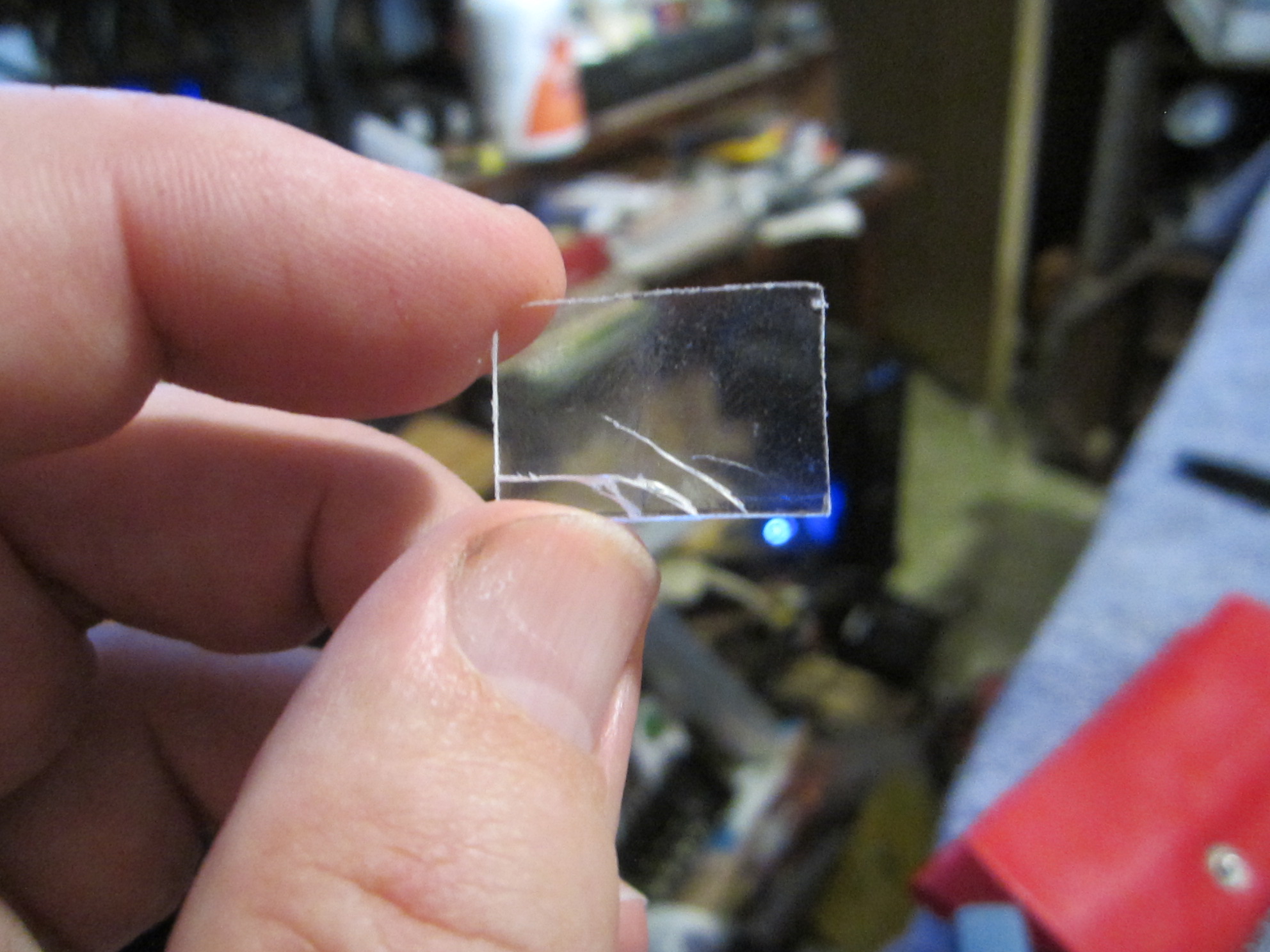

I also added some horizontal lines with an X-actor knife before applying nail polish. Might do deeper lines next time.
Okay, I'm calling that good for now on the acrylic.
I also hit it with some rough sandpaper at the end.

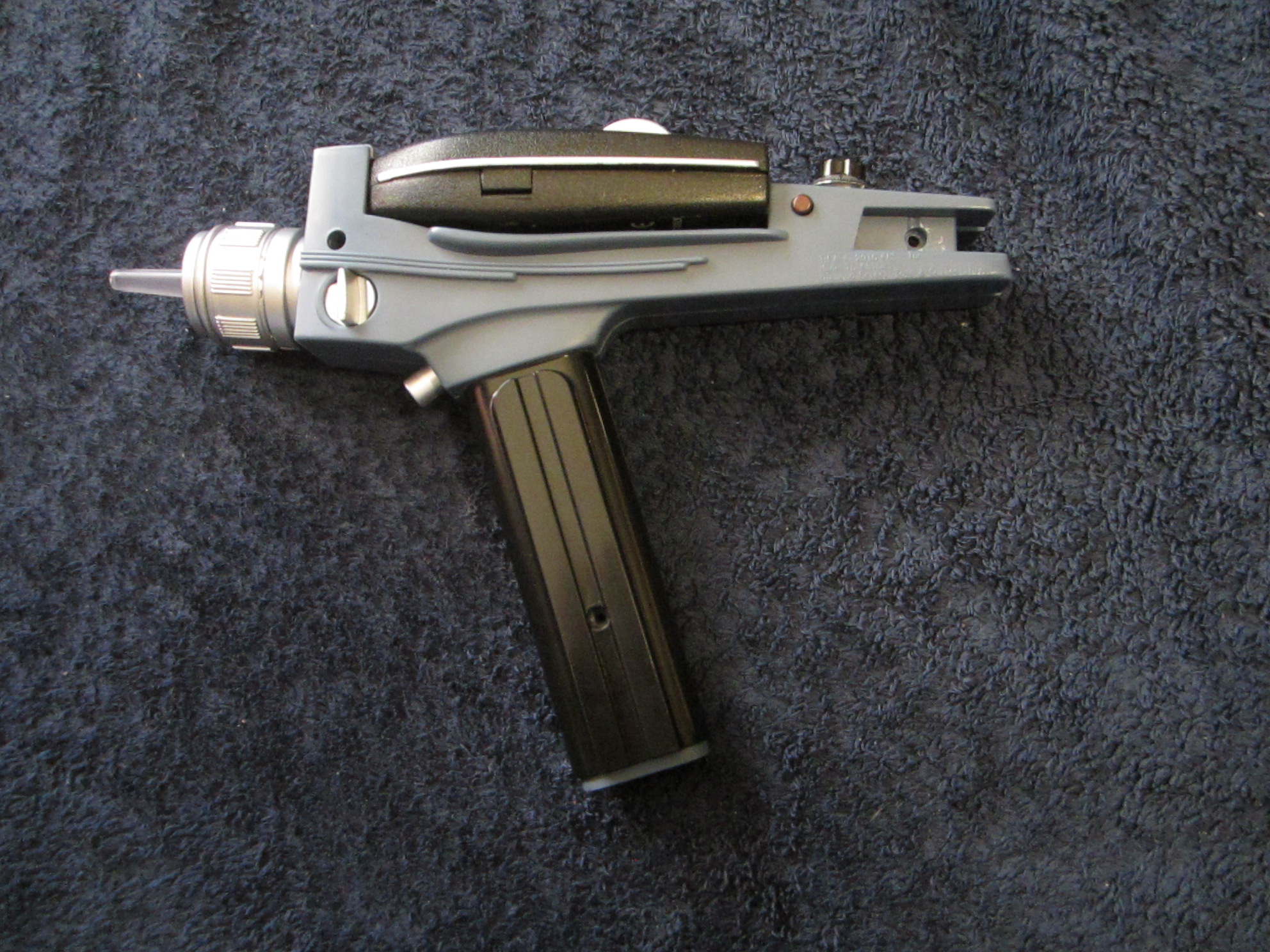

So, here's my paint test. I like the color. But if it needs changed, please say so. This is not the final paint job, just the paint test. This is outdoors, late afternoon.
This is a tough one. Without seeing anything in person, I’d say *maybe* your paint is either very close or just a touch dark? I’m sure that my own build is too light, so that probably makes me biased. FWIW, I think the heroes are a shade darker than the mid grades.
Yep, then the picture is good. And you're right, It's too dark. It actually became darker when I put on the top coat. I had read about painting a gray color and then adding a top coat to give it the correct finish. Maybe lighten the paint and try again.
