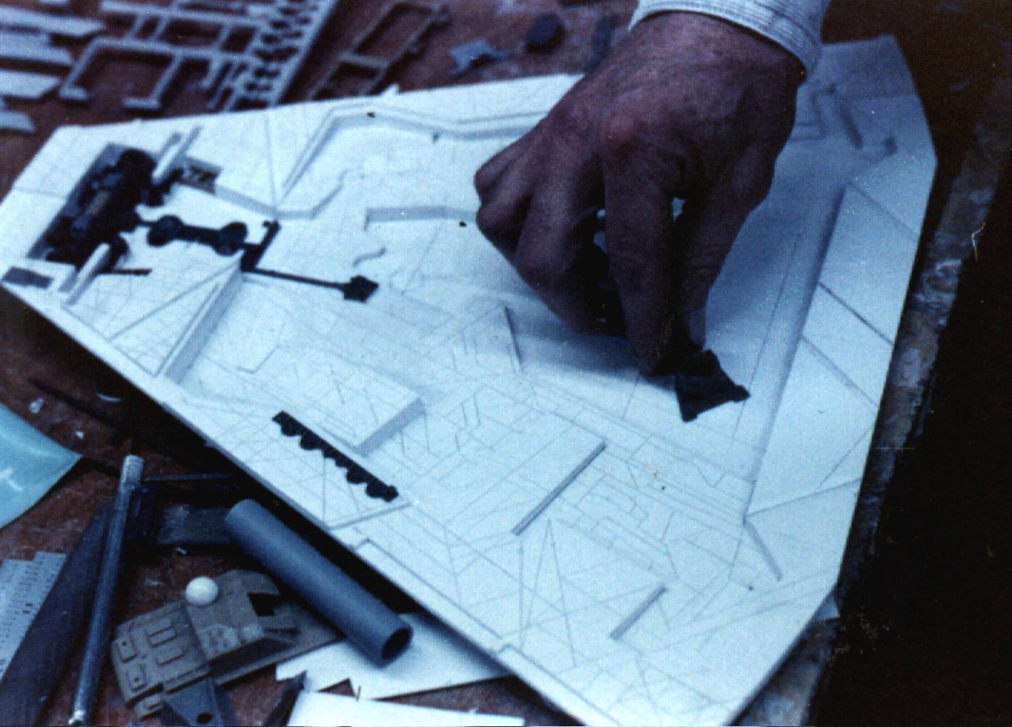

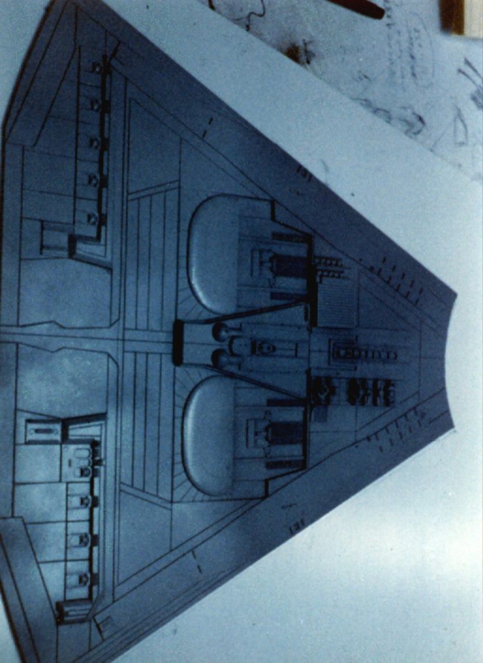

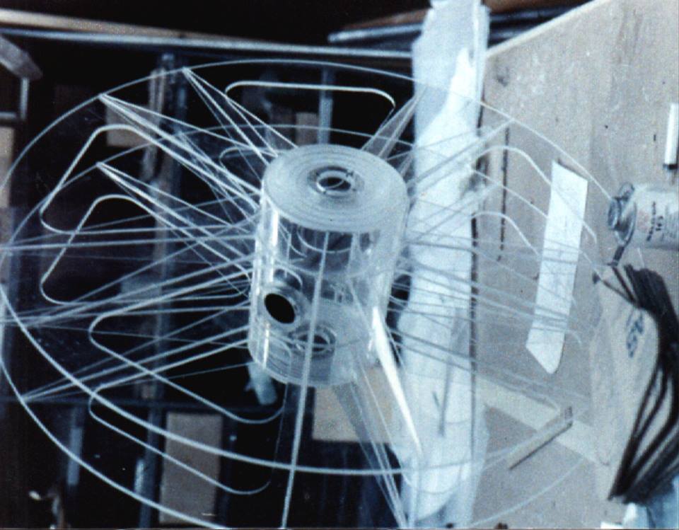

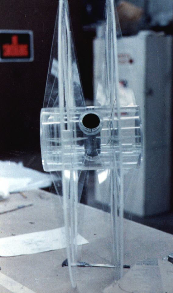

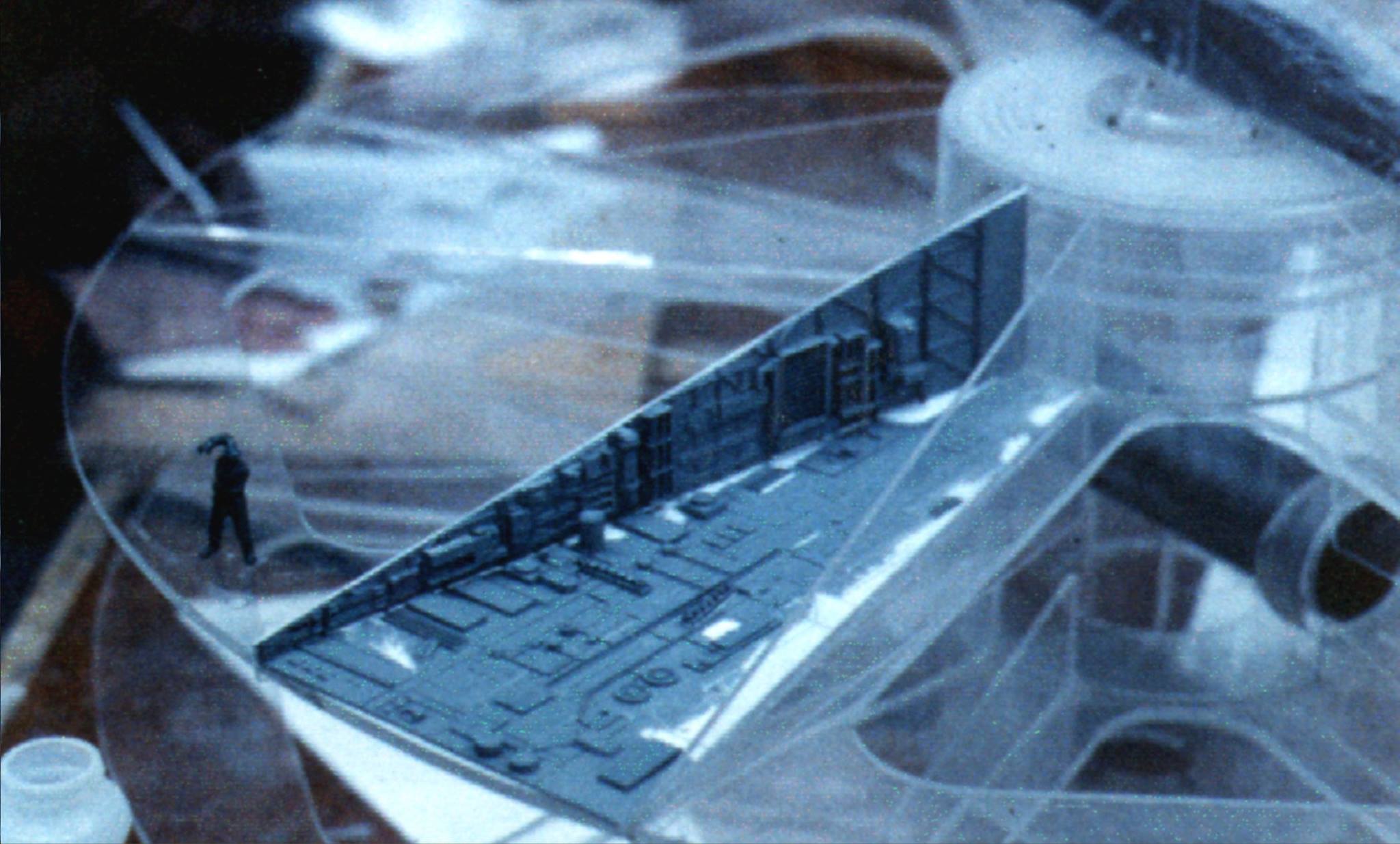

Get some known kit parts & use those for equating your dimensions.
You will not do it any other way.
Also the base of this model is from an acrylic film reel.
You may have better luck finding a 35mm film reel.
Images like this with actual kit parts will get you there. Well as close as you can.

HaHa! They look like film reels but they were custom made acrylic rings. The BaseStar was roughly 3 feet in diameter.
There are some members who have built these before and have very accurate info on them. Do a search on the forum and then give a try contacting those folks.
I'd like to think they would love to give advice to another ambitious builder.
