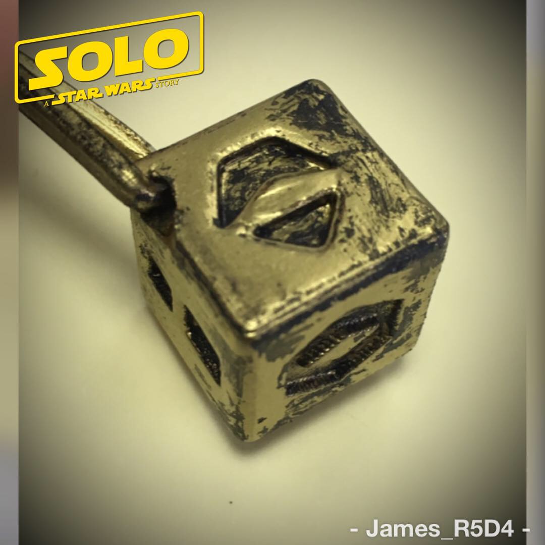

In my screenshot I can see the angled cut-out on that symbol:
Also, if these aren't a hero prop from TLJ, couldn't they potentially be one from Solo?

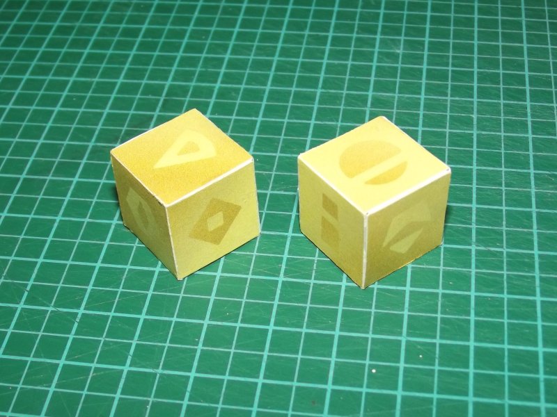

This looks so awesome! I saw the movie last week and wished I had such a nice dice set. Since I love paper models I got inspired by your work and used your dice as a base for a paper model of it:
Thank you and keep up the great work! :)
Nice papercraft version. My tip there is to over-print your colors, so when you cut them out you end up with less white spaces.

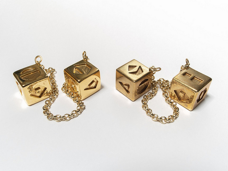

Here is an image of how the dice age if you select "Natural Brass". The dice on the left are 14K gold plated, and are three months old.

Here are the differences that I can spot (Looking at the zinc model):
1: My dice are 16mm in size, which is the size of most common game dice. His zinc dice are 14.5mm, so a bit too small in my mind. (His steel dice are 16.5mm.)
2: His corners are rounded with the equal radii on all corners around. Where I use a variable radius to make my dice look more like the movie used dice. This difference is subtle, but visible in the image above were I used constant radius on the set on the right, and variable on the left.
3: His six sided icon has a the diamond shape in the middle touching the sides of the icon. Mine don't. (More accurate)
4: His five sided icon is too wide, with corners a bit too sharp.
5: His four sided icon has the center portion a bit to small and offset for my taste.
6: The actual depth of the icons are different. Deeper on the zinc dice, and shallower on the steel dice.
