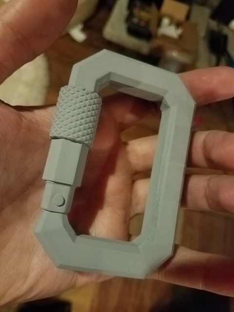

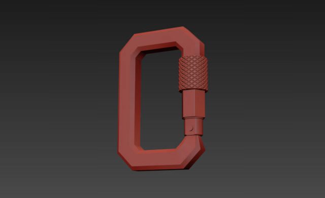

I've noted that the pilots all seem to have caribeaners attached to the front of their armor, presumably for ziplining (in the first game) or whatever. After looking on Amazon for a bit, I was not finding square, chunky caribeaners that fit the look of what I was after, so I went ahead and modeled a quick static part up for printing. Sorry, it doesn't actually clip, but it's just designed to have a loop of fabric sewn through it and onto the armor.
Prints nice enough, though.

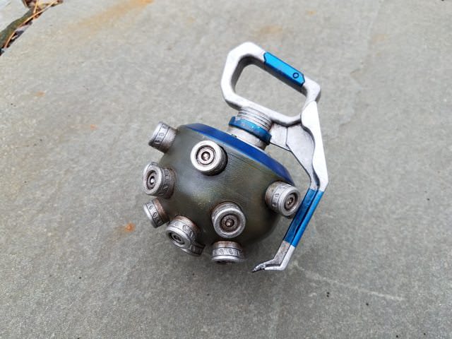

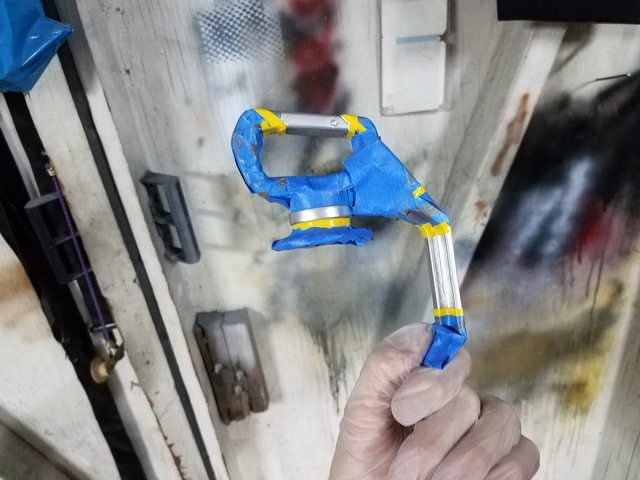

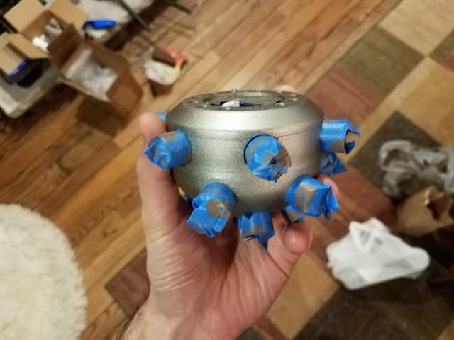

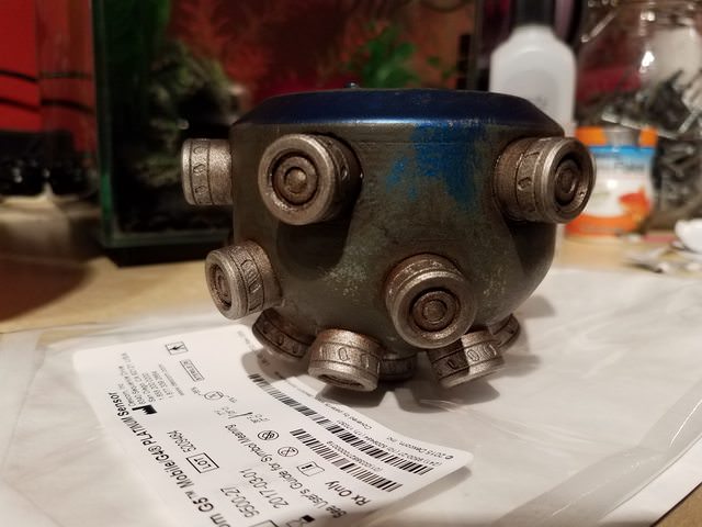

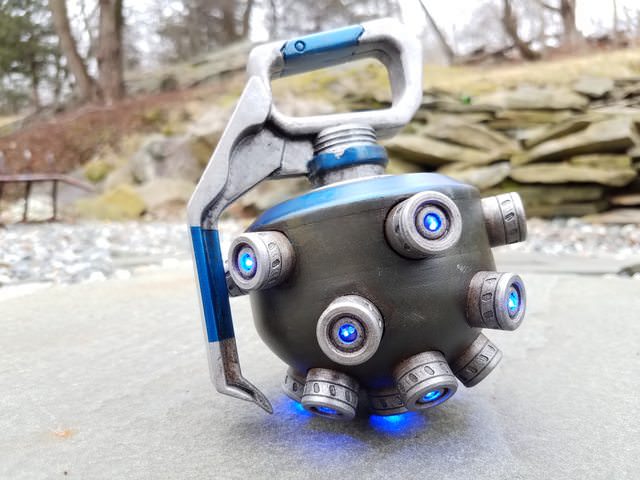

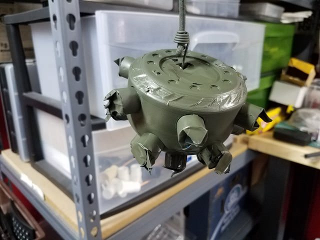

I masked the LEDs on the arc grenade off, then sprayed the whole thing with a rough silver coat that is apparently intended for hubcaps or something. It gave the grenade a bit of a rough finish, which is what I'm after in this instance because it's mass-produced military hardware. The plugs were wrapped in tape after this step, which was actually less tedious than I thought it was going to be.

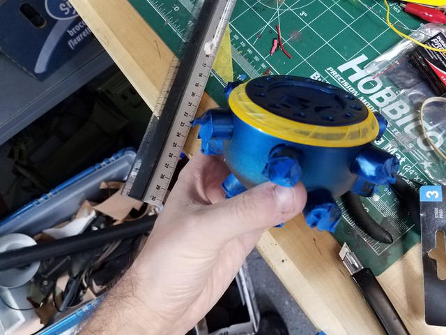

I laid down a few coats of Duplicolor Electric Blue over the top of the grenade, then masked the rim line around the top. The handle got the same treatment.
I sprayed some Rustoleum Deep Forest Green Camouflage spray paint over the body of the grenade in 3 coats, then tried putting a matte sealer over it to keep it firmly on the body of the grenade.
I started adding some washes overtop of the green once I thought it had dried sufficiently (overnight), using burnt umber oil paints thinned with mineral spirits. Unfortunately...
... the green coat started coming right off, even through the matte sealer. Woops. Fortunately, I have plenty of appropriately-colored miniature paints from my wargaming days that matched the body of the grenade, so I stippled those on manually over the spots where the blue was showing through.
It's not perfect. It's far from it. I'm not very good at painting these days. Still, it's done!

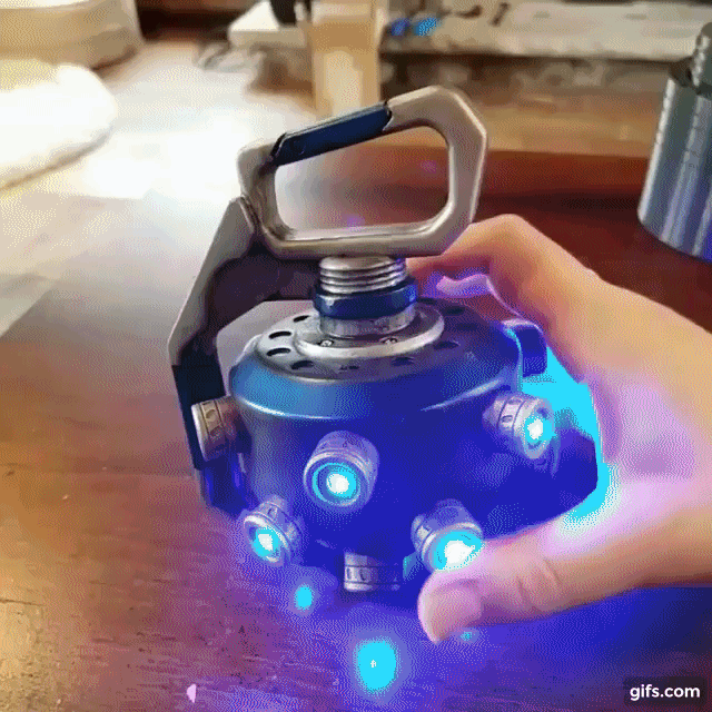

I uploaded a video to Youtube for anyone who cares to hear the sound effects with it.

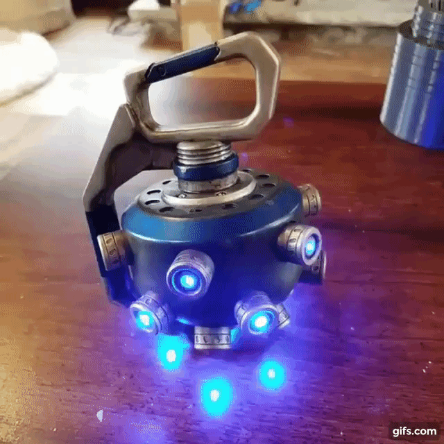

I've added the code used for the Data Knife and Arc Grenade to my site for anyone who cares to follow along.

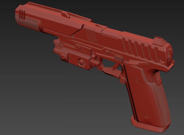

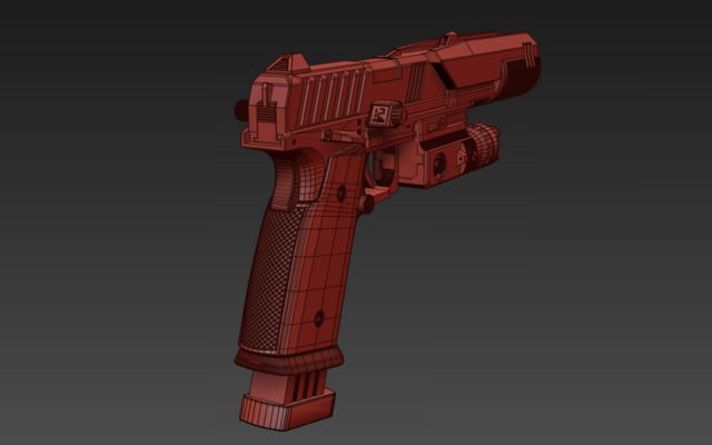

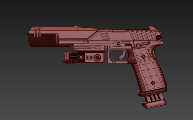

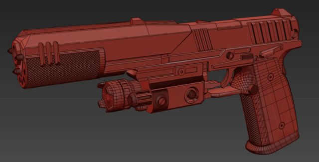

Rendition of the Smart Pistol from Titanfall 1, rather than the one from Titanfall 2. I don't like the look of the T2 one nearly as much, the weird angular barrel is offputting. I'm actually having a hard time keeping this mesh under control, as the boolean operations for combining components on it are getting really stupid really fast with the knurled textures I've modeled. That said, I wanted to push myself to get as accurate a recreation as I could, and I'm getting there.

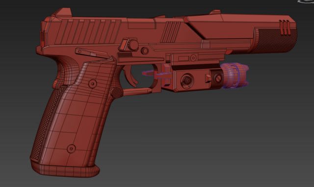

Speaking of which, a bit more progress on the smart pistol. I will be posting files for the 'basic' non-electronics version shortly for people who want a static prop, but I've been occupied working on the 'advanced' model, and I think I'm shooting for the following feature set:
  • Working safety switch to turn the gun electronics on and off.
  • Working trigger action for lights.
  • Sound via speakers installed in the barrel for firing and lock-on audio.
  • Working laser sight on the mounting rails.
  • Working flashlight on the mounting rails.
  • Easy to paint, meaning components can be separated and masked for spray paint/airbrushing without a ton of fiddly work.

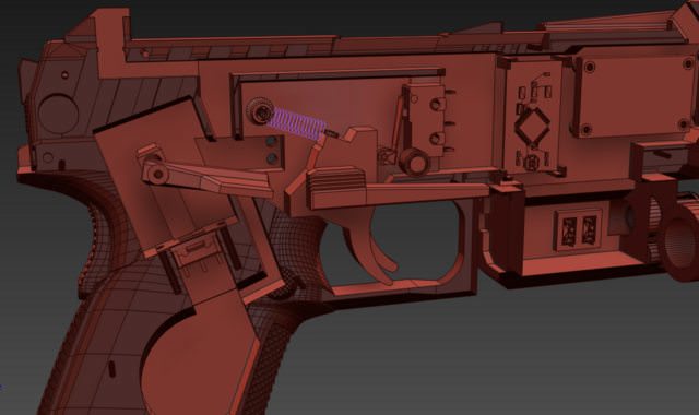

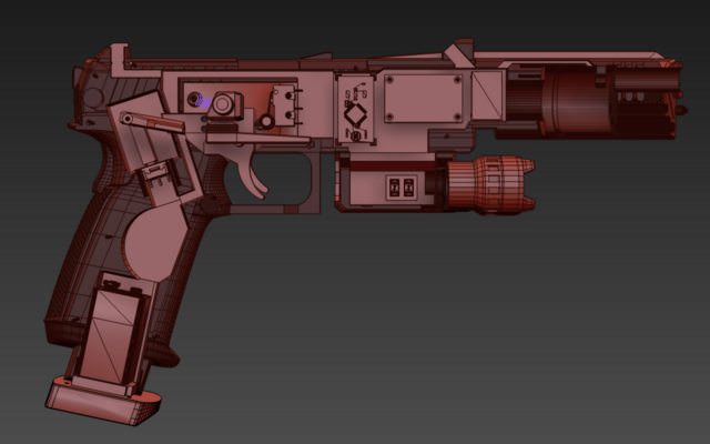

To that end, I spent the better part of a day cleaning up the base model from all the boolean messes I made. Once I got the model cleaned up, I started working on the mechanical actions of things using parts I have lying around my workbench, since I can take accurate measurements of these things.
The safety was the biggest head-scratcher. I wanted to be able to use the paddle like an actual safety on a real gun to engage the power from the 9v battery in the handle, but that requires either a rotary switch that only moves, like, 10 degrees, or some other way of doing it. After a while of brainstorming, here's a look at the safety action I've come up with:
The slide switch used in this instance is a MS12AFW01, which just so happened to have a 3d model available which made the job a little easier. I'm not sure if the switch resistance is going to be enough, by itself, to keep the safety in a fixed position, but I'll engineer something if I have to tweak it.
The trigger, on the other hand, uses a snap-action switch I had lying around, and a 10mm spring.
The flashlight mount has been hollowed out so I can hopefully build a 'flashlight'-esque assembly with a lens and an ultra-bright white LED, while the 'laser' module has been hollowed out to accommodate a red laser diode from Adafruit.
I'm finding the engineering on this to be kind of fun, but there's a lot of work still to do so I can lay out space for the arduino, an amp, a speaker, and figure out how to install the 9v battery into position in the magazine and then have the magazine be removable.

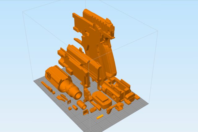

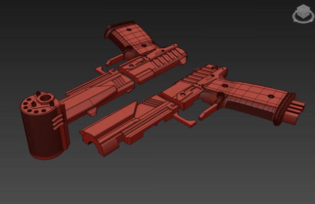

The gun breaks into five ‘main’ exterior shell components, with a number of other small, extra interior parts. This was built this way to make printing easier, so I could orient flat sides down onto my print bed and section it into smaller parts that would fit in my machine.

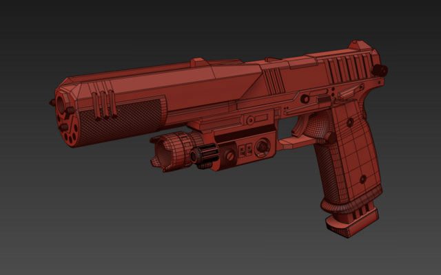

If we dig into the cross-section of the gun, you will see that there have been a number of interior channels hollowed out to accommodate the electronics I have planned.
And here’s a more exploded view of all of the gun’s components sectioned out for printing:
For the sake of being thorough, here's a comprehensive list of parts I believe will be required:
While I can gladly go on at length with images of how the gun’s designed to operate, I felt it would be easier (and more instructive) to record a brief video doing exactly that.
