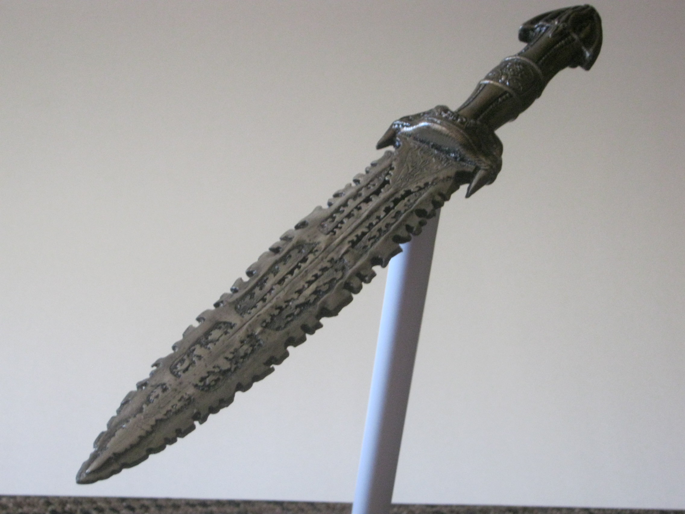

Another very fast and crude test. I can see now what you all are saying about lighting being the key. and I see whats off. I just have to wait to get some more lighting. used the Photobucket tools to play around with It also. It will progress so just be patient with me guys I don't like using the main prop board for test. but It's the only way I can see the last result..
Pre photo bucket
attachment.php
Photo bucket
attachment.php
And Photo bucket's becoming a down right pain. unless I get there add free deal I guess. not going to happen any time soon...
