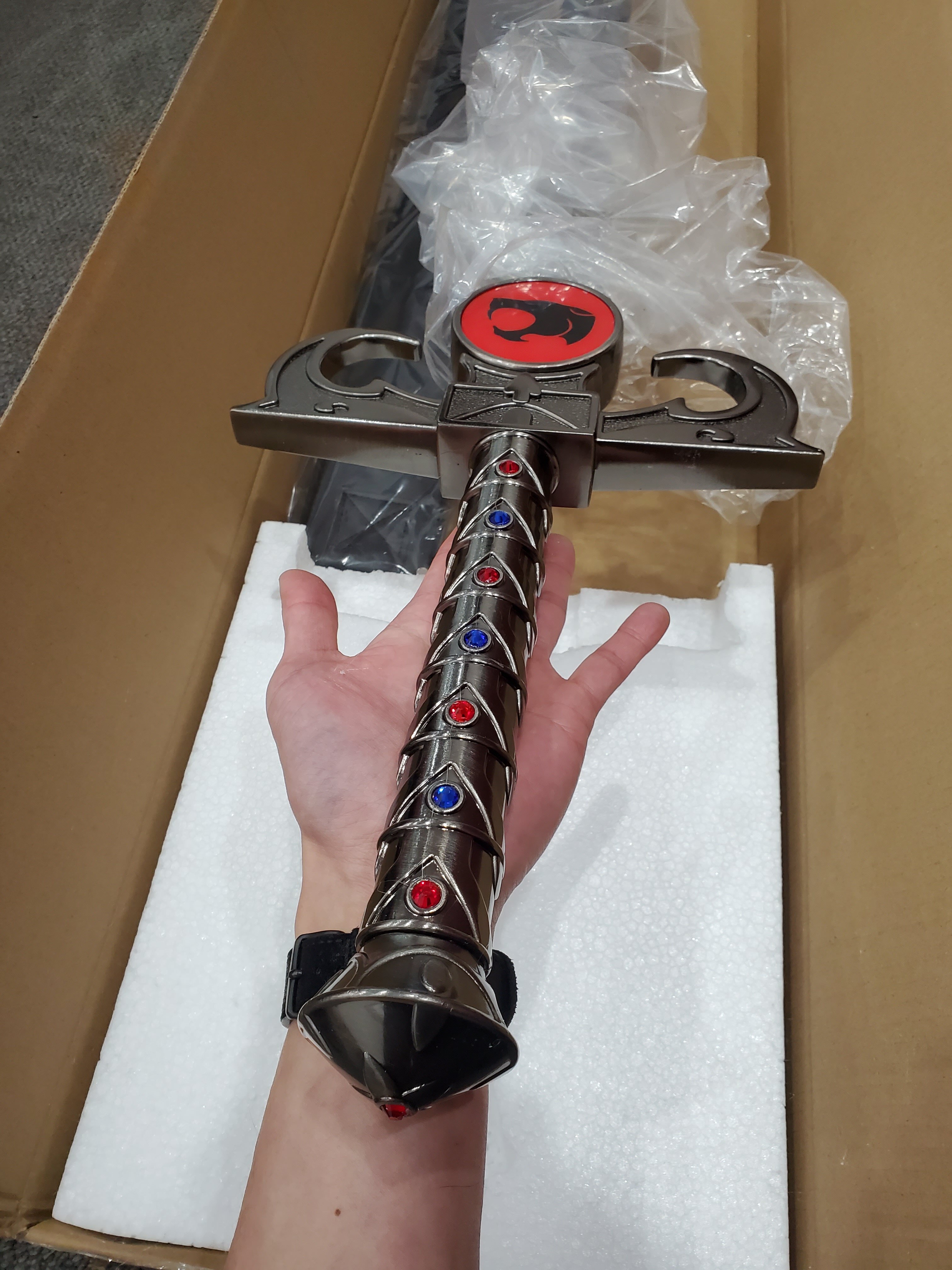

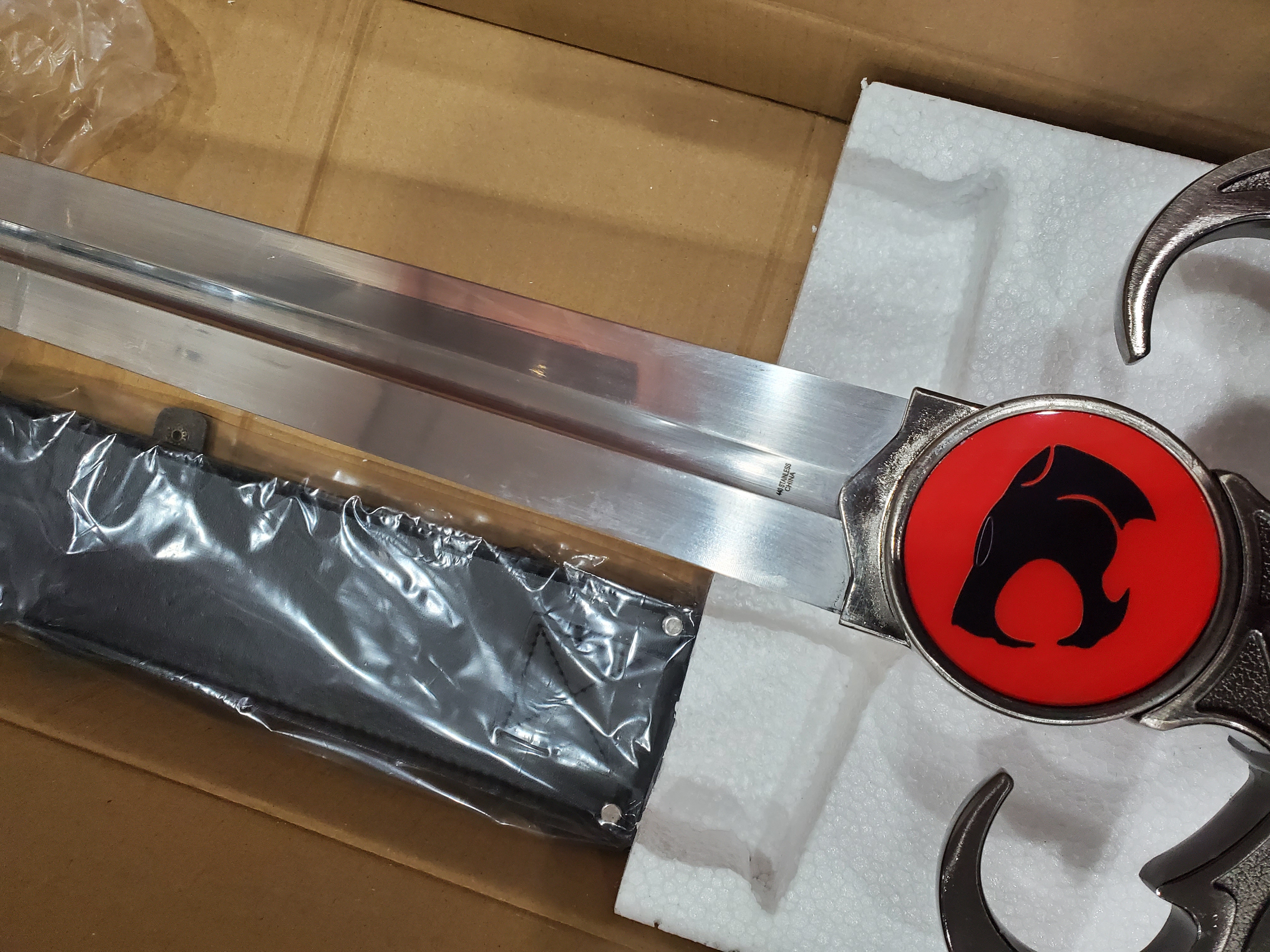

I first picked up this sword -
it's readily available on ebay and everywhere else for approximately $80! Cheap!
If you are going to do this project, please make sure you get the same one, as I can't stress, other swords out there have so many inaccuracies it's not even possible to get it looking right. Plus, I won't know if any of these upgrades will actually fit.

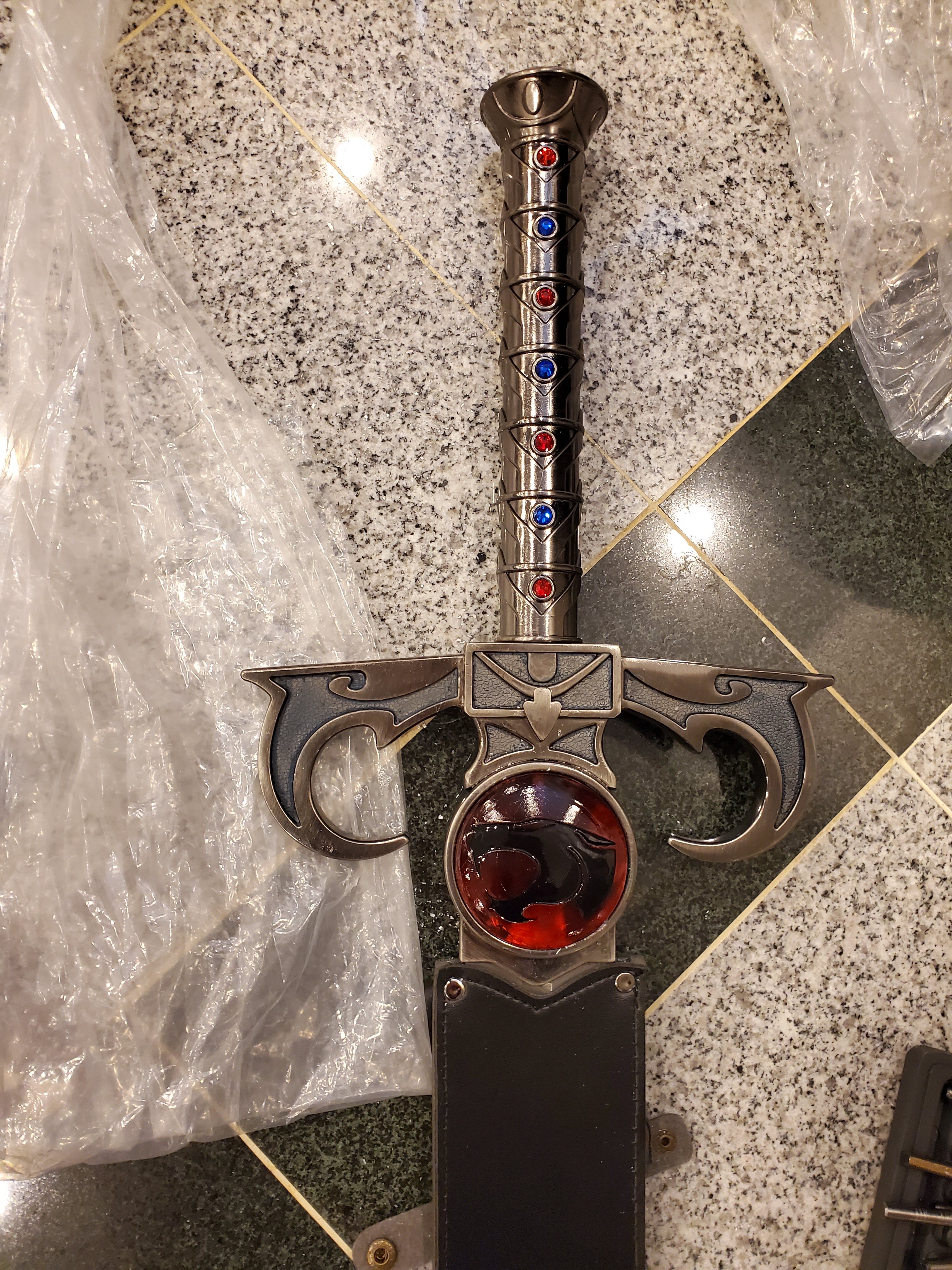

So this sword that came in, has most of the details that I wanted. It had a pretty nice/accurate sculpt. It was proportional. It was all metal. It has jewels in the hilt... all the right boxes were being checked. The most glaring problem was that the eye of Thundera was a sticker! ughhh..

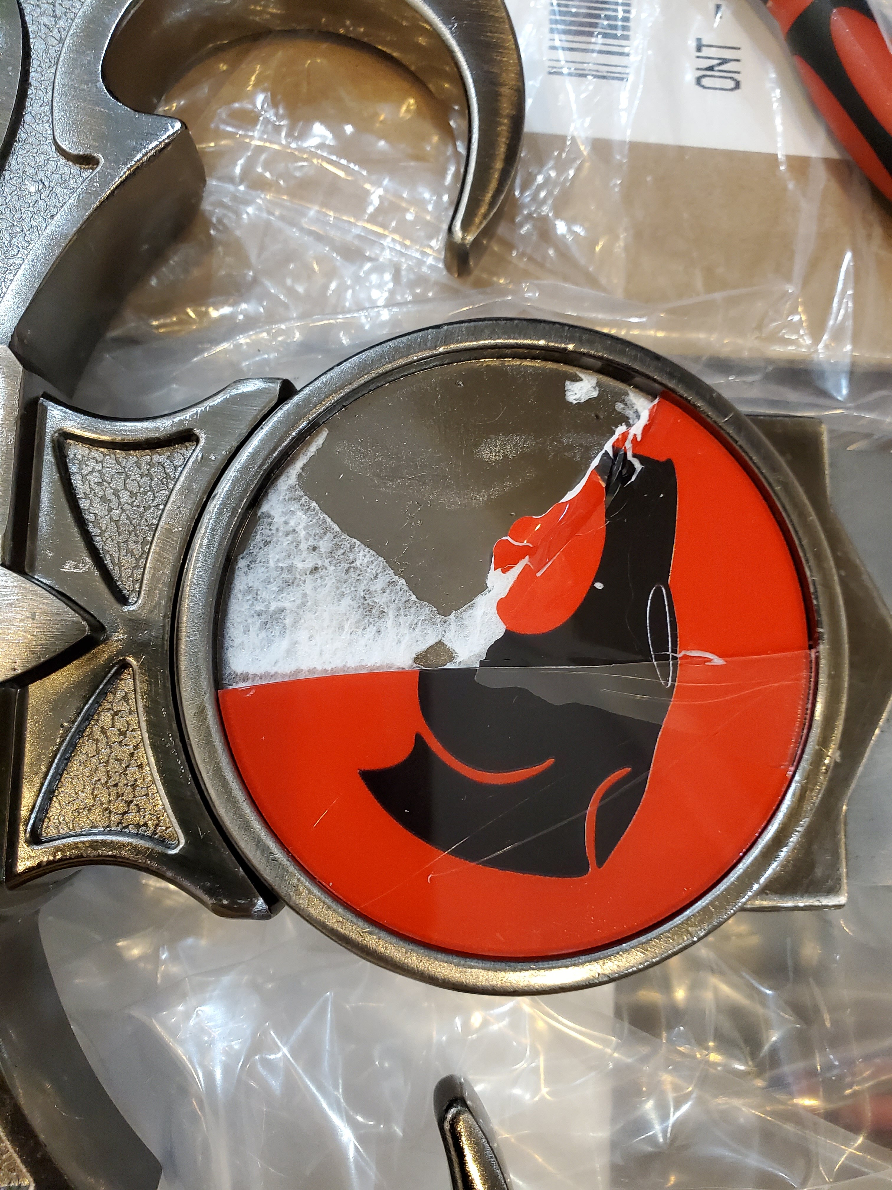

Then I added a bluish tint to the recesses to give the details a bit more "pop." I know the cartoons have it as a little more green sometimes, but I just like the way blue looks better
After this, I realized that the inside of the guard was hollow. So I took a chance and started drilling out the center eye.

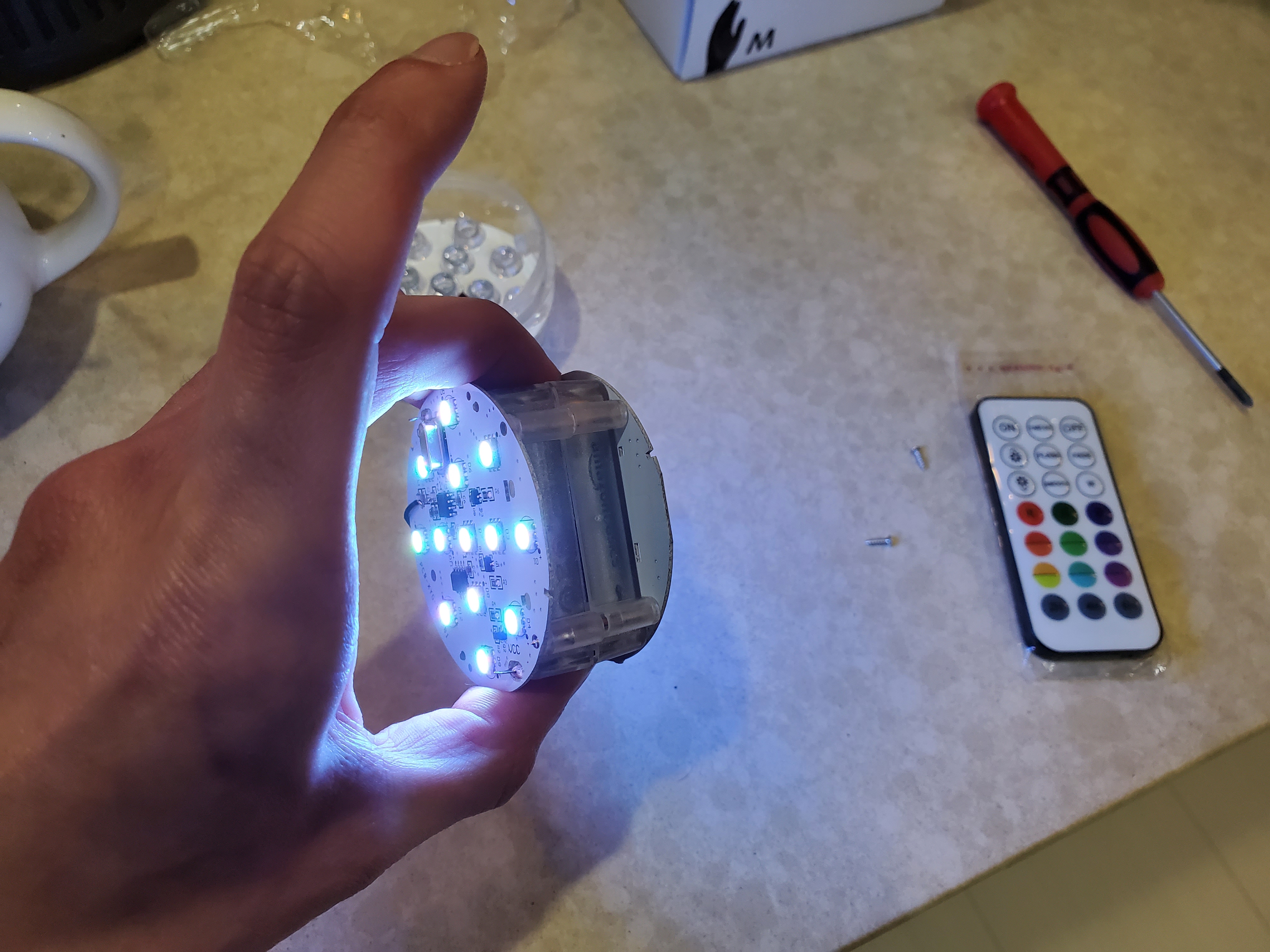

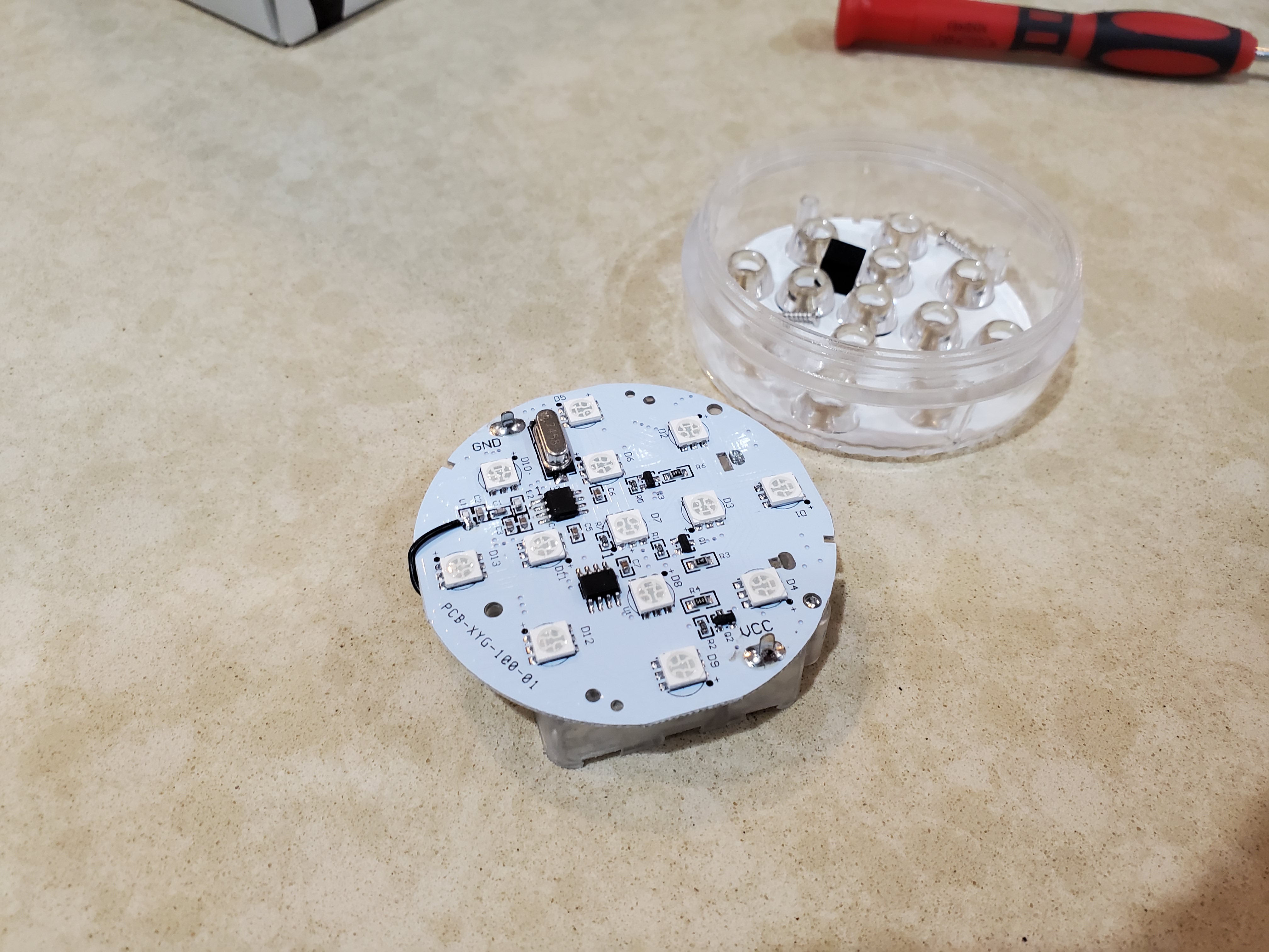

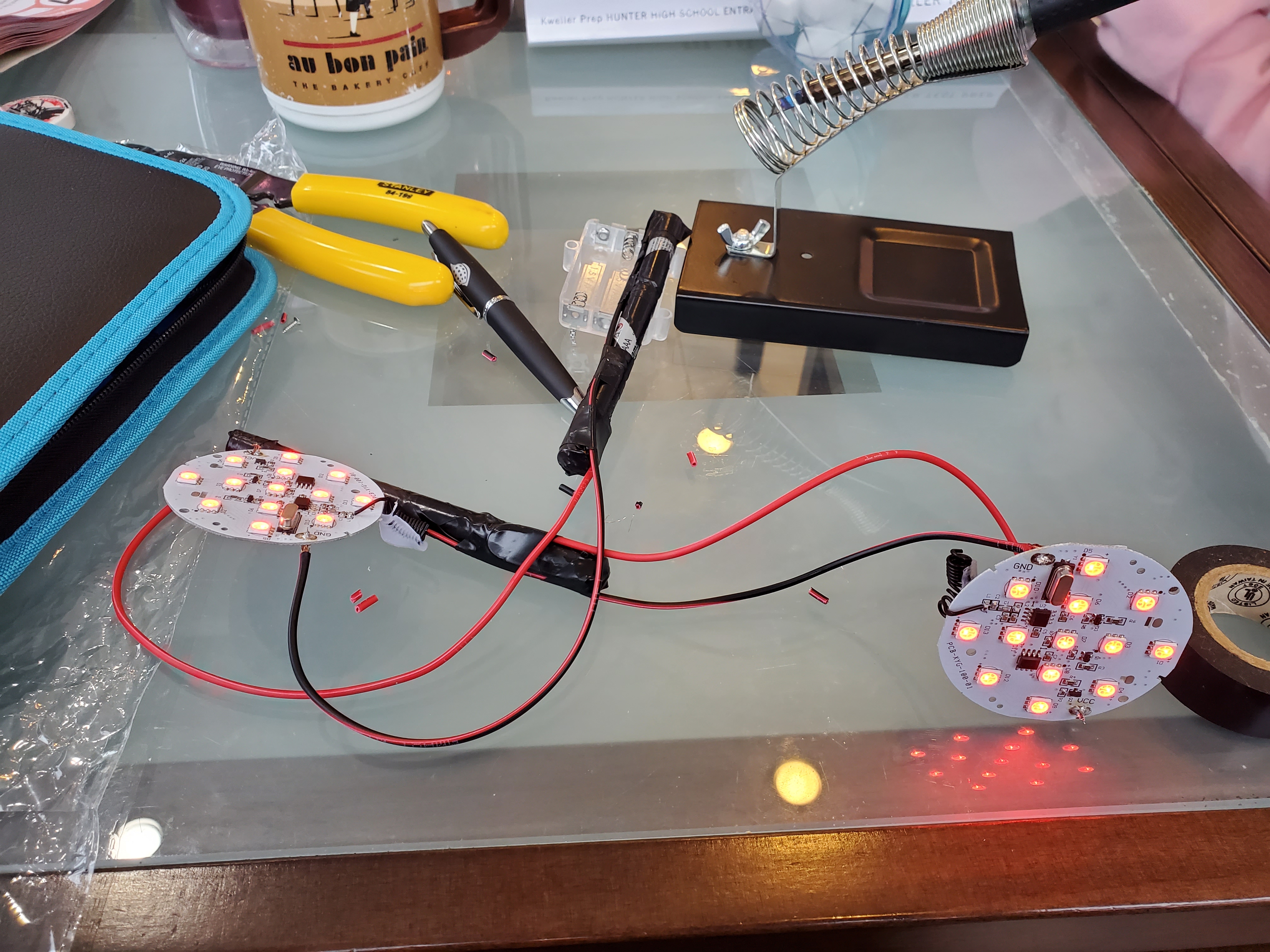

I picked up $5-$10 led puck lights. I figured I could just take the wafer thin boards and get it inside this newly, messily, hogged out hole.
Back to Back they were a bit thick. Plus this sword has a tang running down the center of it, and I did not cut through that so I had to remove the battery compartment completely off of the circuit board and I quickly tested a way to wire them with a series of batteries aligned in a vertical configuration so I could slip the batteries down the hollow metal handle of the sword.
I can't believe that actually worked.... as ghetto as it looks...

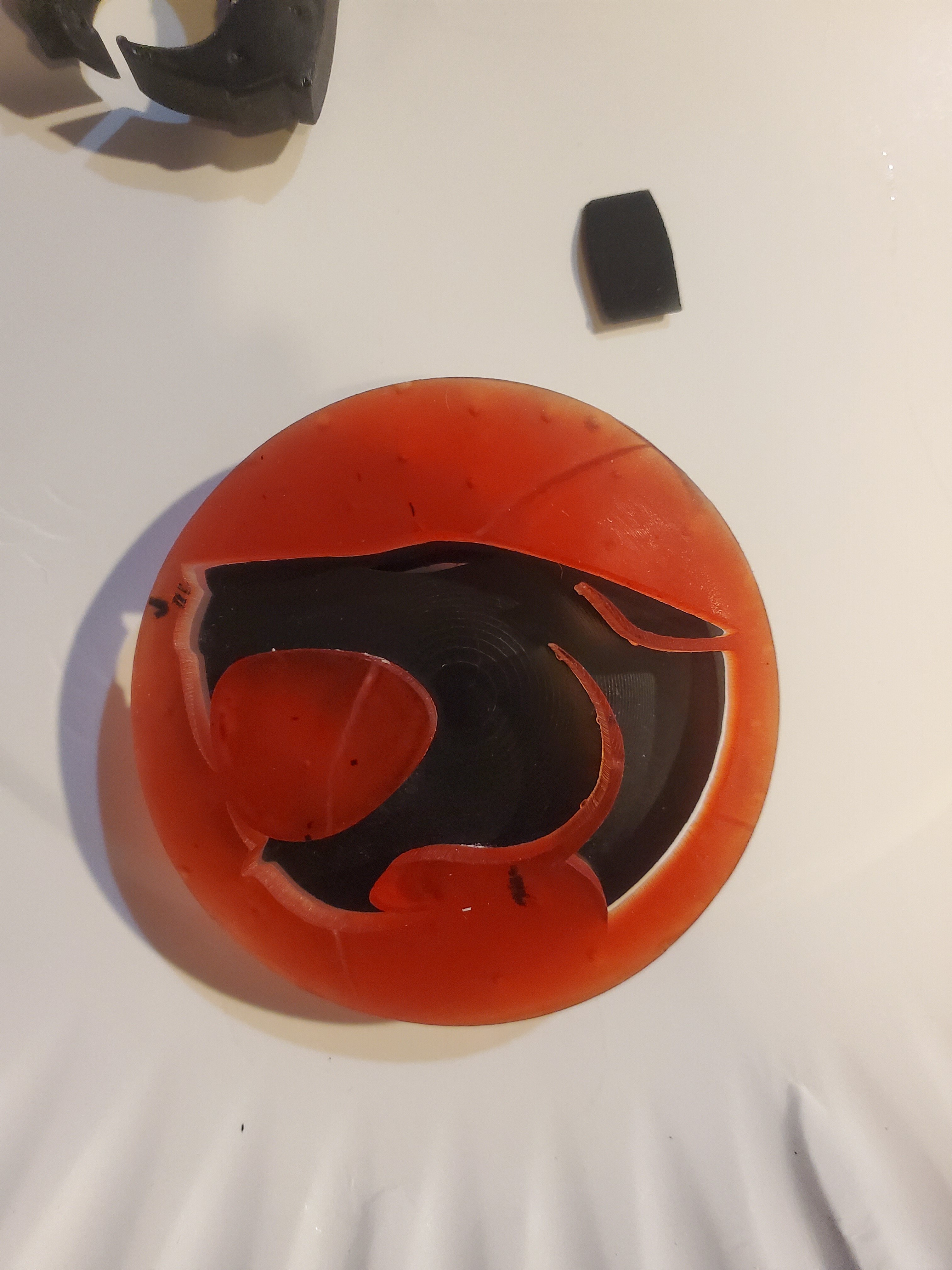

I 3d printed out some thundercats logos with my 3d printer using transparent red resin. They came out really nice. I picked a file where the actual cat on the logo was recessed, so all I had to do was slap some black paint inside. No masking required.

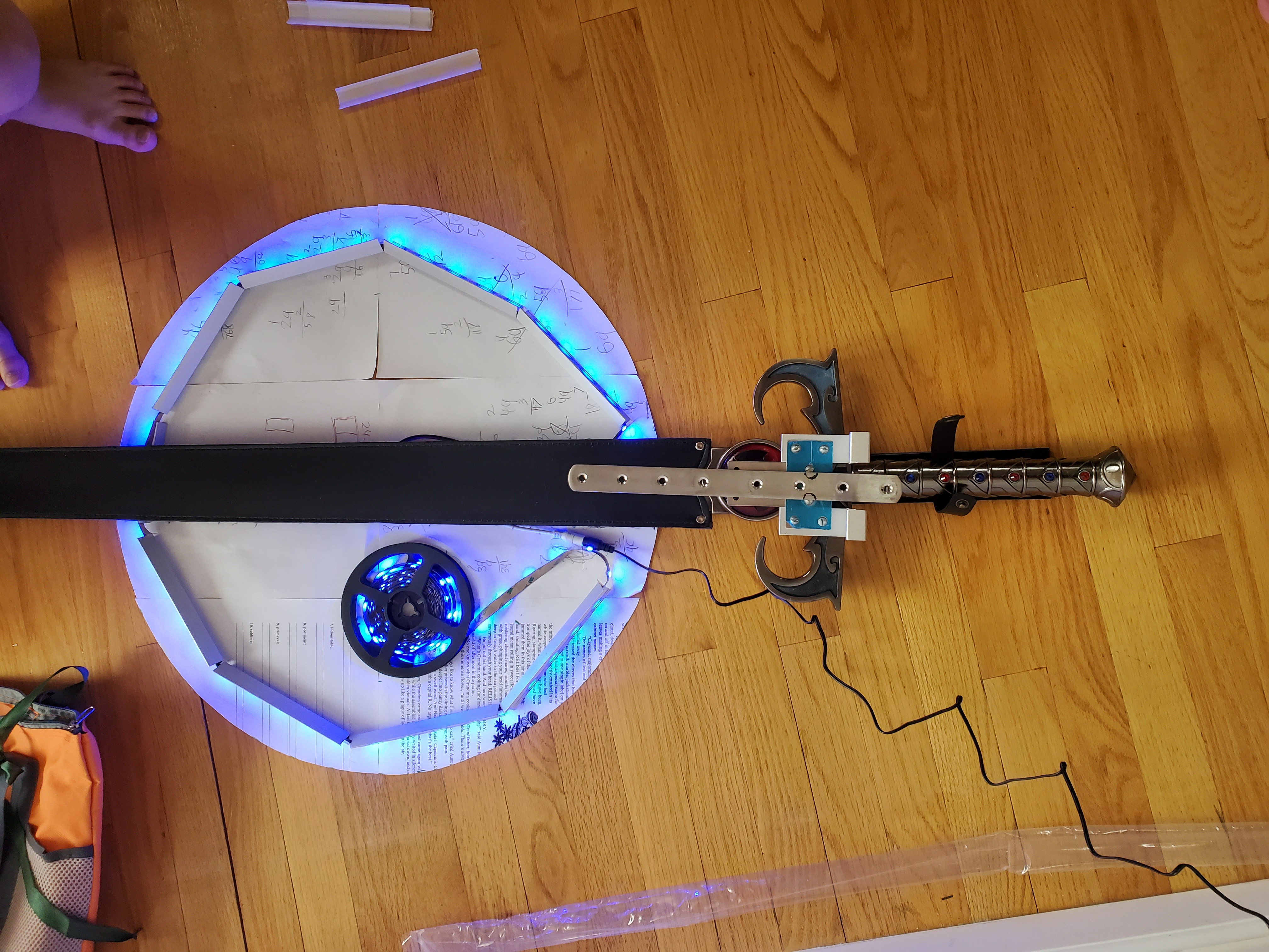

Finally, I needed a wall hanger/stand to display one of the few props that I've ever altered myself...
So I had my kids help me cut out a template, and we sat there trying to figure out how to wire some LED strip lights.
I made a makeshift sword holder out of random parts I had in my basement, metal bars, metal coat hangers... and like an erector set, put it all together.

The cord running down the back is the cord for the LED lights of the emblem. The LED lights inside behind the wall plaque, and the LEDs inside the sword are both remote controlled, so you can do all sorts of lighting effects with them...

The 3d printed eye of Thundera was printed a few times to get it "just right." so it fit snugly into the hole. If you look at the pictures closely there is a very small lip that can actually hold the emblem just by pressure fitting it. I put a very small piece of tape on the edge of the eye to give me something to hold onto to pull it out. A small suction cup could also be used to remove the eye, but the fit is so exact that my kids swing the sword around and the emblem doesn't fall out.
