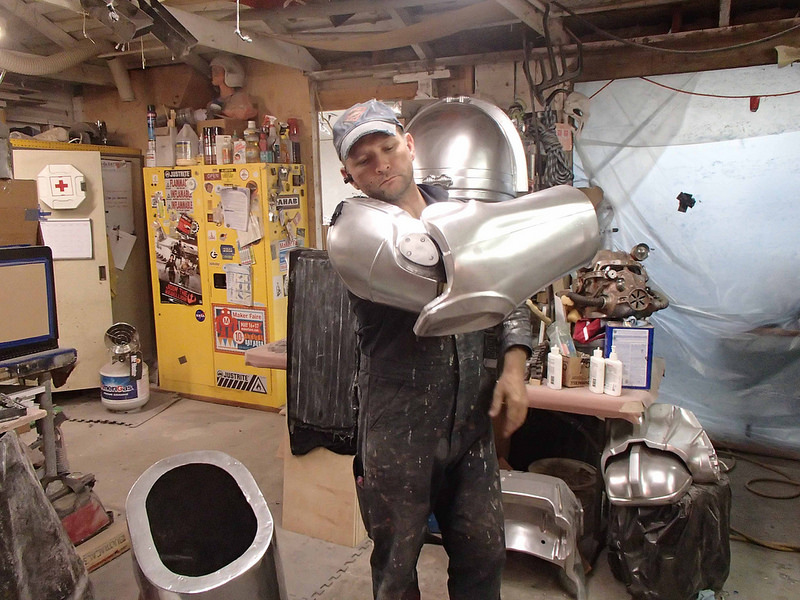

Then we spent some quality time goofing around with the armor:

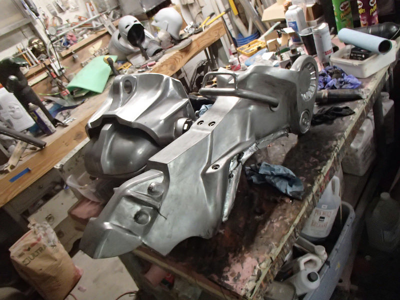

That done, the whole thing was given a coat of primer and then sprayed with it's base silver color:
The only other bit of progress was the installation of the recessed bolt details on the shins:

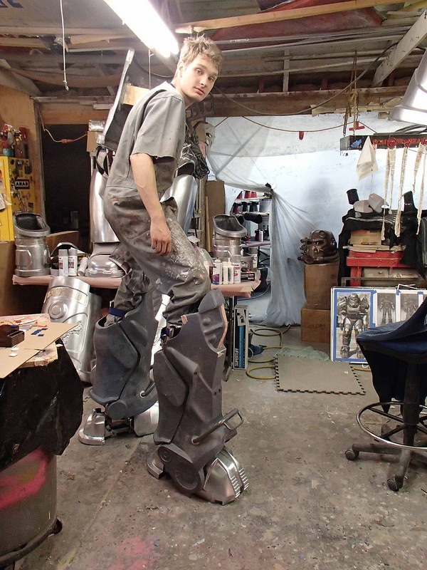

So here's the latest update on this project...

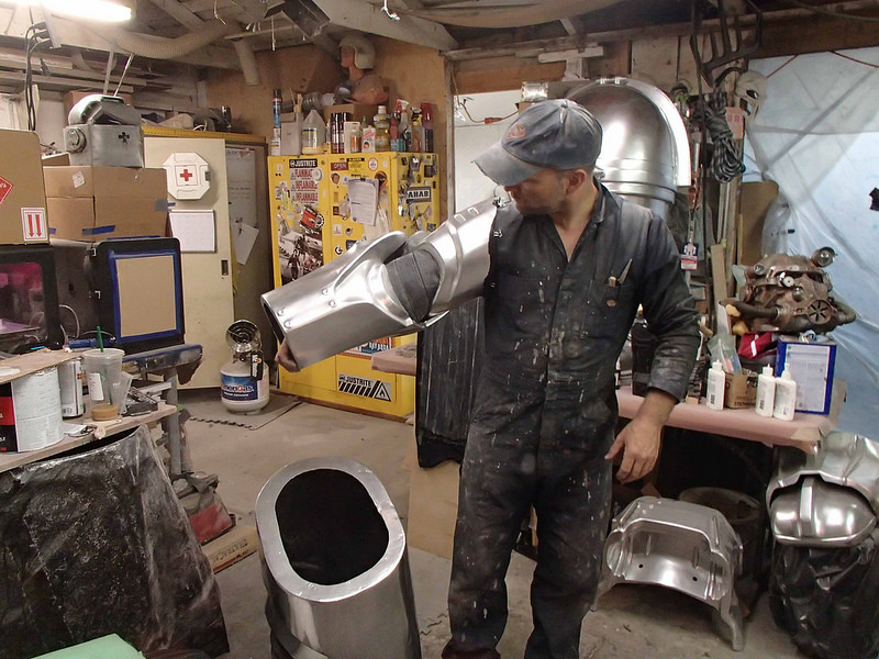

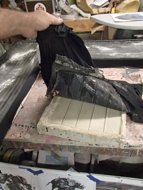

The rubber parts for the joints came out alright. Here's an elbow being de-molded:
And this is a knee hanging to dry a bit more:

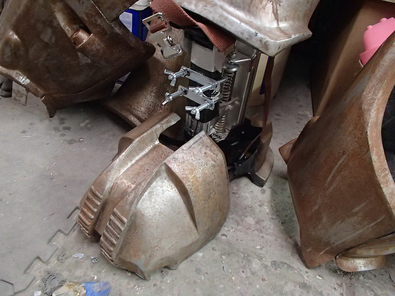

Here you can see me installing an elbow piece:
It fit pretty well:
Most importantly, it covered my skinny little nerd arms:
While still allowing for plenty of flexibility and motion:

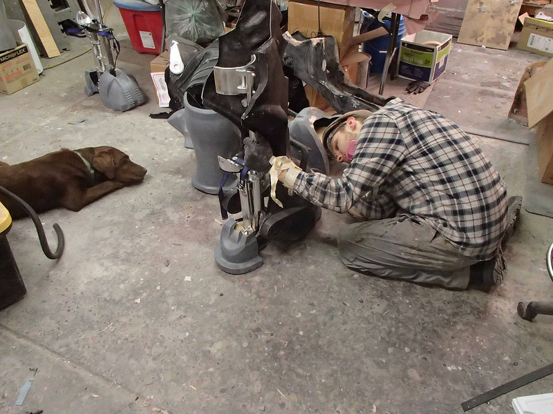

Freddy concentrated on rigging the foot parts onto the stilts:
Then bolting the shins onto the front of the stilts:
Here's an early test of the functionality with all of the lower leg parts in place:
Here's Freddy's suspender arrangement for the big rubber "thunderwear":

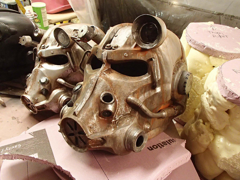

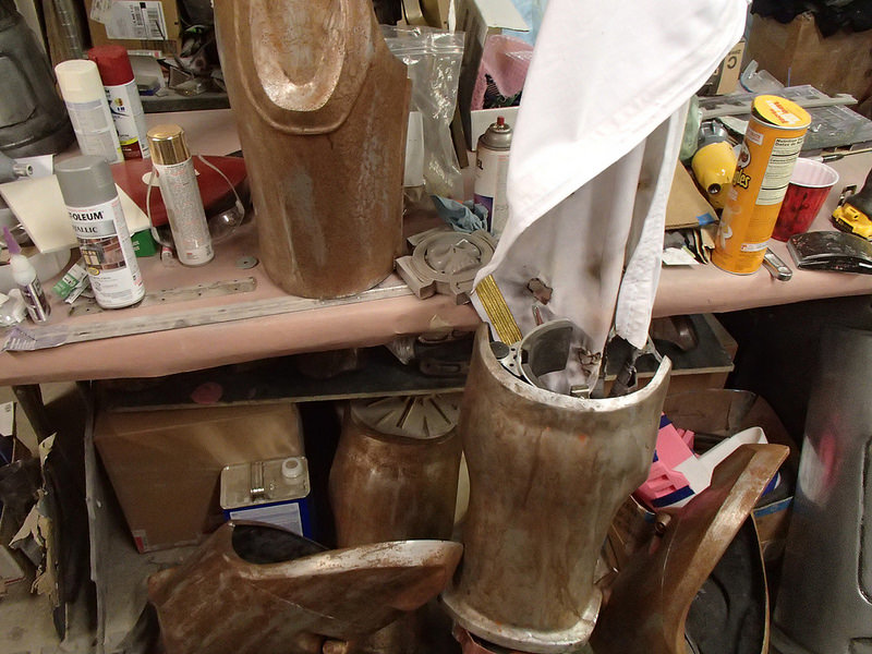

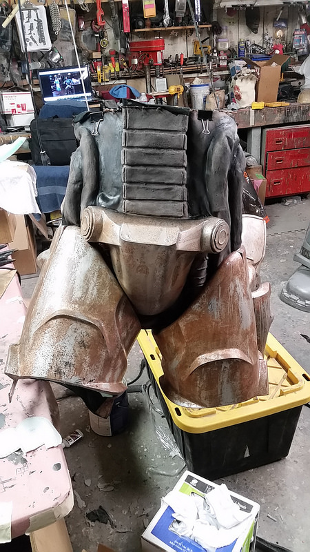

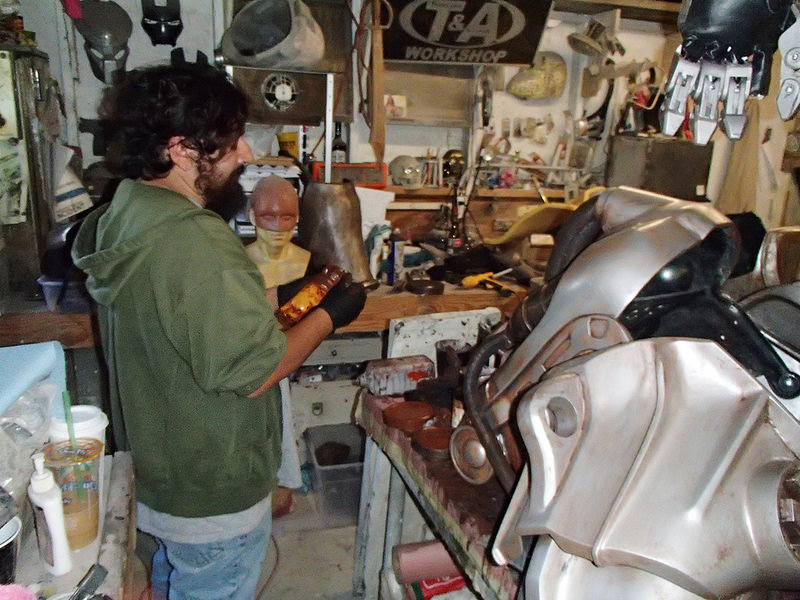

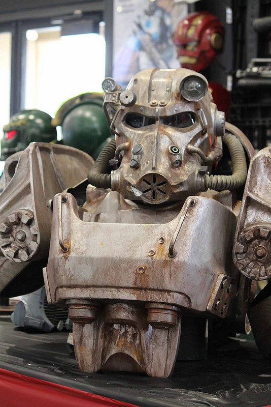

For painting, all of the parts were given a base coat of Dupli-Color Chrome, then heavily blackwashed to tone the shine down:
This was mostly handled by my friend Vinny:
He did pretty good:

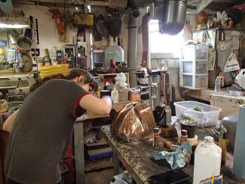

The next day, my friend Madison started the rust washes:
These were just rust-looking acrylic paints in colors like burnt sienna, raw umber, red oxide, and so on that were dribbled onto the surface without thinning, then slathered all over the part using a wet foam brush before being dabbed off with rag that was soaked in watered-down paint and rubbing alcohol. The effect was pretty convincing for surface rust:
At some point Vinny took over the rust washes:
He did pretty good:

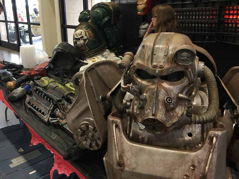

For the areas meant to look like heavier, scaly rust, the wet paint was dusted with cinnamon. That's what gets me this look:
Meanwhile, Freddy took his own set of parts from my molds and painted them in his shop. That was this one:
I still like my raw steel rusted look better:

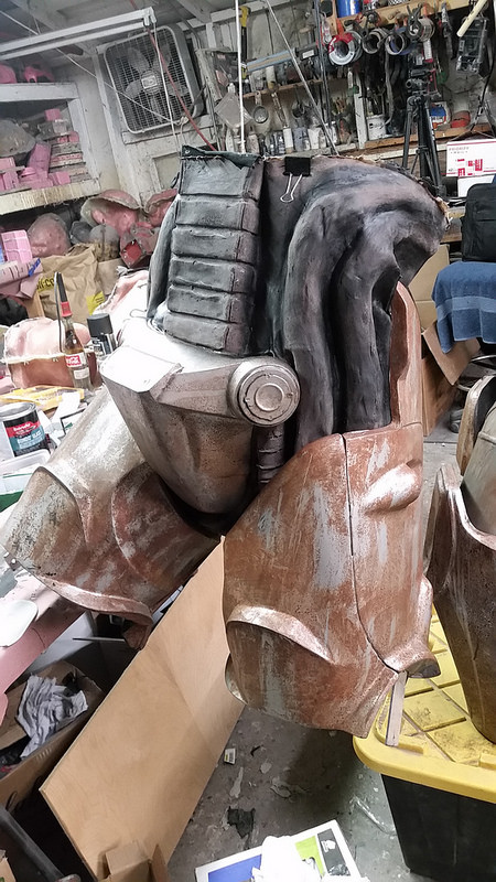

I still need to rig the hands so they can move and rearrange the knee joints so they'll stay aligned when I'm walking around, but that didn't stop me from strapping on the whole suit out at the abandoned Mare Island Naval Shipyard in Vallejo, CA for a rushed photoshoot:
There's still a few other ergonomic issues to work out:
But preliminary cellphone snapshots look okay:
And we had a lot of fun doing it:
