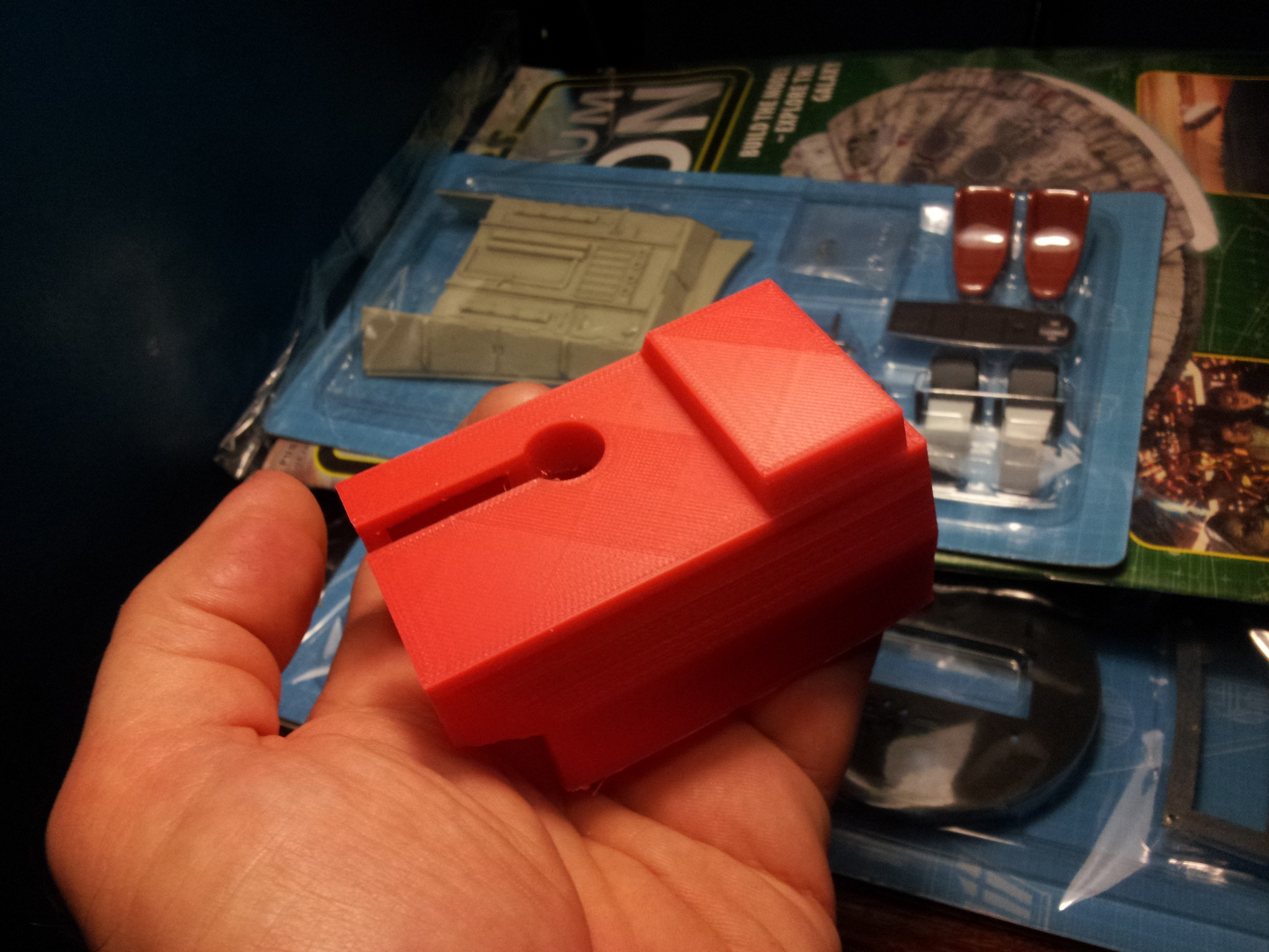

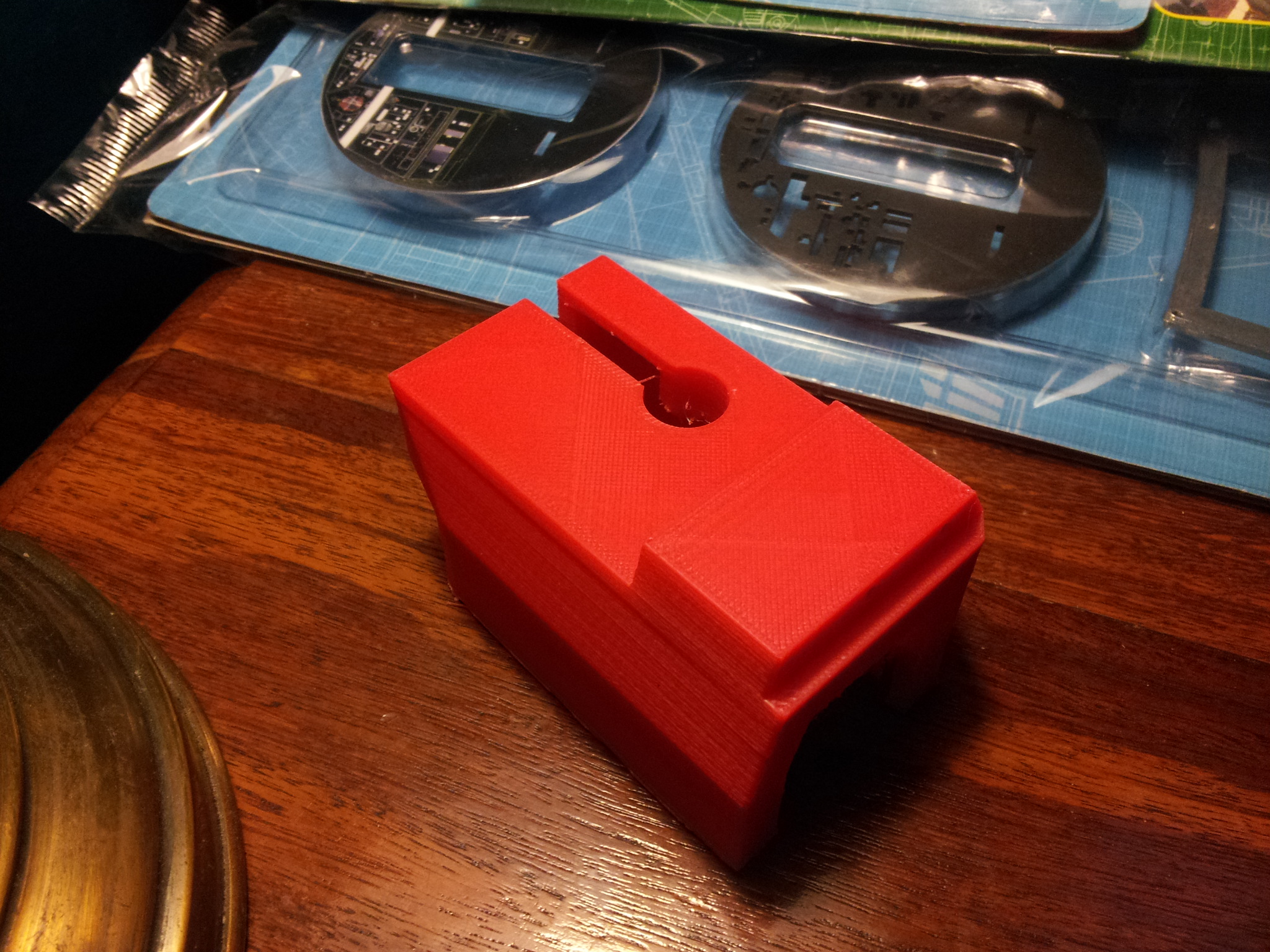

This is the first sizeable part I've ever been able to get done in ABS - had endless problems with warping and adhesion and hot end jamming, so I've gone for PLA for everything - obviously no good for the mounting parts for this project, so this was some incentive to sort my M2 out at last. It worked! I'll slow print speed next time and go for 'grid' support as the one small imperfection arose from weak support material. But other than that, pretty close to perfect. Thanks again for this amazing project!
