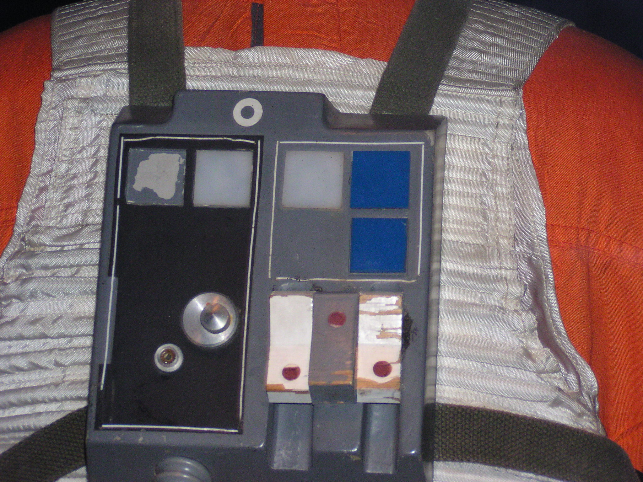

Vest:
(looks bad in pics, cause it was packed away and the loops got squished)
I made this with white canvas and white satiny material. I cut the vest front and back patterns out of the white canvas.
Then took the white satiny material (not cut- and oversized) and sewed it to the top edge of canvas vest pattern.
I took a round metal rod (thin) and inserted that between the 2 peices of materials.
After over lapping the rod (creating a loop) I used strips of "hem tape" between the 2 peices of material, and ironed it down in place. Repeat this process by pulling out the rod and creating each loop. Use pictures to go by, and make the loops at the top- leave gap, and go on with more loops. After that, I trimmed down the stain material to match the Canvas pattern below. Once you have the look you want with the hem tape holding it in place, proceed to sew together under each "loop".
I added a canvas belt material to the back side with a "d" ring buckle, and a metal push shape to the sides. (got these from the thrift store..on an old camera bag).
Once that was all done, I just added white ribbed "stretch" material for the shoulder pieces to connect the front and back.

Don't think I did anything else.. My box was a Richie Chest box.
