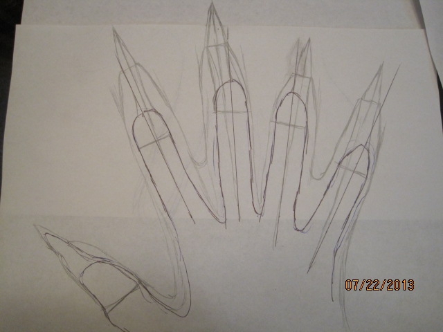

Thanks guys. Hey George if you look at the first drawing above you will see that I am going to do exactly as you explained. I will make the extension of the nail from the cup to the nail hour glass shape to help it to stay in place in the silicone. Maybe I should make it opposite and have it bulbous as the resin may be liter than the silicone would be. Any thoughts on that George?
I think you'll be fine with the hour glass idea. If there are any issues with the extension holding in the silicone .. After cure and paint.. Smear some GE silicone 1 around the edges of the cup and finger, inside the glove for extra support .. It'll also keep the cup in place and help prevent it slipping off the finger tip when the sweat builds up

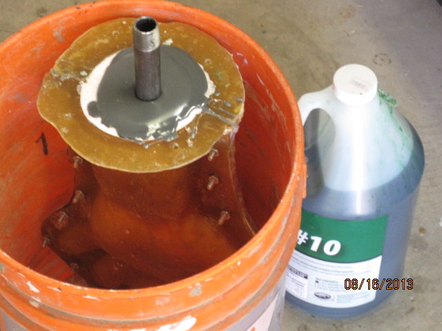

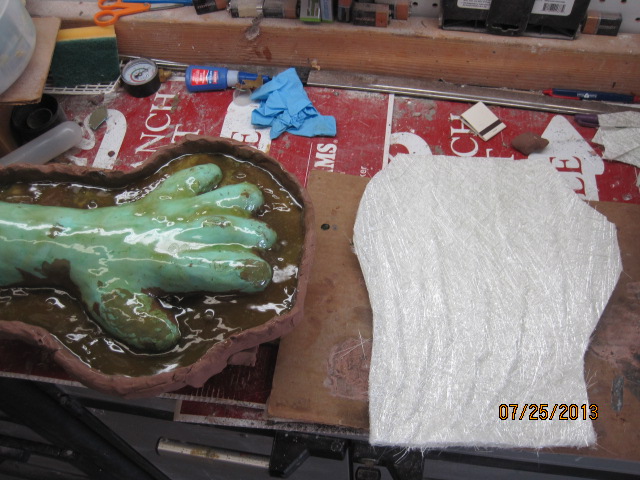

So I woke up bright and early and removed the clay so I could set this back up for the other half.

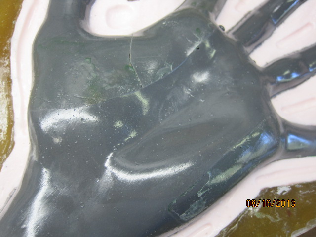

The gel coat.
two coats of glass on the hand and 3 on the flange
These next pics show how well the PVA releases. You can see the film just lifts off.
This is the mother after just peeling off the PVA. That is no other cleaning. I love this stuff.

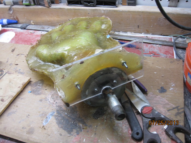

In case anyone was wondering the clear plate screwed to the bottom of the hand is so that later when the clay is removed from around
the hand I can secure the mother mold while I pour the silicone.
And it's ready for PVA and the fiberglass. I'm heading out there right now. It'll be around 100 today so the job should go quick.

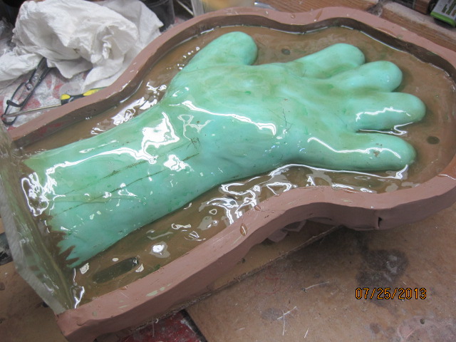

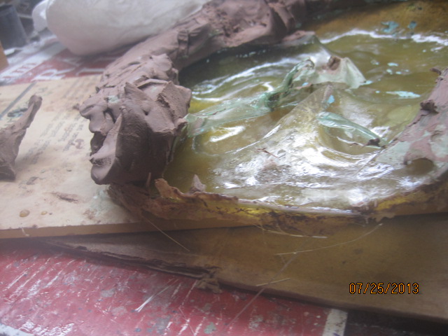

Had a good day yesterday. Got the second half glassed and preped for silicone. I got up this morning and poured the first side.   I tried something a little different when glassing. Since I am using the matte and not the woven cloth I decided to try laying on one whole piece. I presoaked it in a cookie sheet lined with tin foil. I just dumped the cup of resin on and spead it around and waited a couple of minutes. It worked great. I just picked it up and it nearly fell into place. The woven cloth would never move into place like that.

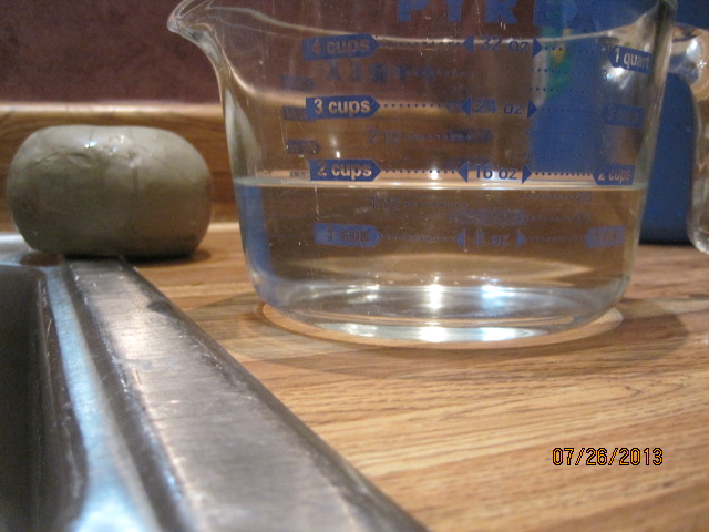

  This is the clay that came from the jacket around the hand. This is one of the reasons I used 2 different colors the brown for the wall and the grey for the jacket.. This is the amount by volume of silicone I will need to fill the cavity around the hand.
Here I placed the ball of clay in my measuring cup making sure it was smashed down below the 4 cup mark then I filled the cup up
to the 4 cup line. I retrieved the clay with a knife and the difference in the levels is the volume of the clay hence the volume of silicone needed. It ended up being around 2 and 1/4 cups so I rounded up to 2.5.
Here the mold is bolted back together ready for the silicone looking into the cavity. This was so much easier
than the way I did the other hand.
I actually used hot glue on the edges as I know silicone likes to escape from places.
This is my cluttered work space.
If you look closely at the tips of the fingers you can see silicone leaching through small holes that were drilled in
the fiberglass. This allows you to know the silicone made it down there and allows air to scape to make sure the silicone gets
down there. That is super sculpey glogging the holes once silicone came out.

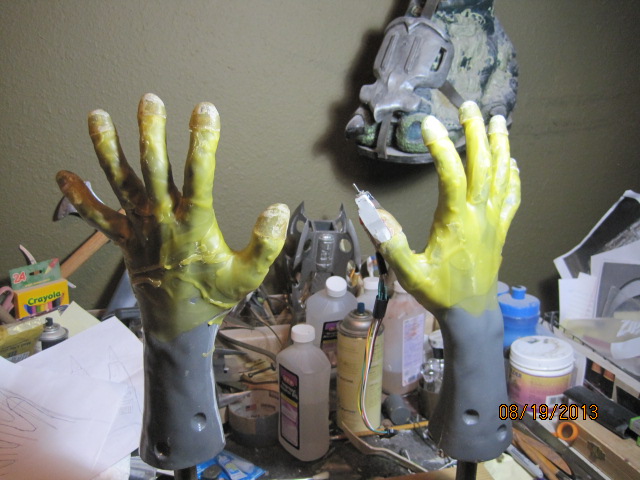

Ok I have some updates. Nothing thrilling yet. Soon I will start putting clay on the hands and finishing the sculpt on the thighs. So here is what I have .
This is the left hand opened up after the first side of silicone was poured.
Then it was on to the next half.
I thought it looked cool to see the hand in there.
I decided to go ahead and pour the none collapsible left one first so I could do some work, hopefully sculpting, while
I monkey with the collapsible aspect.

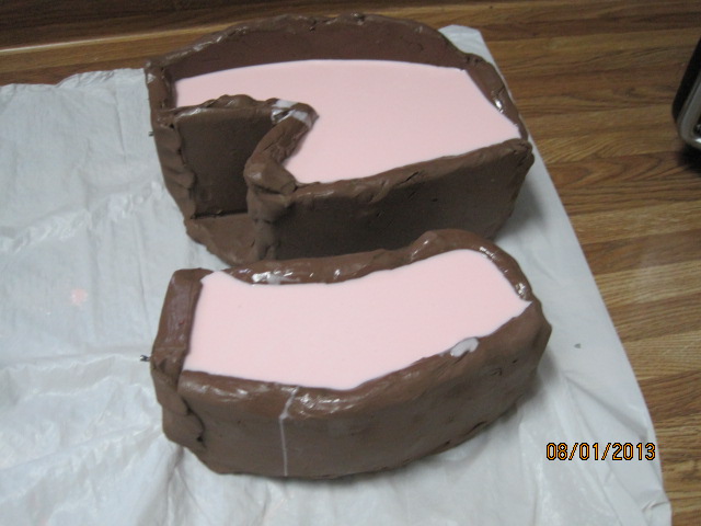

Got the parts cut off and keys built.
Decided to stick with clay for building the block molds. It really is easier. I use nails pushed threw the clay walls
and into excepting holes to suspend the pieces.

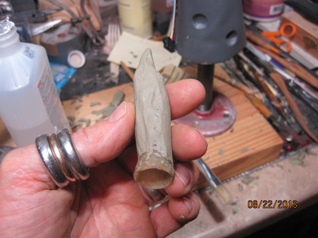

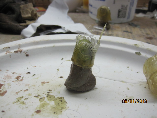

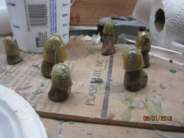

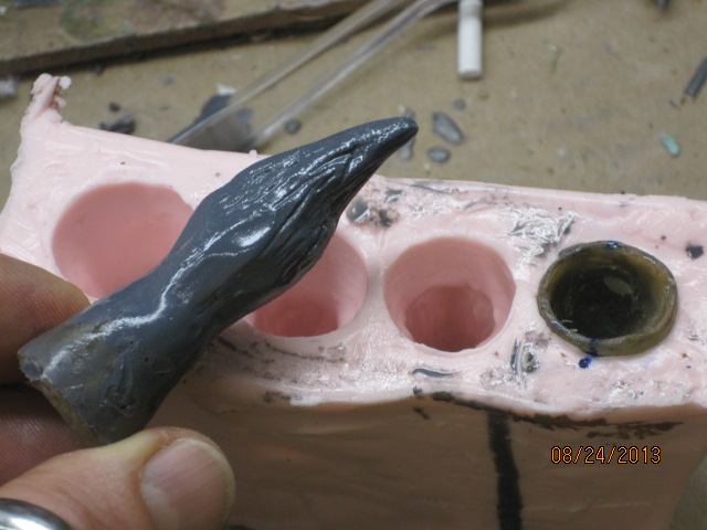

Here are the finger cups. Initially I made them out of resin with no fiberglass. I decided they were a little brittle after one fell
on the floor and cracked. I fiberglassed the lower half of each one. Now maybe I can do something that people will be interested in.
I know this is all sort of boring prep stuff.
Ready to have some extensions and fingernails sculpted to them. They aren't as thick as they appear

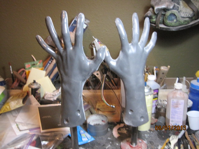

I know it's been a bit since I've posted, sometimes work around the house just has to be done. Here are the final shots of the hands project.

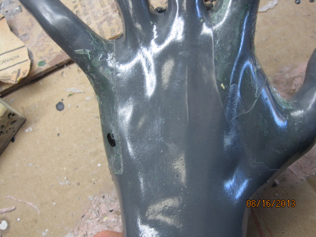

This is just like the other one except I used a drop of superglue to keep the edges of the seperate pieces held tight to the silicone for the final hand pour.
These 2 photos were taken directly out of the mold. You can see how tight the seems are. The glue help to keep no overflow
 onto the already made parts. Unfortunately when I pull them apart the very fine edge gets a light sanding so they don't look as tight
when all said and done.

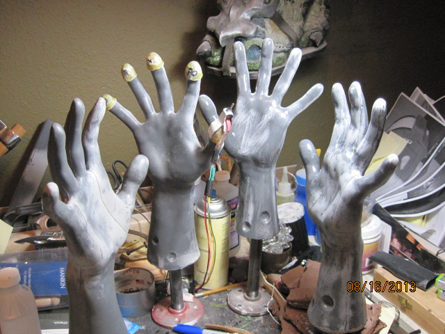

Both hands finally done.
All 4 hands. The none collapsible are for sculpting on and the collapsible are for using as plugs in the pouring
process.

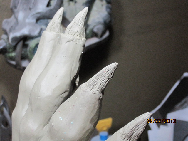

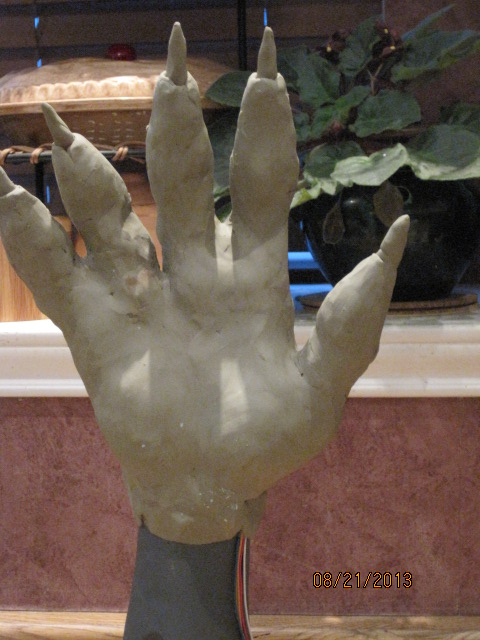

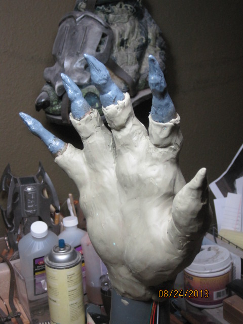

I got some clay on one of the hands just to see if my idea was workable and looked ok. I will be shaving it down a bit but I want strong hands and a bit gnarly to match the feet.

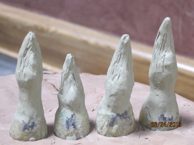

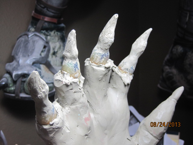

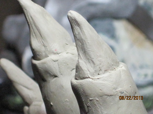

Thanks George. How is the screamin little one? Here's what I decided to do on the finger nails/cups.
roughed in nails.
 the final look of the nails.
I know this seems a little crazy but now I have to carve away the clay from around the nails so I can cast them in resin then put them
back on and finish the sculpt.
You will notice how off center it is. If you look back at my sketch of the hand I did this on purpose to bring those
2 fingers closer together. I know it sounds weird but I think it will work.
The other hand will be a little easier as I will skip this sculpting/carving down step and just sculpt the nails separately
by copying the look of the other hand with the cups in place before the clay is added. Does that make sense?

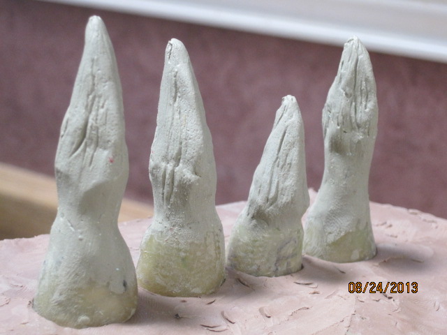

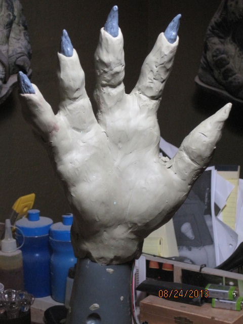

Alright after careful consideration and a word from ptgreek I decided to tone down not only the length of the fingers but also the diameter.

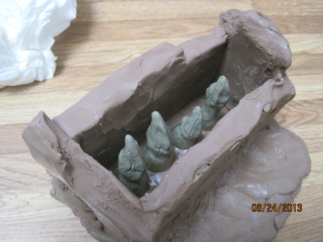

Here are some progress shots of the finger cups. These are the shorter versions. The fingers are still thick.

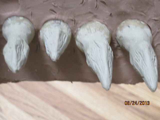

Here are the cups ready for molding,
I colored the resin black, which ended up grey which is better than white. I poured the resin in the mold then just
pushed the cups back in on top of it.

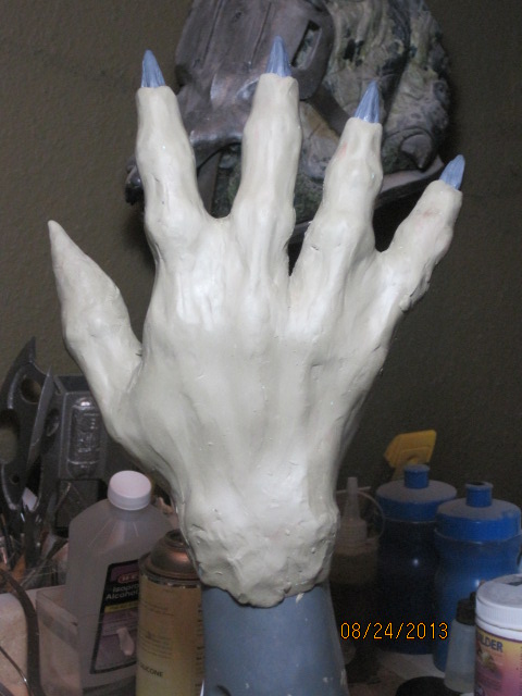

Here I am starting to shave down the fingers and find the look I like.
This is pretty close to the basic shape I'm going with, well unless I decide on something else.
