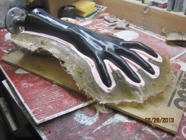

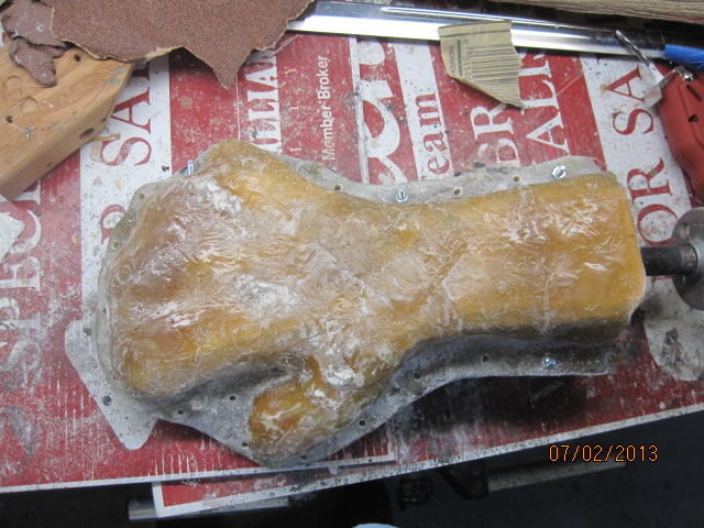

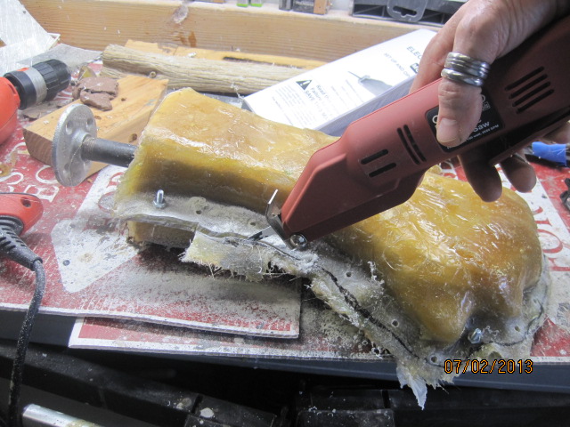

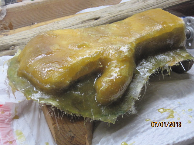

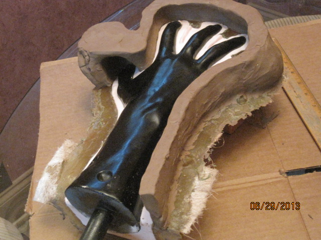

Got the second half fiberglassed yesterday. It looks hind of crazy. The first to pics are of the PVA mold release. I hope to trim this and drill the holes today. The next hand will be done differently. Probably more how it should have been done. I will put a nice 1/2 inch layer of clay around the hand then make the 2 piece fiberglass mother mold, then clean out the clay, put it all back together and pour in the silicone. I thought I was being smart, I was not.
The right hand mold is finished. Everything went great. The PVA works awesomely. The mold halves practically fell apart. Now I need to start on cutting the
thumb and pointer off and building some keys on them. I will need to remold those too. Oh crap then I need to start on the other hand.

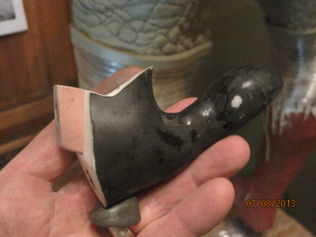

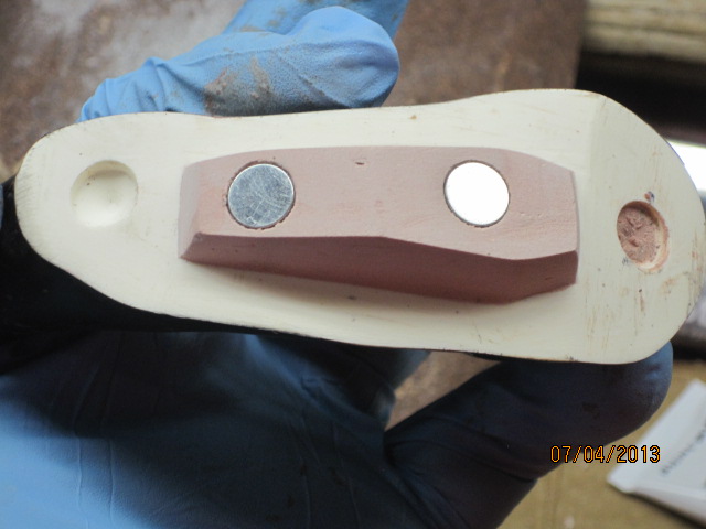

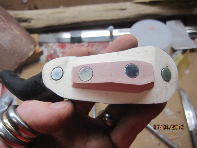

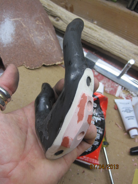

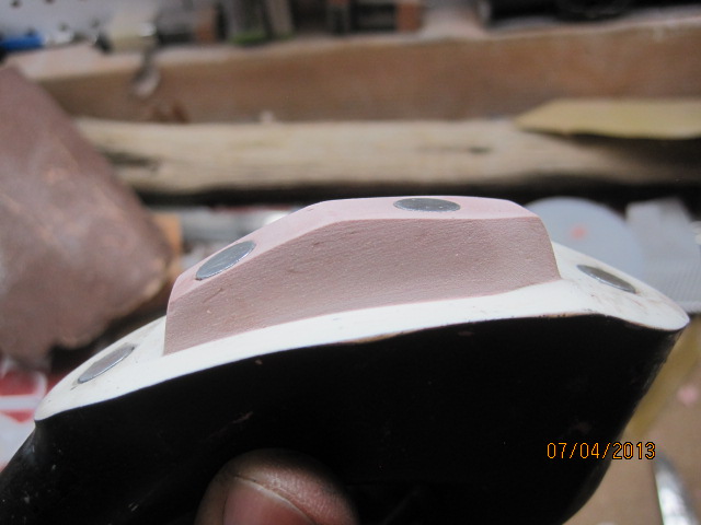

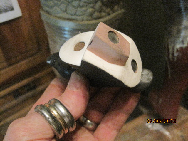

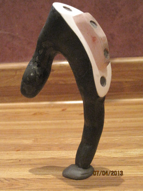

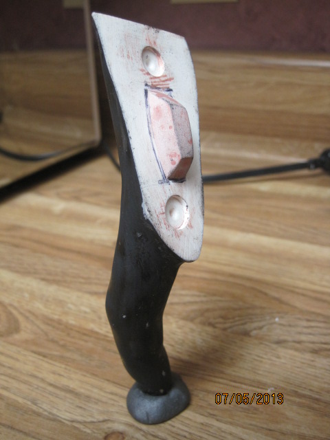

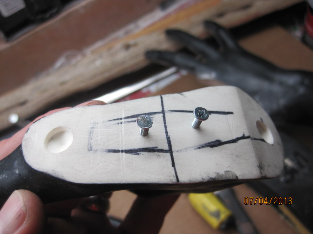

Thanks Steve. Well the thumb is ready to be molded. Here's what I did today.
First I cut it apart.
Then I marked where the key would be and placed a couple of screws to help hold the bondo in place.

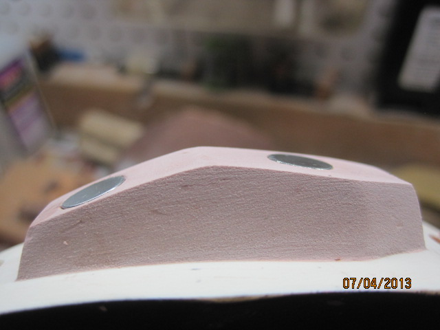

I also drilled the holes for the first 2 magnets.
Shaped and sanded with the other 2 magnets in place.
I did a little spot puttying to finish it up.
Ready to mold.

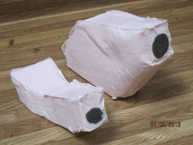

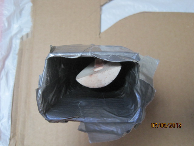

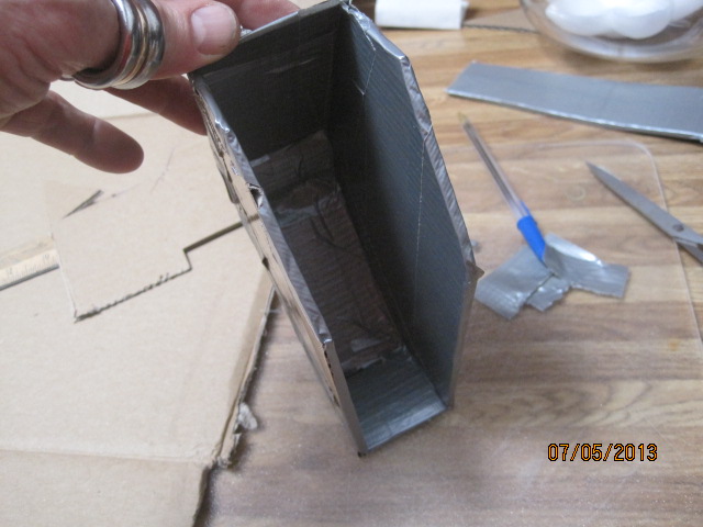

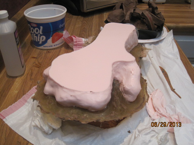

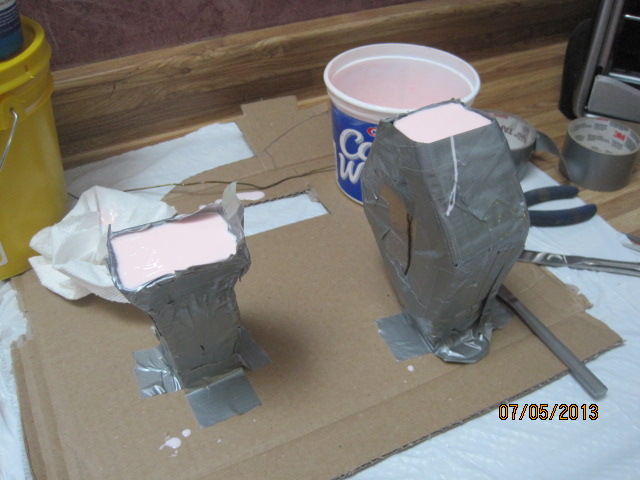

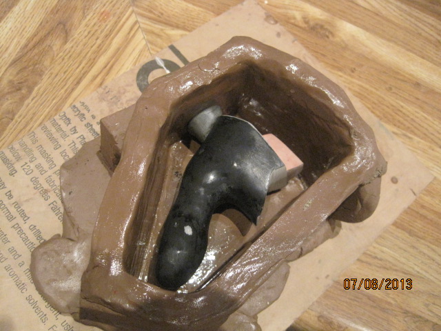

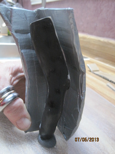

Here are a few photos of what I got done yesterday. I'm a little embarrassed as to the quality of the 2 molds. I just wanted a couple of block molds. They look crappy but they will work. I now have one more mold to make. I still have to cut of the pointer from the thumb then mold just the thumb. I know it sounds like a lot of molding. Once done I will cast the thumb then then place the magnets and release and place it in the thumb/pointer mold and cast that so I will have the 2 piece fitting perfectly. Then I will cast the pinky. Then I will place the magnets and release on all the pieces and place them in the hand mold and finally cast the whole hand. That's my story and I'm sticking to it. So here are the photos.
If you look close at the bigger
mold you will see a piece of wire taped to the side. I forgot why I should have used
foam board not cardboard. The cardboard starts to bow from the weight of the silicone. Not to self "foamboard
not cardboard.

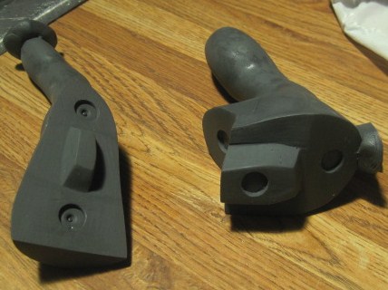

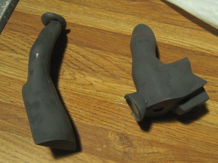

Here are the first pulls straight out of the molds. I'm hoping to cut the thumb off and get that molded today as well as maybe starting
the whole process over again on the left hand.

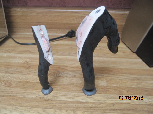

Here is the little finger and thumb pulls.
Here it is with the magnets in place. I actually screwed up a little as the
only magnet to be glued in should have been the one to the pointer finger.
It fit back into the mold ok. I was a little worried but it worked out.
And here it is after the pour of the pointer. Next I will release all of these and place them back into the hand
mold for the final pour. It's a heck of a nice fit.
