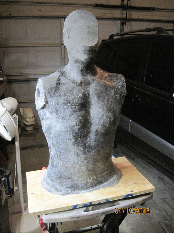

Hey everyone I have not quit. I did get the new plug made. I need to down load a couple of photos. In the mean time I decided to set that project down and regroup a bit so I decided to get at finishing my torso lifecast. Here it is. My wife helped me and it worked out well although it was sort of hilarious, at least my wife thought so.
Here I am with the plaster bandages on. I did the arms separate from the torso.
That "bonnet" is my bald cap. I didn't have one laying around and the beauty supply place was close and this is all they had. It's ok you can laugh. I decided to include my head for placement issues later.

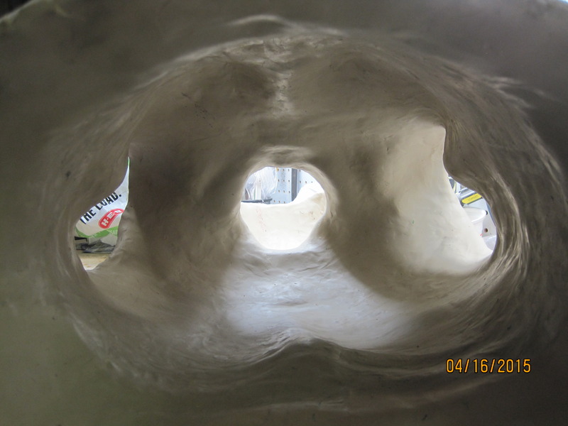

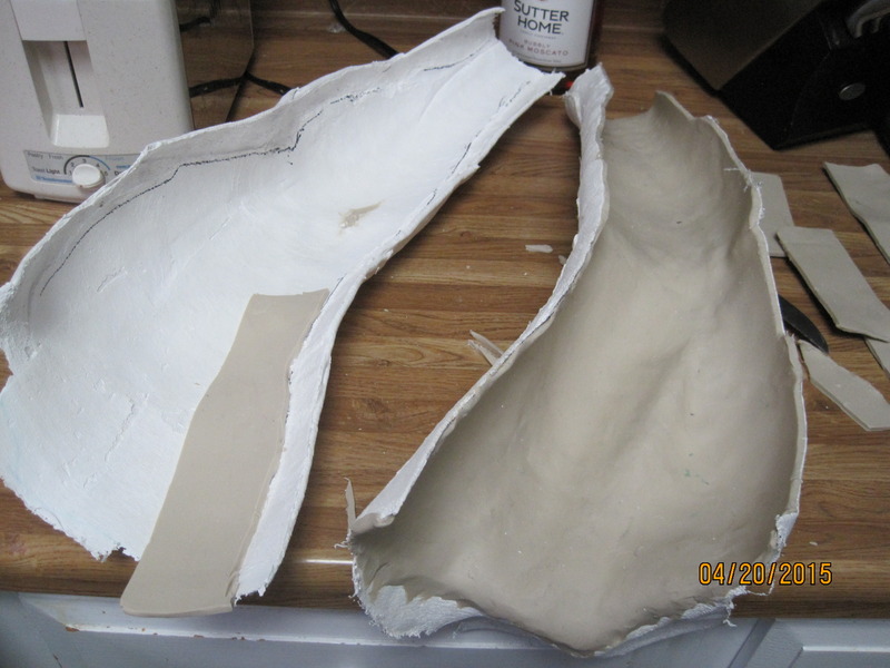

Once I had the cast off I layed in 1/8 inch of clay. I happened to see a Steve Wang video on suits where he mentioned shaving down lifecast so the suit would fit tighter. I figured he knew what he was talking about.

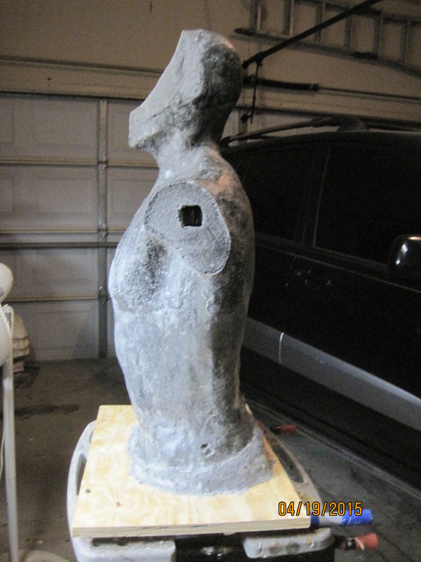

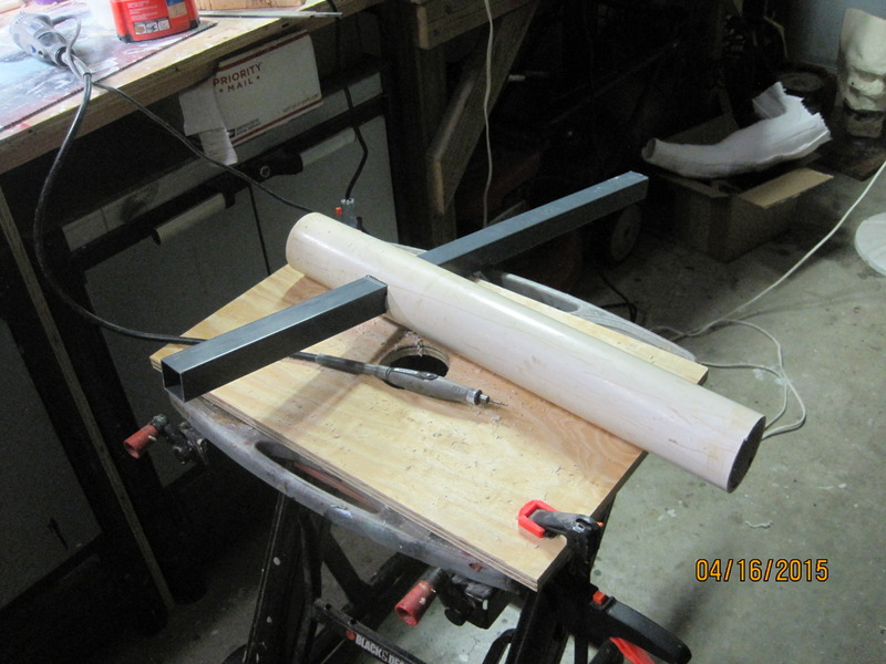

I had these materials laying around so I put them to good use. This is the inside structure to hold the arms and give the neck some strength.
These are after I poured in the rigid expanding foam and peeled off the plaster and clay.

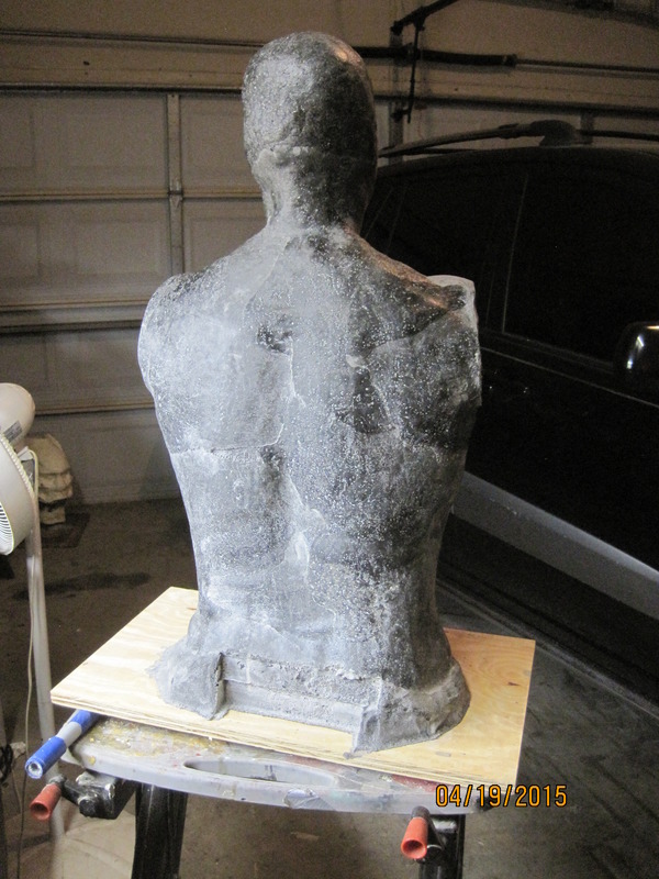

See the shim on the bottom. I fixed that later. (the last photo)
After a good cleaning.

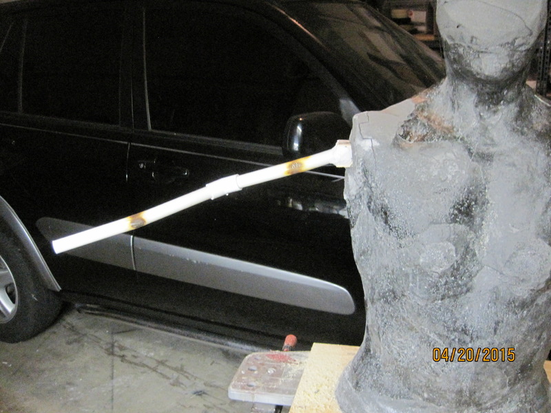

This is the structure for the arm.

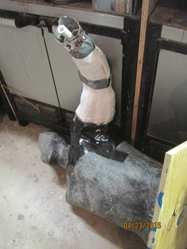

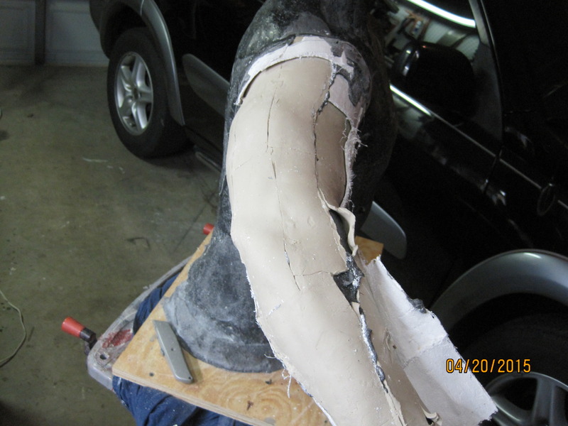

Here is part 2. Laying up the clay in the arm.
Peeling off the plaster and clay.
The finished arm.
Of course the other arm.

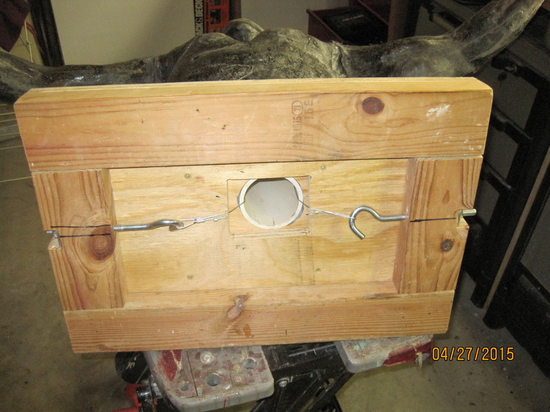

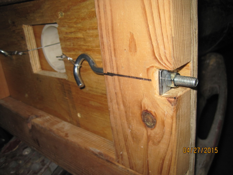

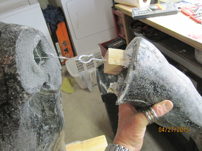

These next few photos are the mechanism I designed to hold the arms in place. They fit nice and snug but I figured when they start getting clay on them they could be under some tension. It's probably overkill but here it is.

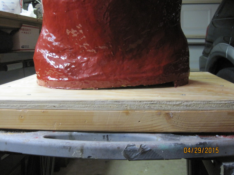

And finally the 2 coats of Epoxacoat to give it a nice shell.
I almost forgot, I mentioned this in the previous post. I did not get the torso pour plum on the base so I eventually cut it off and shimmed it to a new base. I knew later when I was sculpting in symmetry the off angle would screw me up.
