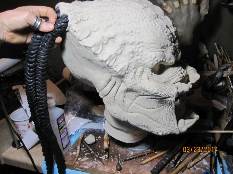

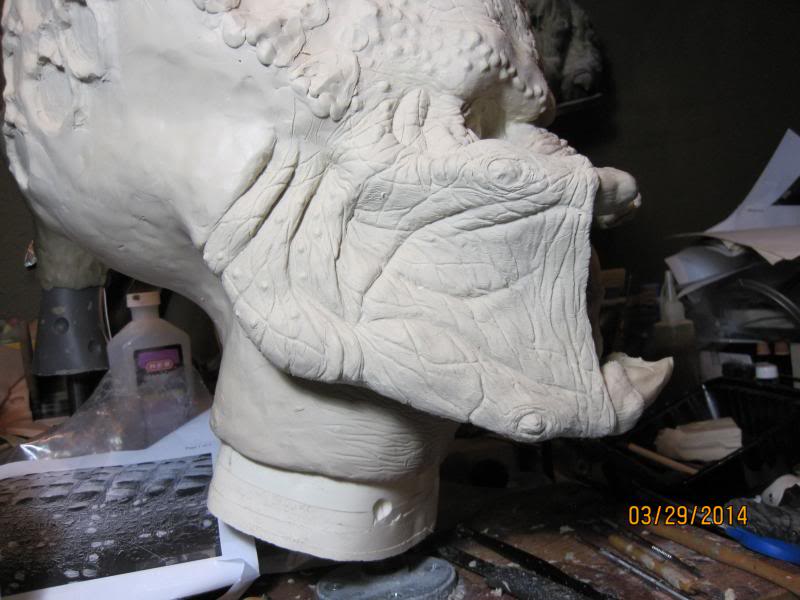

Hey everyone thanks for checkin in on this thread. I got a little time in on it today. I started on these scales around the dread lock
eruptions.

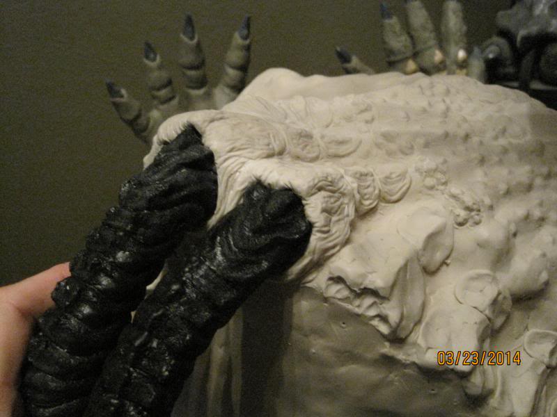

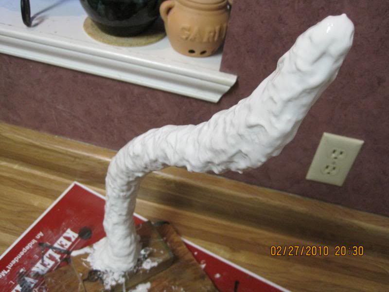

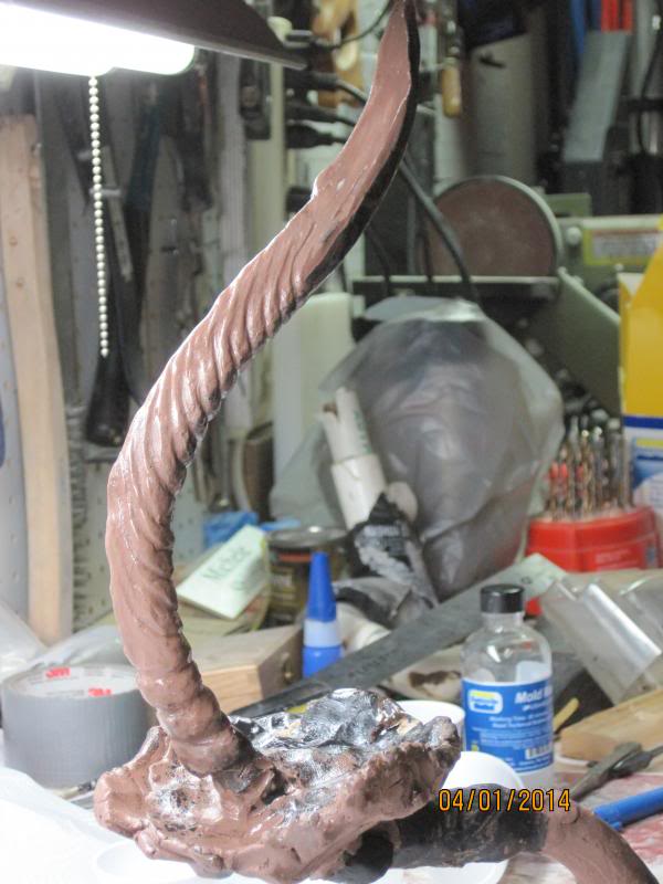

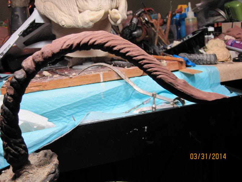

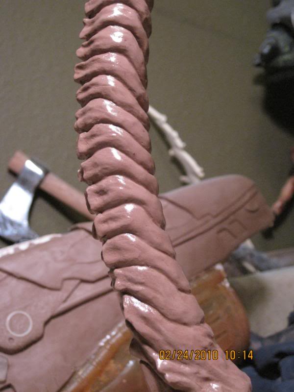

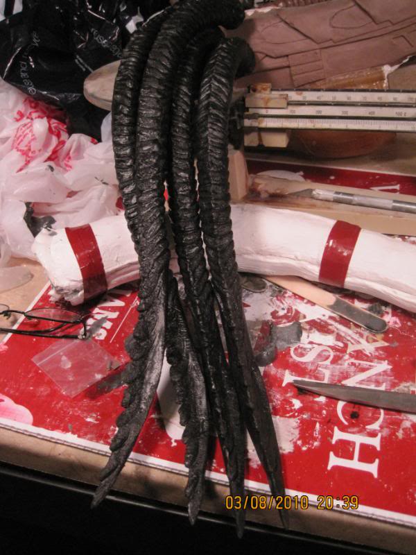

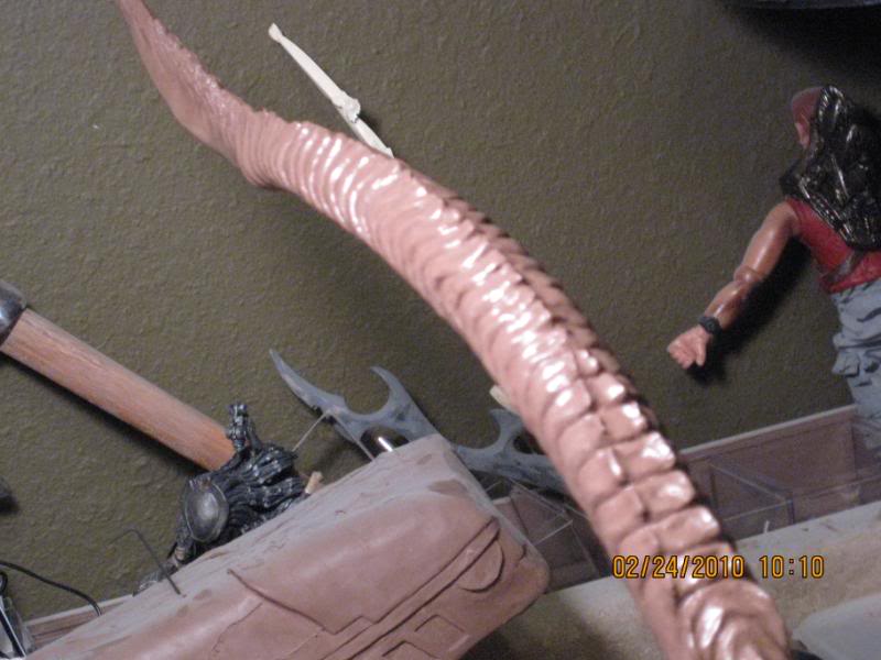

Still trying to get all of the Topknot stuff here. This is the sculpted dreads build. Some of you have seen these some haven't.
Sculpted on a heavy wire.
I wanted to make them more like some type of gills and less like some type of hair.

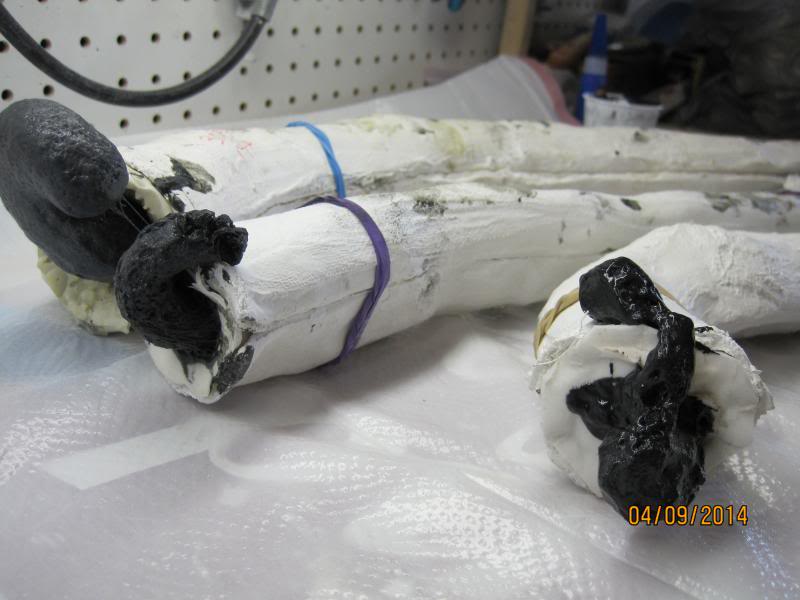

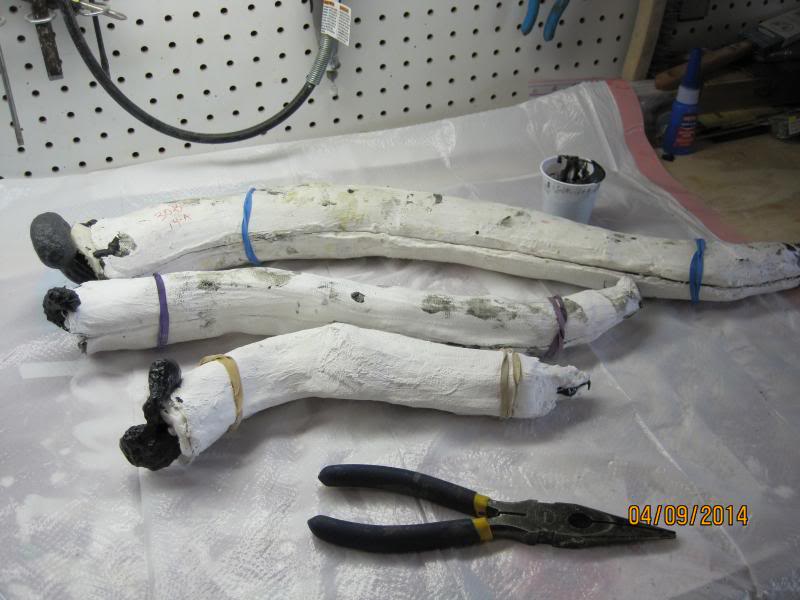

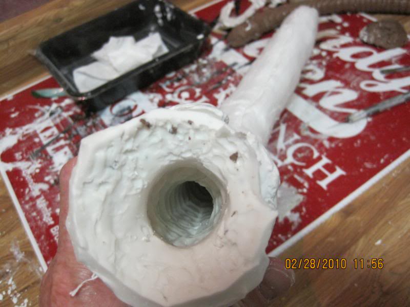

Here is the molding process. Brushed on several coats of silicone then plaster mother mold.
With the silicone mold there is only one split and it is on the underside so there are virtually no seams.

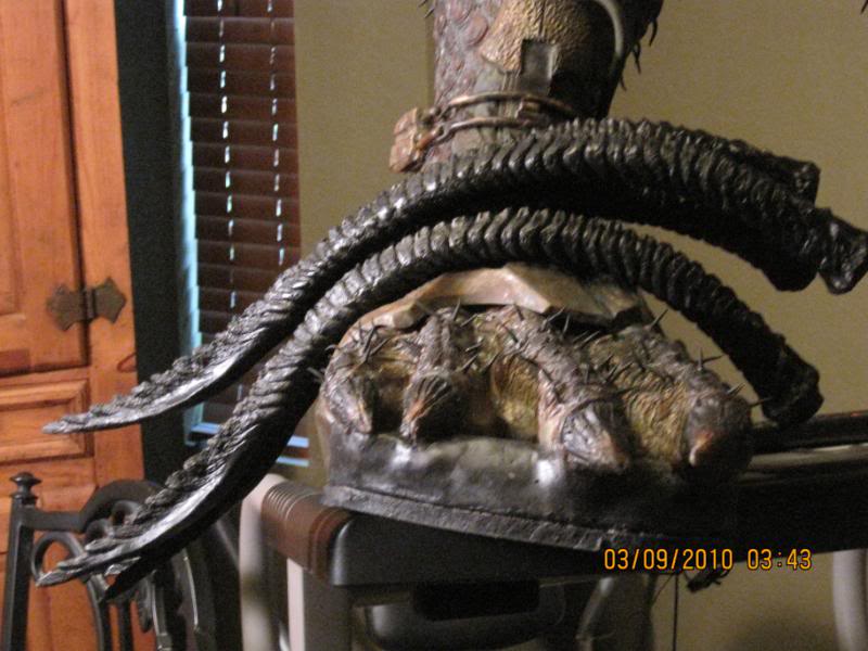

I colored the TC265 so if the paint wears a bit it won't be as noticable.
Here they are sprayed with black Plasti-Dip.

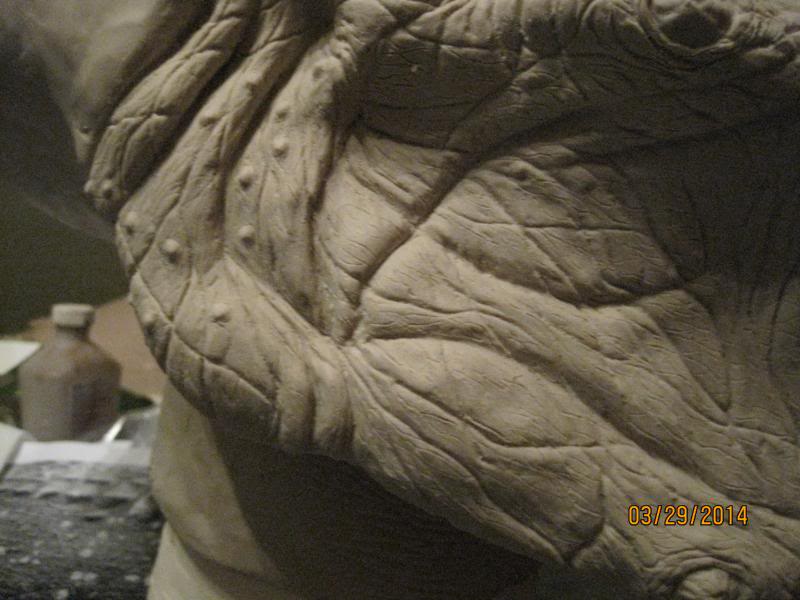

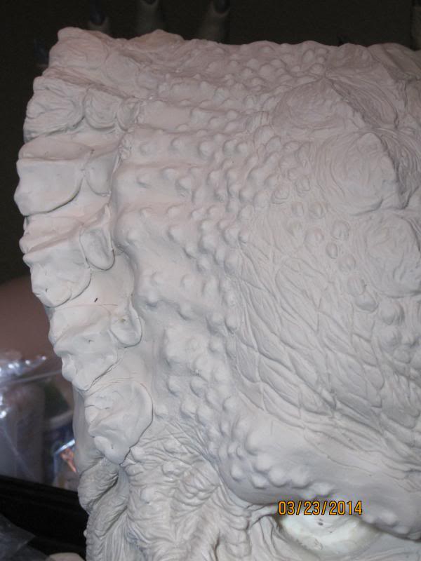

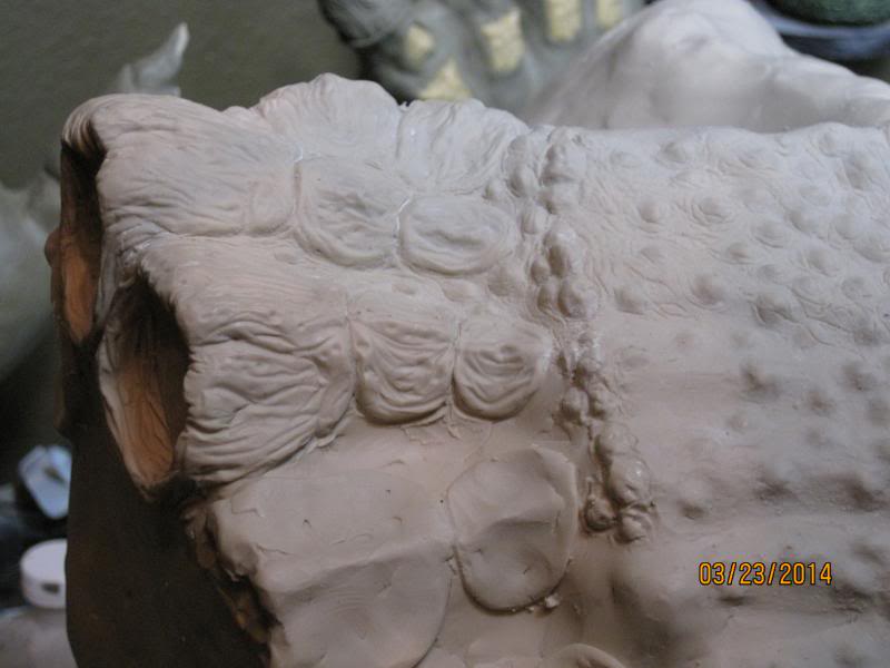

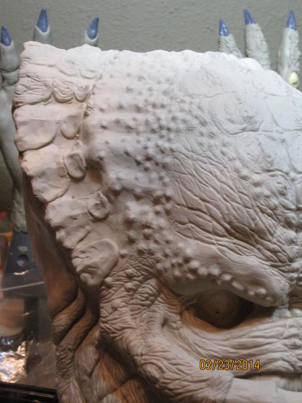

So I didn't like something about the cheek area. I spent a couple hours redoing it. It's not quite there but it is getting closer.
Old cheek,
New cheek.
Also placed some more of the dread lock eruptions. Borriinngg.

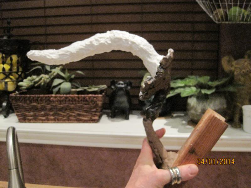

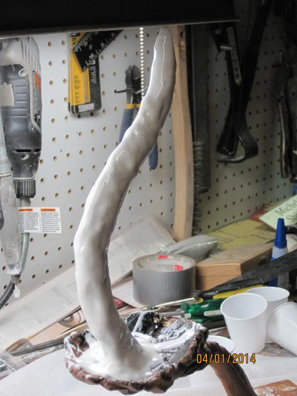

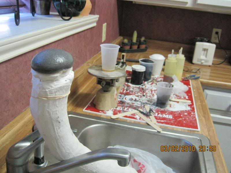

I managed to sculpt and mold the topknot dread today.
First coat of silicone.
Second and last thick coat of silicone. You can kind of see how it will sit on the head.

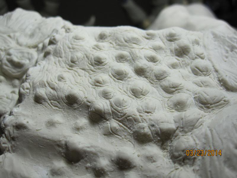

I also did some of the final final detailing of the skin of the cheek. This is what I'm going with.
I like the new version of the cheek area. It is only a slight difference but the "bumps" or thorns - whatever you want to call dem - looks alot better now gathered in one area instead of the whole cheek. Very nice detailing also.

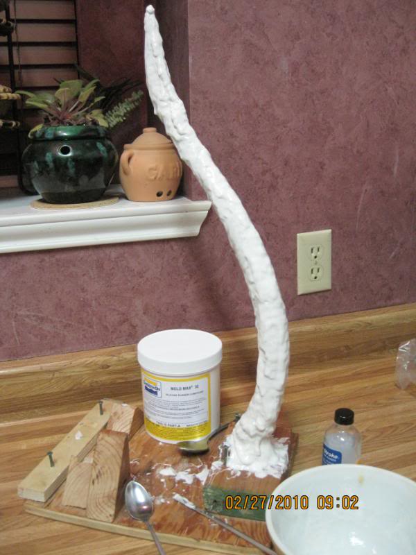

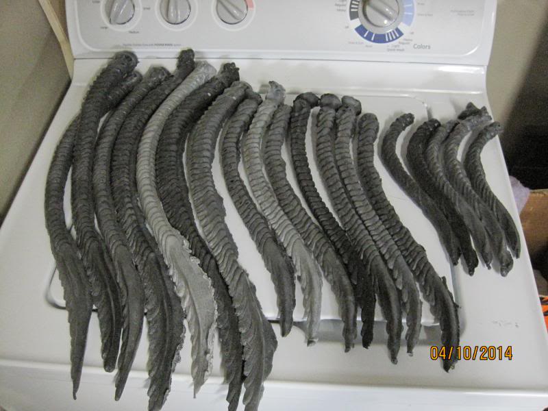

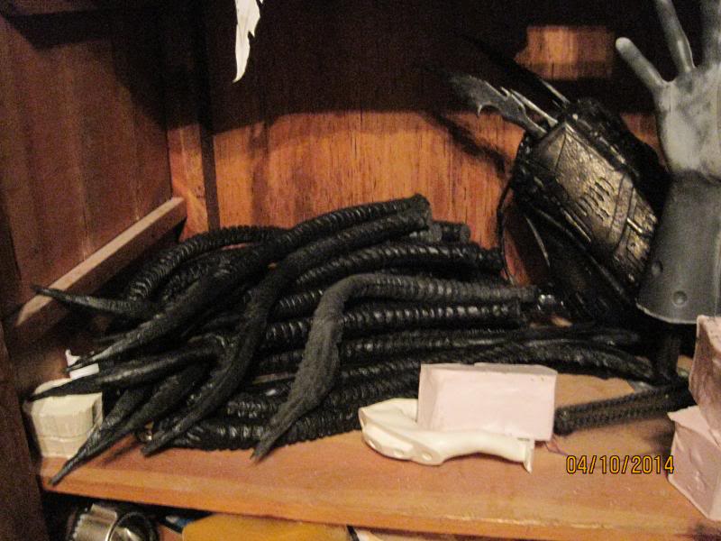

I had a good day of pouring dreads yesterday. I needed a few more of the biggest ones and all of the medium and small. I had to order new foam. The stuff I had laying around was so old it didn't foam up well. Luckily I didn't have that much left that I had to toss.
I still need several more of the mediums and smalls but here's what I poured yesterday.
These are the big ones I actually finished a year or 2 ago. Man I am a loser.

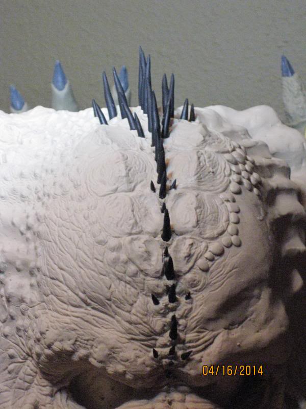

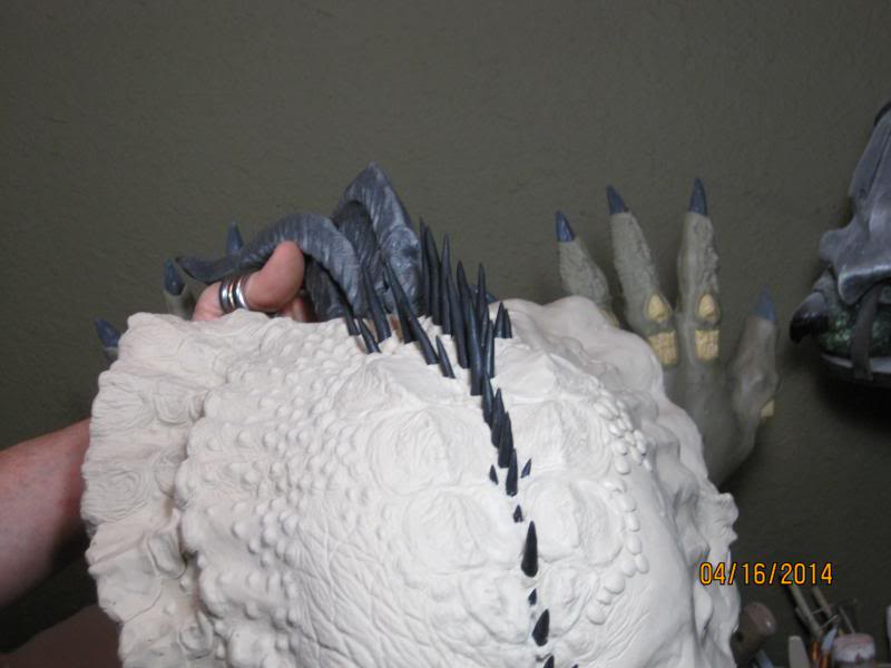

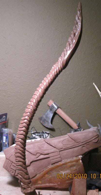

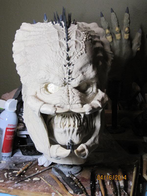

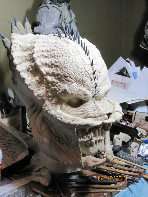

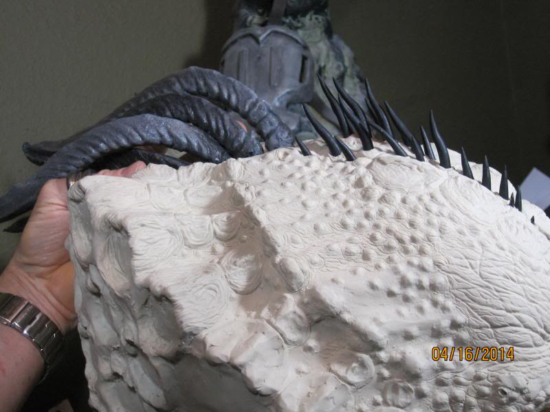

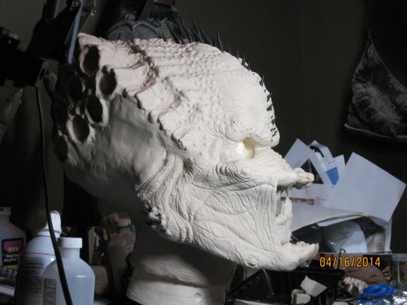

Thanks everyone for keeping up with this. I decided I needed to get the quill situation figured out to finish the head. I wanted to do something different, go figure. I thought it would look cool do have the quills lead into the topknot.
Here is rough layout
I will be sculpting around all of these quills next. Let me know what you think.
