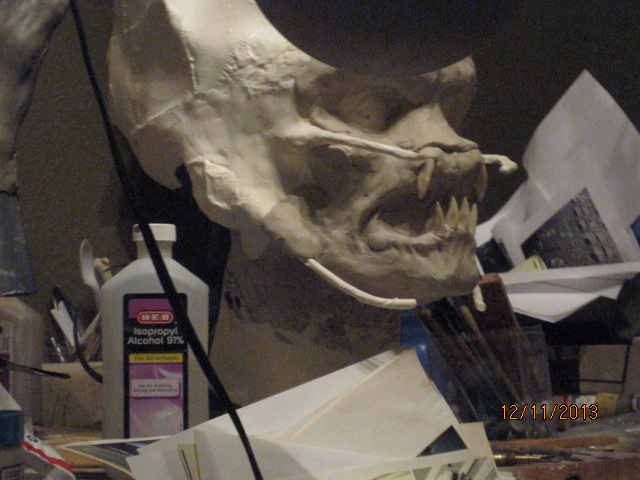

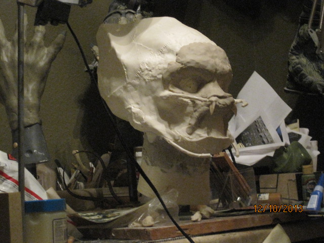

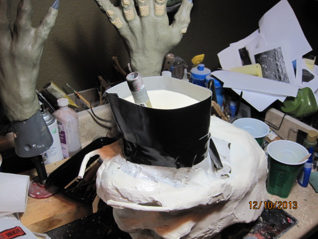

Here's what I got done today.
I extended the neck with resin.

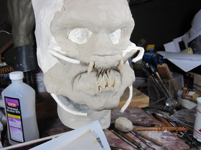

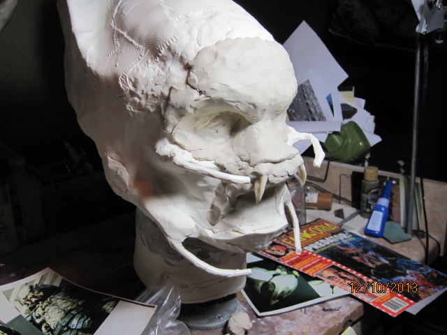

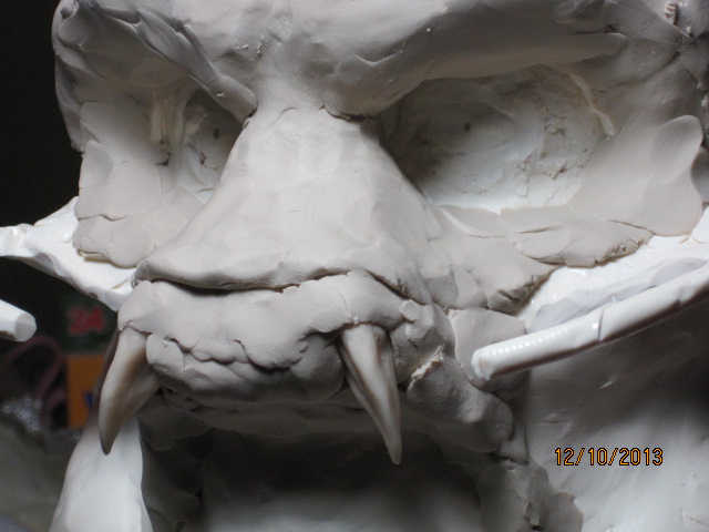

I pushed a little clay today. I'm using Van Aken's Klean clay. It is very creamy so I would say I like it so far.
I only got an hour or so in. I'm starting with the mouth.
I'm hoping to get some good time in tomorrow.

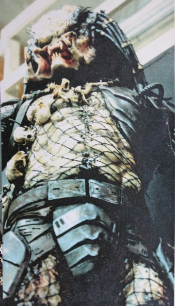

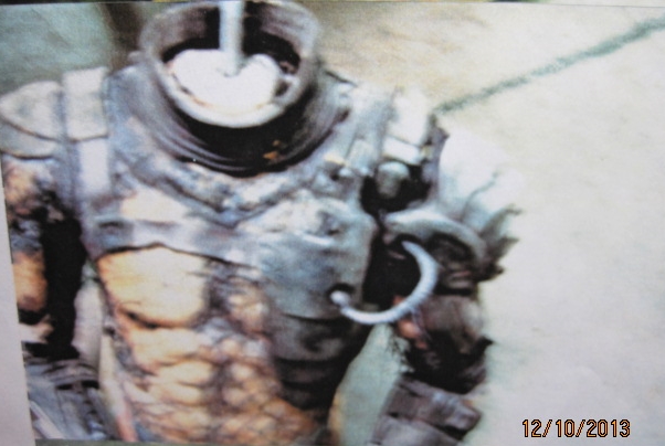

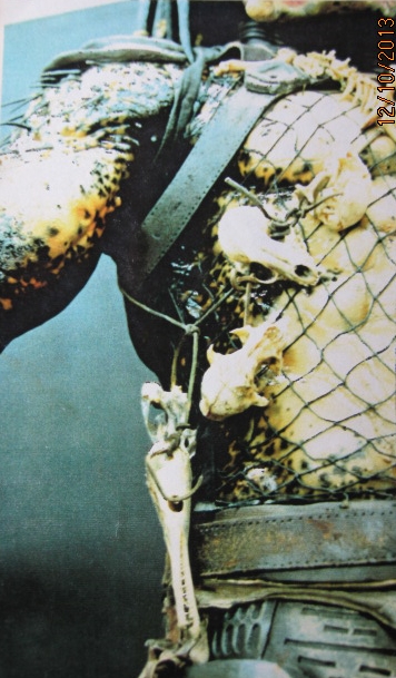

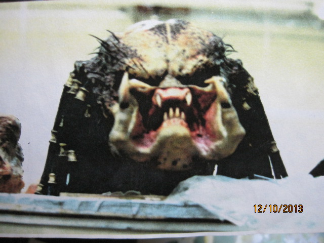

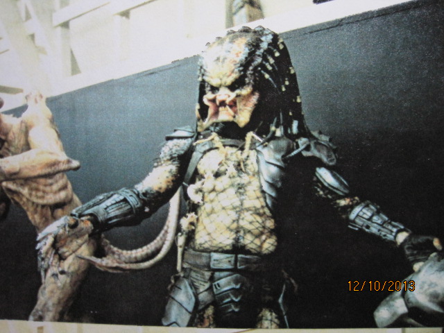

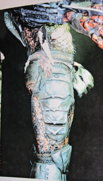

Hey I found these old Stan Winston studio photos that someone sent me years ago. I took photos of them and looked to post them in the reference area but could not so here they are. Enjoy.
I thought  this was a great pic of the hand. It is sort of crazy looking.
Just an FYI, some of those pics are in the stan winston book, I have it, and it's very resourceful. Just thought I'd let you know :)
Eli
Actually none of those pictures are in the SW book, those shots my friend I have never seen. (the angles). So those pictures are unique photos
-Chris

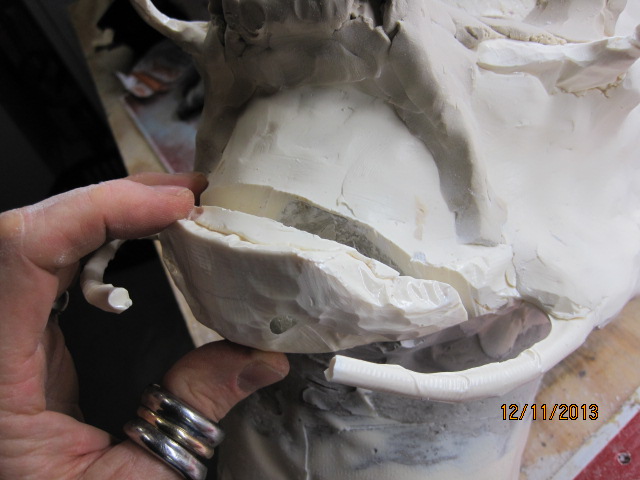

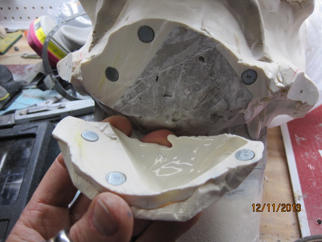

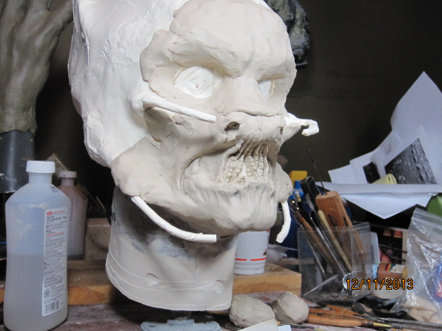

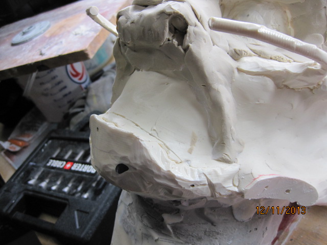

  I decided in the middle of the night two nights ago I needed to make the chin and lower mandibles on the plug removable just in case.
I cut he chin off then lined it back up and drilled three holes. I did that backwards. I should have drilled the holes first.
The holes marked my spots for the magnets. I used a Fausner bit and drilled for the magnets and glued
them in. That hollow spot is were the hydrocal was. There was no drilling that stuff. I will fill that void later
before I pour for the actual mask.

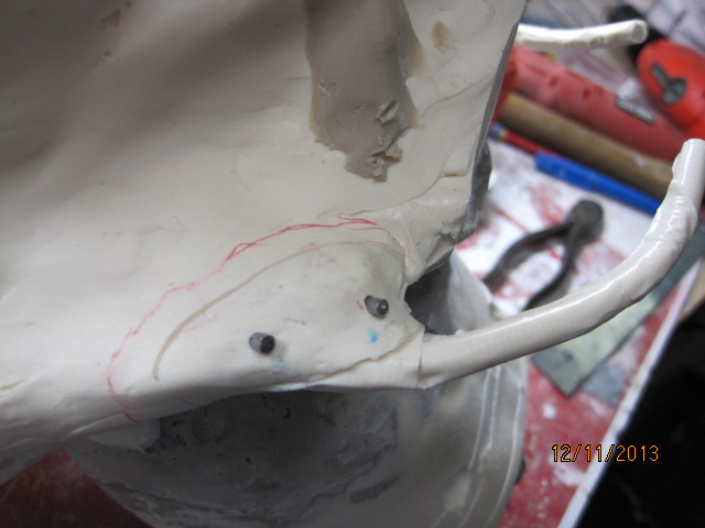

I drilled the holes for the mandibles first, see I can learn from my mistakes. Once drilled I cut them off
and cut the pins (nails) to the right lengths. I will just leave the pins sticking out as I did this part mostly for the initial
mold removal. I'm planning on removing the 2 outside halves of the mold, then  clearing away the clay and pulling the pins to
 the remove mandibles so I can then remove the mold piece that will be left in the mouth. Is that clear as mud?

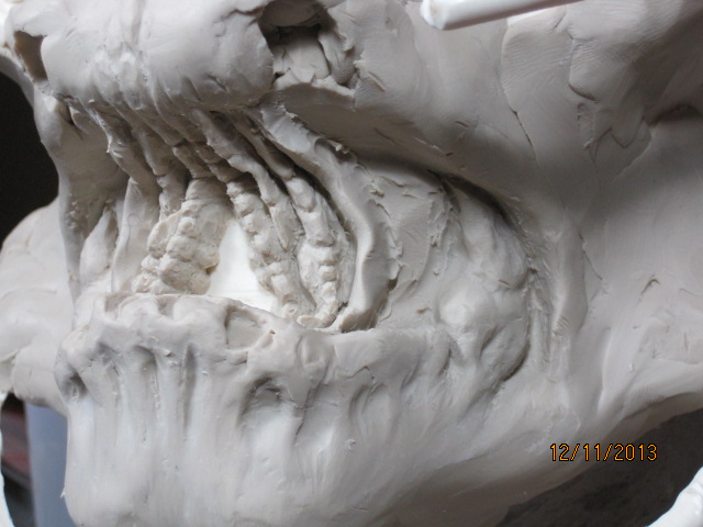

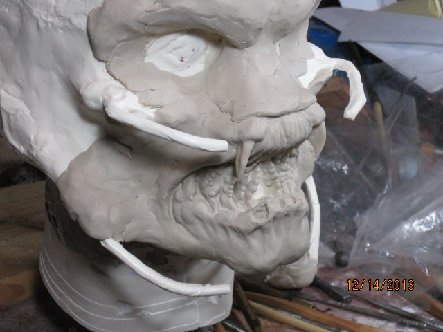

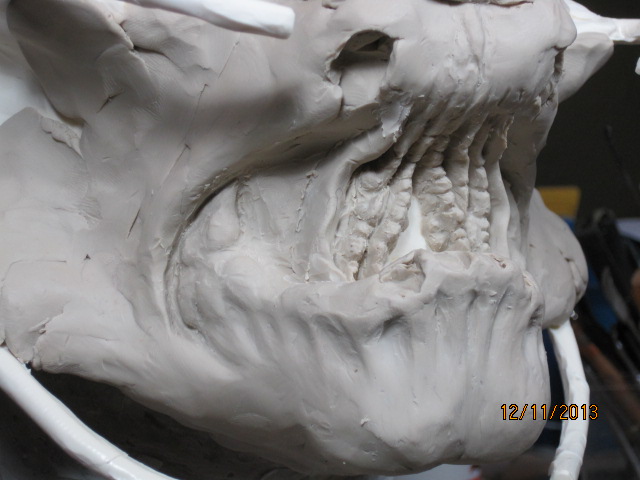

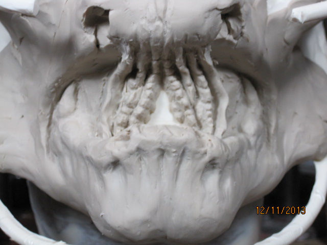

Here are some updates on the mouth work from yesterday.
I actually got a couple of hours in this morning.
That's all for now. So far so good.

This is really amazing. The detail put into this is incredible! I don't know if you've already answered this, but what type of clay are you using? For mine, I used WED clay. I just wanted to hear some different types so I can choose wisely. Again, amazing start!
Eli

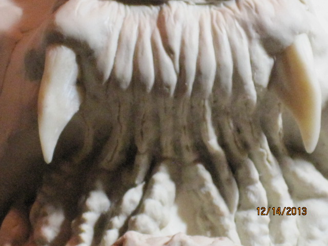

Lots of thought gone into this as usual, and that's one vicious set of teeth you've used there.
Thanks troggs, the teeth are left over from the other head. They are the first dental acrylic teeth I ever did. By the way the movie "Trog" gave me my first
idea of a movable face for a mask. I believe they used that mechanism initially in 2001 Space Odyssey and later in the Chubacca head.
Eli
Hey  Eli, thanks. I am using Van Aken clean clay alternative. This is my first time using it and I am really liking it. It is smooth and creamy.

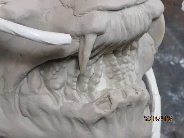

Here are a couple of updates. I am pretty sure this is how I will leave the inside of the mouth.
