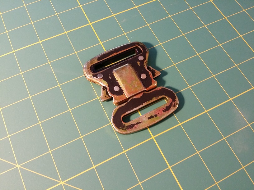

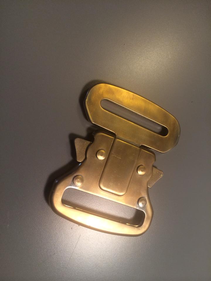

Brass plated buckle.
How it was done:
Disclaimer: I take NO responsibility if you try this- do at your own risk. Make sure you follow any safety instructions as to how long you can run your torch. DO wear eye and body protection because HOT brass dust occasionally flies off the dremel. Obviously, keep water nearby and flammable stuff away. A small gas blowtorch (like the kind used to flambe or heavy soldering) was used to heat the buckle (held in a vice) and then a dremel with a brass brush was run over the surface. Took maybe 20 minutes to do the whole thing (My torch can reach up to 1300 degrees Celsius).
How it was done:

joatrash, any issues with the springs as far as you can tell? That was something I was nervous about because I know high heat can change/ruin tension in springs. The buckle looks fantastic​ though!!

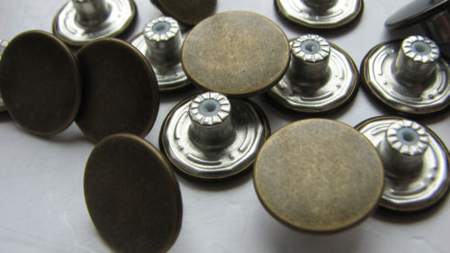

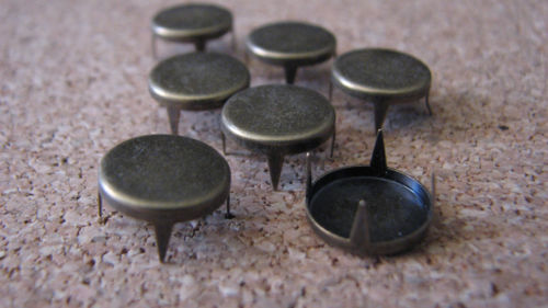

Also, these things come in 8mm and 12mm, do they look about right for anything?
And these ones come in 15, 17, or 20mm sizes.
The first ones are what Soulinertia and I bought for our bags, the second one is buttons for jeans. You can't set those into fabric.

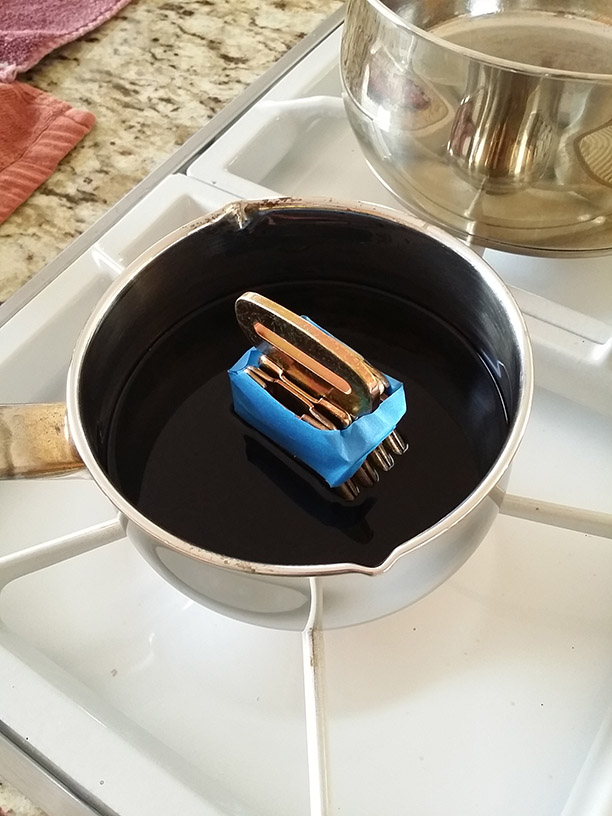

Ok here you go, a way to change the color of the blue insert of the buckle with out having to take it apart and is super easy and cheap to do, just takes some time ;)
First you need to get Black color dye, "RIT" the key in this product is that IT WILL STAIN PLASTIC.
So part one of my buckles.
get a small pot as shown in photo, a way to prop the buckle so the hole thing is not submerst in water. Fill pot to just a about the blue part maybe an 1/8" over. Bring pot water to a simmer, not to hot as to melt the plastic and to were you can dip your finger in and not burn. 100degF is good. Next add your Black RIT dye, for the this small pot i added about 7 tablespoons. Next place buckle in dye water, i had 4 buckles so i taped them together and used the other end in one as a handle. Now the hard part, have to wait, for me i left it in for 1.5 hours. I would check it every 30min. tell the right color is achieved. The Dye does its best in hot water. After you get the color, wash off the buckle in warm water, you may need to use a small shop towel to wipe off any residue from the metal buckle. Thats it easy and simple. You can see in the photo the buckles next to each other, one with the blue and the one that was dye black.
Step two to follow, which is the process of the black wear look on the buckles.

^ Nice effect on the buckle StarLordGoG :thumbsup
