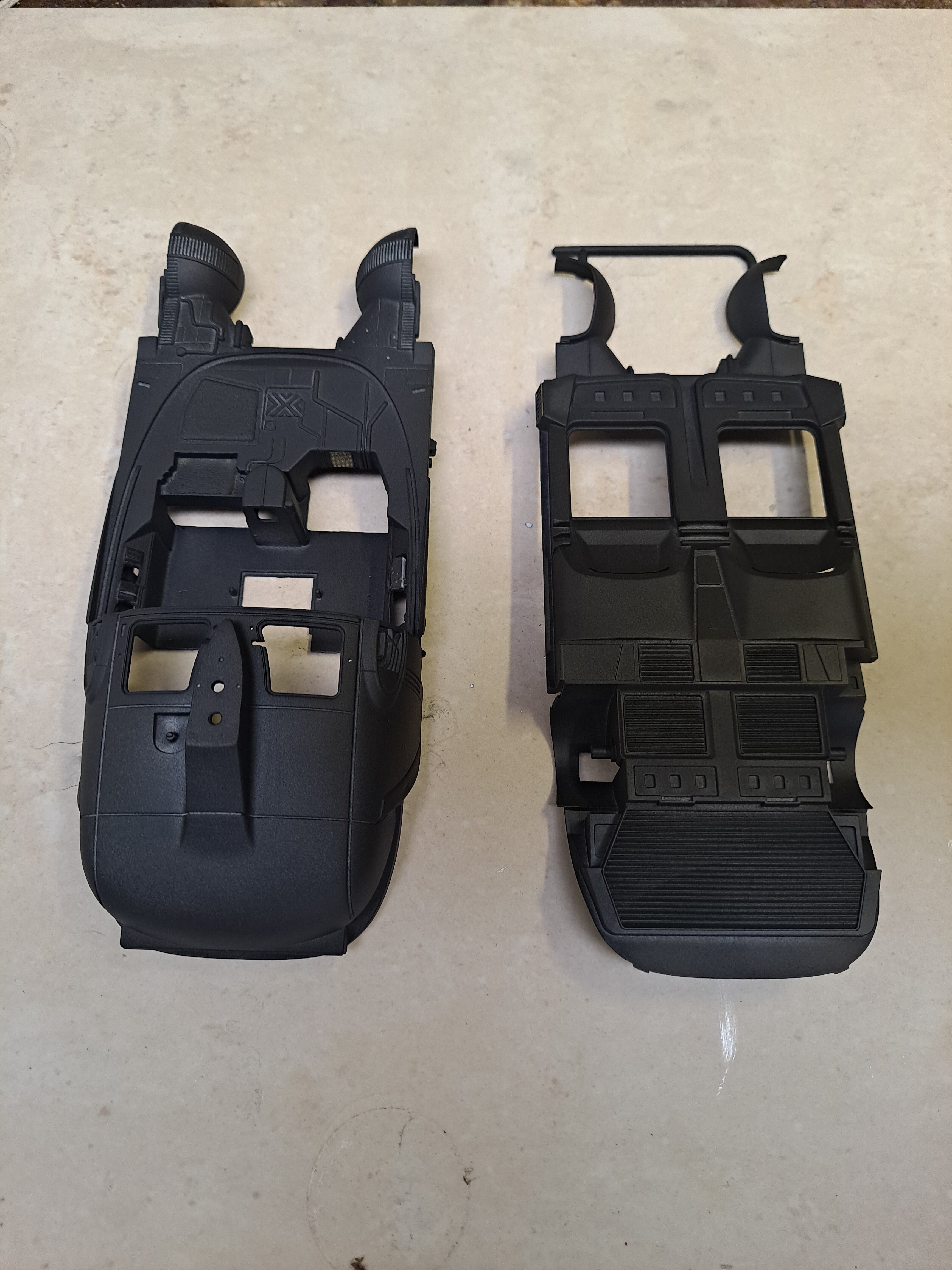

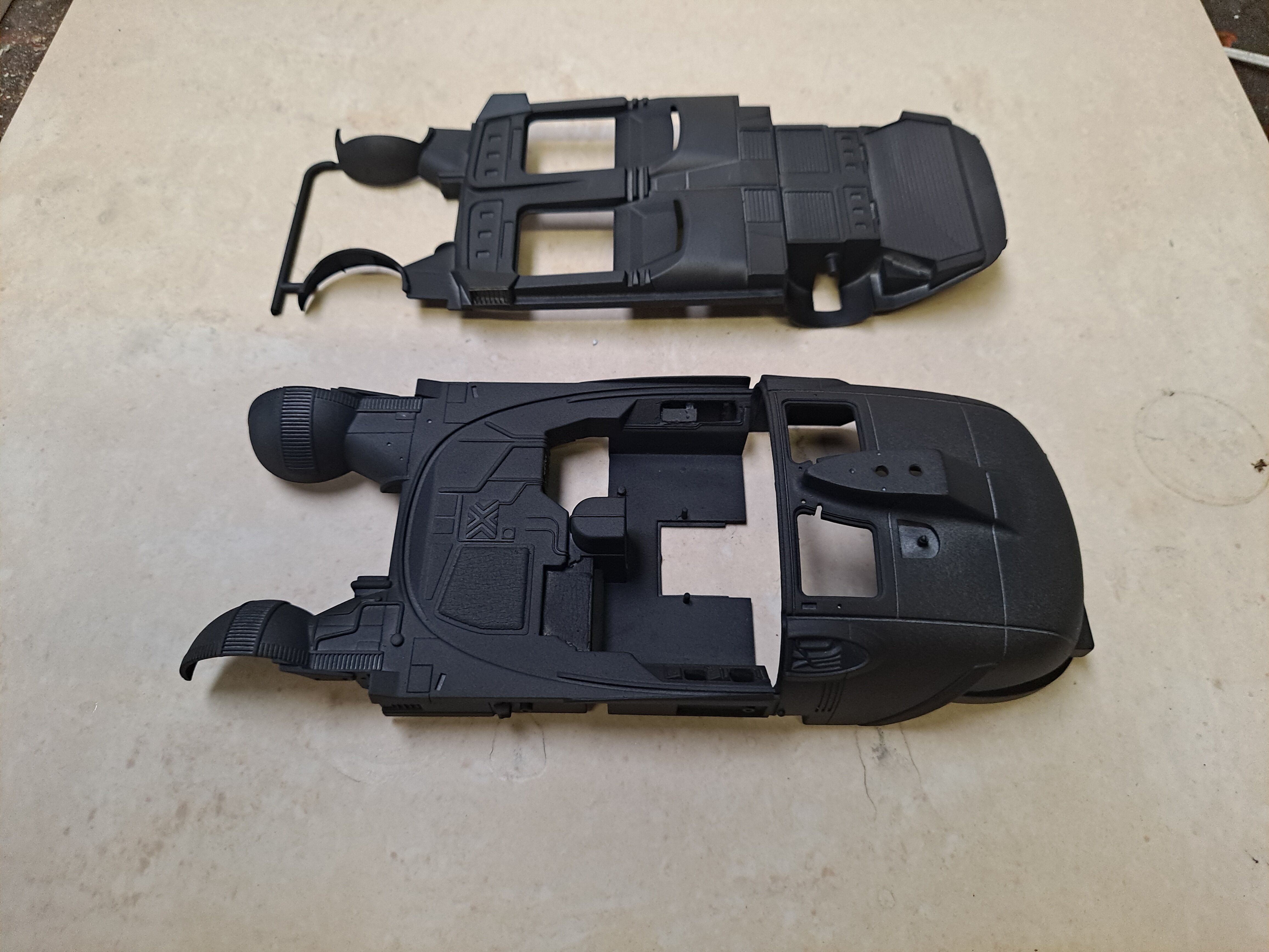

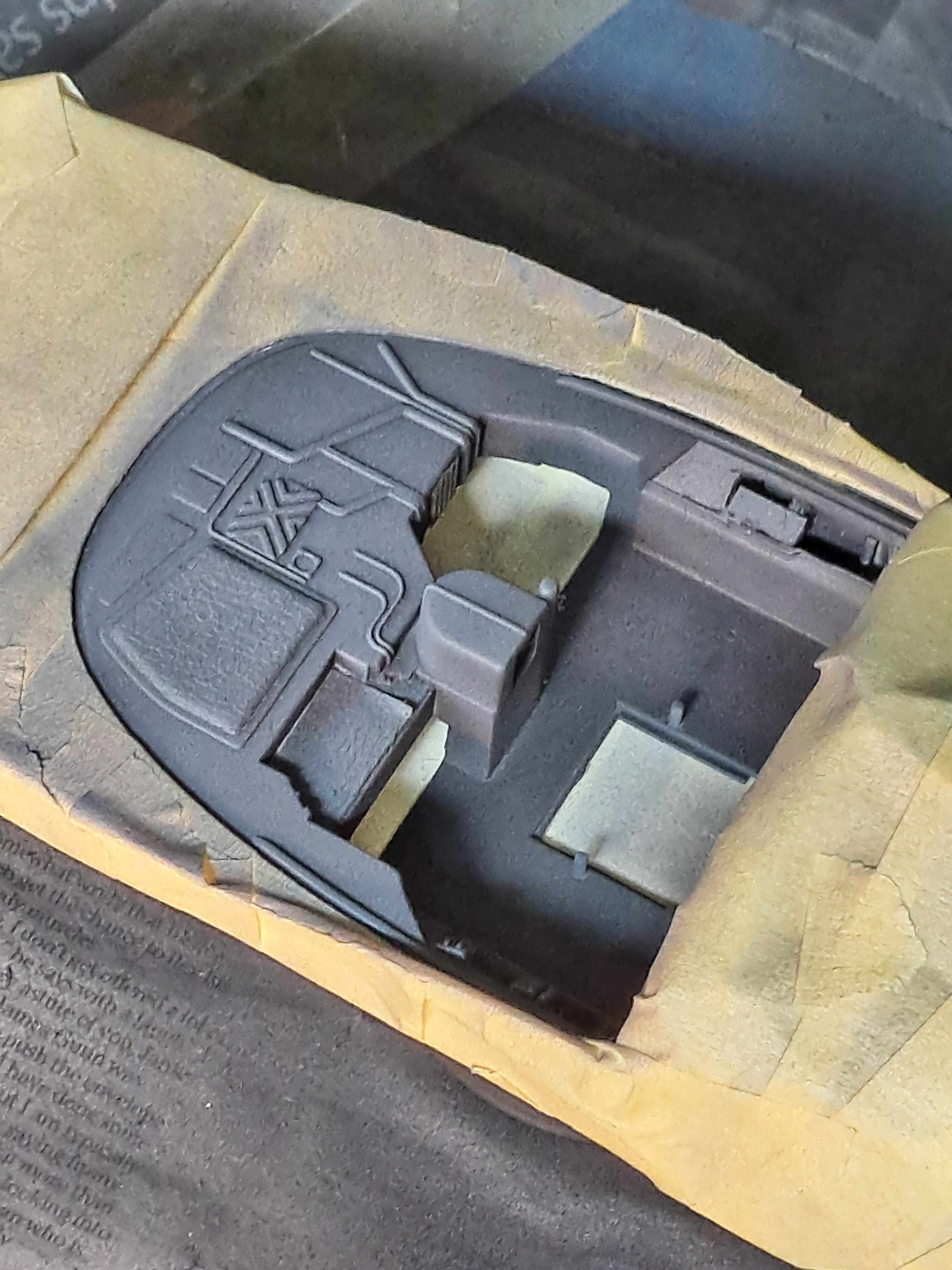

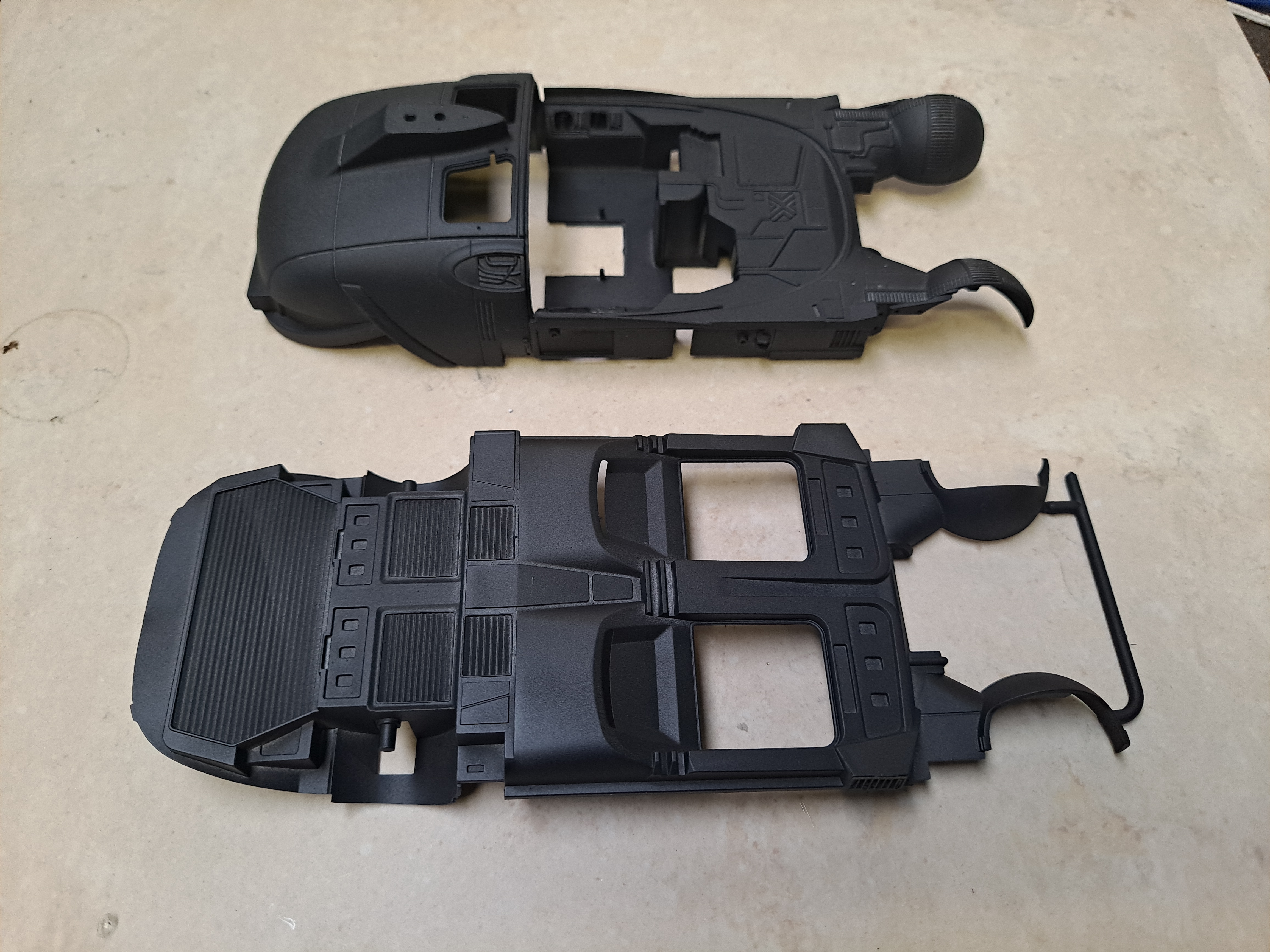

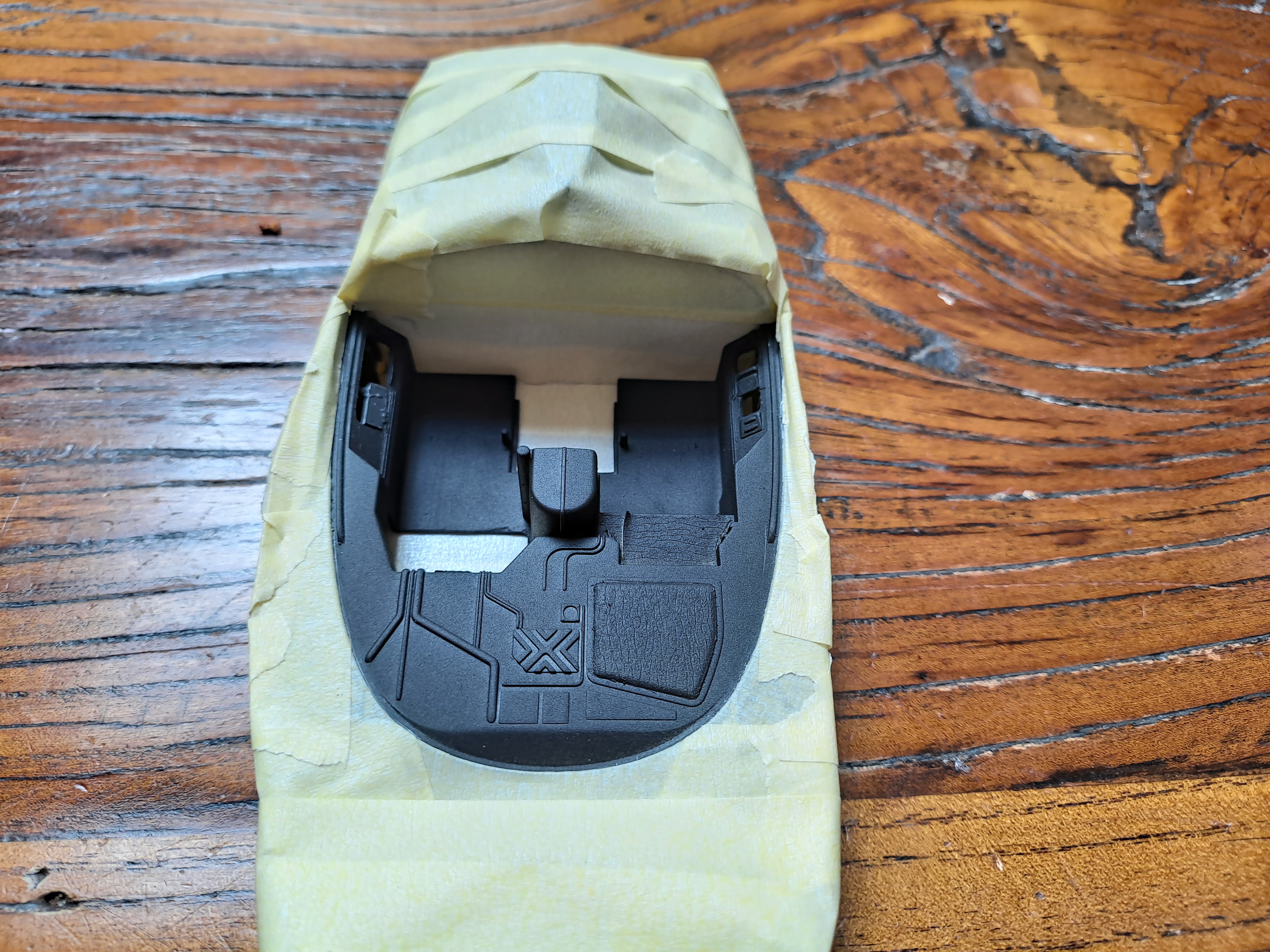

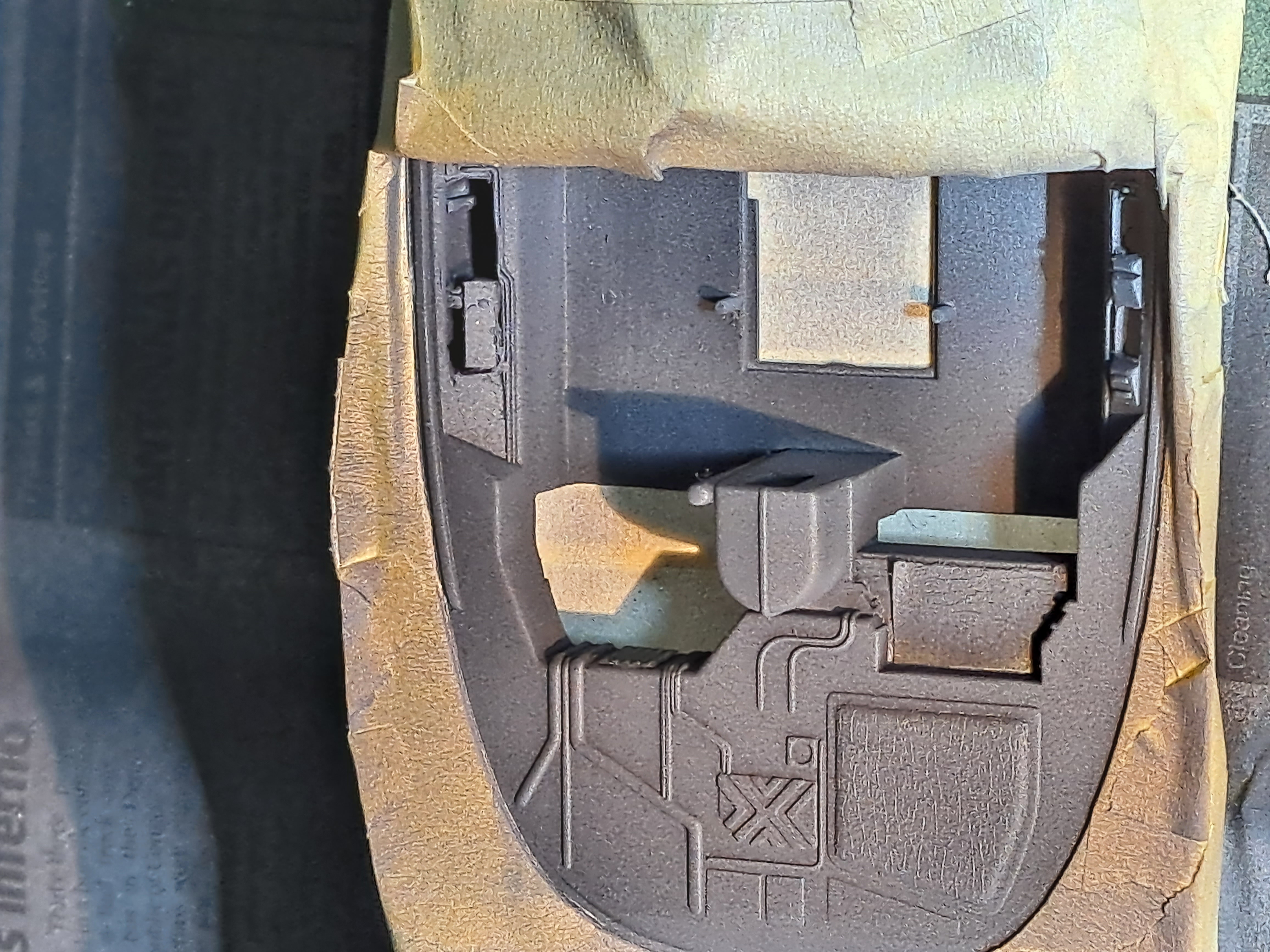

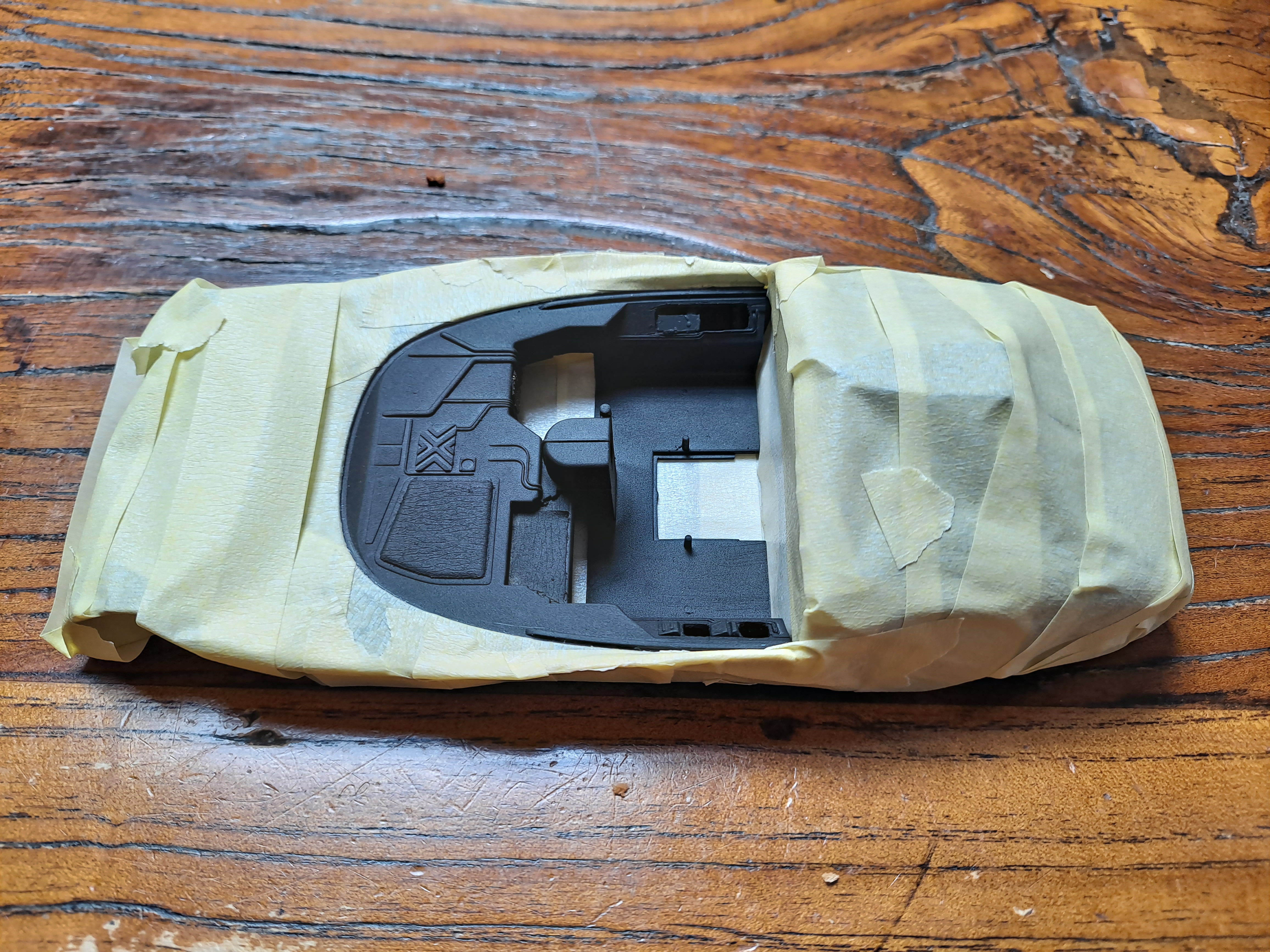

Hey there wayouteast! Yep still here - just had a busy week and took a break from the project. Prepped and sprayed the interior last night and this morning. I'm happy with it. I'm not concerned with the floor well around where the seating will go because it won't be seen.
I've taped the white panel forward of the driver and the dashboard where the driver's display will sit. I plan on blocking that portion out with al-foil and doing some drilling (similar to yours actually) I can run the lighting for the display.

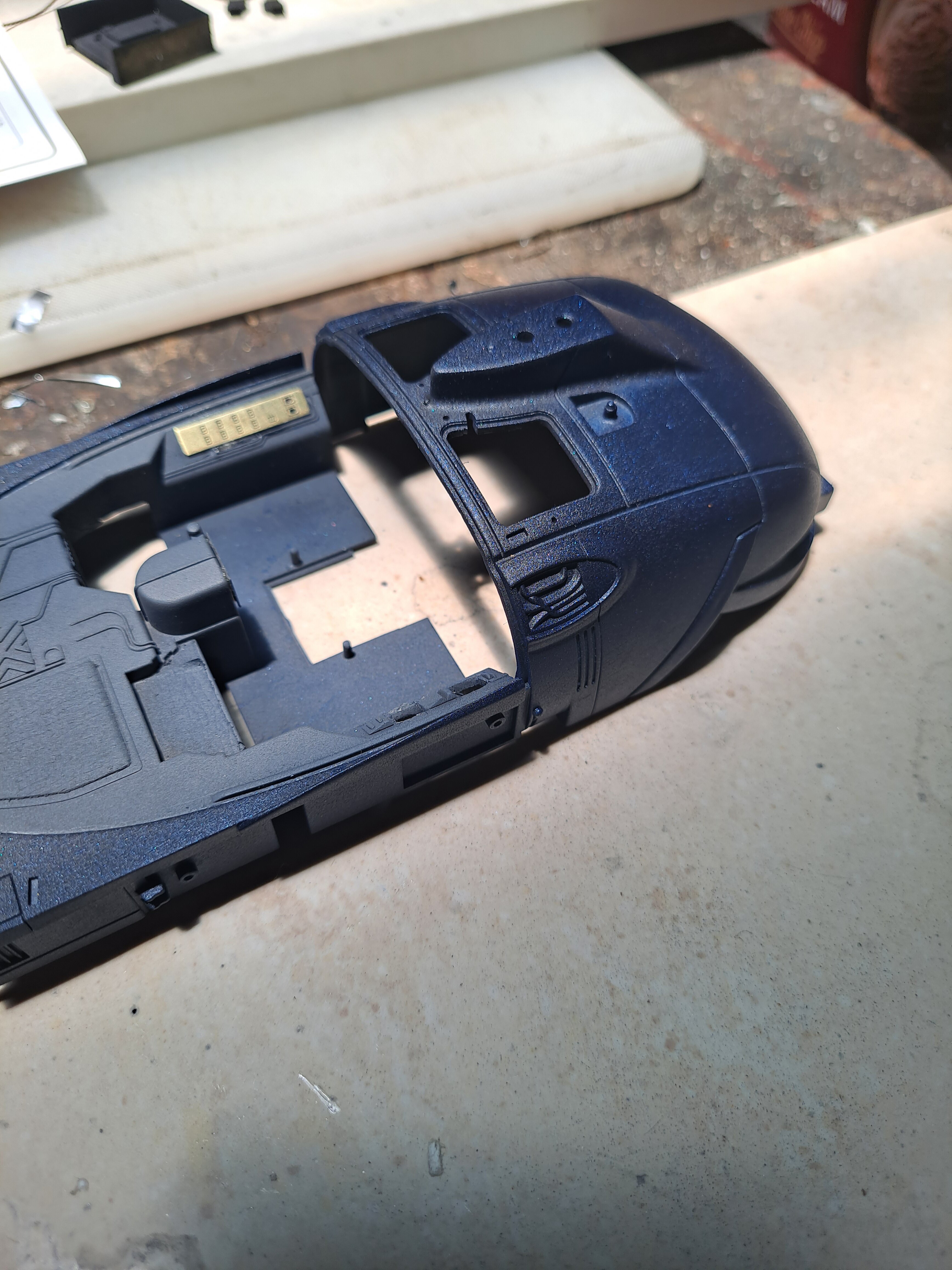

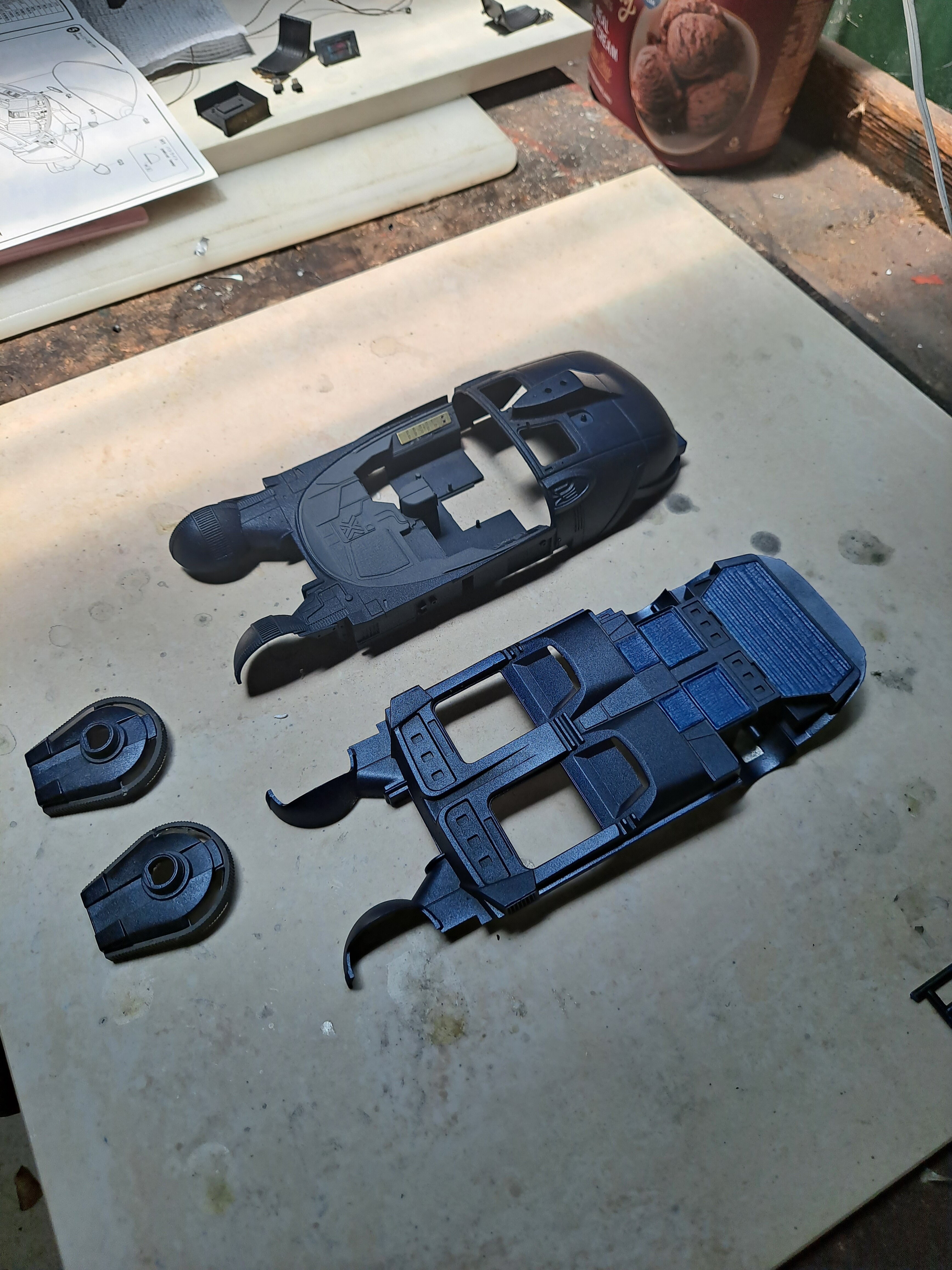

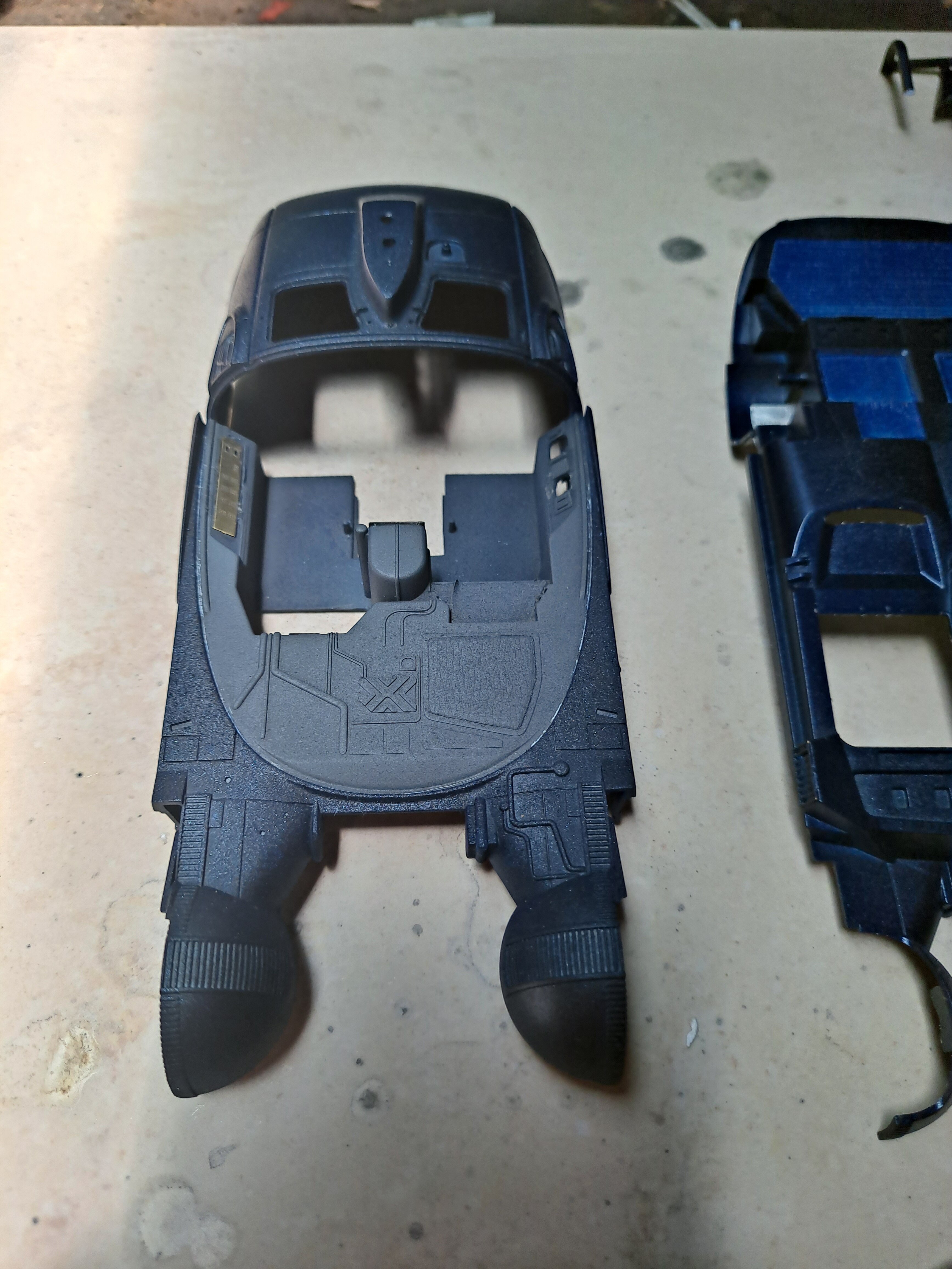

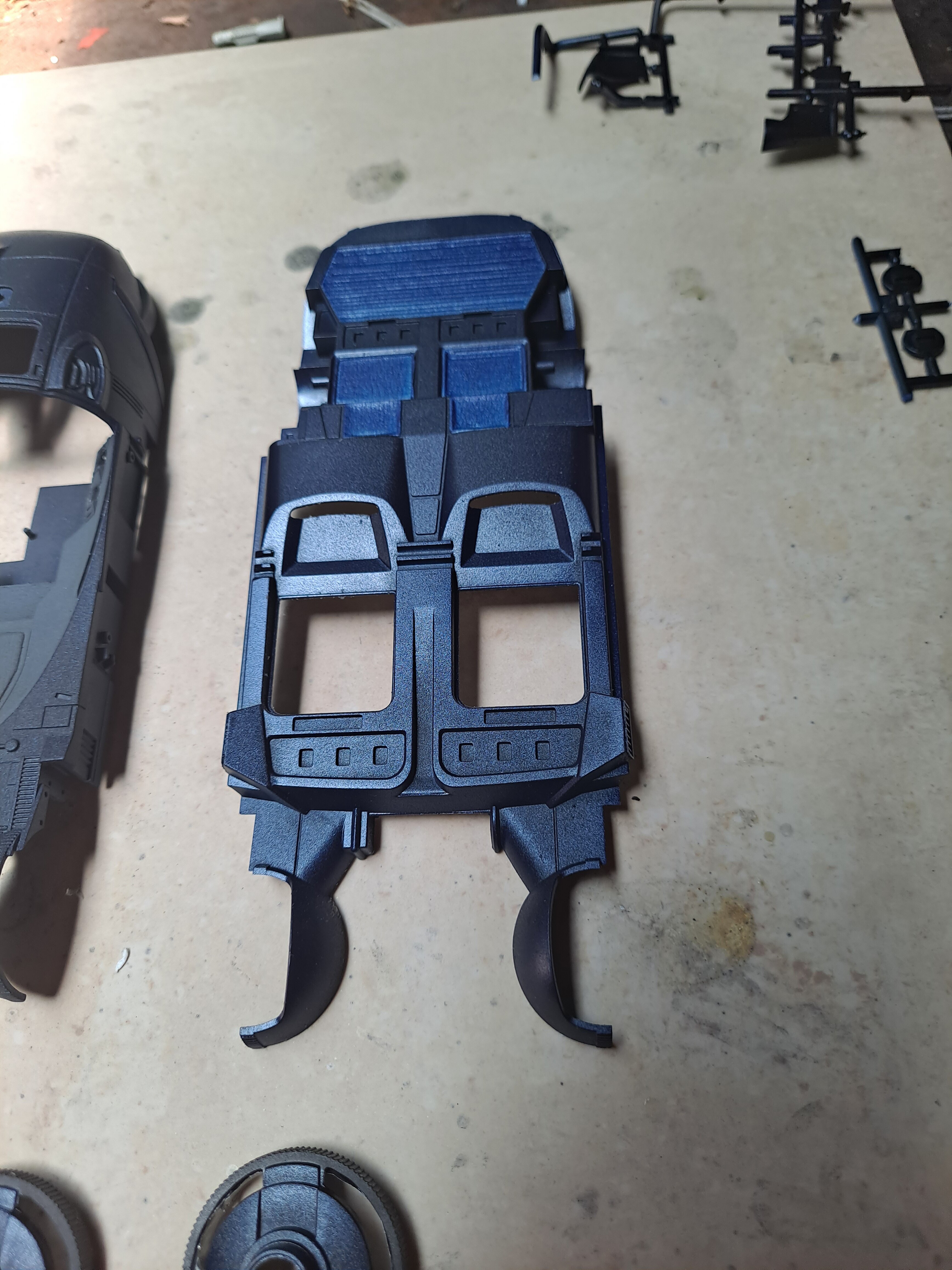

It's been a couple of weeks. I've had a lot on and I haven't been able to do much work on the Spinner. I did get the final coat onto the body and I'm happy with how it looks. I wanted to go with a darker shade than the movie prop. I've always seen the Spinner as a darker blue compared to the lighter blue that it *should*. The Tamiya TS-51 Racing Blue has this metallic speckling throughout it which I really like. So I may not overspray with the lighter blue that I was considering after all. I had to take a backwards step with the front wheel covers as I wasn't happy with the coat I gave them. Fortunately, with the Dettol trick I picked up on here, I stripped them back and started again. They look much better the second time around. One thing I'm a little concerned with are the holes I cut for the Paragrafix overlays in the driver's side and passenger side doors. I did make them a little too big and I'm trying to work out a way of addressing that with some sort of greeblie. So far, I'm not having much luck.

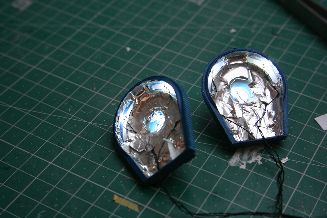

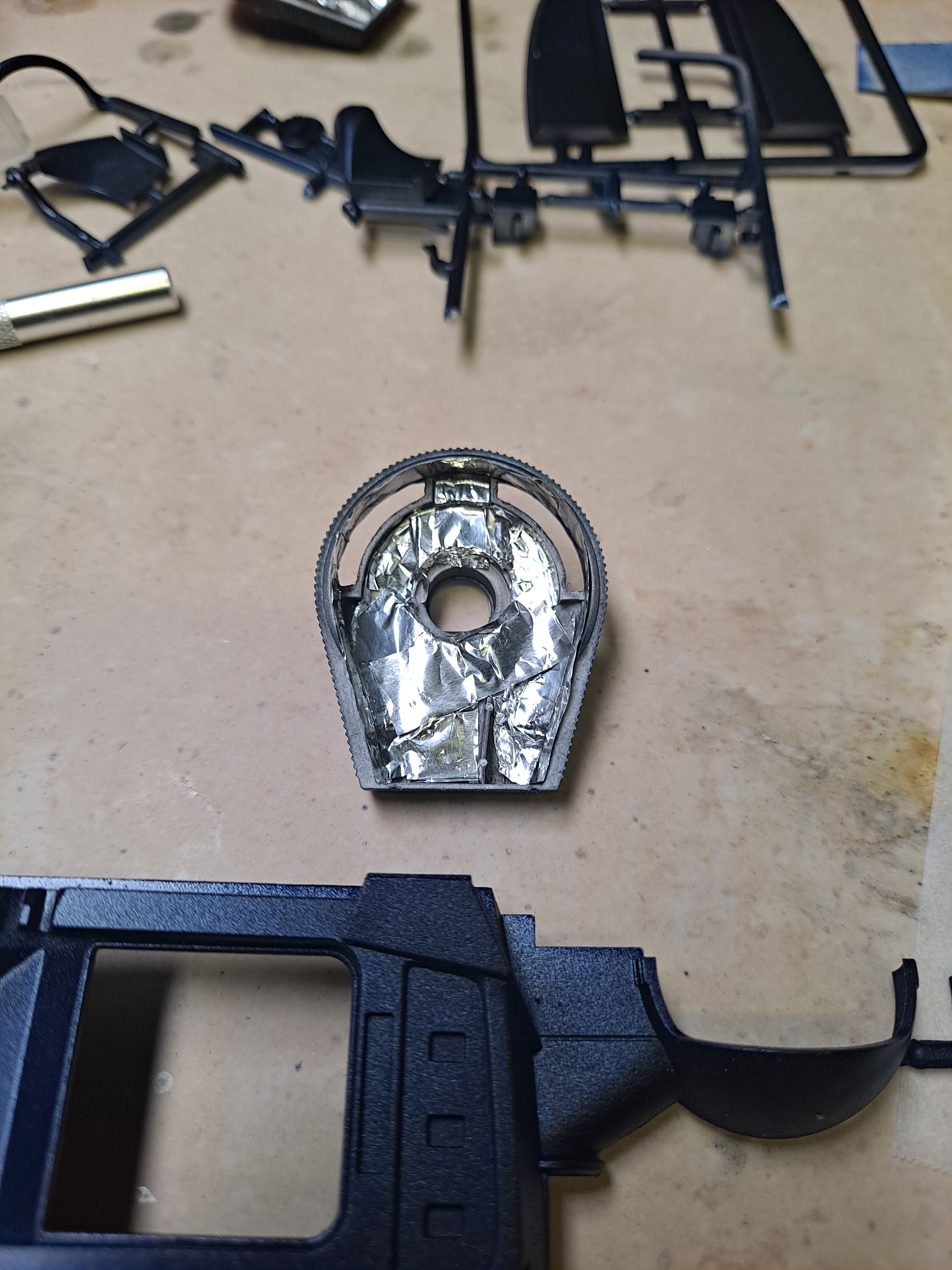

I'm onto the prep work for the lighting. Taking a cue from wayouteast once again, I'm blocking the interior with aluminium foil using some spray glue to fix the foil strips I've cut. For some reason, I'm nervous about the lighting. I know it's going to be fiddly and I keep hesitating with it but I know I'm just going to have to dive in eventually.

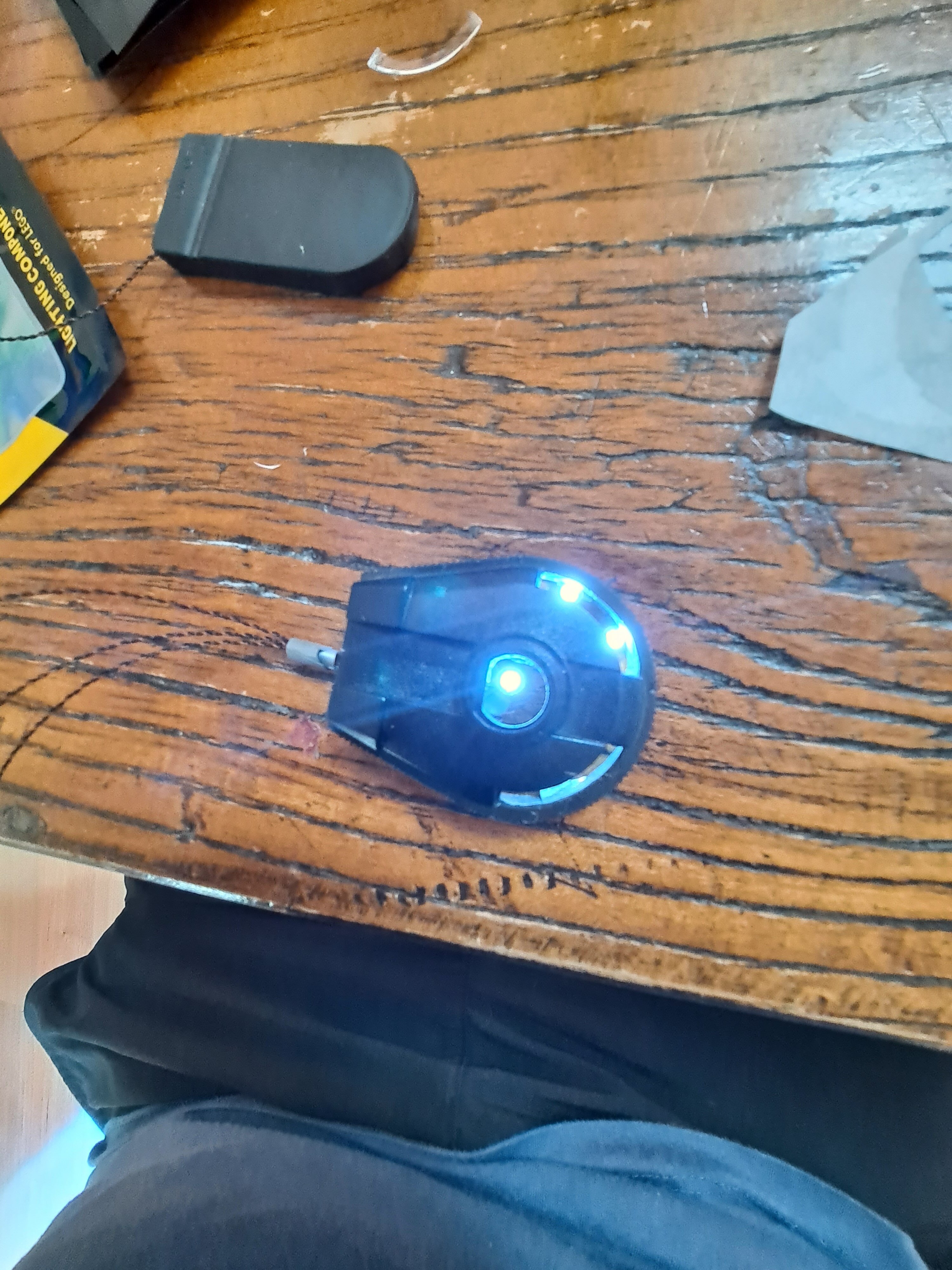

First test of the lighting. I started with a single LED in each arc but I'm concerned the light diffusion isn't bright enough.
wayouteast - I'm struggling with how to diffuse the lighting through the wheel cover arcs. I've tried back covering with baking paper and attempting to glue paper onto the backs of the transparent plastic arcs to actually painting the backs of the transparent plastic arcs. None of these look good.
How did you achieve your look?

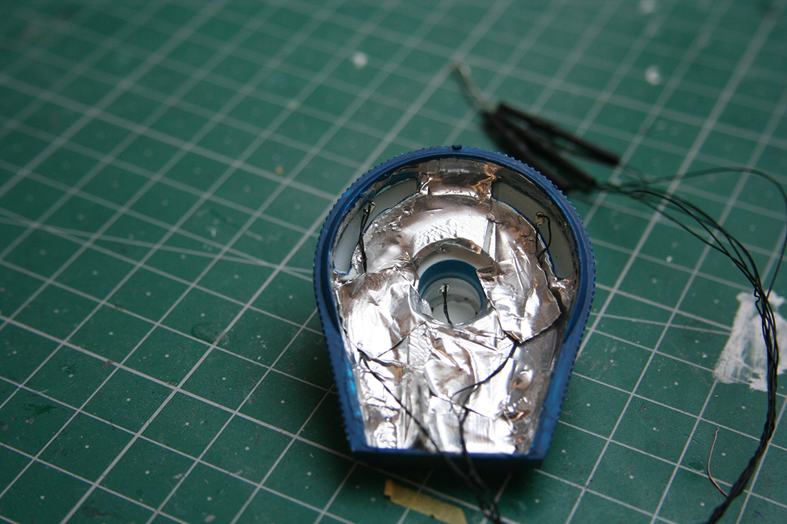

I actually made replacement insert pieces for most of the lit areas from 3mm opal acrylic LED light diffusion sheet like this, which you can buy cut to size (you don't need much - I think I ordered 150mm x 150mm):
Opal 35% Spectrum LED Light Diffusing Acrylic Sheet - Cut Plastic Sheeting
This not only diffuses the LED lighting brilliantly, but also gives a uniform look to those areas when unlit.
So I didn't use the kit's separate clear pieces for the wheel covers (the 'arcs' and the centre piece) at all, but carefully cut pieces the same shape from the diffusion sheet. The sheet does diffuse the light enough to avoid obvious hotspots, even at the small distances within the wheel cover. Those areas were lit with the same nano-SMDs you seem to be using, and in pretty much the same location (though I only used a single SMD for each 'arc'. You can see my setup from the inside here, unlit...
And lit...

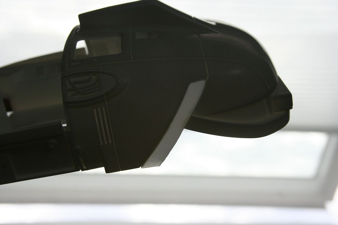

I also removed 'strips' of plastic from either side of the fuselage and the 'fin' on the top, where the lit areas are (yellow/red on the sides and white on the top). These were again replaced with heat-curved strips of the same diffusion sheet cut to fit. Those were lit from the interior with lengths of LED strip. You can see the translucence here, with the body held up against the light from a window...
The only clear piece I retained from the kit (other than the cockpit glass, windows and various domes and other beacon lights) was the main front 'headlight' at the front between the wheel 'arms', since when I looked at photos of the original prop you could make out individual lights in that area, which were replicated nicely by the LEDs on the LED strip I used there. There was just a thin curved sheet of tracing paper inside the clear piece to very slightly diffuse the light.
Hope this helps!

Brilliant work from your end wayouteast - I fear I don't have the skill or the patience to try something similar to yours. That said, it looks as though I can get the product here in Australia so I might reconsider this...
For now, I tried cutting some standard A4 copy paper and I managed to fashion some serviceable inserts that sit flush over the arcs. They block out light bleed from the LEDs and diffuse the light. I've sat the clear covers over the top of them. The diffusion is okay. I've gone with three LEDs per arc to try and minimize the dead areas between each one.
